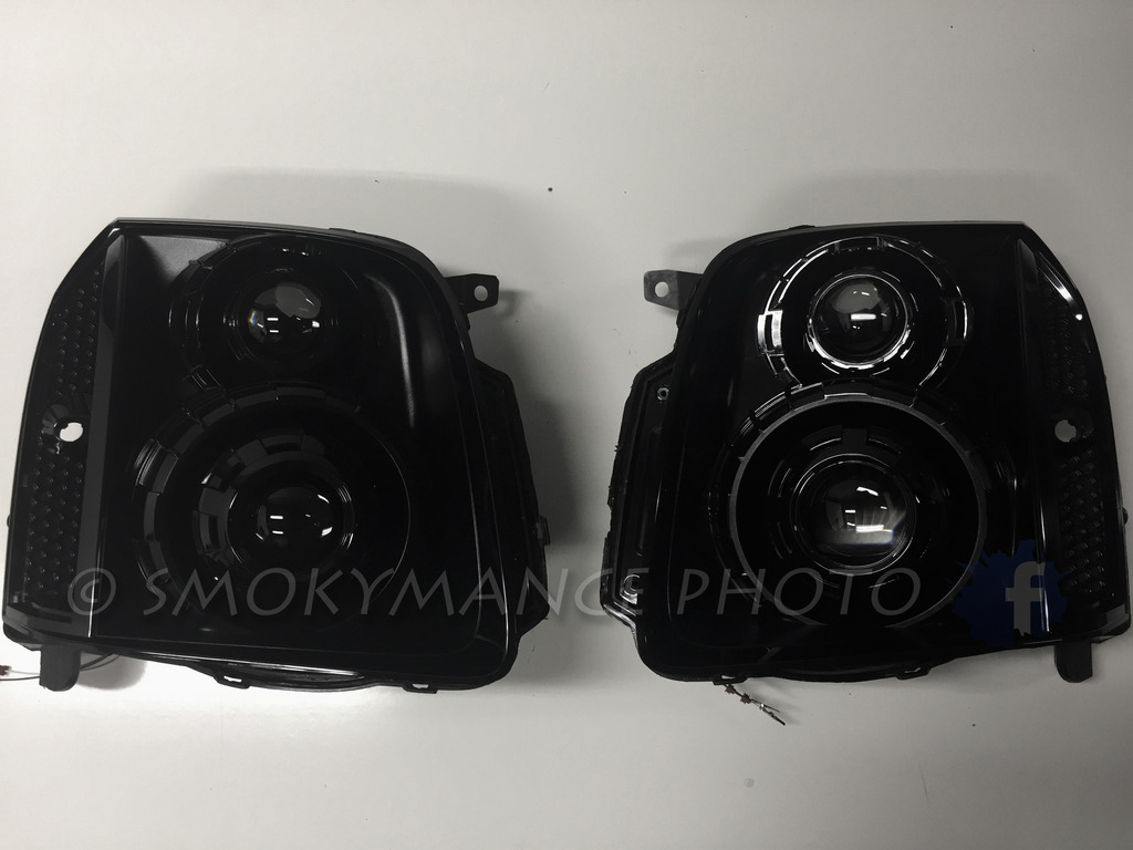

The blacked out nnbs retro above looks awesome! If mine was black I would do the same!
