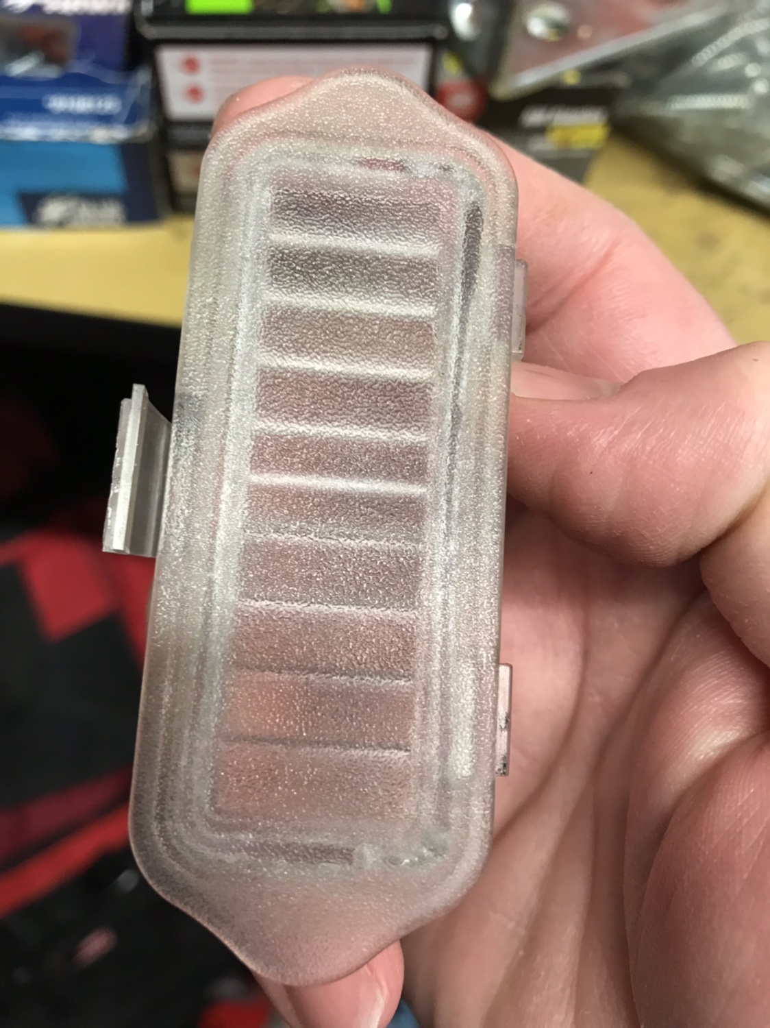

Just ordered these. Got to try it out, and see what they look like. I’ll install them as-is first. Not sure if I’m going to polish the puddle lamp lenses yet. [emoji106]

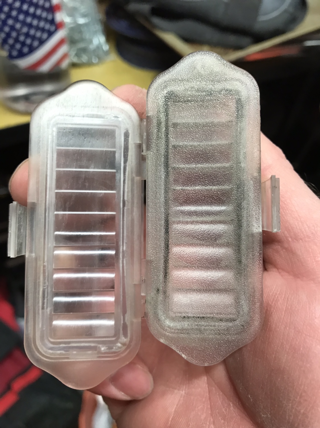

Sam... It's really easy to get them clear.... ...If you choose to do it.
Yep, should be cake. Just want to see how bright those suckers are before I go making them brighter. [emoji16][emoji106]

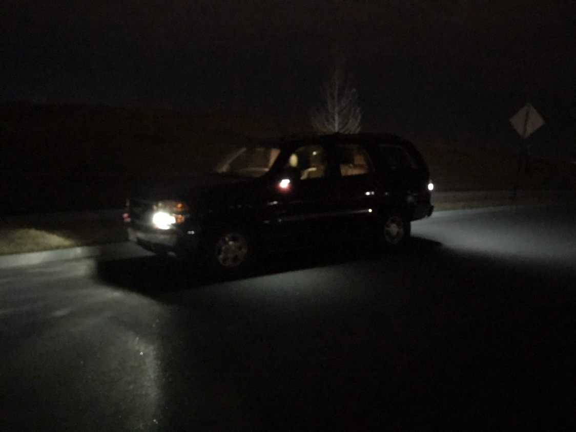

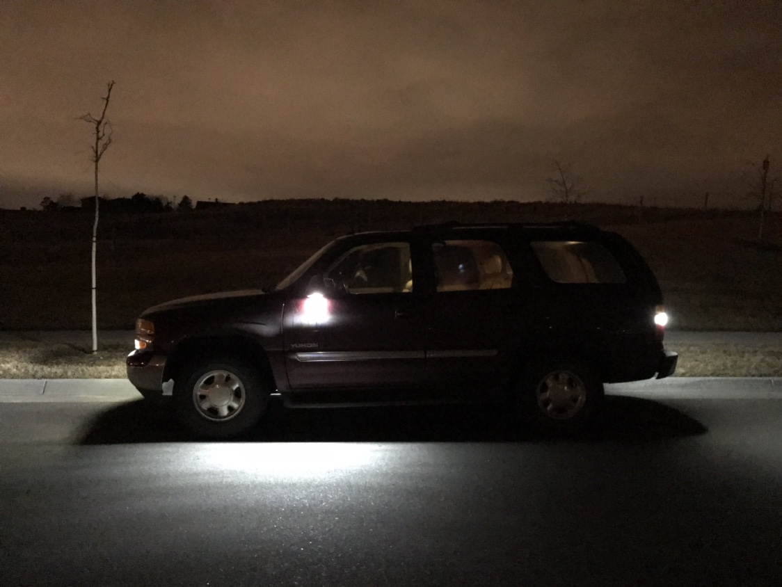

Forgot to follow up on this thread. I added the LEDs that @HighHoeSilver linked, and also polished the lenses. Didn’t go crazy with getting every little scratch out, but still a big difference. Very happy with the results. Not the best pics, but you can get the idea..

Sam, get a 4" buffer wheel that attaches to a drill, & rubbing compound, it will clear up in about 10 easy minutes.

Yeah, just used the dremel. They’re fine for me. I’m not looking for anything more than that. Lol.

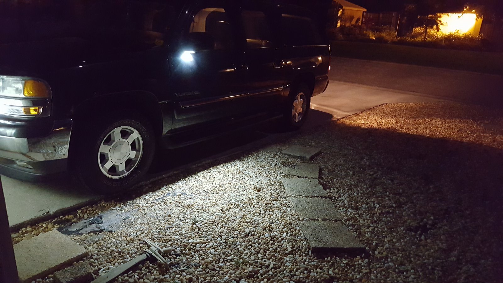

HiHoSilver..... With my polished/clear puddle lenses, and the just installed LED's you recommended, the puddle lights are *****'N BRIGHT!!
Annnd the pictures are..?
It’s nighttime here.. I’m guessing the same in your neck o the woods..? Good time to get some photographic examples, eh?
