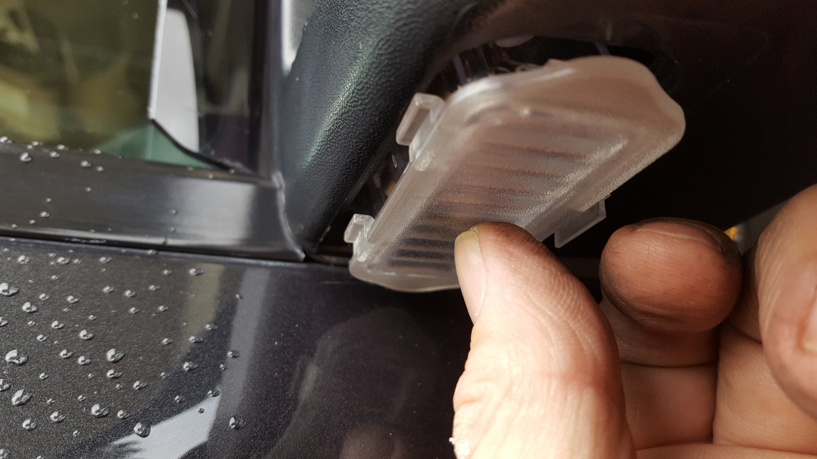

I found a thread in our forum, but it does not describe how to get that darn puddle light lens out, after lowering the lens part way, pressing the plastic clip,.......... What do I do next??
It will not drop out any further!! What is the trick to get to the bulb???

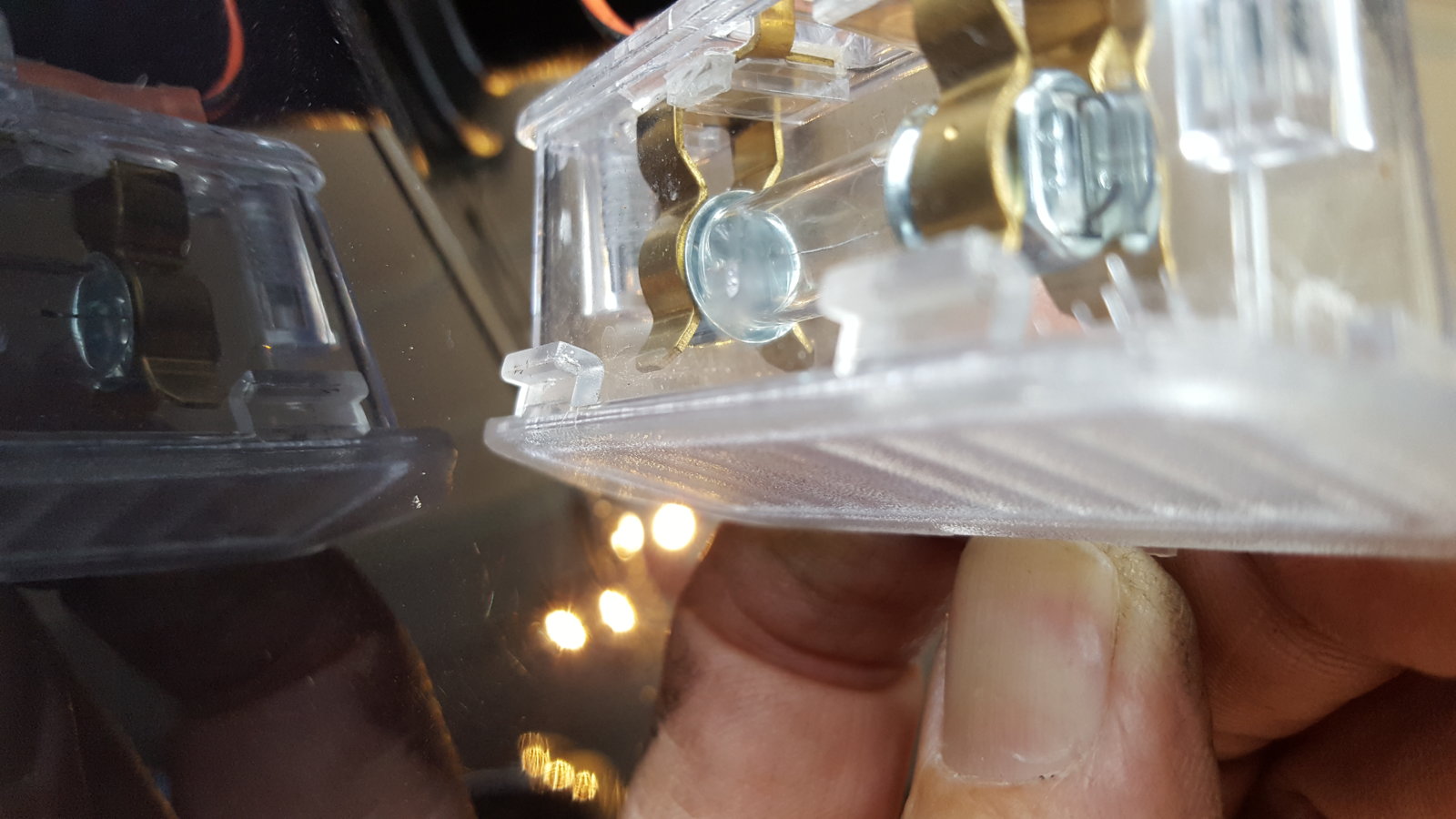

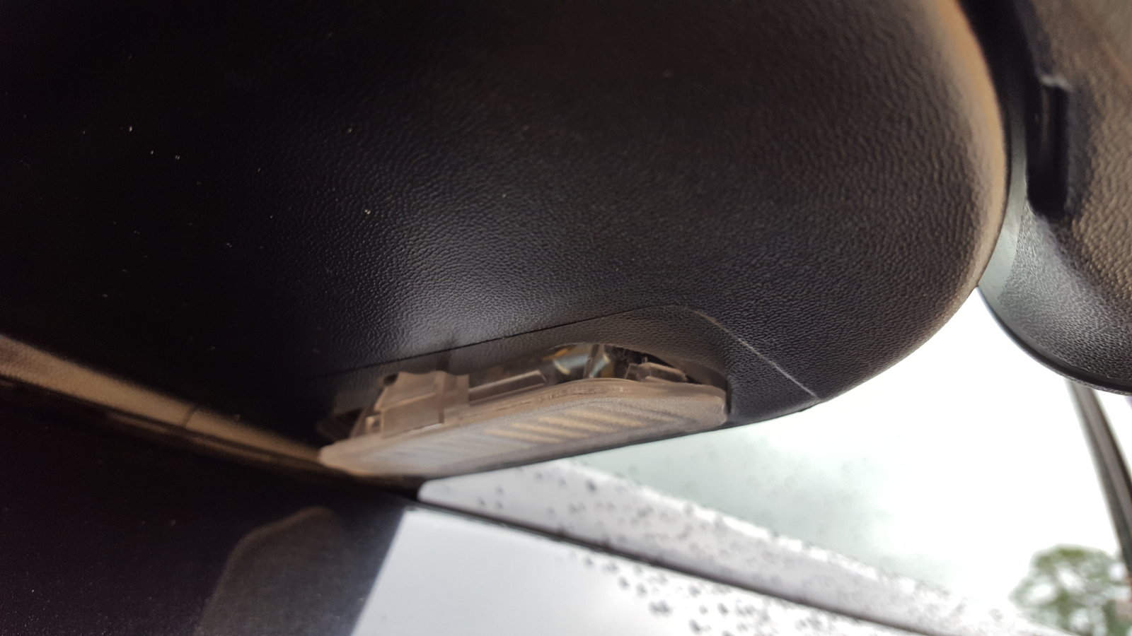

UP date..... Well, I figured it out.....
2 more photos : When you press clip and it slightly opens, then as you open it up a bit more, put a forward pressure on the lens, to slide the little rear 'tips' away from the mirror opening / edge.
Then it drops out.
Then I realized the auto parts guy sold me the wrong style LED bulb.
