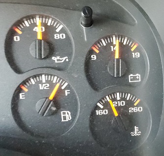

Engine temps while driving look completely normal. What is the temp at idle?
Idle values from post #2:

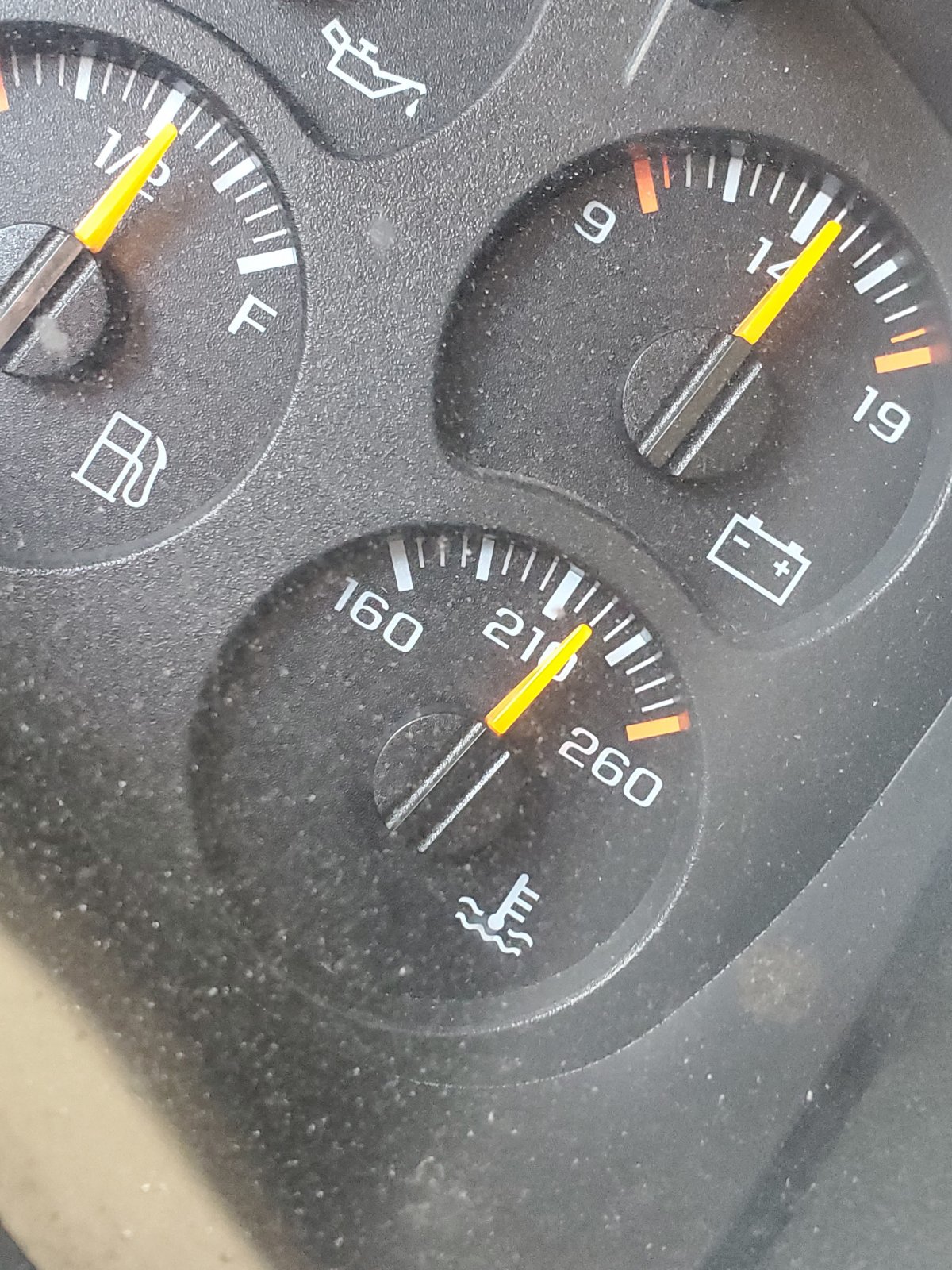

I agree, what I mean I guess is that it was warmer than it usually is. The gauge was showing roughly "225" instead of "210".
93M6Formula
Sep 1, 2022
34
8
This is with that line basically clamped shut. This was showing about 203-207 on my scanner.

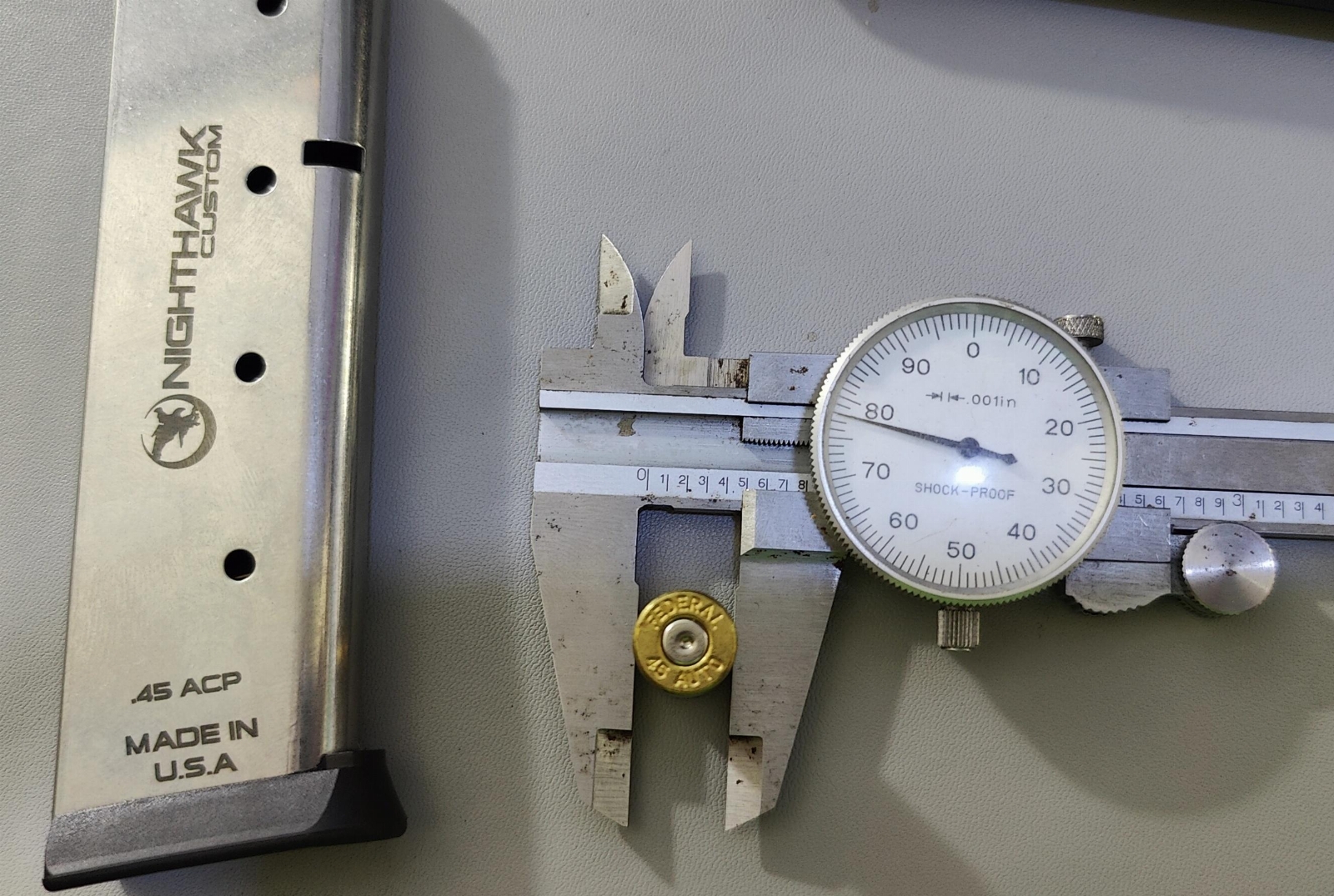

@Charlie207 posted a few pics in this thread. The restrictor is a small orifice built into the radiator fitting for the small return hose going to the surge tank.
If anyone wants spent .45ACP brass for this mod, let me know. I'm happy to throw one or two in an envelope and mail them to you.
OD post-fireforming looks to be 0.478" which fit snuggly, but easily, in my GMT900 overflow hose.
I'll let you drill it out to your preference.
