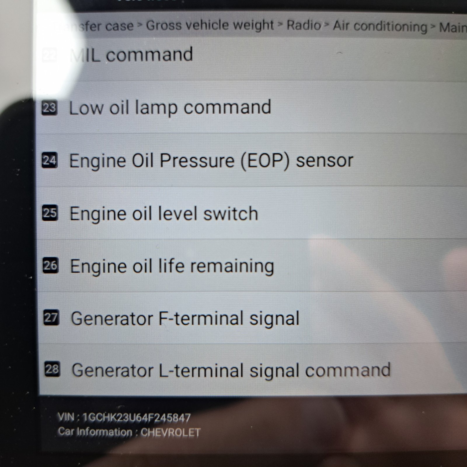

I have been seeing the odd oil pressure gauge reading for a couple days. Was completely normal. I think the problem is a stepper motor. If it is, I will just get a new cluster from Digital dash solutions. I have a Foxwell NT710 scanner that will graph oil pressure readings. The graph is from 0 to 5. When I start the engine, it idles around .5 and you can see what happens when I rev it on the graph and at the gauge. The lowest the gauge reads is around 40 psi and then does climb while driving and if accel hard enough, it goes past 80 psi. When engine is cold and KOEO, the reading is around 40 psi.

@89Suburban, it is gonna be a stepper motor and therefore I am going to customize the dash cluster at Digital Dash Solutions.
I sent the pic and the video to them. They were asking questions and a pic/video says it all. No engine noises though.

You could pull the custom cluster from your Tahoe and install it here to see how it acts.
Have you thought about disconnecting the connector on the sender to see what the gauge does then?

Ok, I did the dash cluster swap from my 2005 Tahoe Z71, with a transmission temp gauge, in to the dash of the 2004 K2500HD, with the transmission temp gauge. I hope the videos come up right. The first video is supposed to be the Tahoe cluster showing it is working the way it is supposed to work, while plugged in to the 2004 and then the bad cluster back in the 2004.
Sorry, when I said that the OE cluster went to "10" with Key Off I meant 20 psi, but either way, It is not acting like the good cluster out of the 2005 Tahoe.
Also, sorry, I did not hook up my Foxwell NT710 to graph the oil pressure voltages. I was doing all this with the sky pouring down rain and I was ready to be done. But, the videos back up my stepper motor theory.

The first video is good, but the second one is marked "private."
Looks like a stepper motor or cluster issue. Good oil pressure.
