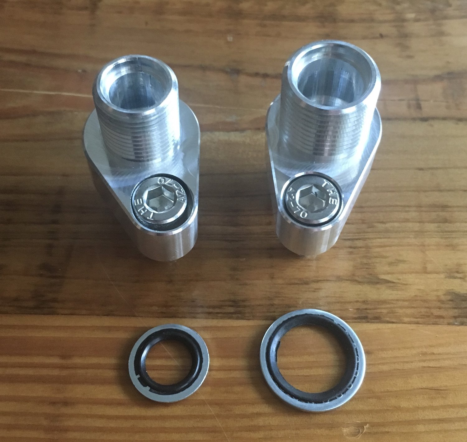

That connects directly to the compressor, how would the adapters work?
changes over to hose with oring hose ends, one of these (bigger one) goes onto compressor with stock type sealing washer

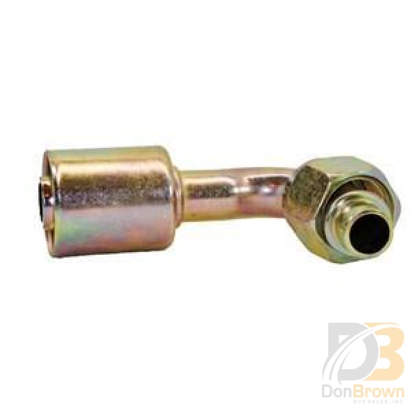

I believe so, we used it on buddies RX7. What hose you buy got a link?
i get a lot of stuff from https://donbrownbusparts.com/pages/ac-heating-parts it has been the best website ive found being completely clueless about most of the parts.
would have to see if you use the same hose in those crimp fittings.
fittings are sized similar to an 1/2=#8 , 5/8=#10, 3/4=#12 for that return hose youll need #10 or #12 hose. the adapters for compressor and drier will probably be #10
so youll need 5/8 FO (female o ring) x #10 hose :
looks like this should be hose for "beadlock" fittings #10:
