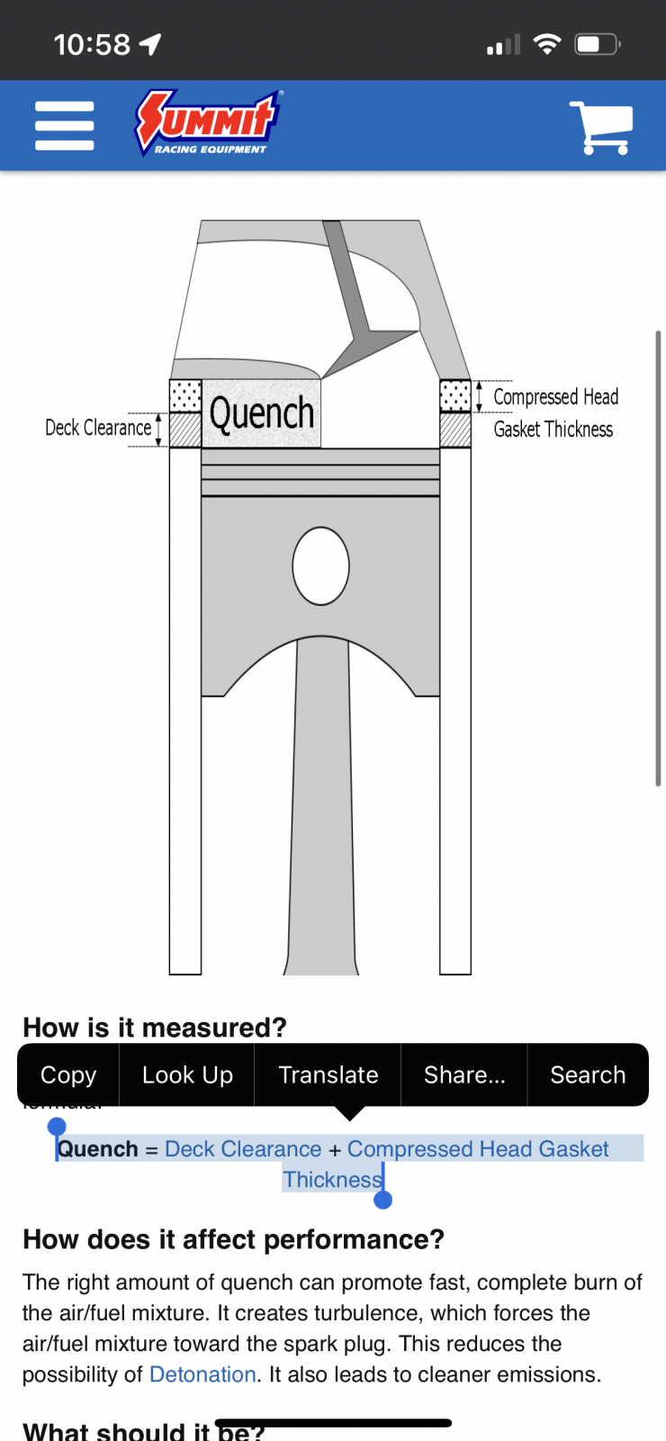

Ok ok hang on, so summit says it’s clearance plus gasket thicccness. If the deck clearance is +.008 wouldn’t that be .008+.041=.049?
Or because it’s positively out of the cylinder, meaning sticking up like a hard ****** .008 that means you need to subtract it because it obviously makes the quench volume less. Meaning .008-.041=.033/danger. I think this is correct and is what my initial thoughts were but then the summit wording got my panties in a bunch.
So if that’s the case the .041 gaskets are probably too thin to be safe but your saying I could check with modeling clay how? Put the heads on with clay on the piston and turn the crank over sinking the valves into the clay and then pull the heads off and measure compressed clay thicccness?
Thank you for your patients kind sir.
You have NEGATIVE deck clearance when the piston comes outta the hole. So, you subtract .008" or whatever your clearance measures out to be. I have a bad habit of calling it "piston height", which is not technically correct. Piston height is the measurement from the center of the pin to the top of the piston.

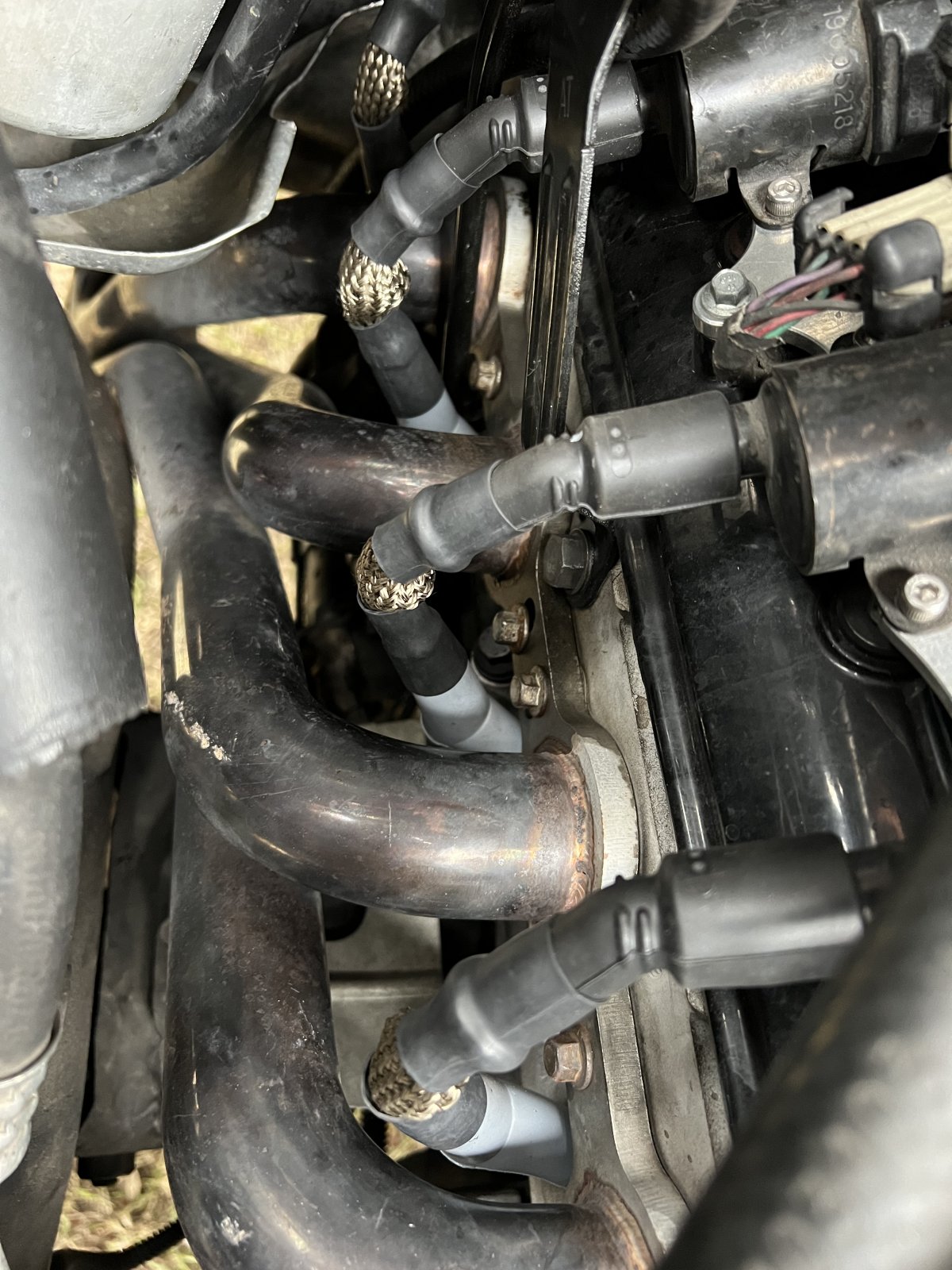

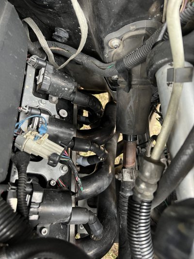

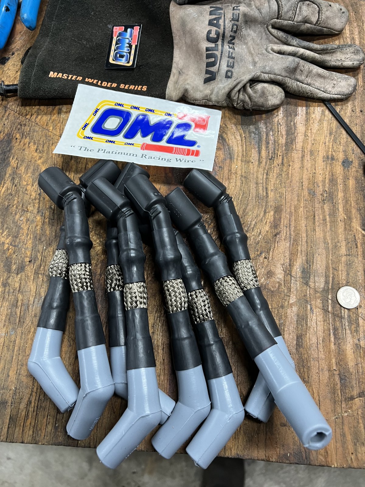

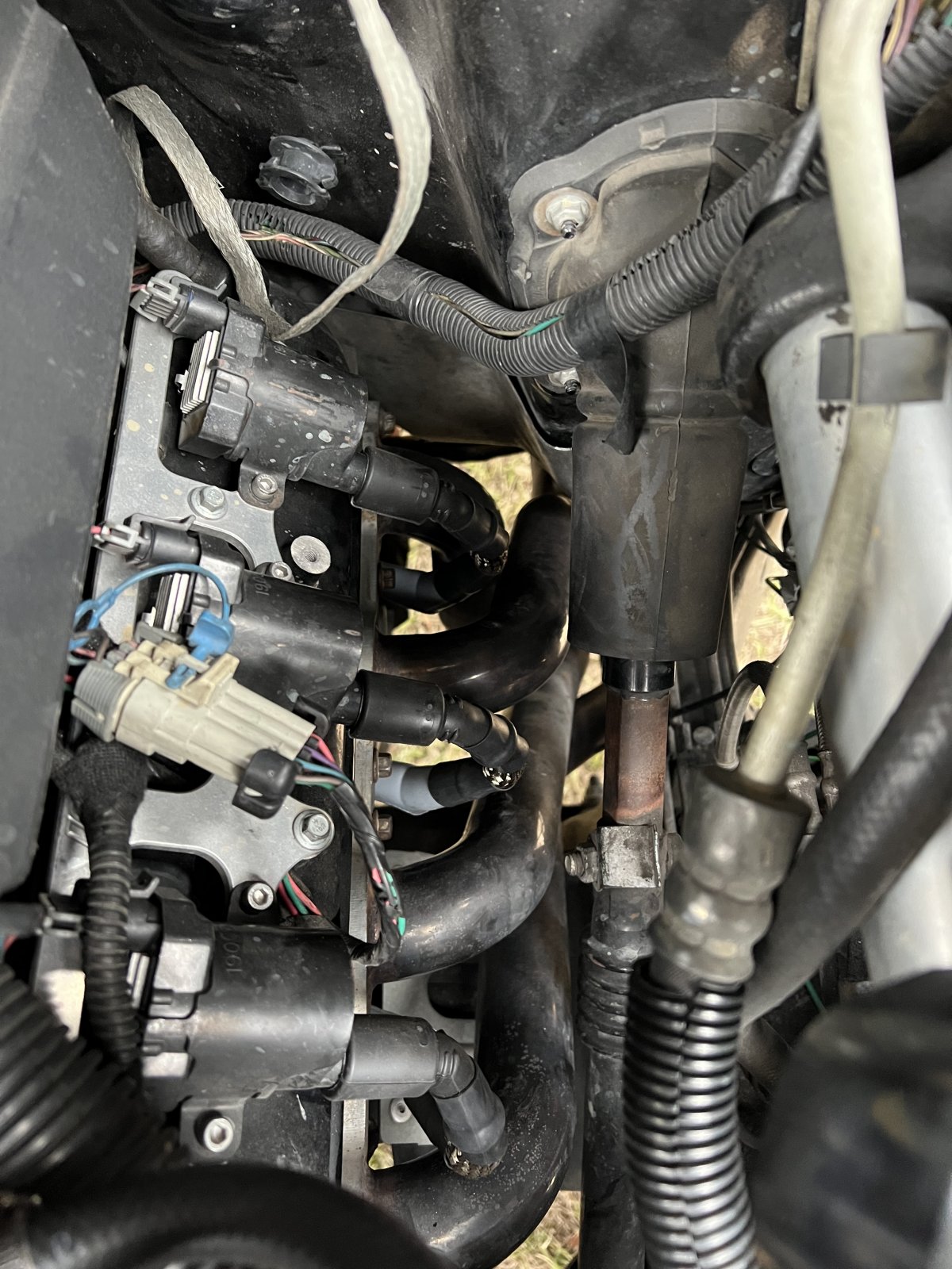

These plug wires are super nice and fit the round coils perfectly. No more wire burning for me!

When I bought those I was finally confident my burned plug wires were a thing of the past. Glad you like them. They’ve worked perfect for me, going on 2 years I believe.
First set of wires that don’t touch anything except the thing they are plugged into! Plus they are just really nicely done I’ll get a set for the RCSB as well. Thank for the tip! :beer:

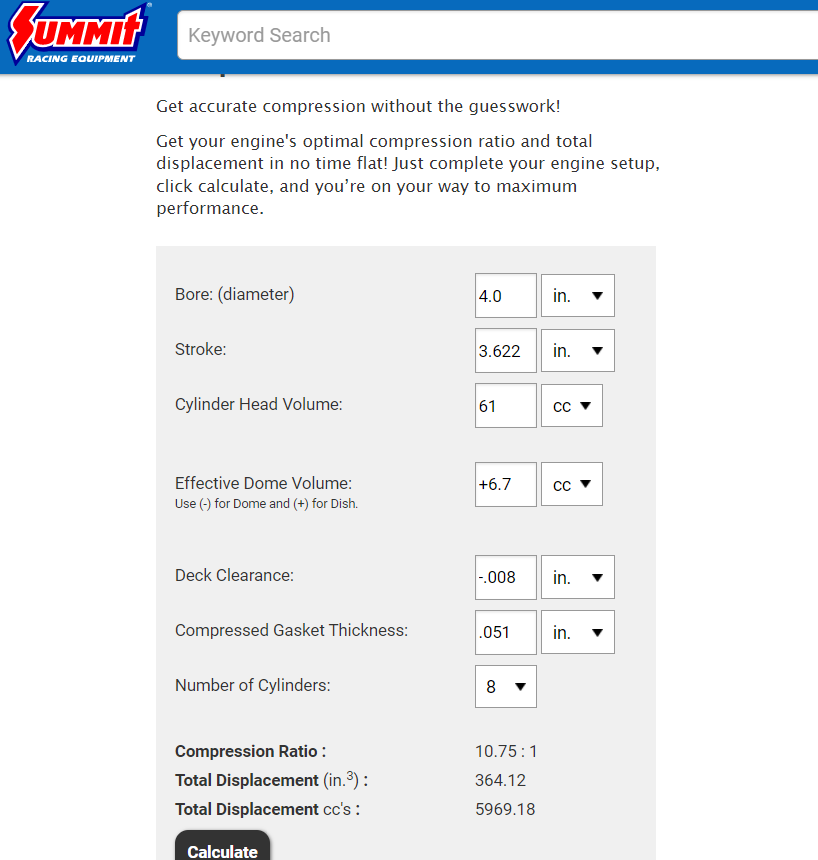

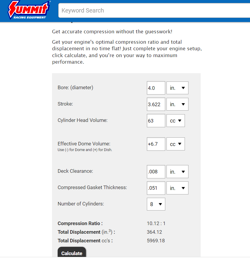

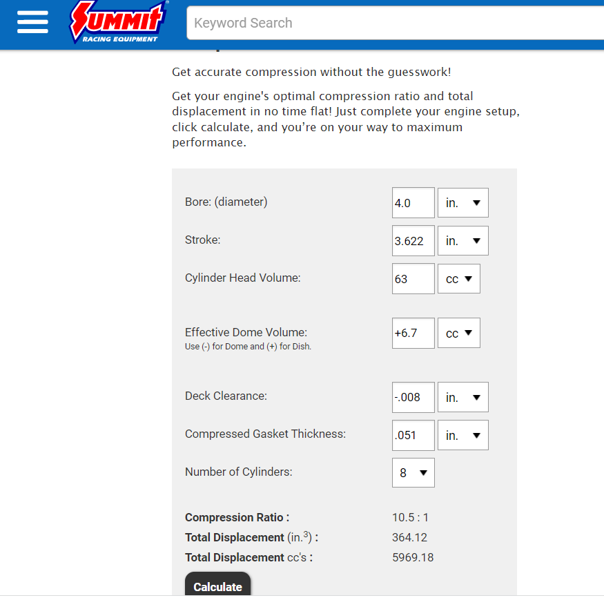

While overthinking this head swap again I ran some more numbers through the CR calculator and realized I may have been using the calculator wrong before. On the deck clearance box, I was putting a positive number thinking that since the piston is out of the hole .004-.008 it would want a positive number to calculate correctly. Well, I just put it in as a negative since having the piston out of the hole would obviously subtract from combustion volume and increase the CR and when I did the CR went up. So previously I was looking at 10.16cr if I used .051 gaskets and input the number as a positive. If I put it in as a negative I end up with right at 10.5:1.
If this is the case then the current setup runs a 10.75:1 which is more than I thought.
All good numbers. With that cam, your DCR is still safe.

I will probably end up putting on .051 gaskets to get close to 10.5cr in case I miraculously find some sort of Wuhan whirly boy to force-feed this thing.
