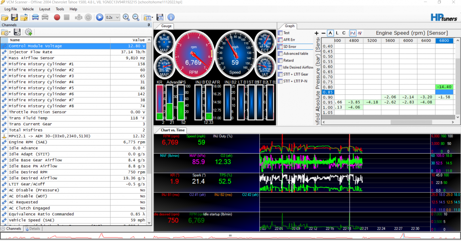

I got HPT to read over 6k but I wasn't able to see what the dash was reading at the same time, I guess I need to do a deliberate pull to 6,800 dash read out and compare it to the HPT log.
@randeez I sent you two new log files, one is a cold start idle warm-up with no accessories on and the other is my ride home with a couple of high rpm pulls in second gear.
it looks like it cold starts fine lol
the misfires look bad though, you make sure theyre all plugged in n stuff? wires pretty new? whenthe last time you checked plugs
the misfires make no sense to me I don't not feel anything every and the plugs looked great 2 months ago. The wires are kinda mismatched junk but I inspected them when I checked out the plugs and nothing looked bad, I did not OHm them out tho.
The cold start is steady but why does it start and initially idle at 16-18afr? The commanded is clearly 14.7 and eventually, it gets down to that but the first few minutes it's super lean and if I start driving during that period it usually swings even leaner I've seen 20s or it dives down crazy stupid rich like 9.
Maybe all this is related to some strange ignition issue like a bad coil pack causing misfires which throws everything else off? Maybe I need to nut up and buy some decent plug wires for once.

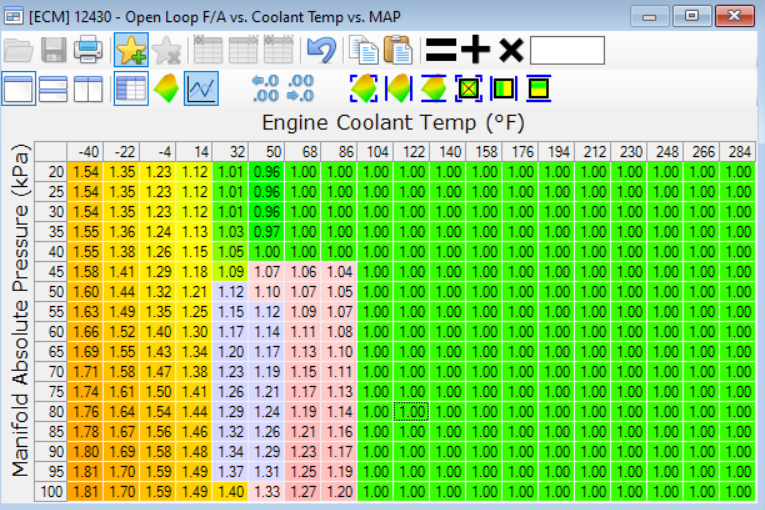

if youre using pump gas (E10) set the stoich to 14.10840 under fuel>general>stoichiometry
it starts (the first couple seconds) rich. you can stretch out the table under fuel>open loop/base>eq ratio over 68* its calling for 1.0 eq (no adder) when you start it over that temp it wants to dump right into 1.0eq. maybe stretch some adder to 100*+
Stoich is now set to 14.1 what do you mean stretch the table out? You mean ad some gradually going up in temp so at 68* maybe make that 1.03? or subtract some making it .97?

I would copy the three cells with 1.04, 1.08 and 1.12 and move them over to the 86 column (same row)
at the bottom of the 86 column i would put it in like 1.2. then smooth from the 1.2 up to the 1.12. and then smooth it back to the 68 column. let me know if that makes sense
since your map is pretty stable at 50-55kpa that is where the most of the warm up eq is going to be. but if truck is off (100kpa) its going to run along those cells for first second or two till it gets there. the 14.1 stoich value is going to richen up the adder also (and will prob make your wideband display more accurate.
before you were telling it all fuel was a stoich of 14.7, when in reality E10 is 14.1. so if youre targetting E10 @14.7 youre lean. hence the wideband showing lean @15+ after it comes up to temp. the wideband doesnt "read" in air to fuel ratio, it reads lamda. and just spits out a display based on what scale your using gas scale is 14.7=1
Makes sense, I had heard about that 14.1 stoich value before but I guess I didn't absorb enough to make me do anything about it. The above post has more usable info than 99.96969696969% of posts on the HPT forum.
Everytime I learn something new
Hows this look Daddy?
yep, try it an see...should hang the afr a little richer, longer. "colds" starts are still 65-70* right?
theres the table to the right that says startup decay or something like that. im wondering if that table holds the enrichment value that you just rised for that duration. as long as it hits the cell or if the decay is a stop for it only allows it to work if its in the cell for that time. but may play with that one after if it stays rich for too long

log whether its commanding closed loop or not also
Roger, closed-loop active channel added.
