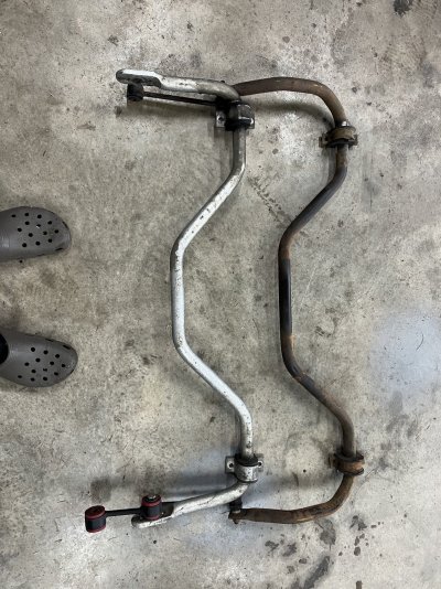

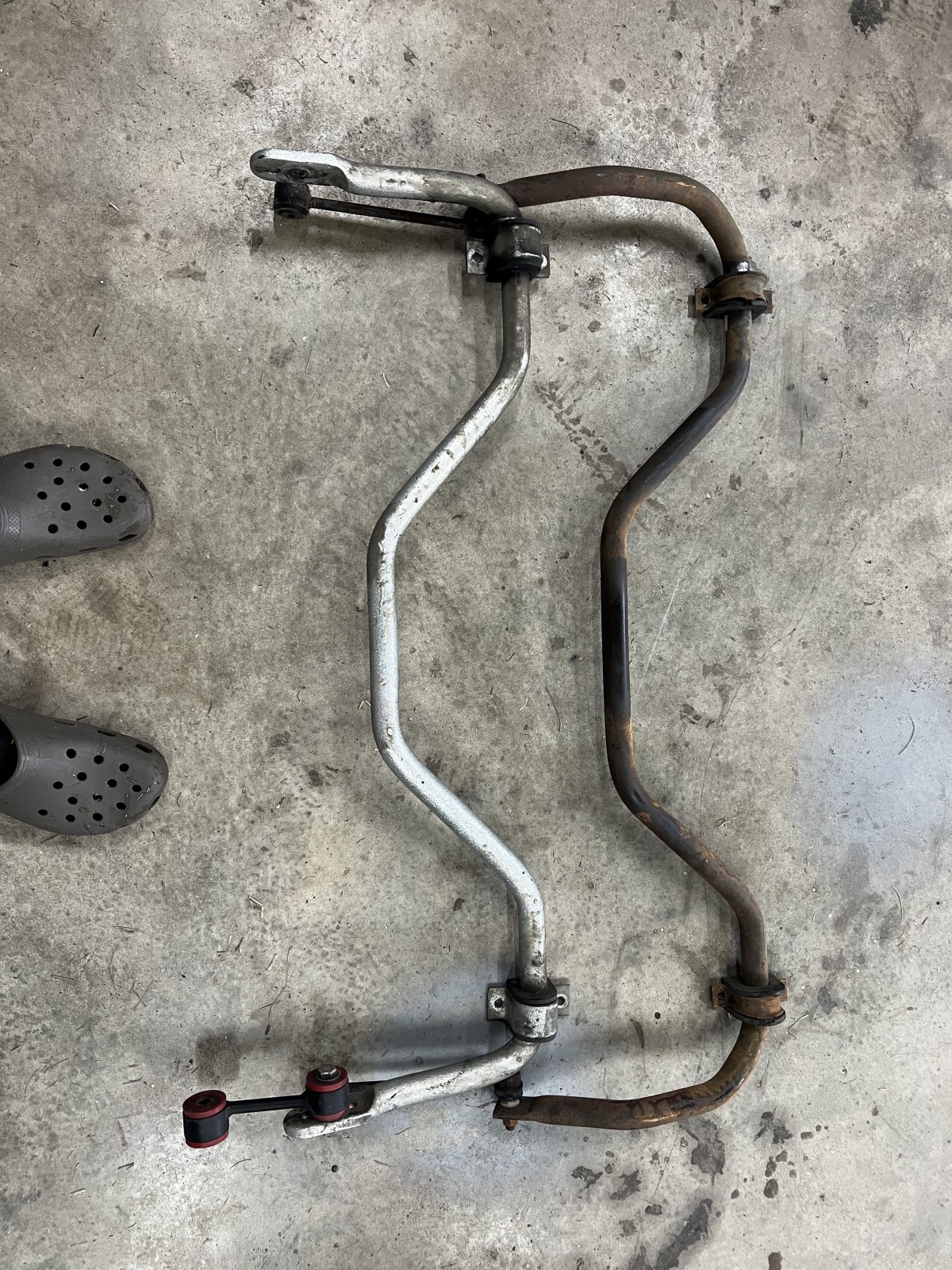

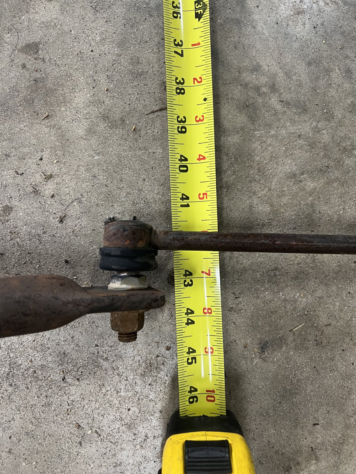

Not sure what other measurements you really need, the one with the tape is end to end distance. They are both the same thicccness but the hellwig is solid and the H2 is hollow.
That width is my main concern. Thanks for getting that and the side-by-side pic. I'll compare my Hoe when it stops raining. :(

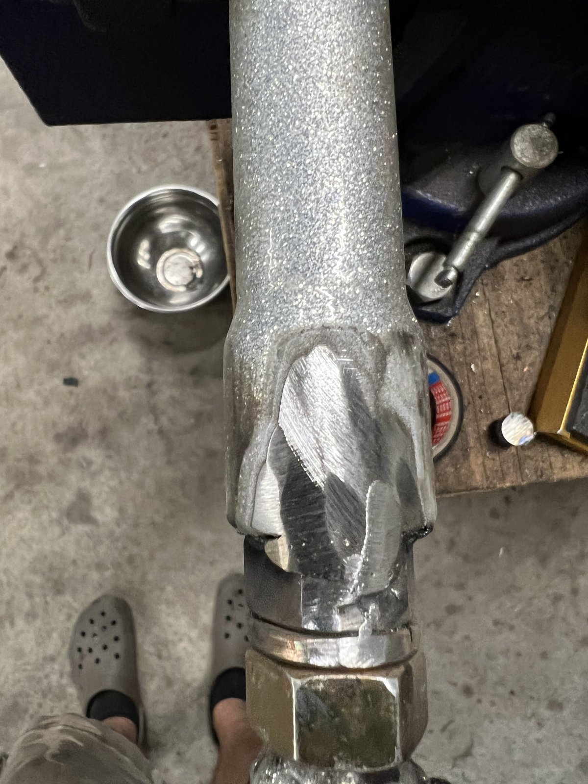

Fixed my endlink issue hopefully for the last time! To refresh everyone my Hellwig links had a female end fail by having the threads basically strip and with a small amount of force it would be able to compress and skip past the threads. Then I switched to the DJM endlinks but instead of moving the whole bar over and yada yada I just didn’t and an endlink broke I think when I snatched the amazon guy out of the sand a week or two ago.
So I went back to the hellwigs and added 2 nuts sandwiching a lock washer and welded the female half of the link to the lock nuts hopefully keeping it from moving freely. The welds look like shit because my argon bottle is below 100psi but I ground it down and it appears good enough.
Somehow I only took one pic
