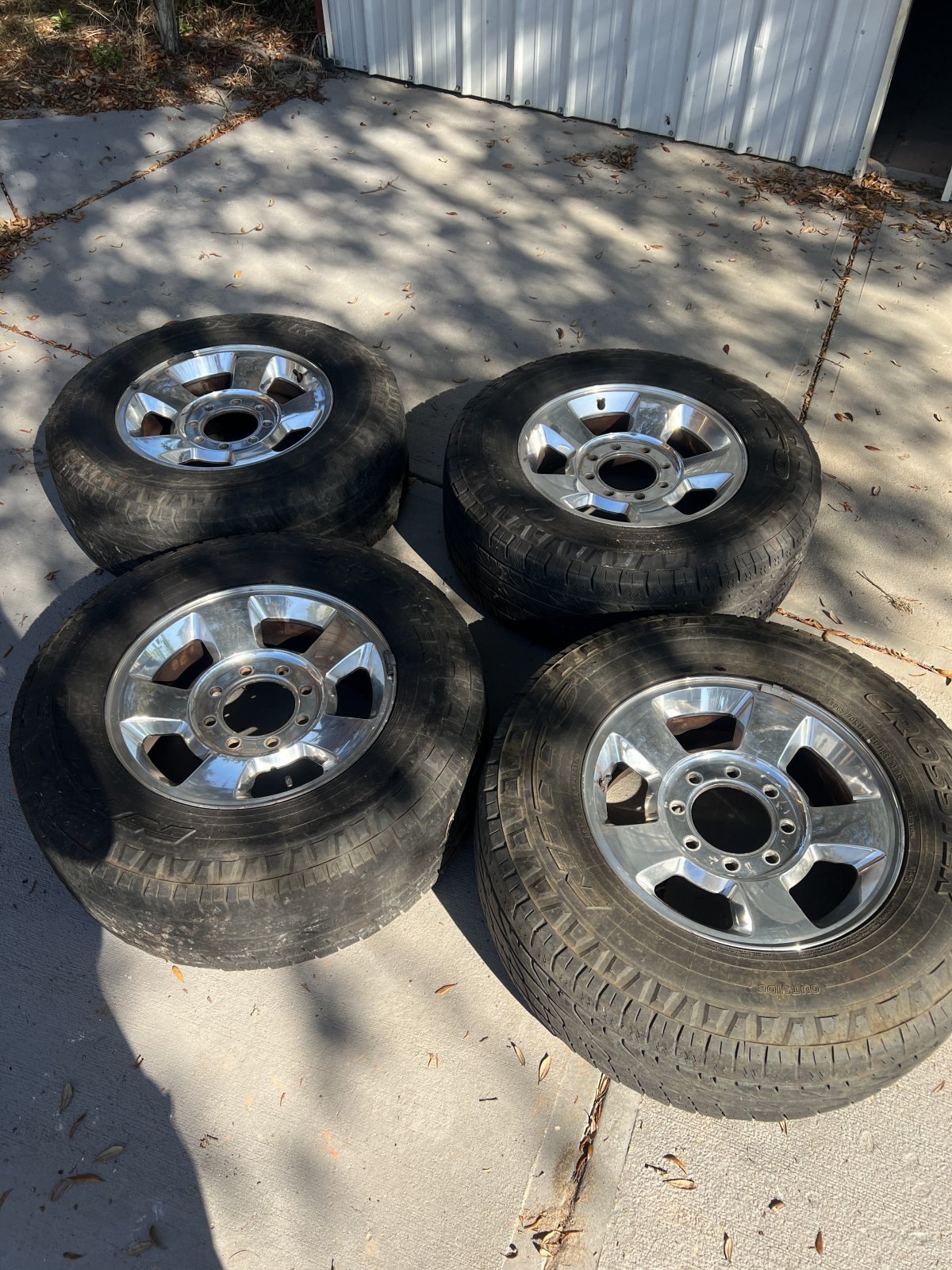

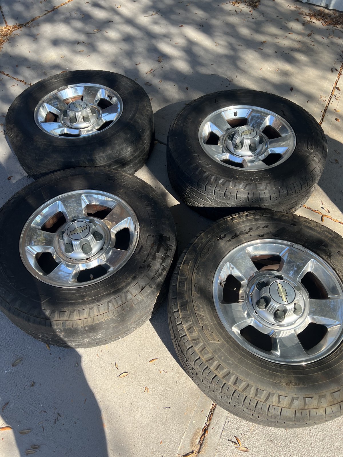

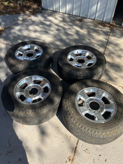

Here’s the new wheels I got.

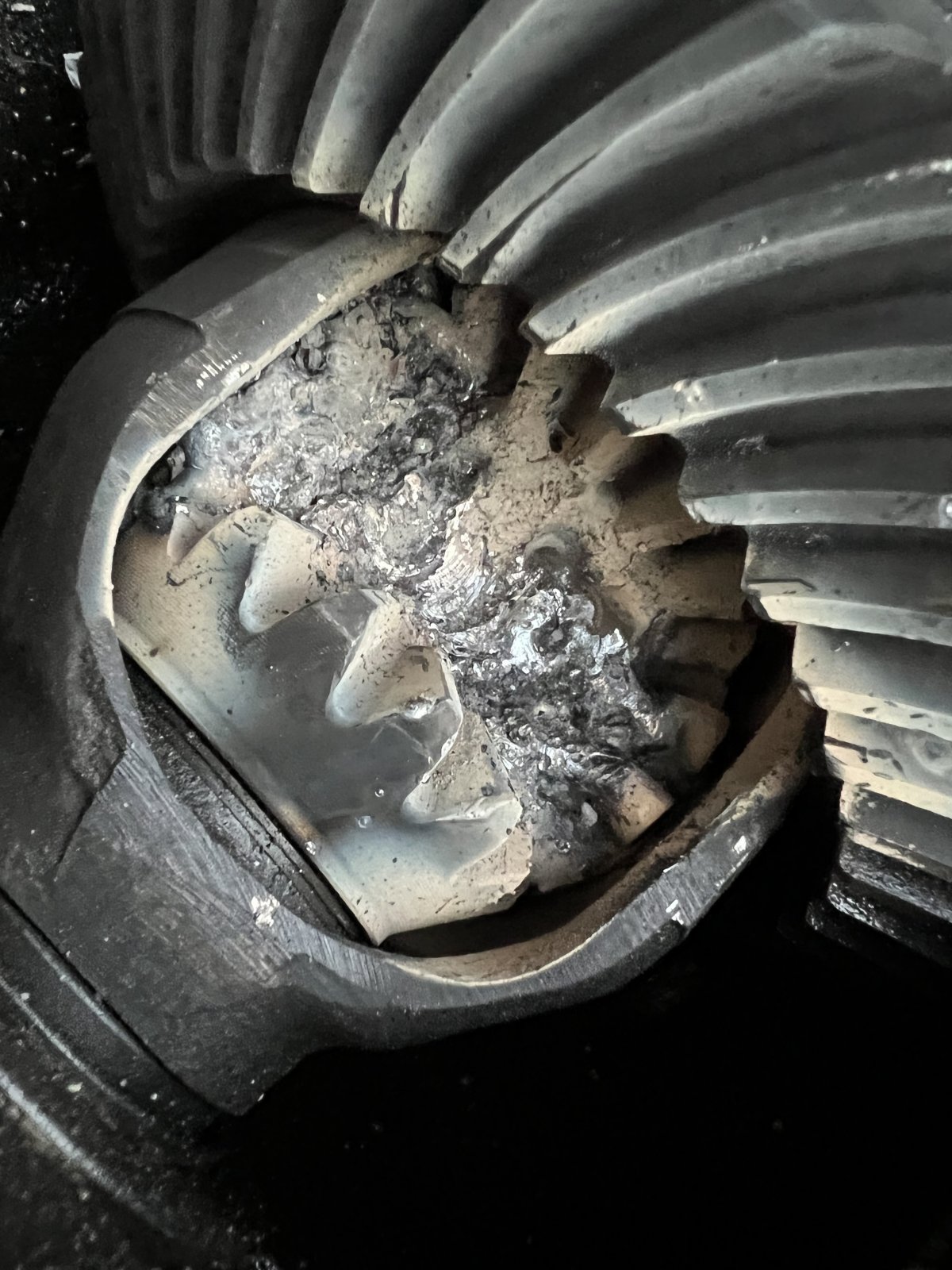

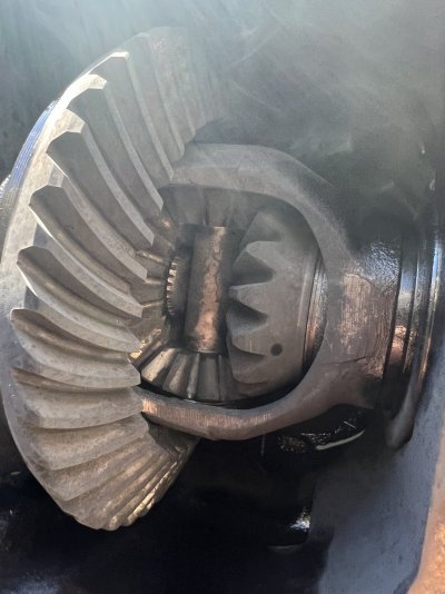

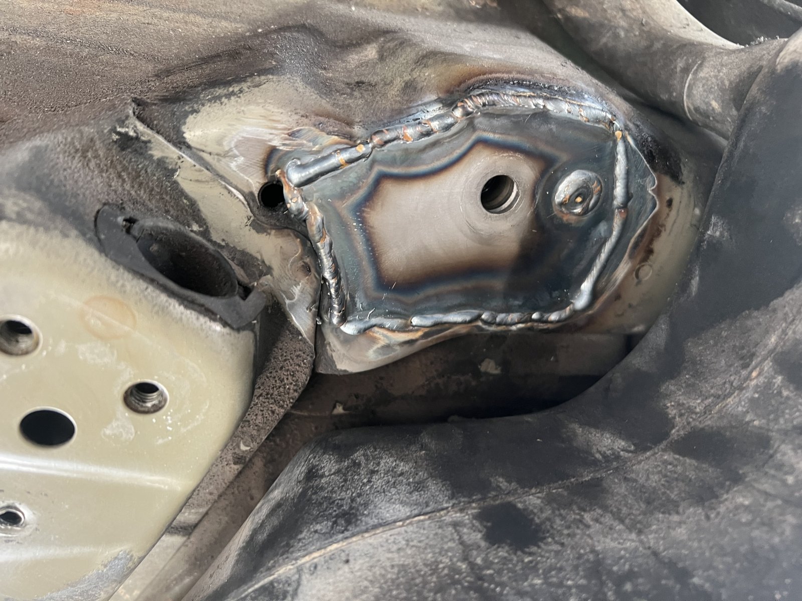

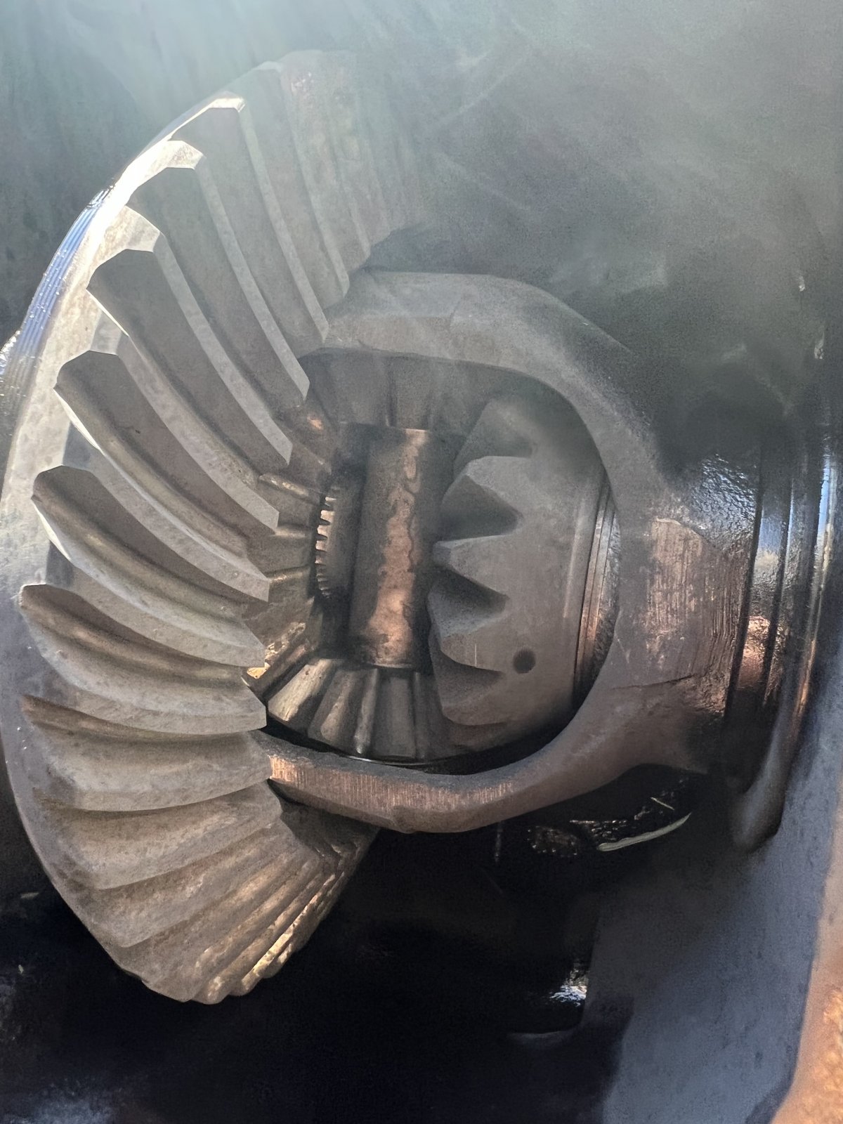

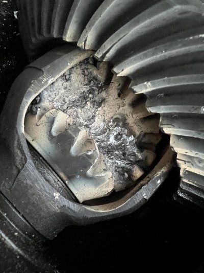

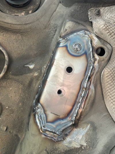

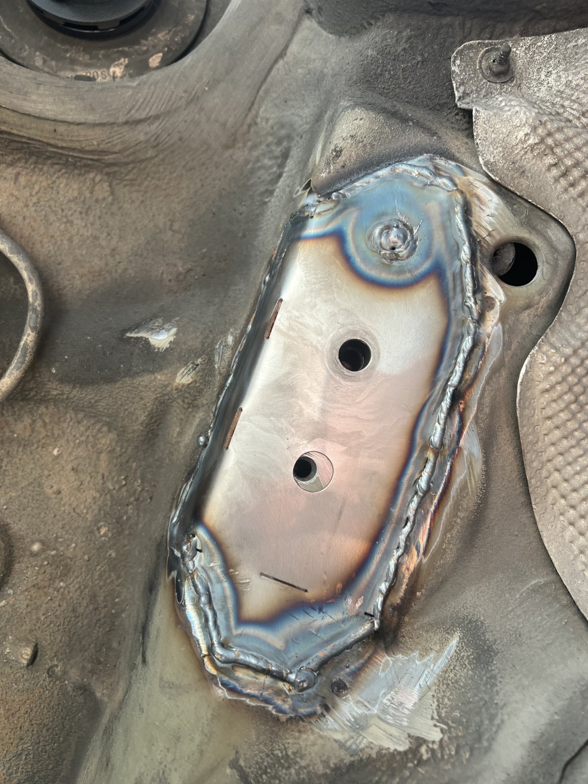

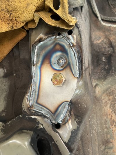

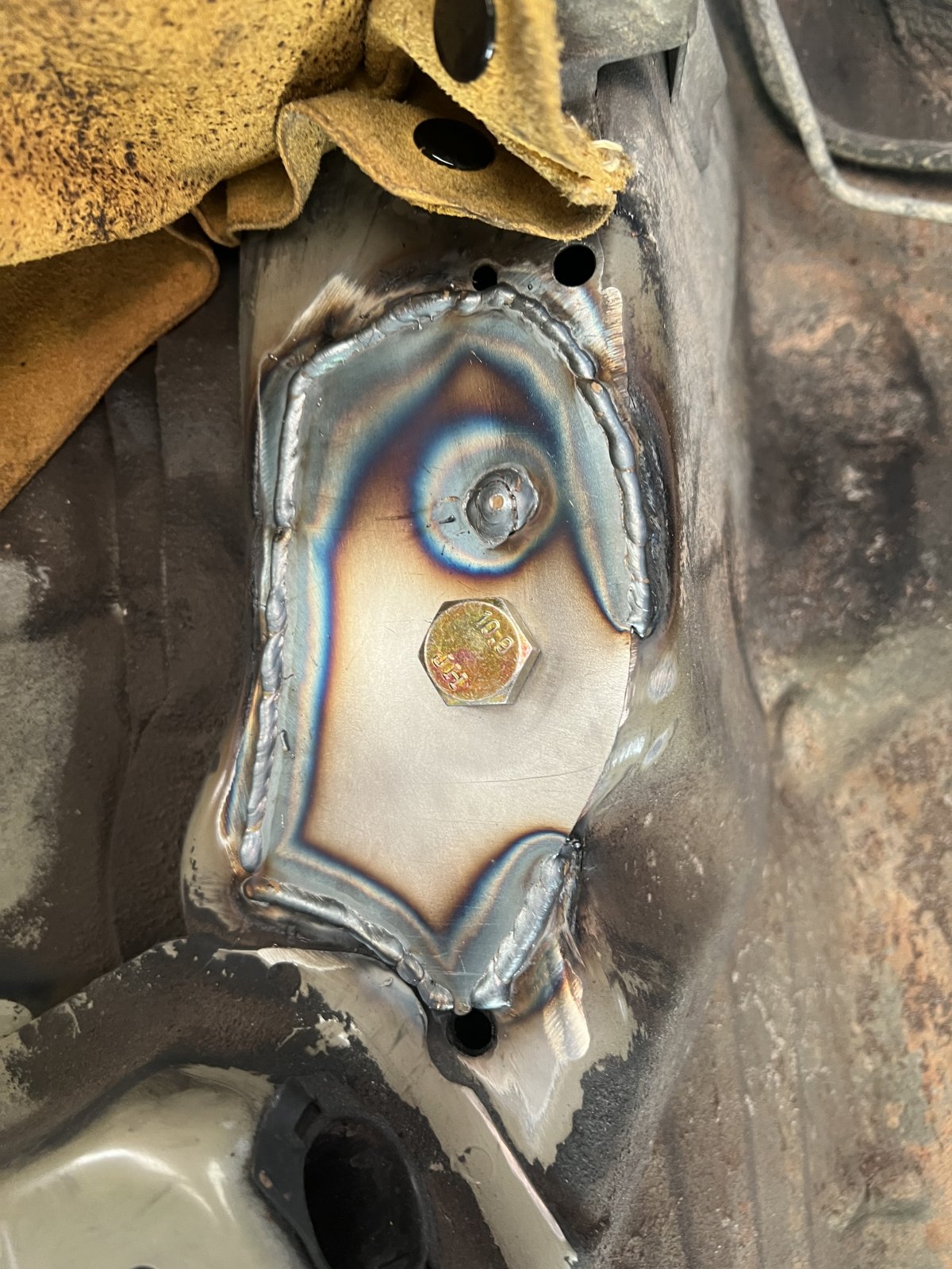

Did some weld jobs today, the diff is cocked and locked now and the other plates are subframe bracing. Did the diff with my new everlast machine using 7018 rods at 90amps and the plates is my little Hobart turned down about as much as possible for sheet metal. Could have used less wire speed to flatten the mig welds but he’s gonna grind it and paint it anyway.
