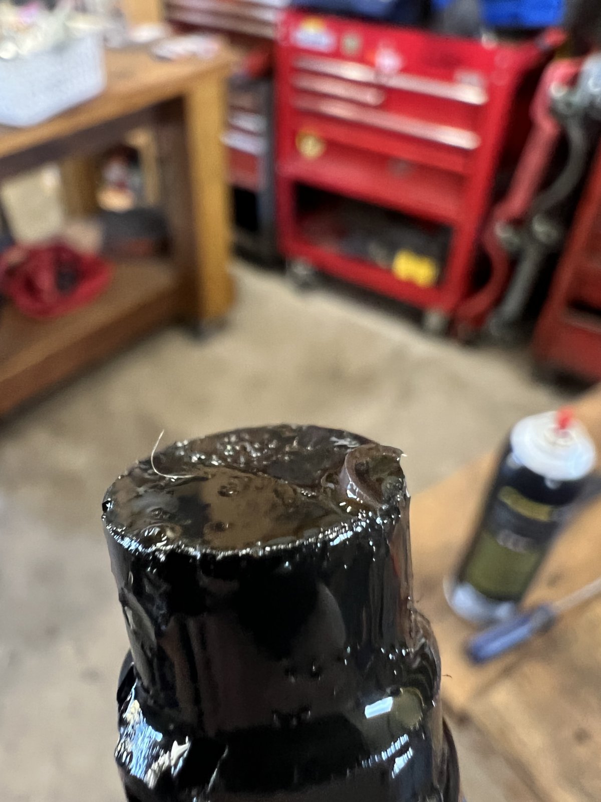

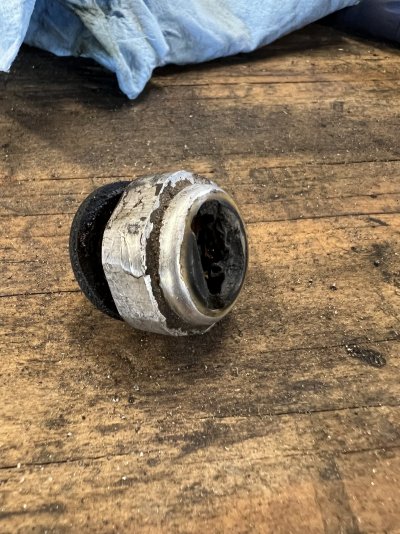

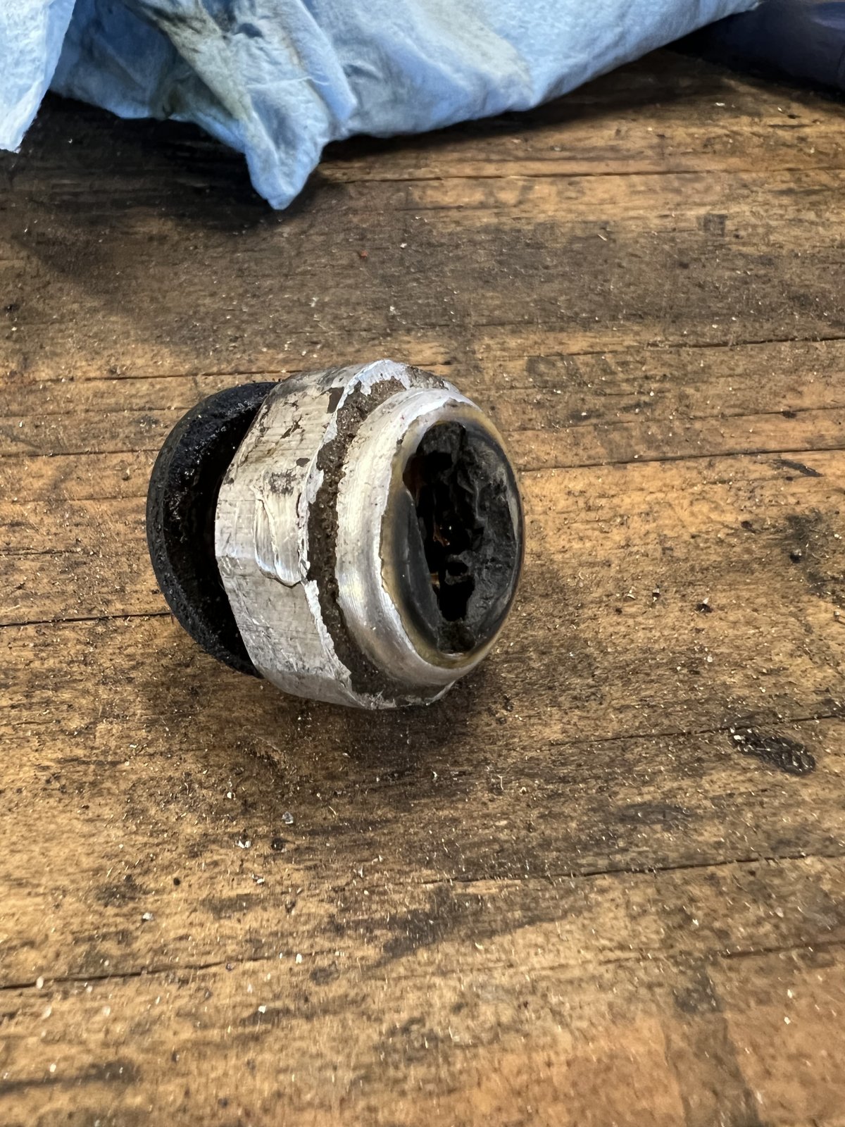

Curse my giant hands! While giving the cam sensor the reach around I somehow broke the oil pressure sensor. Gotta wait till after turkey time to put it in and hope the new cam sensor is better. This one I got from auto zone and it looks to be better quality than the AC Delco OEM replacement I put in a month ago. The AC Delco has china stamped on it and the plastic has molding marks that look cheap compared to this autozone sensor. Also not sure what this finger nail looking sliver is that was on the tip of the old sensor when I removed it but maybe it has something to do with it. The sliver appears to be plastic.

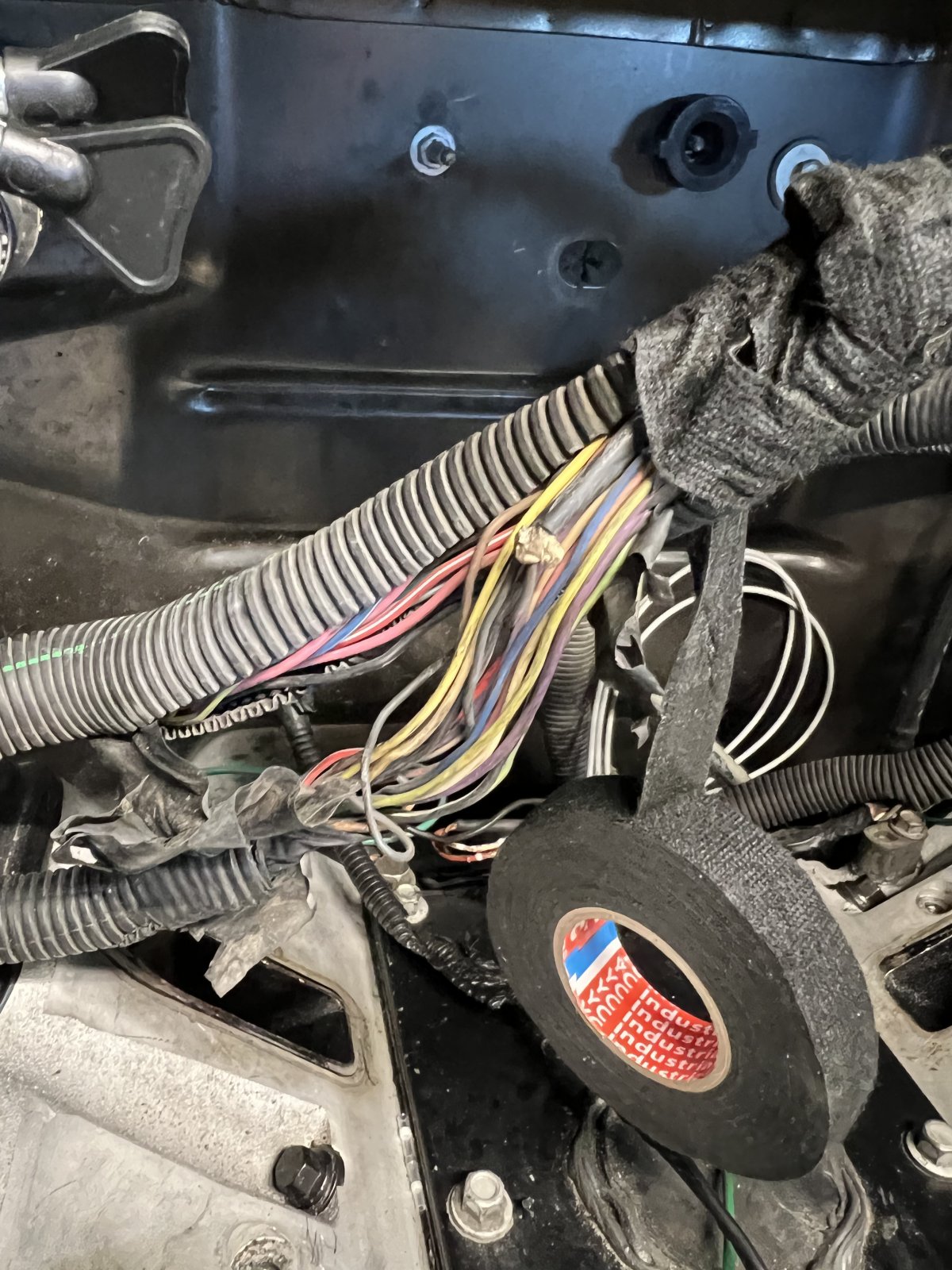

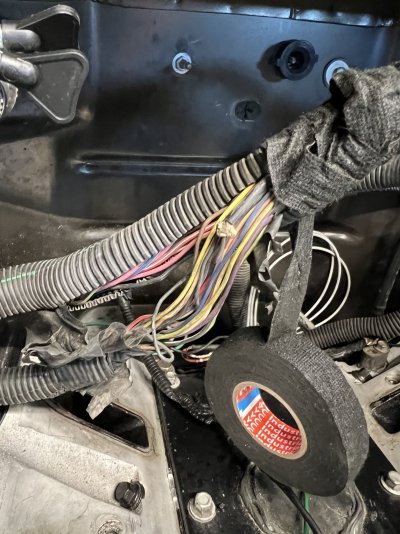

This is very frustrating I wired in the new pigtail and put everything back together. It only takes me about 5 -7minutes to remove or install the intake with my M12 ratchet. Got it back together and the truck started right up! With a check engine light saying cam sensor voltage low……. First time it’s had a cam sensor code since the very first time it started funny over a month ago. I cleared the code and shut off and restarted the truck multiple times with no issues except the cam sensor code keeps popping up. Even went for a drive during which is shut off and restarted the truck multiple times without any cranking issues.
Not sure what to do at this point, maybe because the pigtail came with an extra foot of wire and I left it full length the extra resistance is causing the code to pop up? Maybe I should just turn off the SES light with that code on HPT? Or maybe I need to mess with it even more …..
I did spend some time and cleaned up my harness by wrapping a bunch of stuff with that cloth like tape @Rocket Man suggested. That stuff is super easy to work with and no icky sticky.
Sorry no good pics.

You sure you have the polarity correct?
I triple-checked by referencing a picture I took before I snipped it off. I will be pulling it all back off this weekend to quadruple check tho. I love that the new connector came with all three identical grey colored wires.
