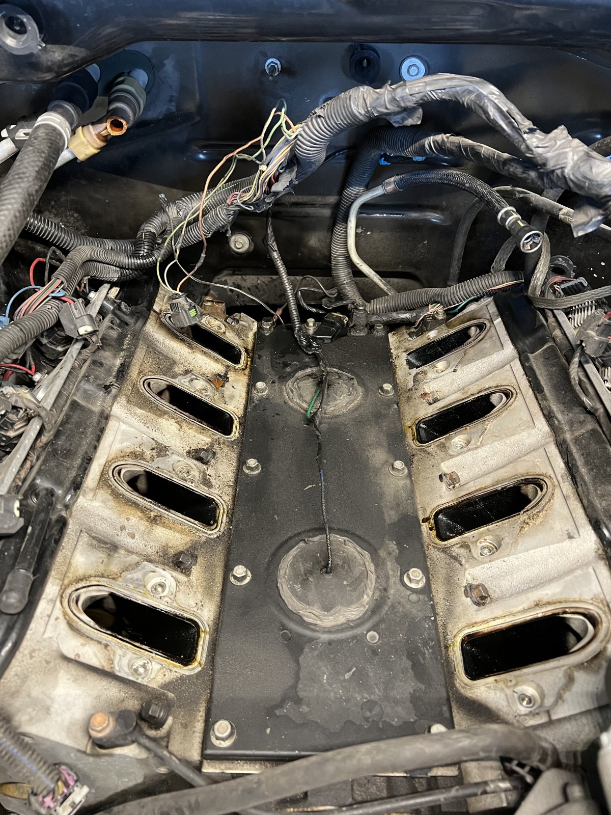

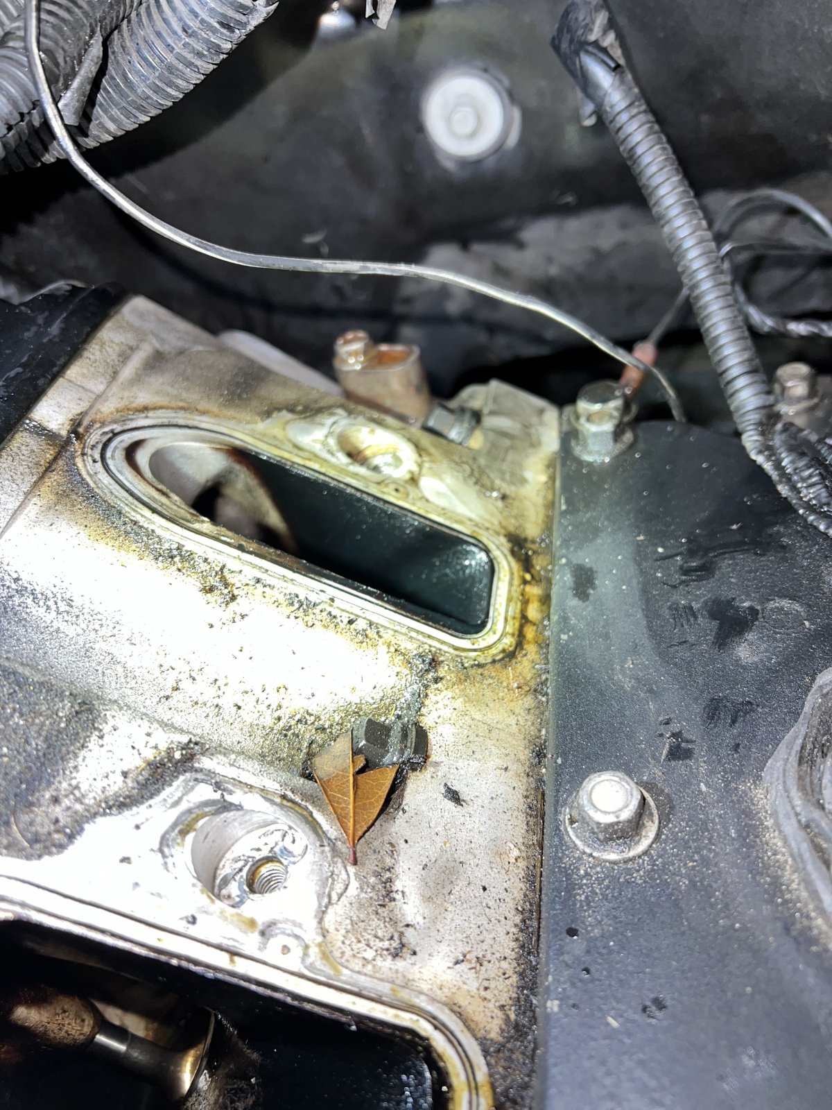

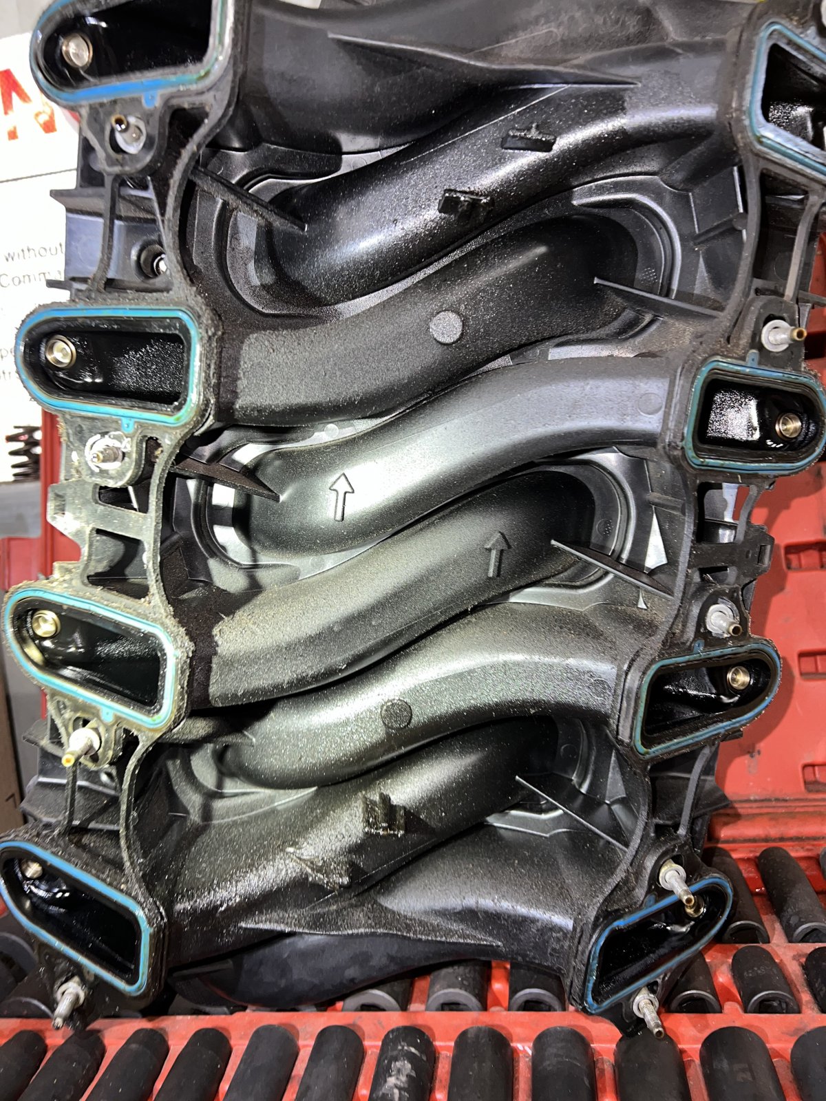

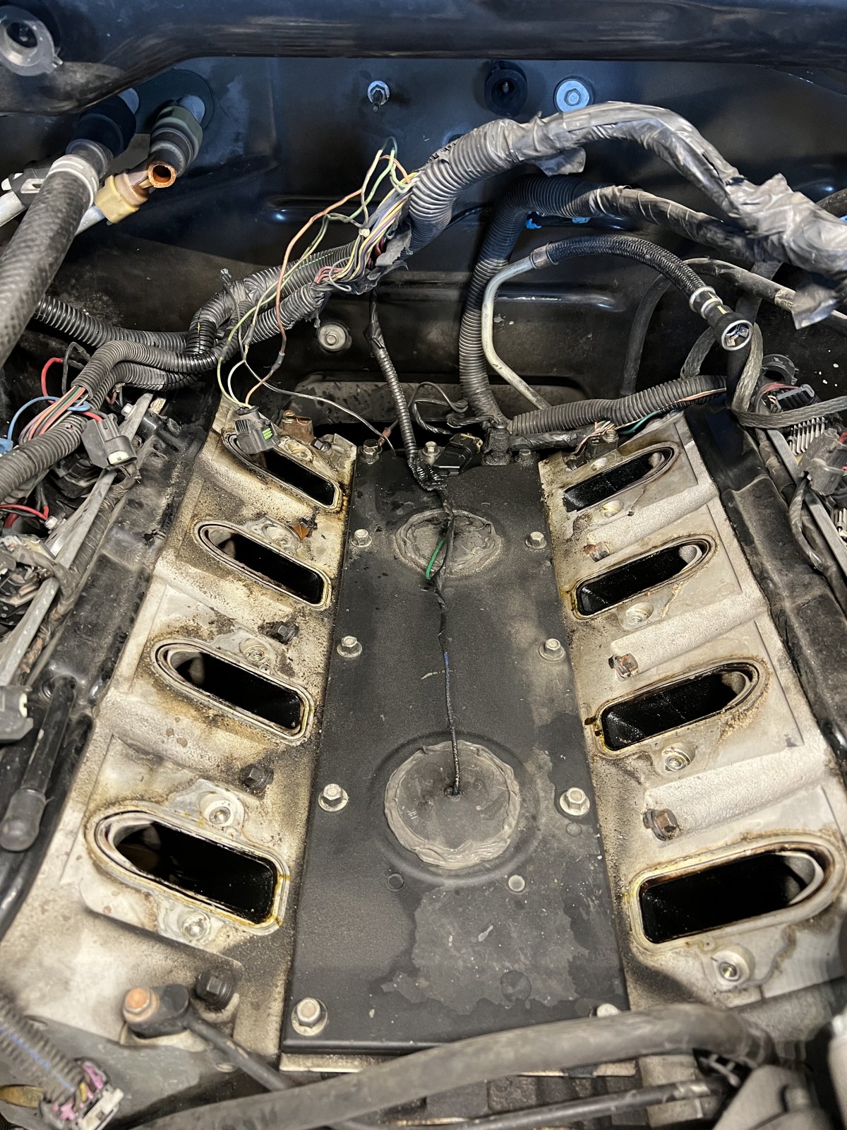

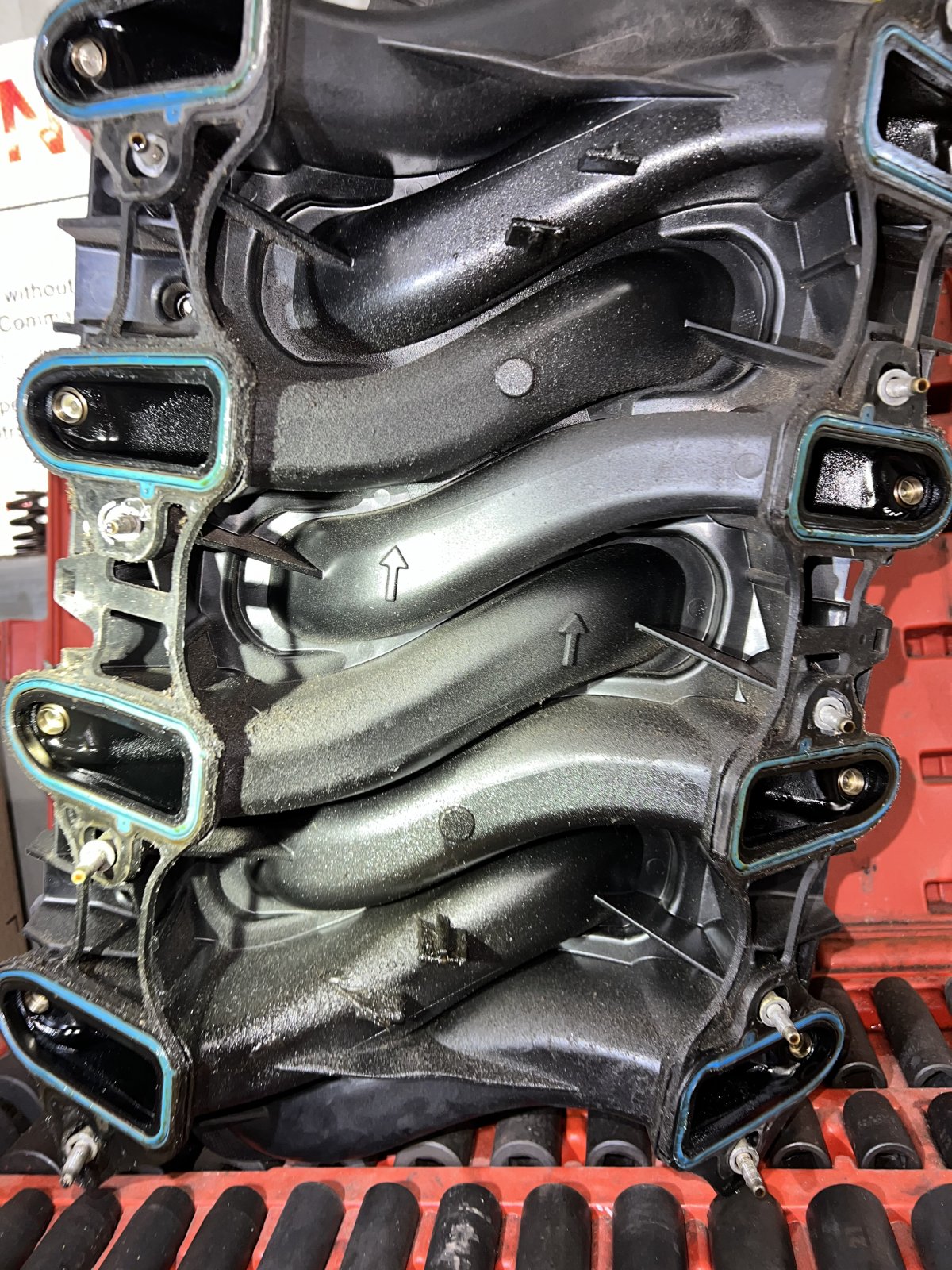

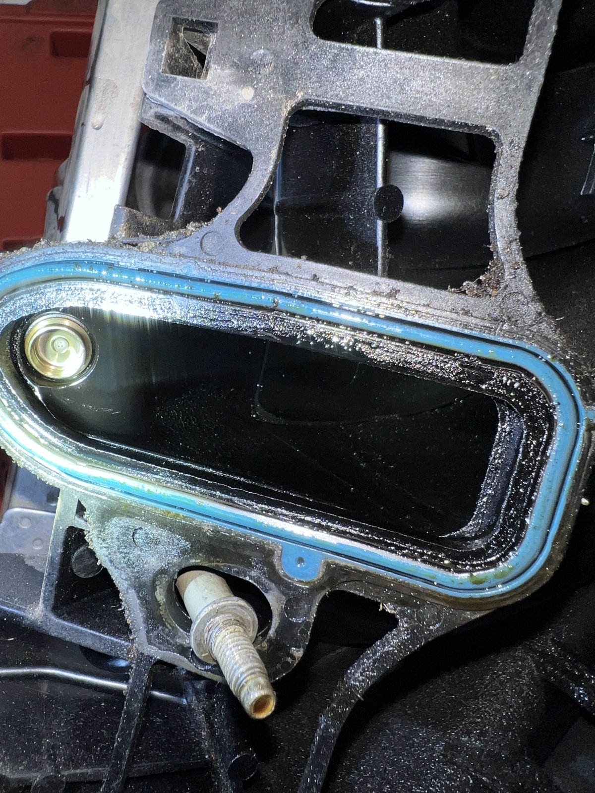

Pulled the intake to inspect stuff and noticed what seems to be excessive oil around the intake ports and valley. Going to order a new valley gasket along with intake gaskets and install new injector Orings while I’m there. Contemplating running a second $20 catch can in line with the current $20 catch can to reduce the oil going into the intake because I can see the line going to the intake from the catch can is wet and oily inside.
Pulled the plugs as well and they all look good except #6 was kinda oily around the threads and all of the gaps had opened significantly to around .060 or more which could have significant effects on startup! I typically have them at .044ish, so I closed them back down.

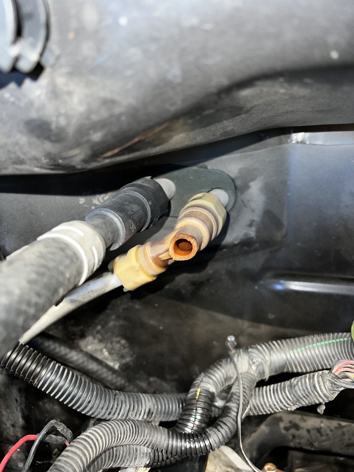

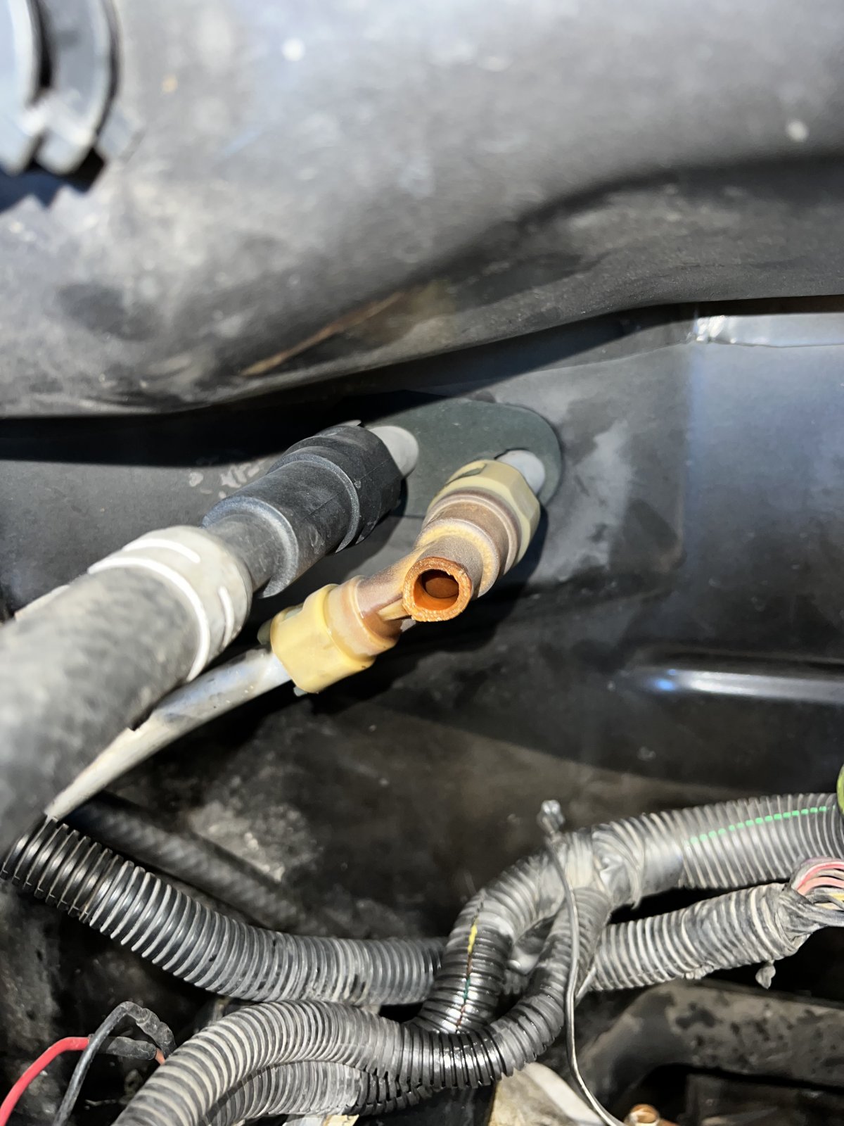

Lastly my dumbass bumped the heater connector at the firewall and of course it broke so I gotta find the best solution for that. I would love a metal T with hose clamps if anyone has a link to something.
52,956
View attachment 354261View attachment 354262View attachment 354263View attachment 354264View attachment 354265
Just put an OEM T on there and you’ll be good for another 150k. That one looks original.
Is this Dorman replacement considered OEM or should I get the clear/white colored replacement?

No do NOT buy a Dorman. Replace both of them also. GM Genuine 15055342 and 15055343 , one is black and one is white. The angle on them is slightly different from each other.
GM still sells them and they're very reasonable in price. Broke mine a few years ago leaning on it trying to fix something else. Of course coolant was hot, and it actually gave me blisters on my hand. SWEET :mad:
Thank you for the part numbers! The search bar really sucks I tried multiple ways to search for info on them because I know I've seen it on here 20 times yet came up with nothing relevant.
Ouchy! The plastic when it breaks is sharp as crap too.
+1 on OEM ONLY for the plastic connectors. Also, since you asked, these are what I'm running: https://jagsthatrun.com/collections/cooling-systems/products/traditional-hose-tee
What size 5/8 on all 3 right? I may just get some brass Ts and hose clamps since I already replaced the lines with nice silicon hoses.
Lots of high-dollar cans are set up to VTA like the mighty mouse I have for my RCSB. The downside is you can often smell oil when parked and sometimes when driving and that gets old fast. I'll try it tho and see how I like it, if I notice a vacuum leak in a log ill report back. Either way I don't want oil in my intake anymore so something needs to be done.
If they were the same size on all three, then nobody would've had to push so hard to have anyone make special Ts for our rigs. We'd all just go to Home Depot for brass 5/8" Ts or order up some aluminum or stainless ones off Amazon or somewhere.
I'm not 100% about NBS, but mine was 3/4" off the firewall, 5/8" to the water pump and 1/2" to the rear heater. So, when ordering from JTR/Stealth, "Size A" would be 3/4", "Size B" would be 1/2" and "Size C" would be 5/8".
As the others have said, the OEM plastic ones are fine. But, if you do a lot of work in the area and are often at risk of cracking them, metal ones with hoses are much more forgiving. You'll just have to accept the aesthetics of multiple clamps in close proximity. I used constant tension clamps from GM, Honda and Ford (salvage yard digs) and positioned them all in line to look as clean as possible as well as easily accessible with long needle-nosed pliers.
Yeah I figured they would be different, so dumb they did that! I ordered two from your link they look supernice! I know I'll bump plastic ones again and again so might as well buy once and cry oncee. Thank you for the link!
