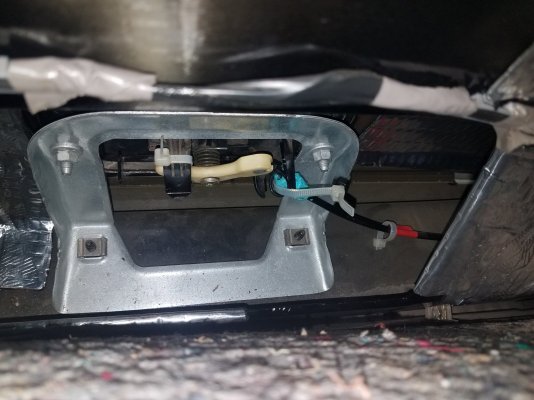

Here's a pic of the little clip that retained the cable that broke. It's really hard to tell without pulling the entire panel if it's part of the door handle or not. I have the old black textured handle assembly at home so I will check on that and maybe I will get lucky and be able to use part of it to fix my paint-matched handle. I also ordered a whole bunch of sounds deadening matterial because while I'm in there I might as well.......

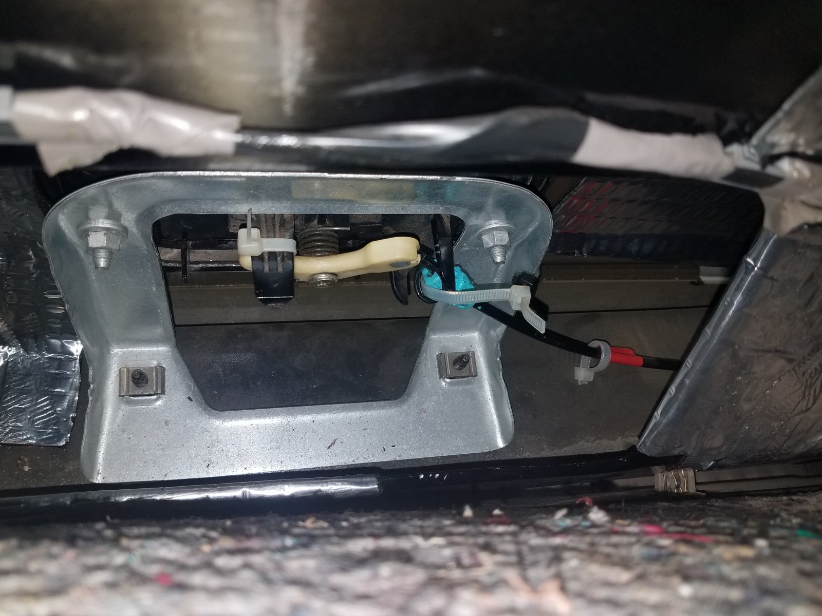

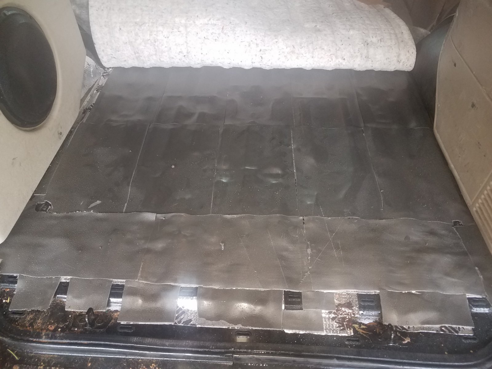

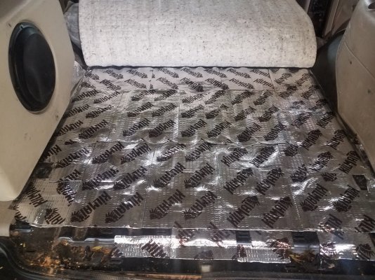

Looked at the broken rear handle and I'm unsure if its actually the cable not being pulled enough or if the actuator is worn out. That makes sense because the hatch nor the glass will open right now. Heres a video of what its doing.

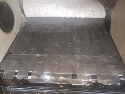

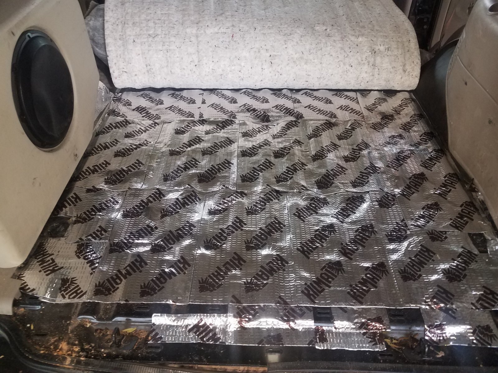

Also started on the rear hatch and cargo floor insulation even though the MLV isn't here yet. I forgot I had done some Dynamatt type product on the floor and a few small pieces on the hatch door before. Did another better layer on the floor along with some closed-cell foam from Norico that laid down incredibly well, the adhesive they use is seriously sticky. It didn't seem better yet but I didn't have the interior put back together or the MLV down either. I have enough insulation left to pull the rear seats and do the rear floorboard area as well however, I think I will end up putting small cats back into the system.

I think that actuator is just too weak to fully unlock so I'm gonna take a chance on a $15 replacement from amazon hopefully, that will fix my issue.

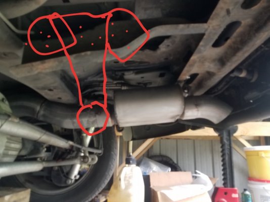

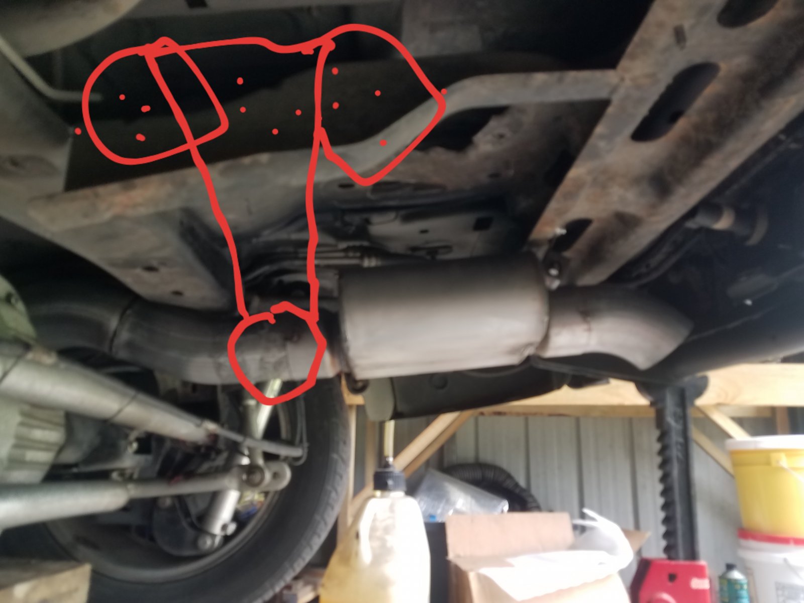

As for the exhaust, I canceled the order of the Vibrant merge pipe and ordered some 3" pipe to make a J tube with like @Sam Harris suggested a while back. I'm fairly certain the noise that's bothering me is pure drone because outside the truck the exhaust doesn't seem that loud. Inside is a whole different animal and it's most noticeable at low RPM like 1,200-1,800 even worse when I'm lugging the poor thing around in 4th and 5th gear at low speeds. So the plan is to do an 18-20" tube directly off the over axle pipe right behind the final muffler and have it hidden in the spare tire location. Should be fairly easy since the over axle pipe has a V band so It can be removed for the cutting and welding.

Lol, funny drawing :happy175:
