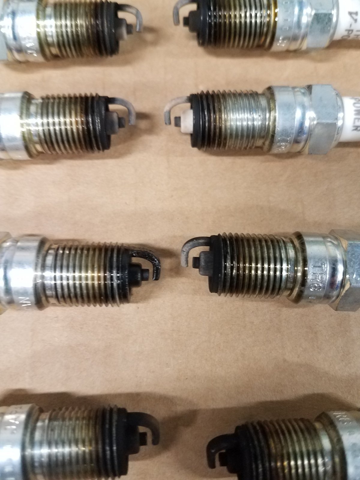

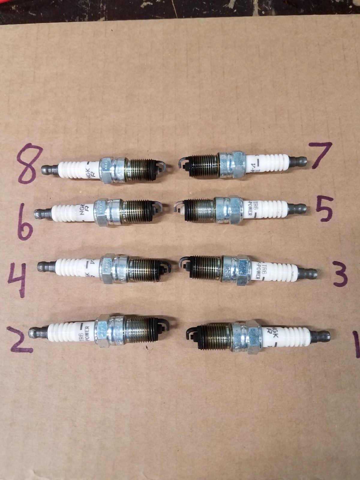

Borescope down the spark plug holes and the cylinders and pistons look pretty good. Kinda impossible to see small cracks but overall they look good. My thoughts now are somehow the LS9 head gaskets have failed. New gasket will be here Wednesday the plan is to pull heads tomorrow evening and hopefully just throw the new gaskets in Wednesday night. Then let her rip tater chip.

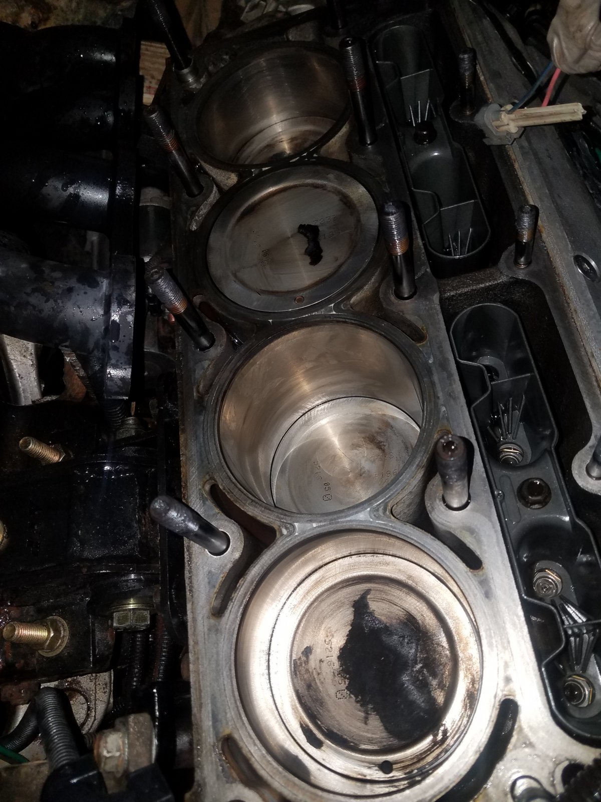

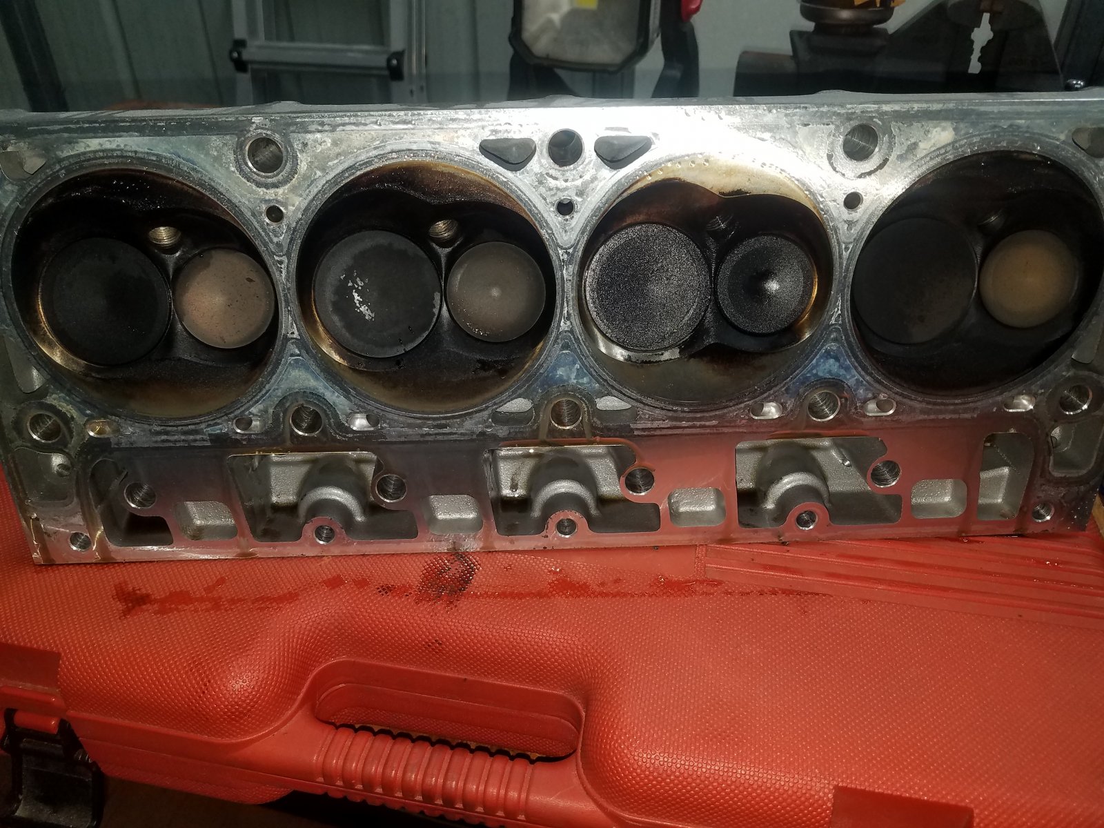

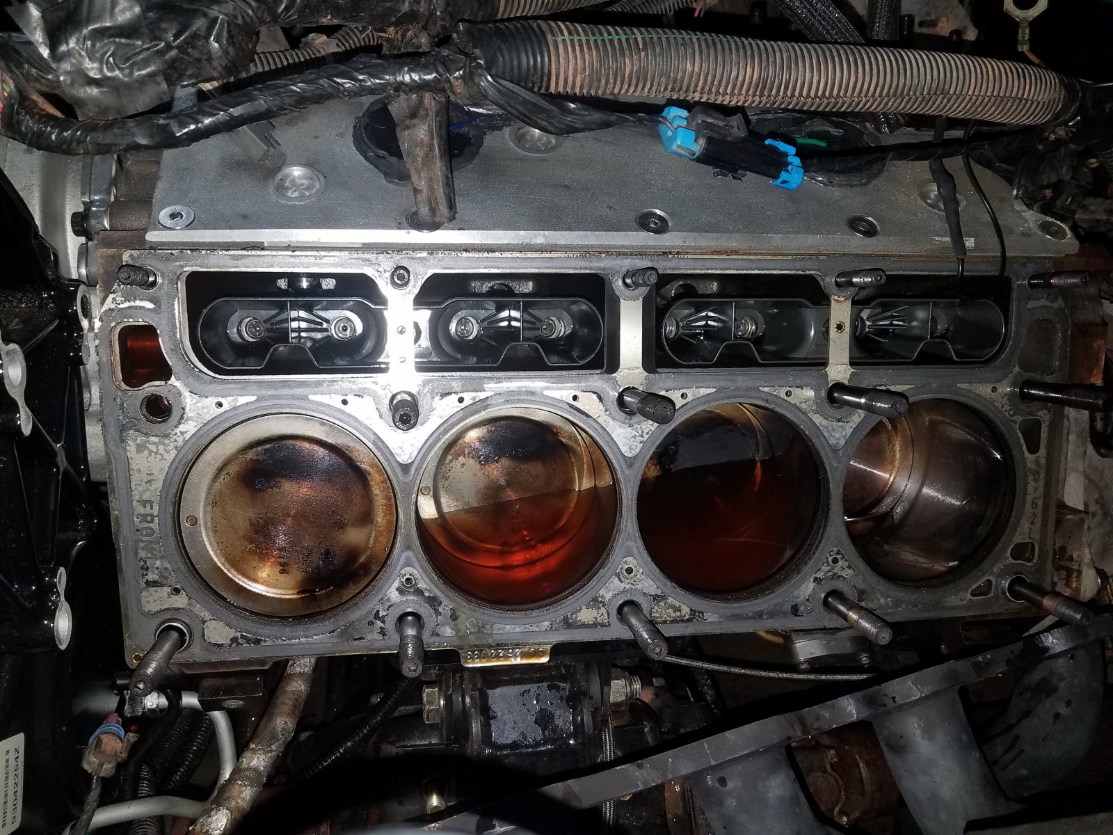

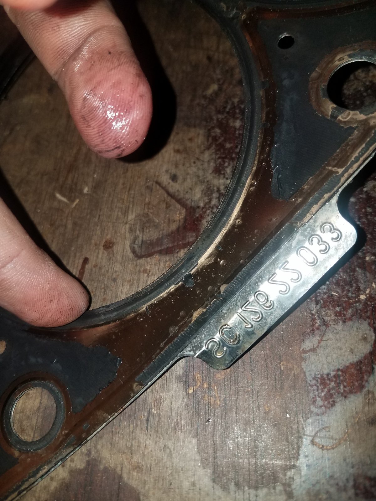

Got the motor torn down in a couple hours this evening. Didn't get driver head off yet since I suspected the passenger side to be the problem. Thankfully pistons and valves look good and I see an obvious failure point in the head gasket . Not sure why it blew though. My torque wrench is snapon and was recently calibrated. Only thing I can really think of is that I torqued. The heads twice and ended up pulling them again and retorqueing using the same gasket which might be a nono I'm not sure. Also they might have gotten wd40 on them when I was coating the cylinders. Not sure if that would cause an issue.
New gaskets will be here Wednesday and I'll pull the driver side head tomorrow

Nope yanked the blower, fuel rails, coolant lines, fuel lines, catch can stuff and headers. Not bad at all. When I put this motor in I specifically designed all the lines to be easy to get to and everything is AN fittings! No silly worm gear clamps or spring clamps. Also used arp bolts for nearly everything which is nice.

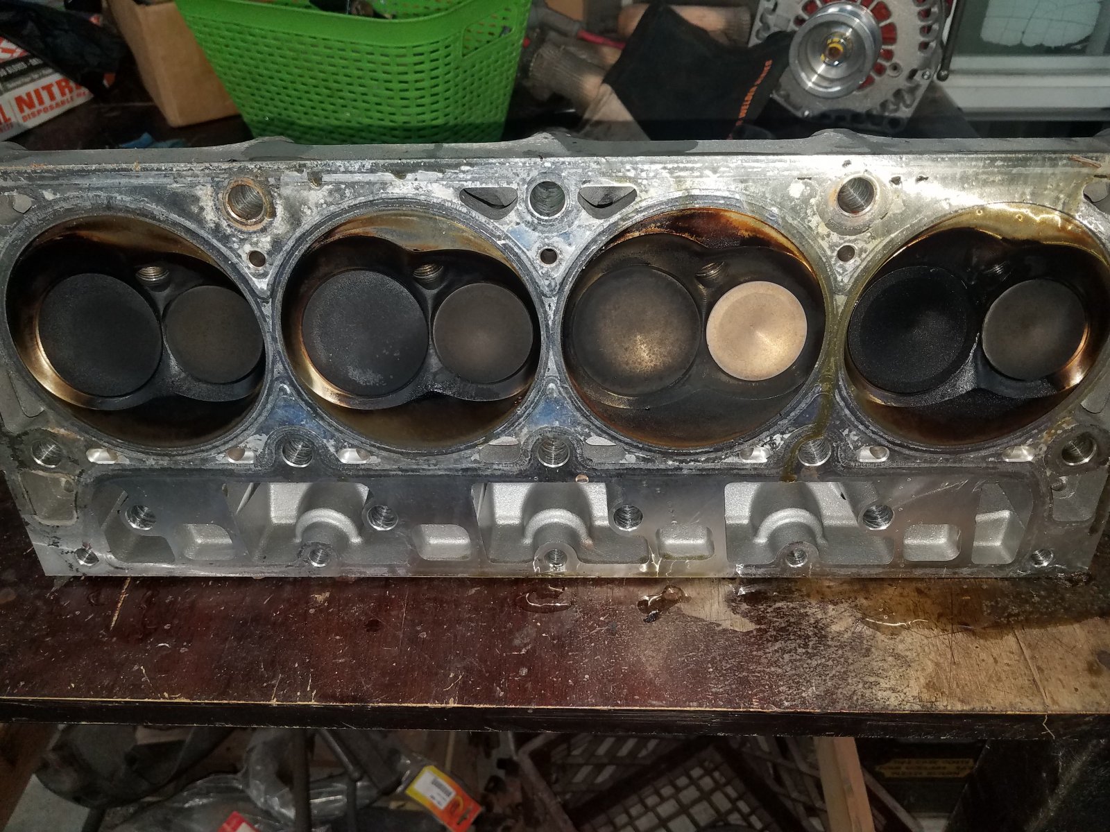

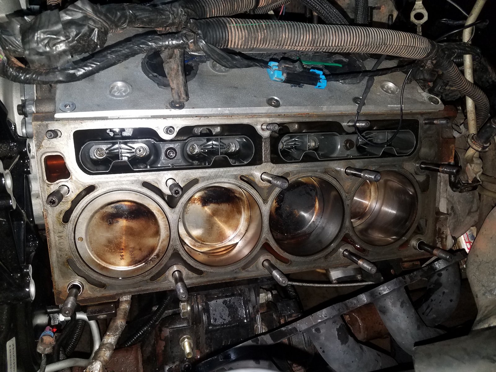

I do have further good news the driver side looks healthy! No sign of Corona virus.
With any luck it will be running by the end of the week!
