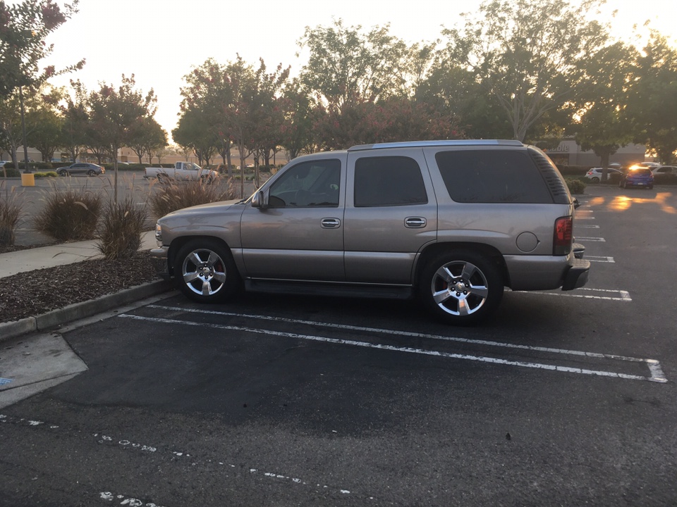

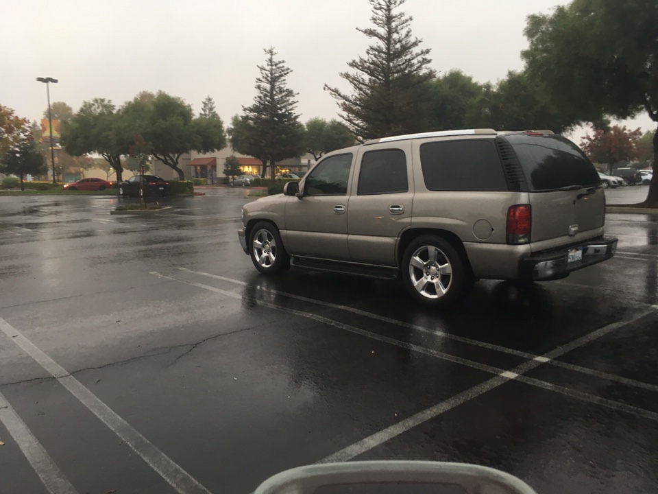

This has always bugged me but Tahoe rear sits 1-2” higher in rear. I have 2 finger gap front and 3-4 gap in rear.
Anyone else have this issue? Maybe shop didn’t level out with the front keys? Want to add helpers but don’t want even more rake.
Tires are 275/55/20 in pic

Kinda just grasping at straws here to figure out what's going on with your not-so-dropped drop. I mean, it just doesn't look like a 5" rear drop. For that matter, the front doesn't look like a 3" drop. From that pic, I'd guess it to be a 2/2. Stock for stock, the GMT800s tend to sit lower than the GMT900 and I'd imagine yours should have virtually no gap, if not slightly tucking with a 3/5. The back for sure should at least be level with the front. This is why measuring before anything is done is so important.
Grasping at another straw, there's a chance the front WAS dropped 3" and the shop cranked the T-bar to lift it back up a little to help with tire clearance and/or to make it easier to align. Although, assuming the front was dropped with spindles (2") and a coils (1"), the suspension would only need to be adjusted for that 1" drop from the coils and there's plenty of adjustment for that with the stock parts. None of this says anything for the back, though.
Any chance you can find some part numbers or markings on the rear coils? Maybe post pics of the setup? Do you know what that 3/5 kit was supposed to consist of?

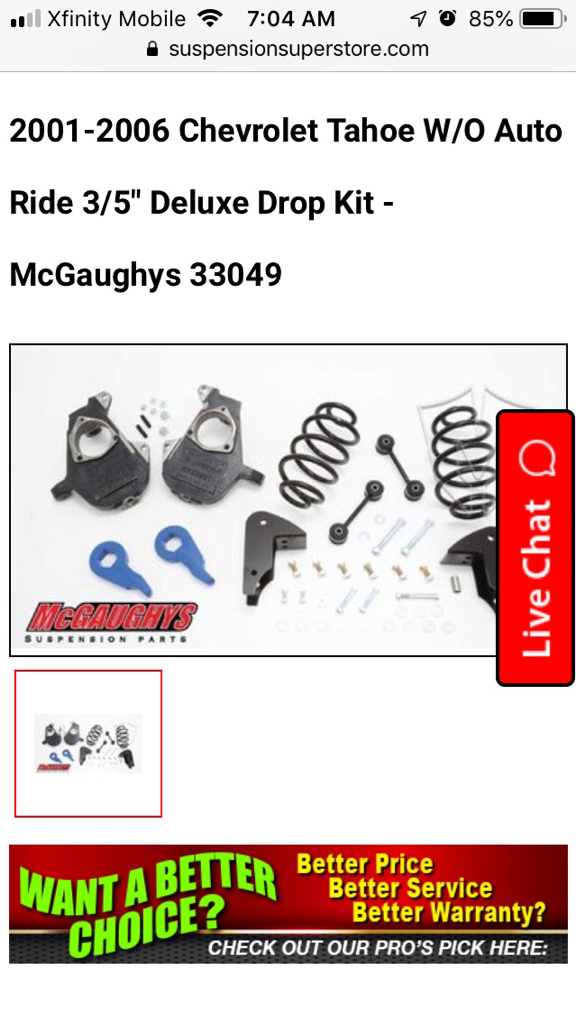

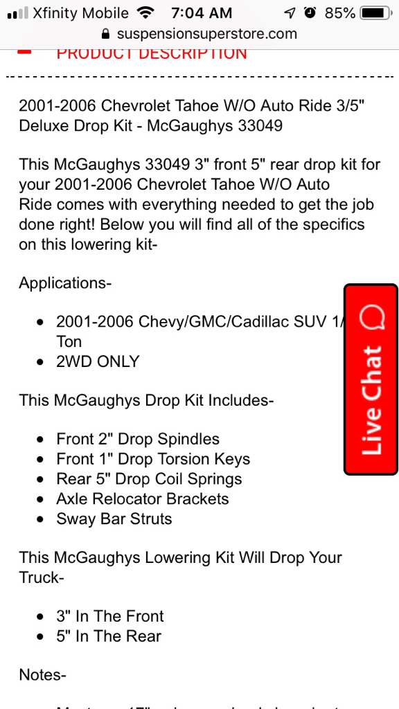

Kit used:
https://www.suspensionsuperstore.co...uto-ride-3-5-deluxe-drop-kit-mcgaughys-33049/

Yeah, I keep saying coils for the front as I'm stuck in GMT900 Land. But, the same applies- a 1" spring drop (torsion bar is your "spring") is easily alignable.
There's no other way to drop the rear other than with coils. Based on the pics you posted, I just don't see that as being a 5" drop. If you were to jack up the frame 5" from where it sits now and step back to take a look, I bet it would be way higher than what it was when it was stock.
It's like they installed the wrong coils in the rear, like a 2" or 3" drop coil. Or maybe the older kits never actually yielded their advertised drop? Or maybe it's more like 5" on a long body (Suburban or Yukon XL) from the extra weight?
All I can suggest is to first try to verify what springs you have in the rear so we all can have an answer to your mystery. Then, if you wanna drop it more, get a different 5" inch drop coil, such as the the Belltech TBSS one. From what I hear, those are sometimes TOO much drop for some people and they end up adding the BT spacer to pick it up an inch or (as I'd do) use load helper bags to pick it up and increase the spring rate as it tends to be a soft spring. This is probably why that BT kit comes with the spacer and is advertised as a "4-5 inch rear drop kit". It's to cover them for the potential and maybe likely variance. Every vehicle sits differently due to a slew of factors. What one needs to sit a certain way when lifting or lowering may not be necessary for another.
