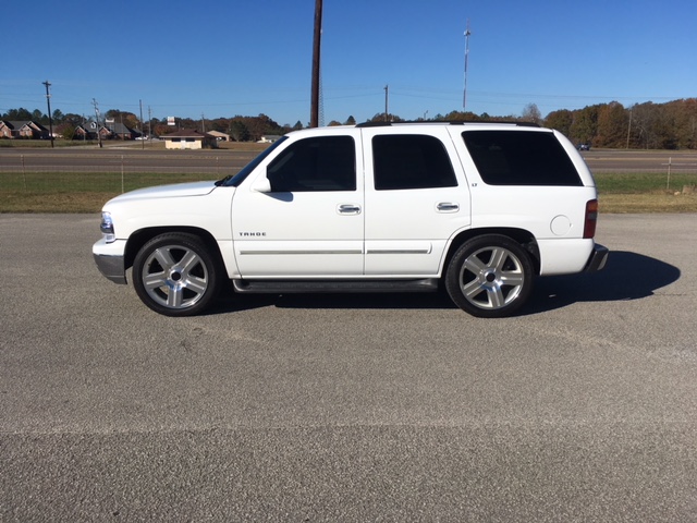

So instead of lowering rear to level can I replace my mcgaughts lowering keys with factory and realign? Then I’d just be running spindles up front.
BADRIDES
Dec 18, 2015
1,825
1,278
I have 2 inch spindles on mine and 3 inch Mcgaughy springs in rear.
45,012
You could if sitting level is more important to you than being low(er).
BADRIDES
Dec 18, 2015
1,825
1,278
So you have JUST drop spindles on the front?
Your trucks sits perfect and is exactly what im looking for.
Yes Sir. Sits 3/4 of an inch higher in the back and is exactly what I was looking for.
