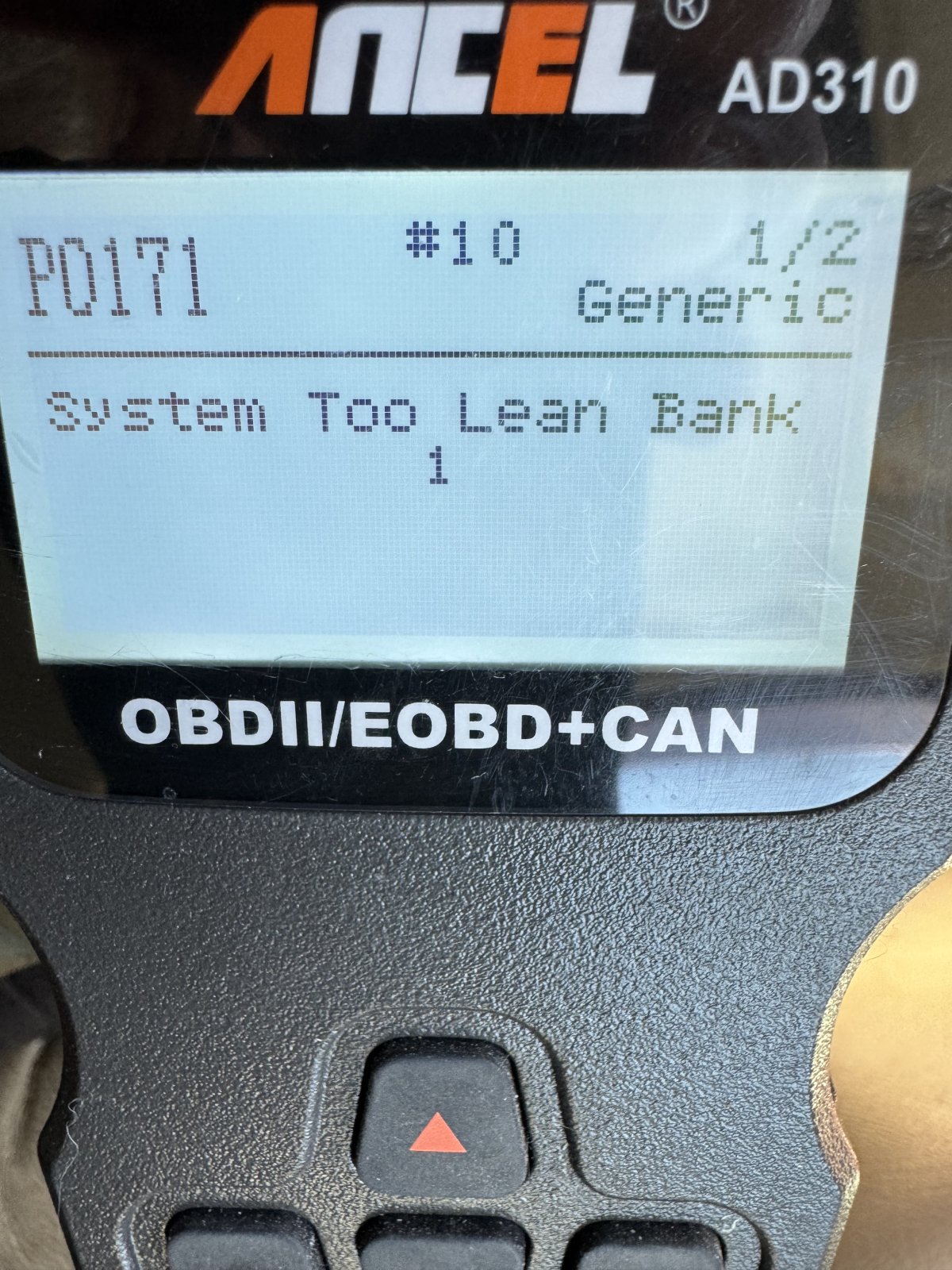

4) while still running (roughly) I was getting these codes and the bank 2 one.
5) I’m guessing the fuel pump? Intake manifolds seem intact.

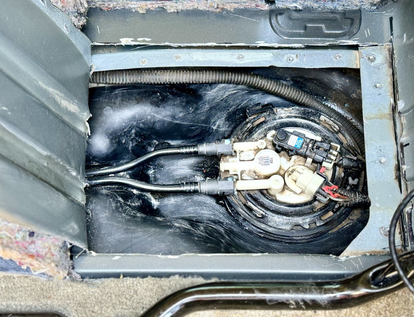

I’m right there. ACDelco on order. Hatch cut and ready. A bit of a PITA as I chose to cut it outside the spot welds thinking the underlying structure I can screw back into and have a solid closure.

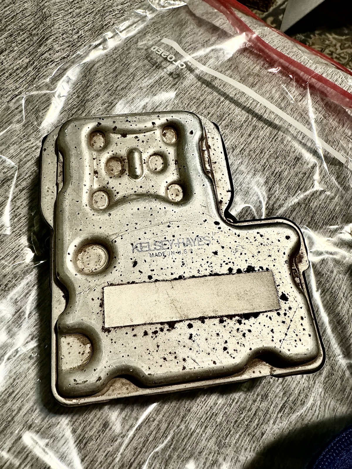

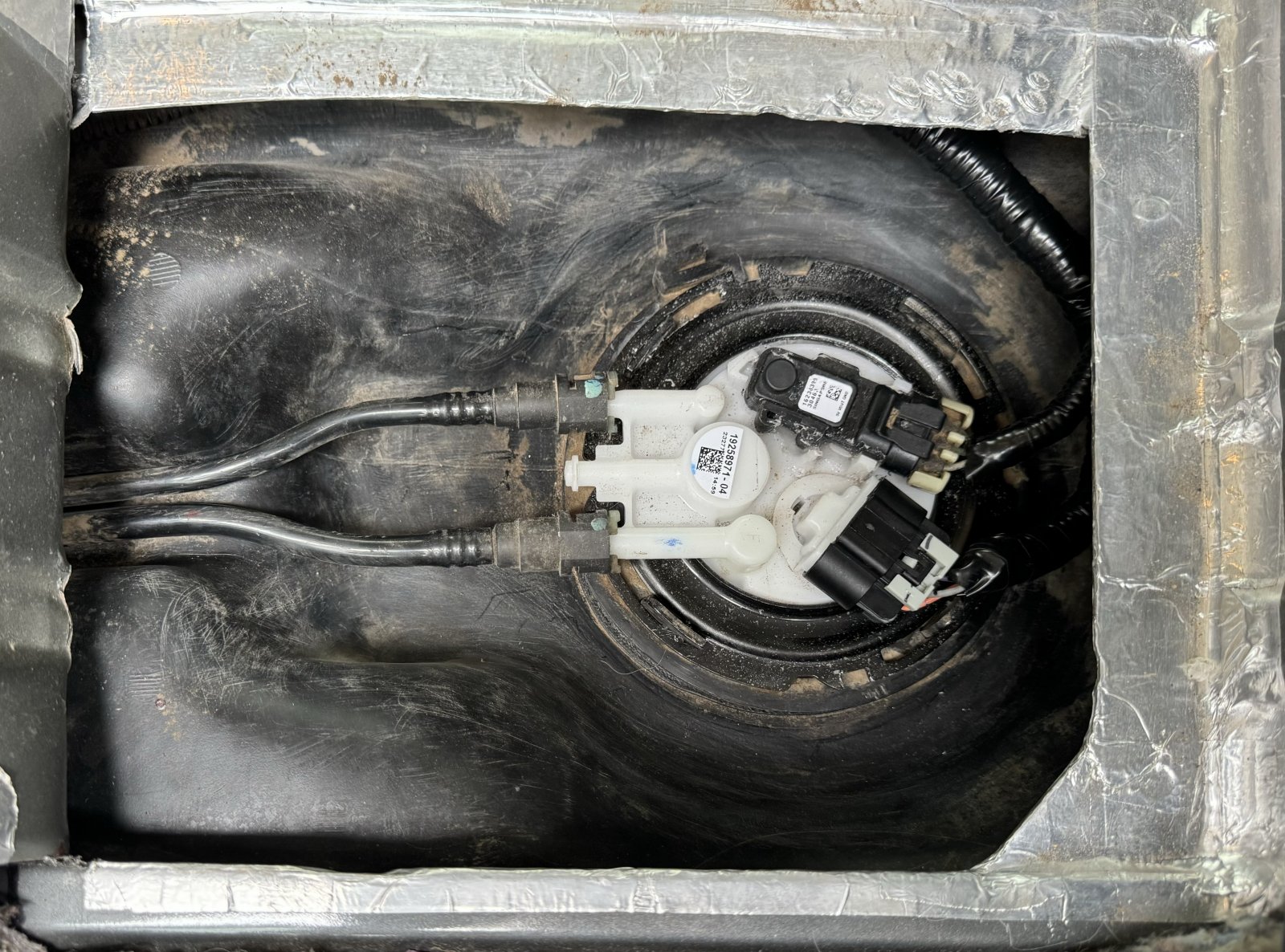

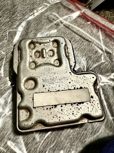

So it was the fuel pump. I went the hatch method cutting beyond the spot (drilled them out) welds, a harder way to go but safer in the long run, so I could come back and put short self tapping screw back in for strength-but short so they would not reach anything vital.
I also redid all the grounds, changed the oil, replaced the fuel filter and the ABS brake module while I was under there. This fixed the wonky fuel gauge issues too.
A huge PITA all told, but well worth it in money saved and results.
