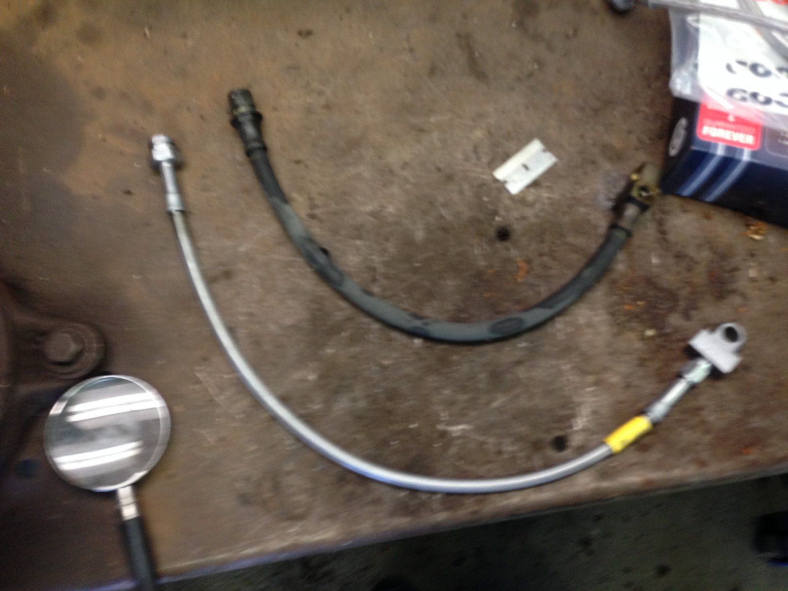

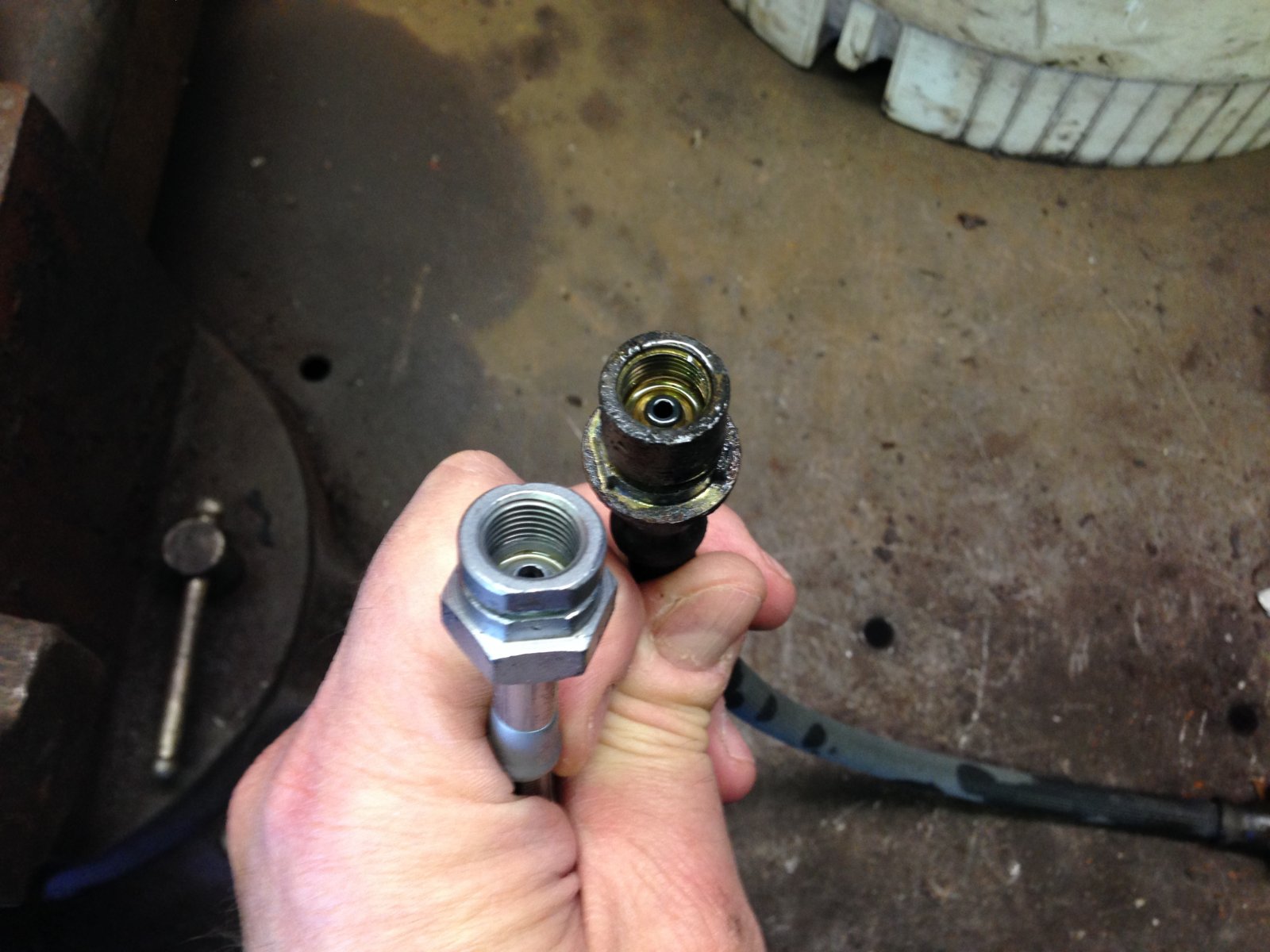

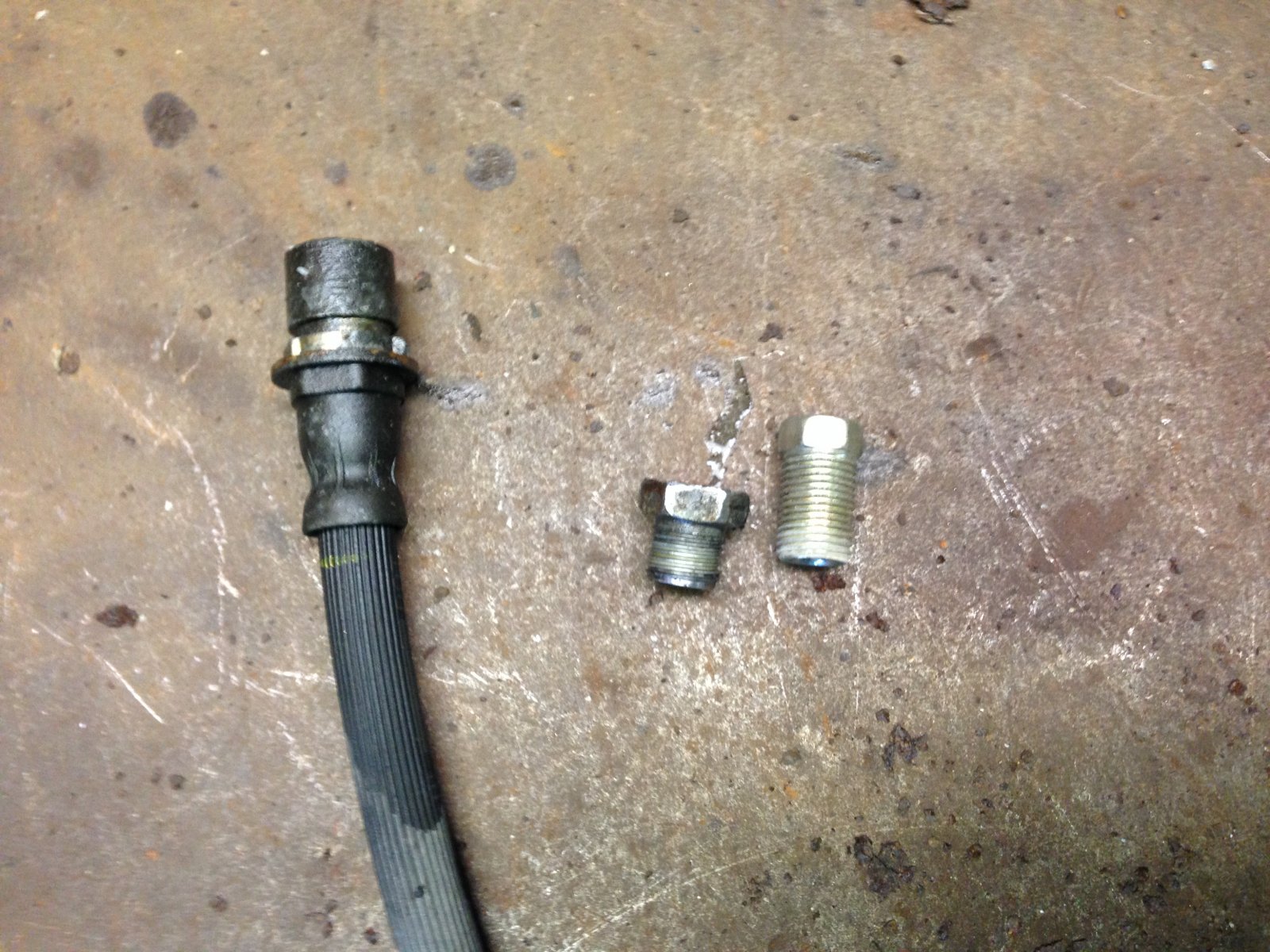

Yes Sam i think i was the guinea pig for that fiascal when i did it in 2017.They had no part back then so i had to make it work and cut the line no biggie-but when your on your last line and find that out your not happy.
