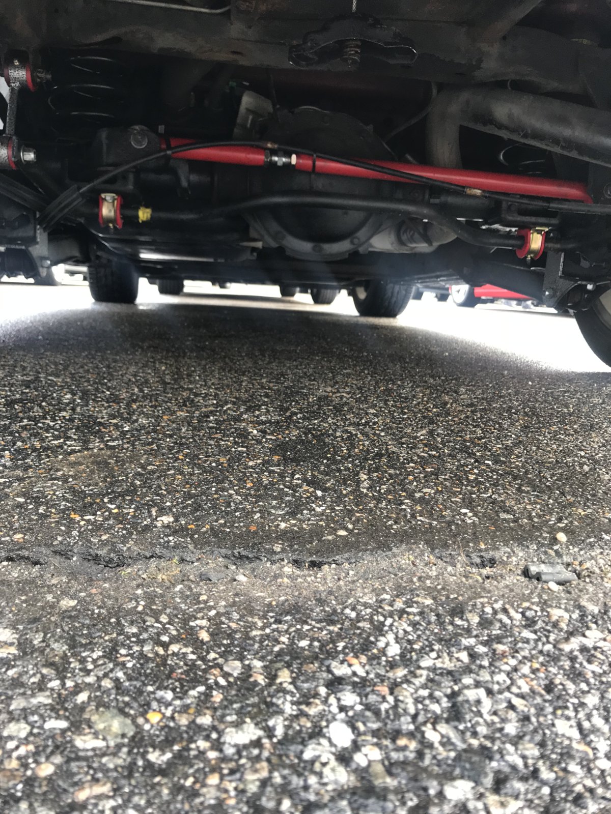

Talking about the rear swaying. I had the same issue until I changed the rear springs.[/QUO
I installed drm rear trailing arm re locate kit and sway bar endlinks and got ploy bushings and now rear is tight. No swaying need to get poly for the front. Can’t afford sway bar kit yet. So I need to get ploy bushings and 1/2 inch shorter endlinks
LINTZ0718
LINTZ0718
Jun 25, 2017
51
17
Rear lower shot
