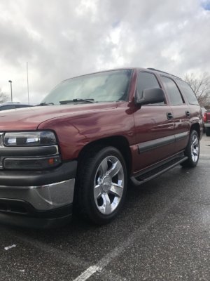

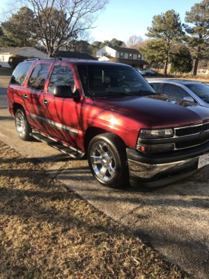

2002 tahoe lowered on spindles and 3 inch rear lowering springs I work for Chevy and was gonna police take rear springs to stiffen it up ... I just ordered the djm trailing arm relocate kit and endlink kit and poly sway bar bushings.
Do you think it will take the rear sway out ? Should I get police tahoe springs?
Will i need adjustable rear pan bar too?
It has cai , flomaster ,bbk power plus 80mm tb long tube headers on next weekend
Just looking for sum input View attachment 189676View attachment 189677
