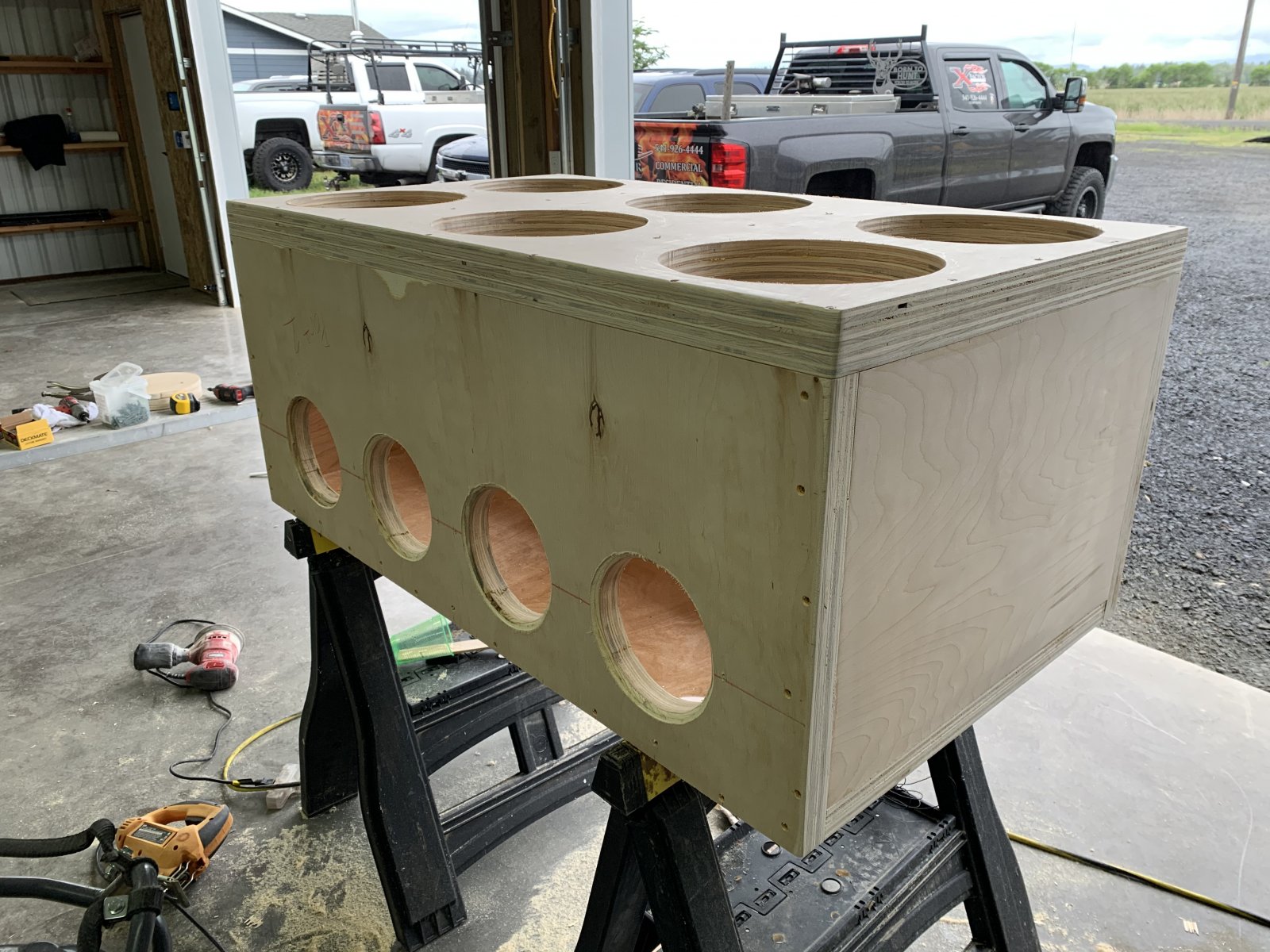

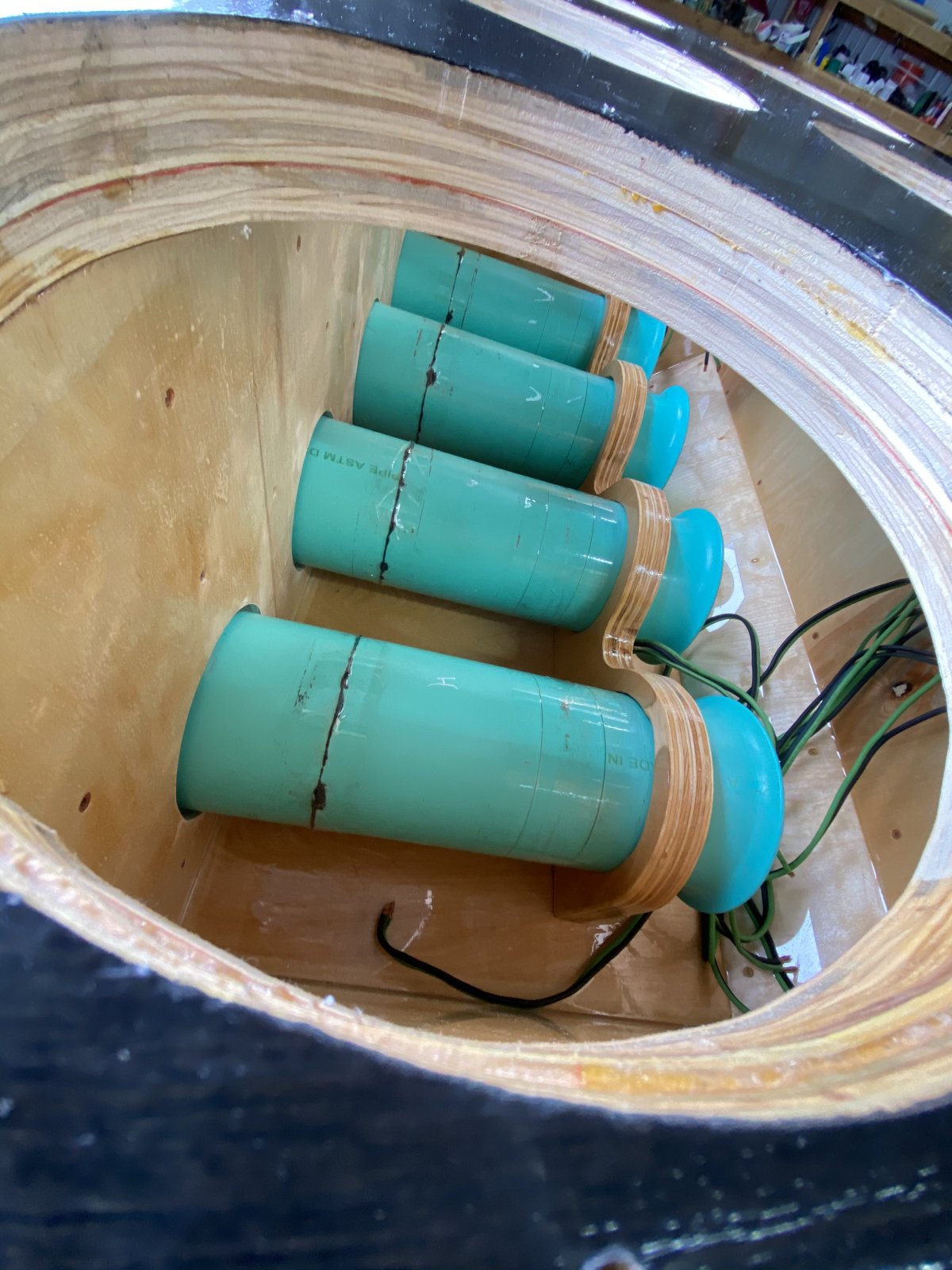

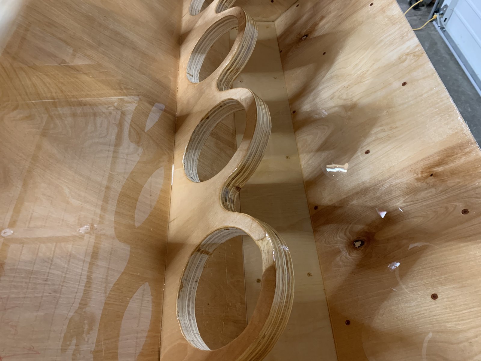

Yeah i have no idea what @05Single is talking about. Lol. More progress on the enclosure. Really hate wood. Really really hate it. Liking this glaze coat though it’s coming out nice.

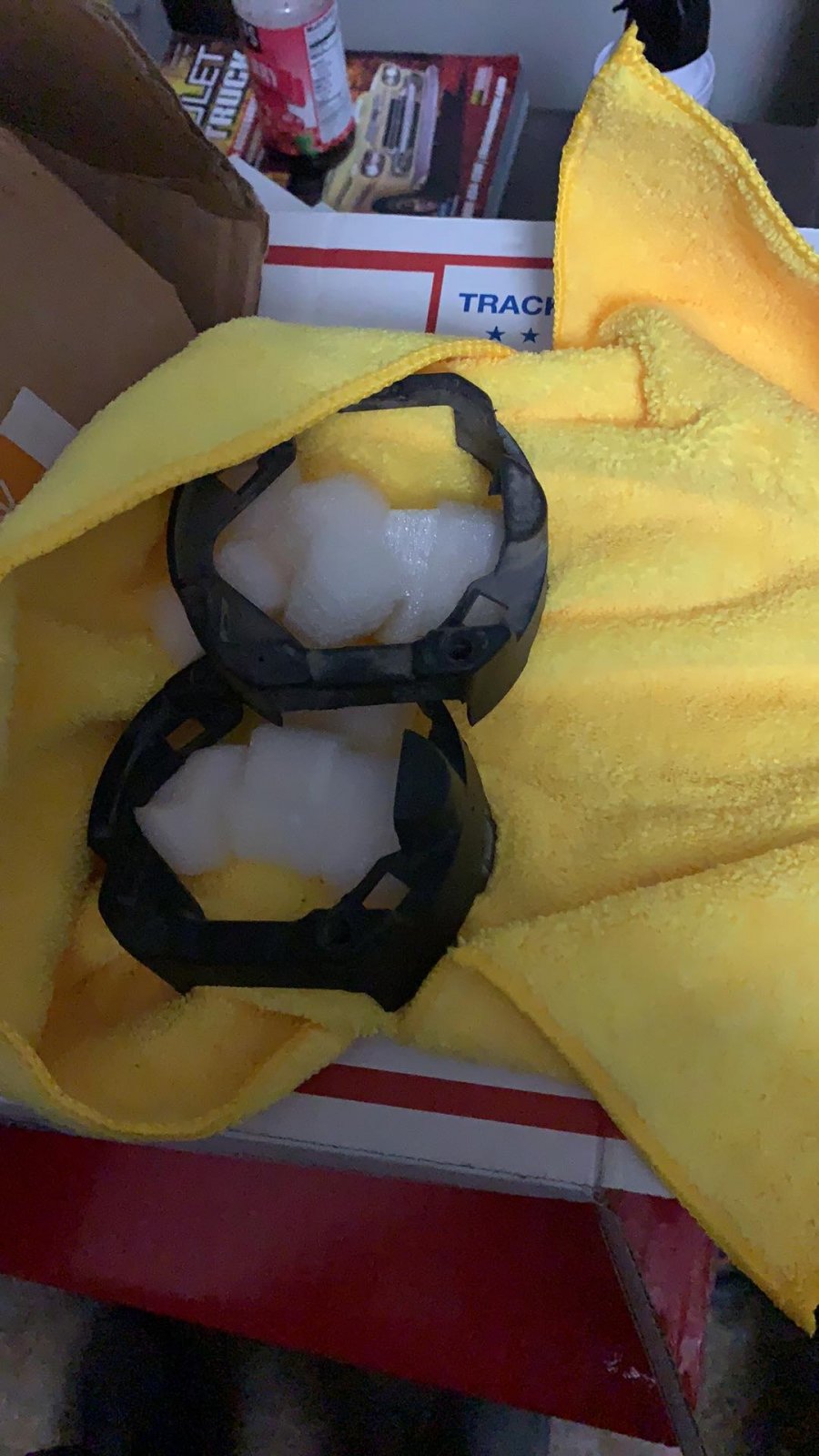

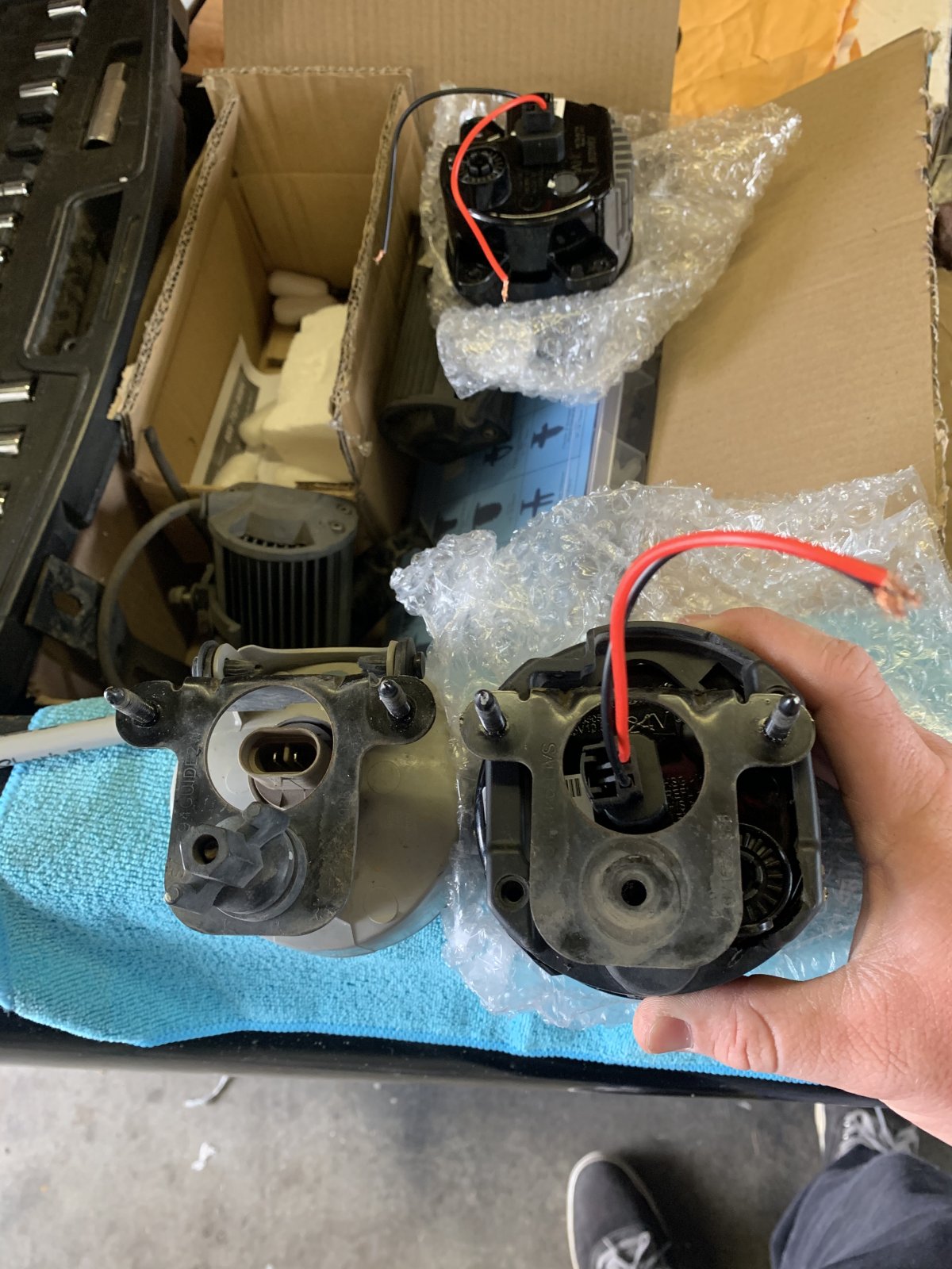

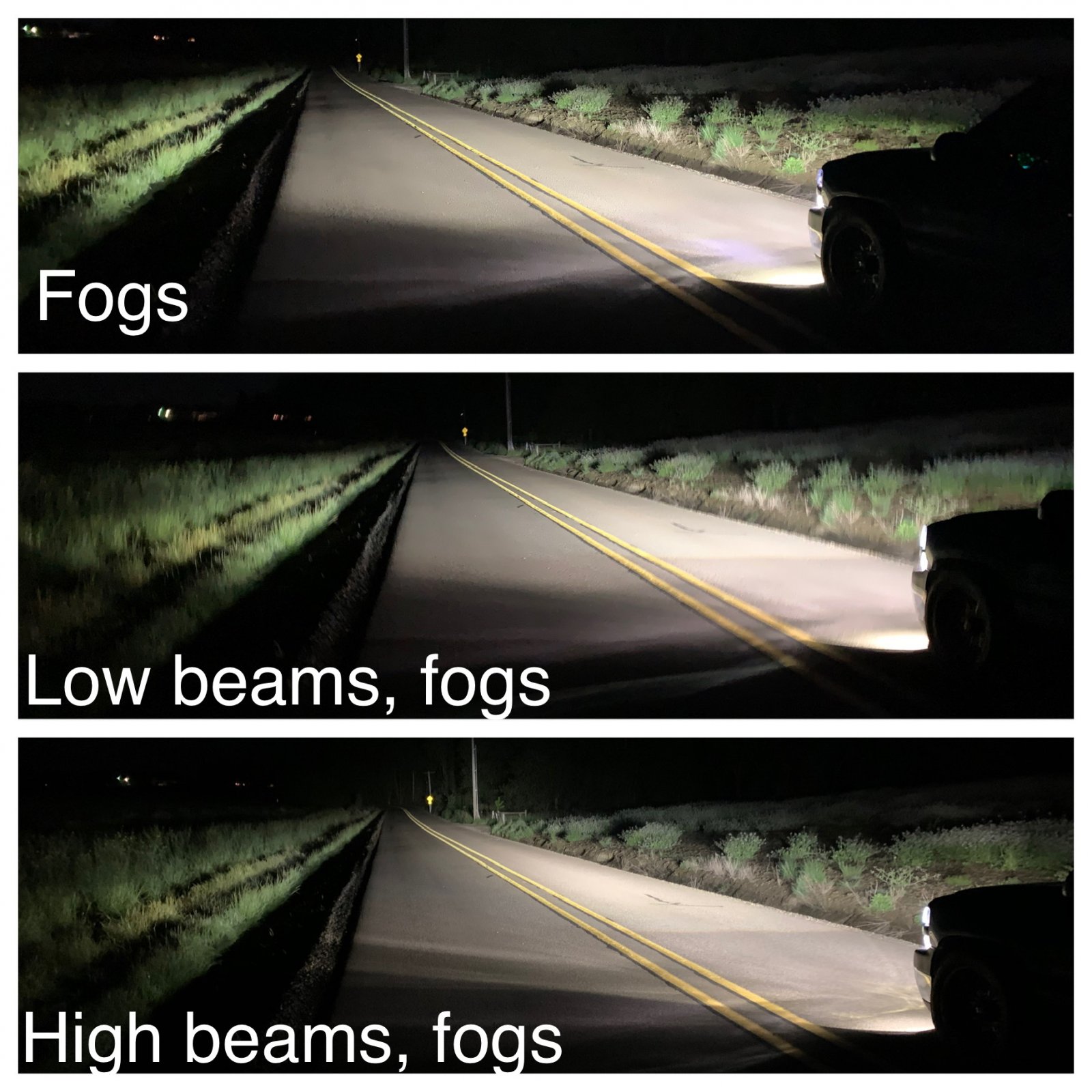

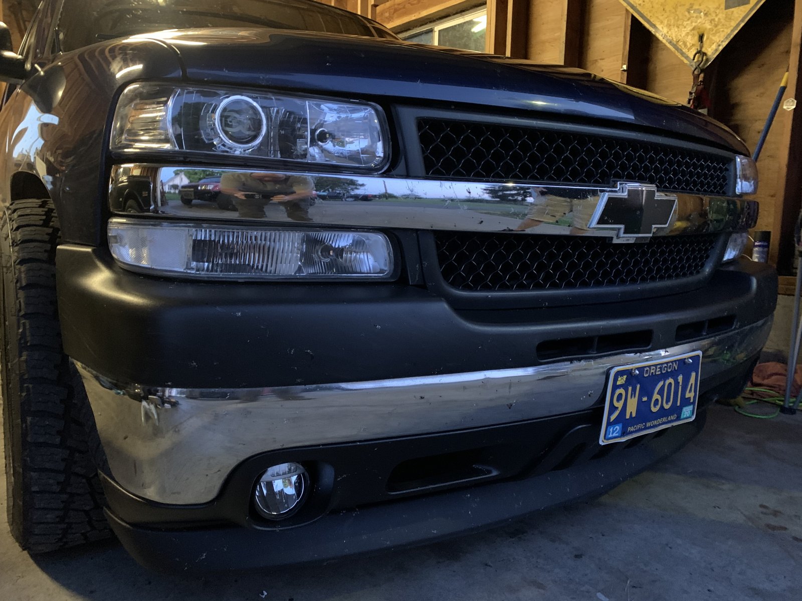

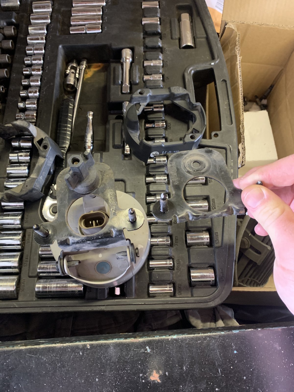

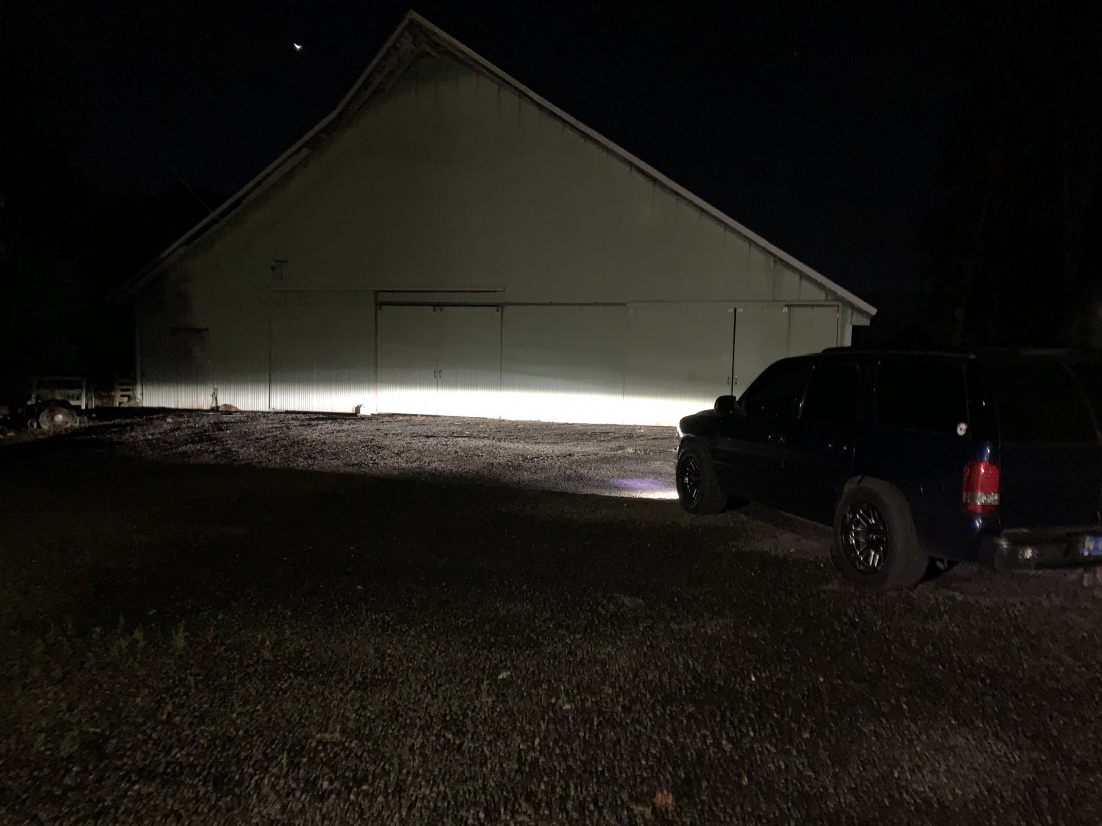

Fine I’ll show more on that. For anyone reading the recent comments between @05Single and I.... we both got our fog lights done. He showed me them and sent me some brackets for the install so I was waiting for him to post on here showing them so I didn’t steal the thunder from him lol.
Jeep Wrangler oem myotek led fogs.
These things are stupid. I’m so stoked on them. Almost more than I was with my retrofits. @05Single has more detailed pics but I’ll upload mine. Did a very similar mounting setup as him. Used Wrangler halogen fog light brackets to hold the fog and give a flat mounting surface. Only different thing I did was cut the metal bracket off the oem z71 fog and mount that to it as well so it used the same 2 stud mounting as factory. Used some CA glue to tack the mounts on then once I got them aligned correctly I used jb weld clear epoxy to connect everything.

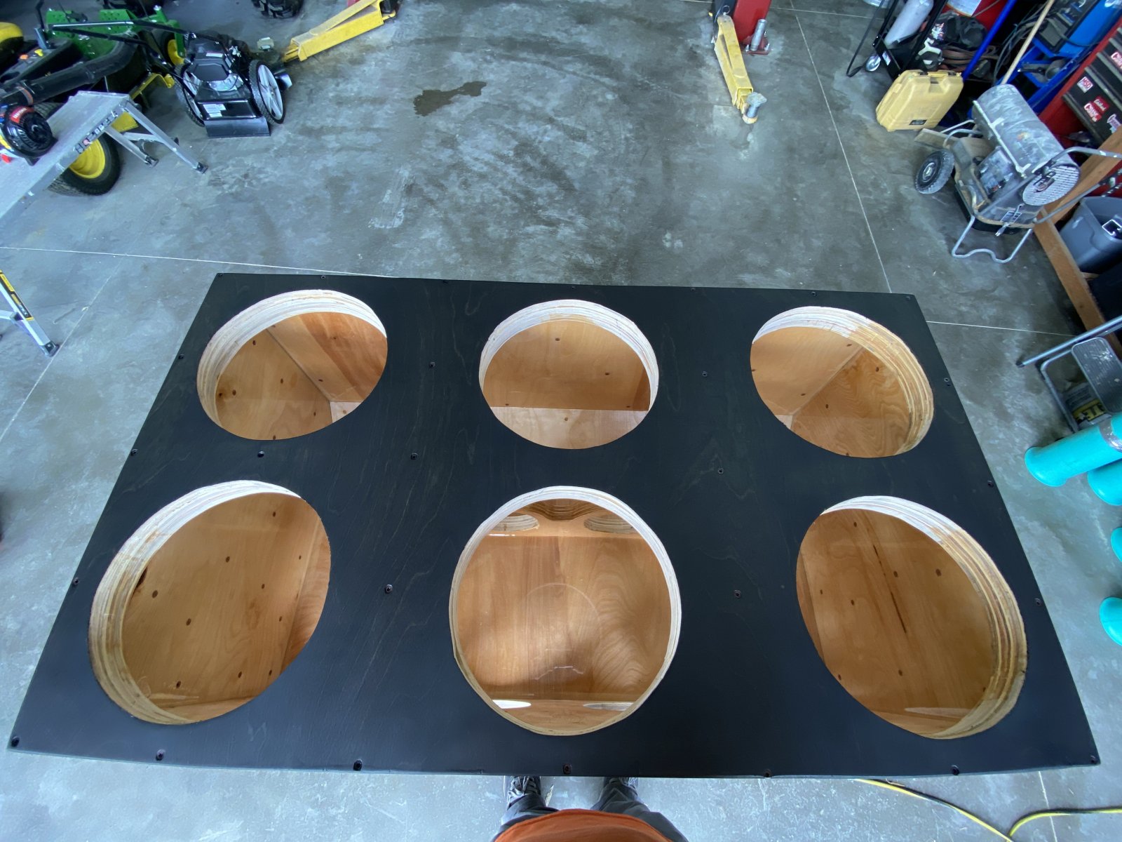

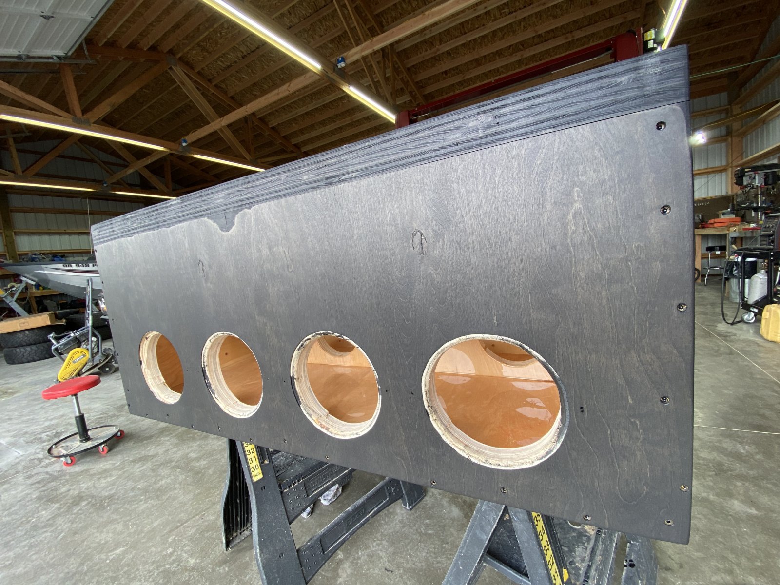

Now that the interior of the enclosure is coated I was able to sand the exterior and stain it. I really like the black stain I used before(plus it matches everything else) so I just made it slightly darker this time. Just a true black minwax water based
I used a 3x clear gloss poly stain for the outside just to give it a little shine but not be super thick. Pretty happy with the way it turned out plus will hold up better over time. The fun part now :rolleyes:

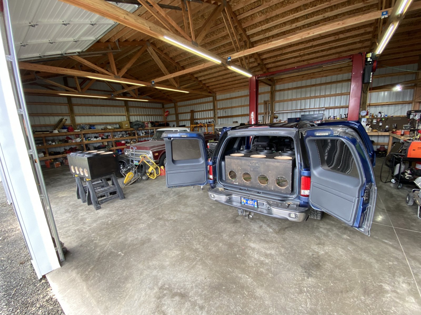

My back hated me after this. Pull the subs out, place them in the new enclosure, mark holes for subs, pull subs out, pre drill holes, drill in terminals, vacuum and wipe down enclosure, final mount ports , get it in the Tahoe, install back three subs, push enclosure back, install front 3 subs, screw enclosure down, and then connect wiring.
but it’s finally done. Played it a little and it sounds a lot better, subs are happier, all around cleaner sound.

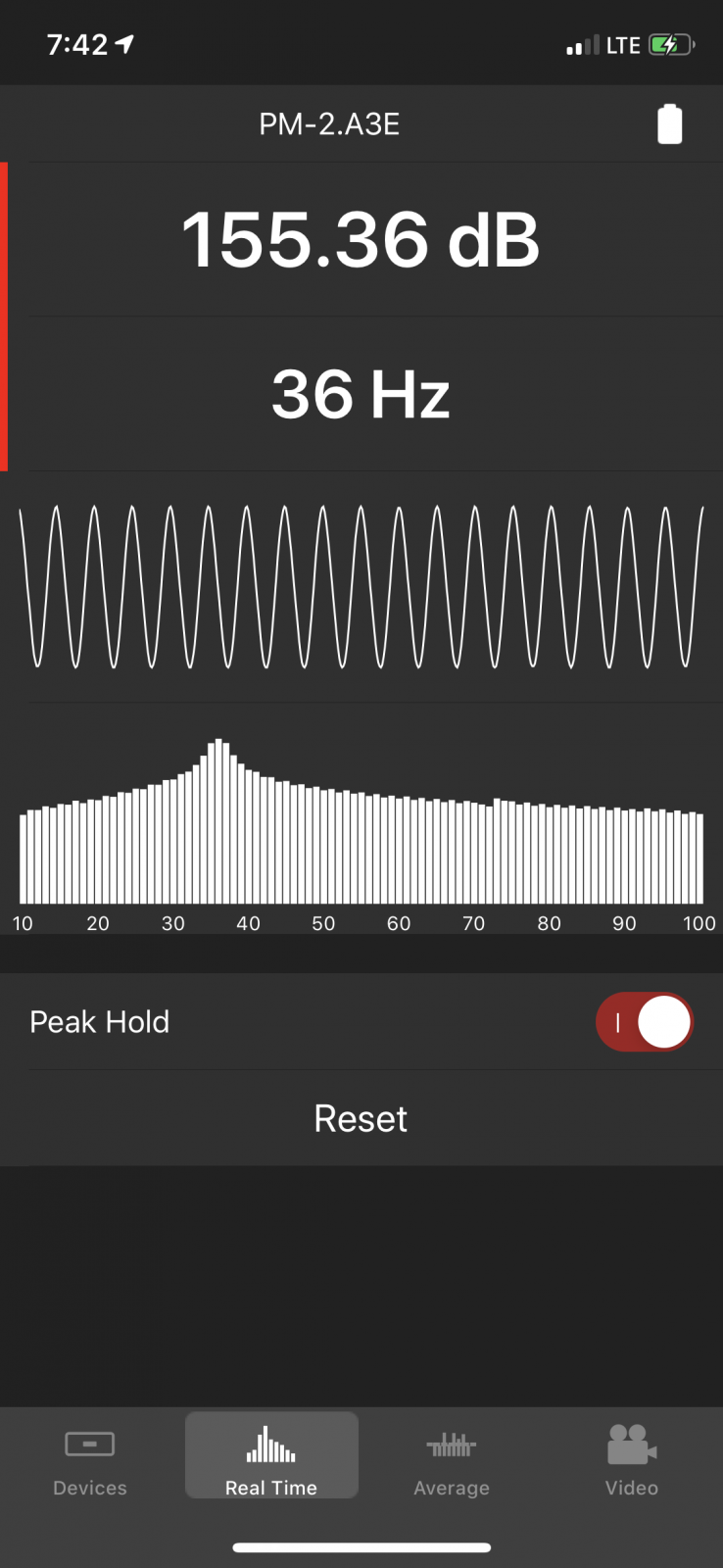

put my spl meter in there and tested at my old frequency peak of 44hz.......154.82 :mad::mad:
pretty upset at this point, clean up the shop and head home. I’m really happy it bothered me enough to test a little more when I got home. New enclosure means peak can change so I tested for a new peak. For some reason my peak dropped from 44hz to 36hz. Not that it’s a bad thing but very surprising it did that. So test at 36hz and boom 155.07. FINALLY! I’m stoked :)

So what's the difference between the old and new enclosures? Size/tuning?
so the old one was about a cubic foot to big(10cu ft) it Was only 1 sheet of 3/4 birch on the bottom sides and back, the front was double and the top was triple thick. I was having problems with the subs moving to much and I tried to shrink and stuff to get it to be louder but nothing was really working. It wasn’t built right from the get go.
the new enclosure is double wall all the way around with a triple thick top. It is right at 9cu ft internally(1.5 cu ft per sub) which is recommended spec for these dc xl12’s.
basically the subs are just way happier now and it’s showing on the meter.
I still have a lot of testing to do with this so hopefully I can find more gains

Whew! Good thing. I’m sure people on the internetz were calling that last bone crushing setup weak..

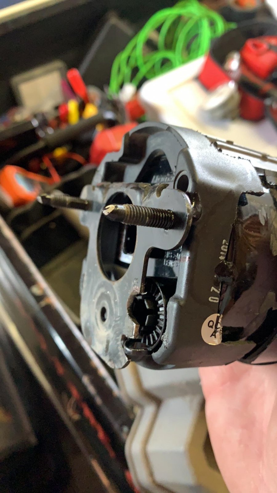

After bitching to my lady and everyone else for months and months that I have to set my e brake everytime I park to disable the auto headlights, I finally got a resistor to put in and fix that. Tinted windshield made them come on more than they should have and trying to not shorten the life of my hid ballasts.
Just takes unplugging the purple plug under the steering column
finding a4(grey) and a6(White) wires. Those are what go up to the sensor below the windshield.
Cut them with enough length to work with. connect the resistor (1.5k 1/2 watt)on each wire to make a loop and boom done. I soldered and used heat shrink for them. taped the harness back up and she good to go.

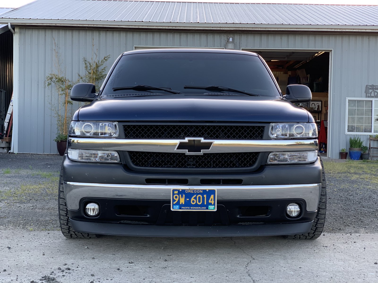

New switchbacks came in. Still unhappy with how bright they are but at least they are more of a 5000k white unlike My last ones so they do match the headlights and fogs a little better. Happy about that at least. These are the type 2 so when you hit the turn signal it flashes amber-white-amber-white.
My jdm A Star ones were type 1 so they would go to amber-amber-amber for turn signal then back to white once the signal was off.
We shall see how long these last though.
