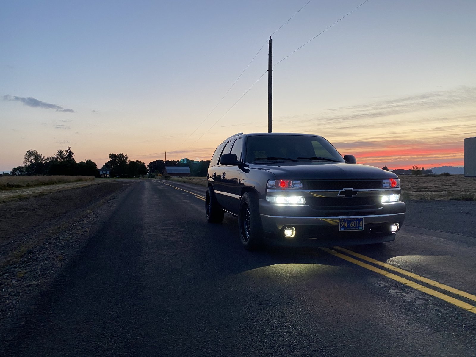

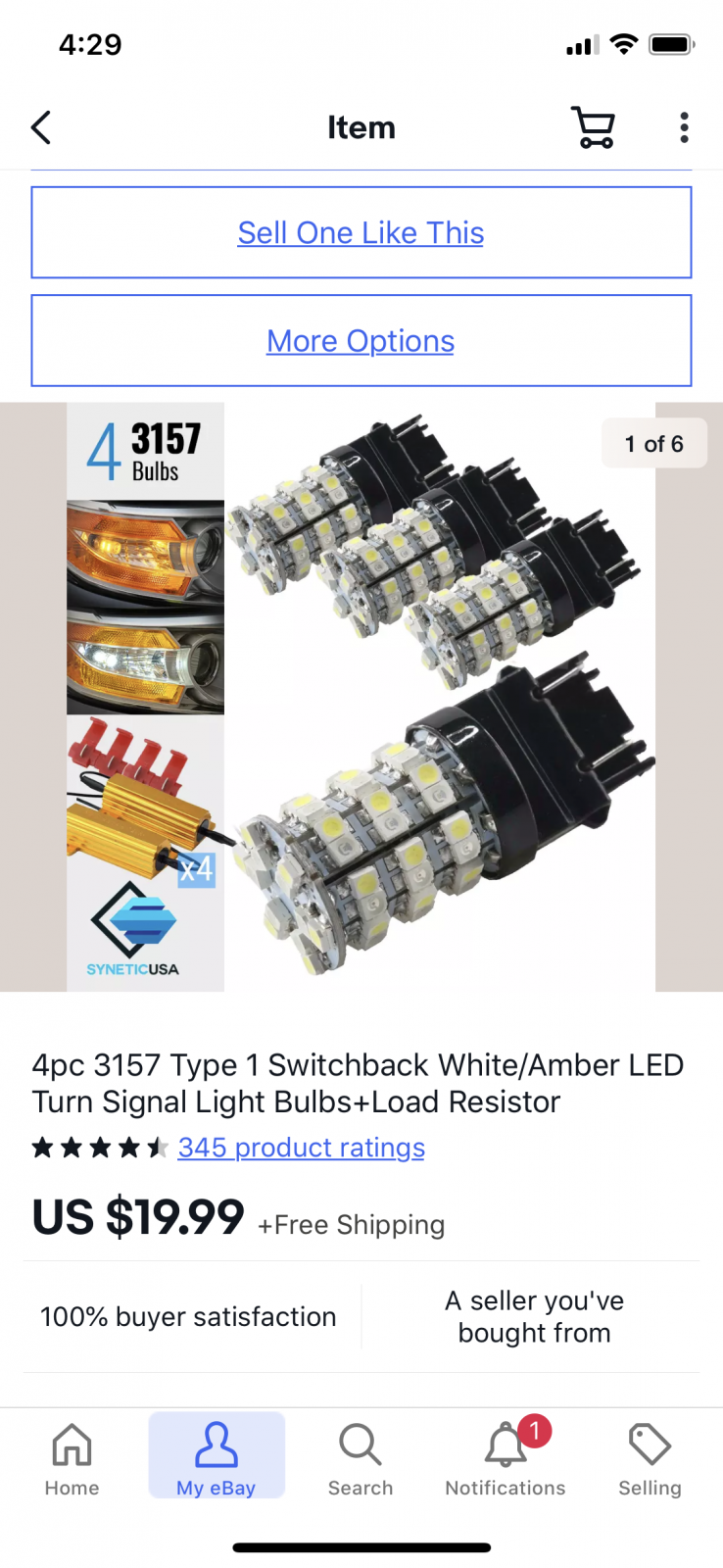

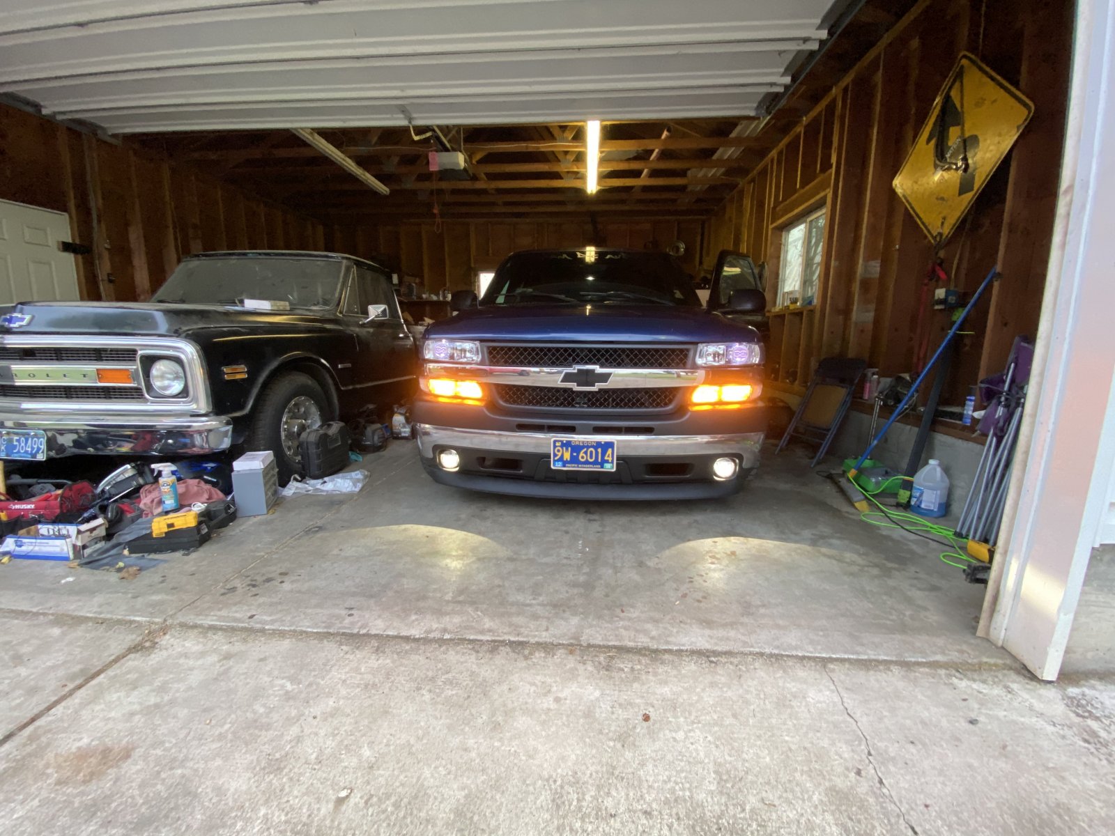

New switchbacks came in. Still unhappy with how bright they are but at least they are more of a 5000k white unlike My last ones so they do match the headlights and fogs a little better. Happy about that at least. These are the type 2 so when you hit the turn signal it flashes amber-white-amber-white.
My jdm A Star ones were type 1 so they would go to amber-amber-amber for turn signal then back to white once the signal was off.
We shall see how long these last though.

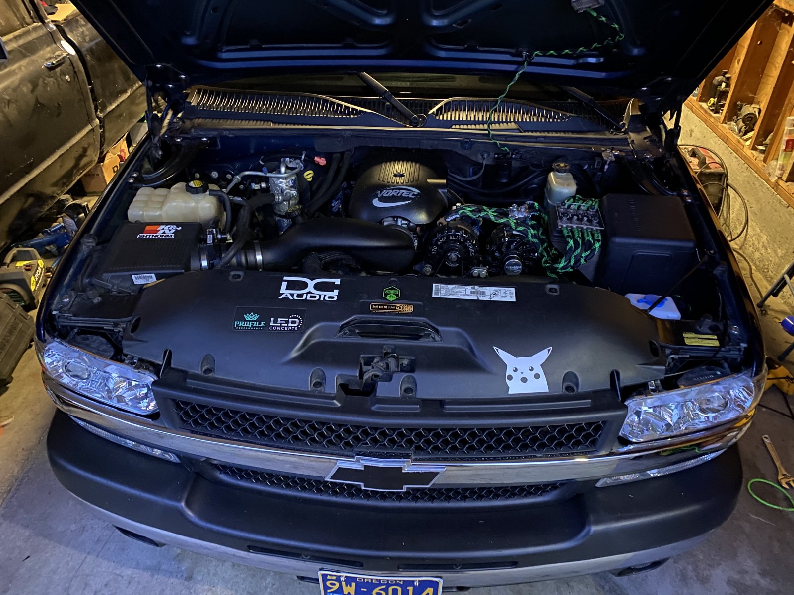

Got the engine bay cleaned today. Ashamed of myself for ever letting it get this bad. Lol.
My girlfriend got me a custom etched acrylic hood prop for shows/competitions. Turned out so awesome! Also got a new teardrop dc audio bass knob wheel. Need to find my passenger side fender brace so I can take out the secondary battery plate. It looks like poo and I won’t ever use it again lol.

Glad I always am a hoarder of old parts. :emotions33:After some digging through boxes I found my factory fender braces to swap out with the rusty secondary battery tray. Wiped the cob webs and dirt off of them and took off those factory stickers on the plastic core support cover that were so worn out you couldn’t even read them. Had some stickers laying around so might as well throw them on.
I let the engine bay get to dirty I have come to realize. It’s clean for the most part but I need to go through and really wipe the whole thing down inch by inch to be happy

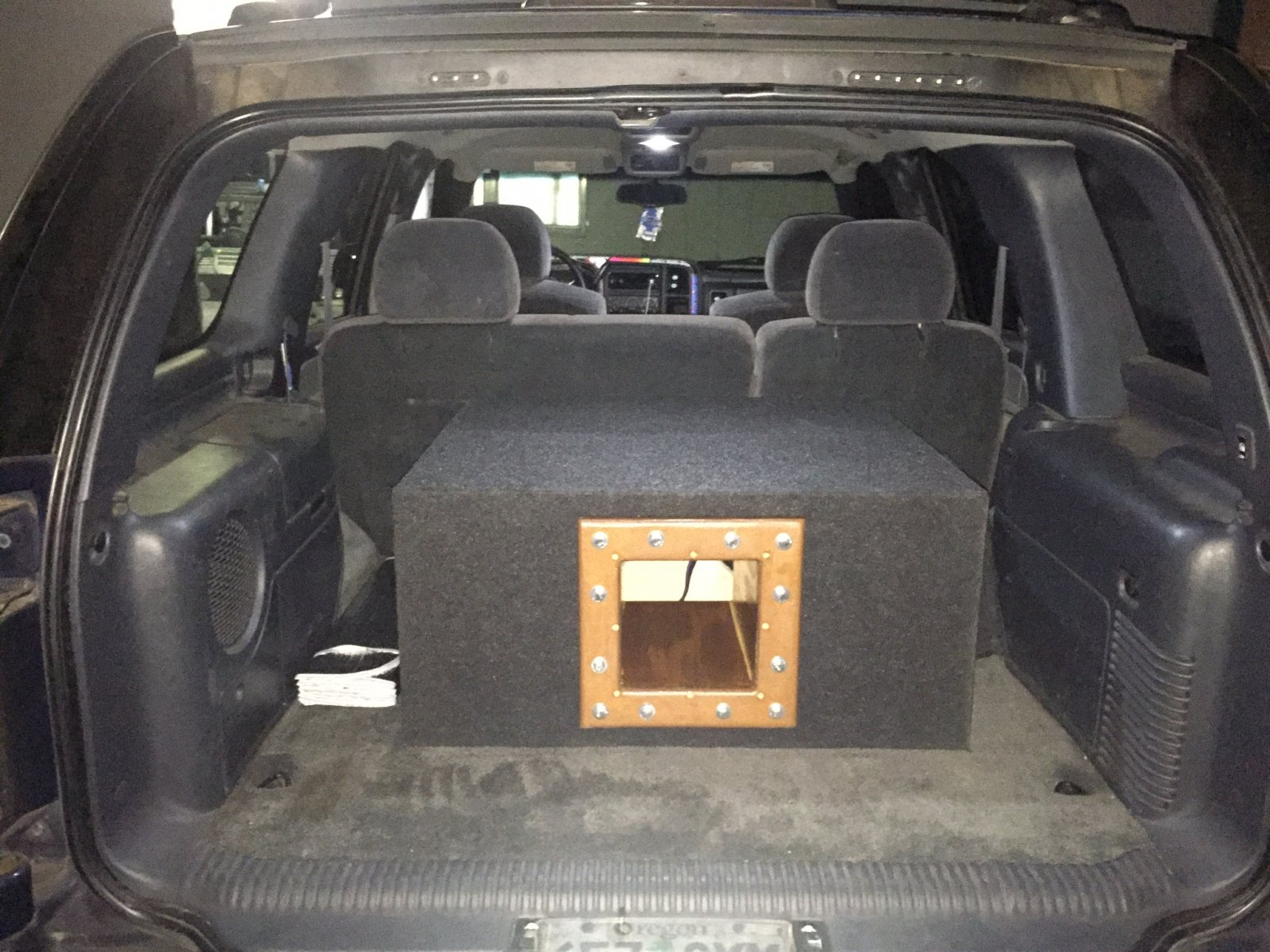

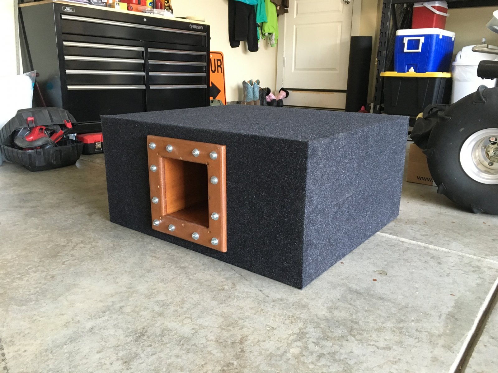

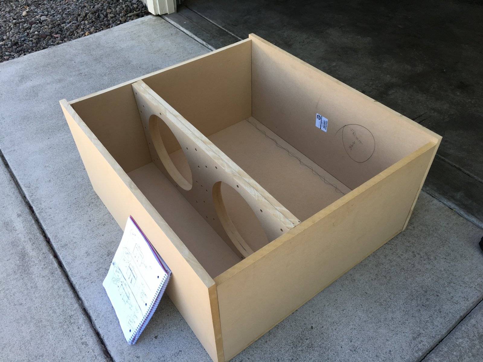

8/26/16 was caught of guard with a passing of someone very close to me. Green was her favorite color and that’s where a lot of green will come into play with this build. My buddy decided to surprise me with a 4th order enclosure that weekend, trying to do something nice to cheer me up a little and before my first time at the biggest audio show of the nw surf city sound off 9/4/16. Won first in my class again and dedicated the win in her memory View attachment 235439 View attachment 235440 View attachment 235441 View attachment 235442 View attachment 235443
Anyway I could get the specs on that box for 15s

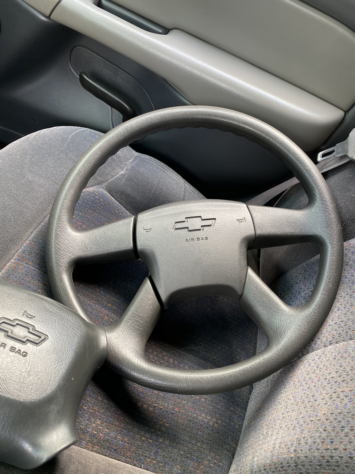

also picked up this today. Absolutely perfect shape. Got a little work ahead to get it to work but I absolutely hate the 99-02 steering wheels so I’ll figure it out

I've read the 03-06 airbag won't work in the 01-02. Good luck with it.
I know the dual stage bags won’t work for sure. Supposedly the 3500 or van airbags are single stage like the 99-02 are. I guess I’ll find out. Thinking it won’t be a simple install but We shall see. Gotta go get a 03-06 column now

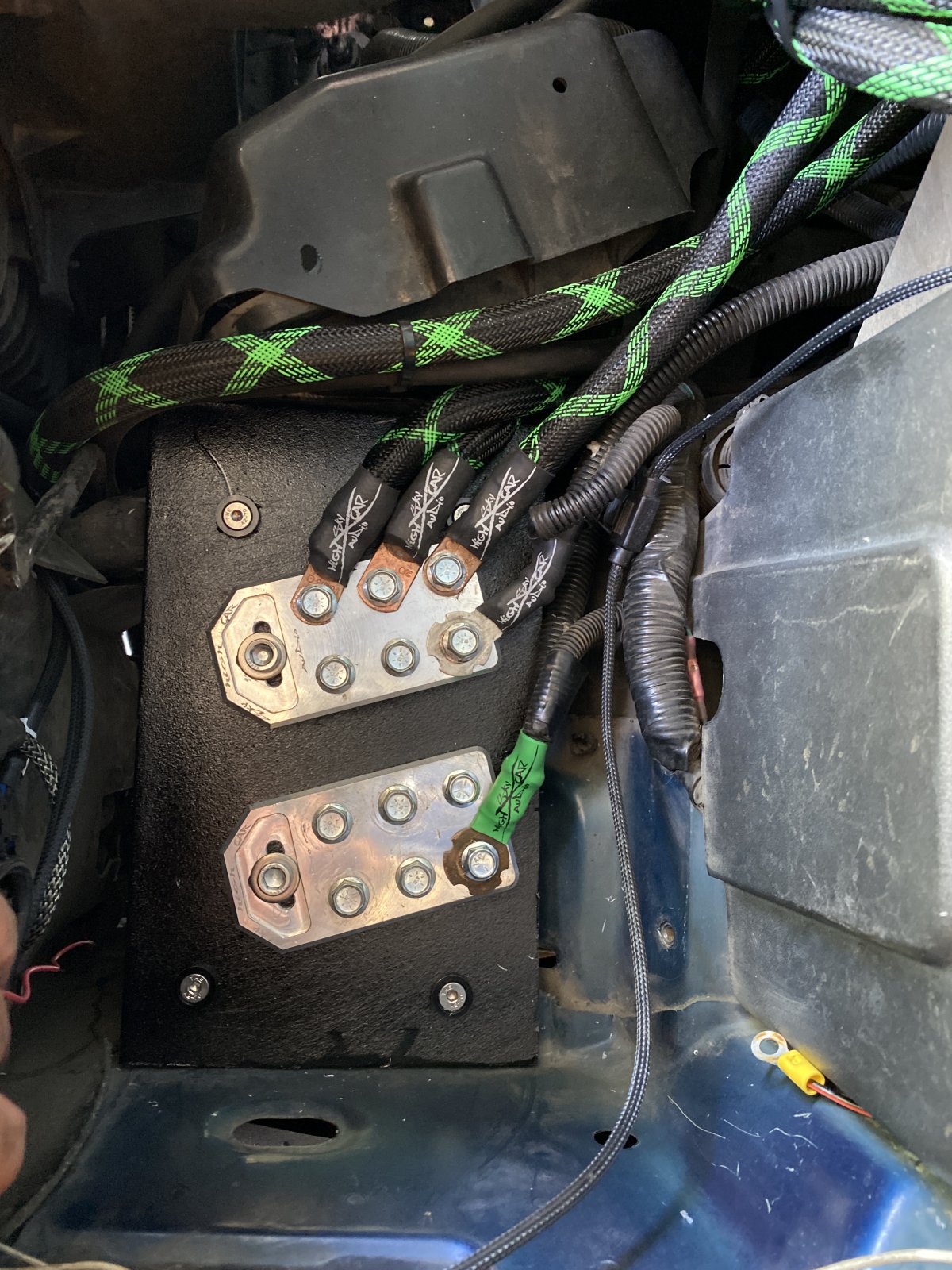

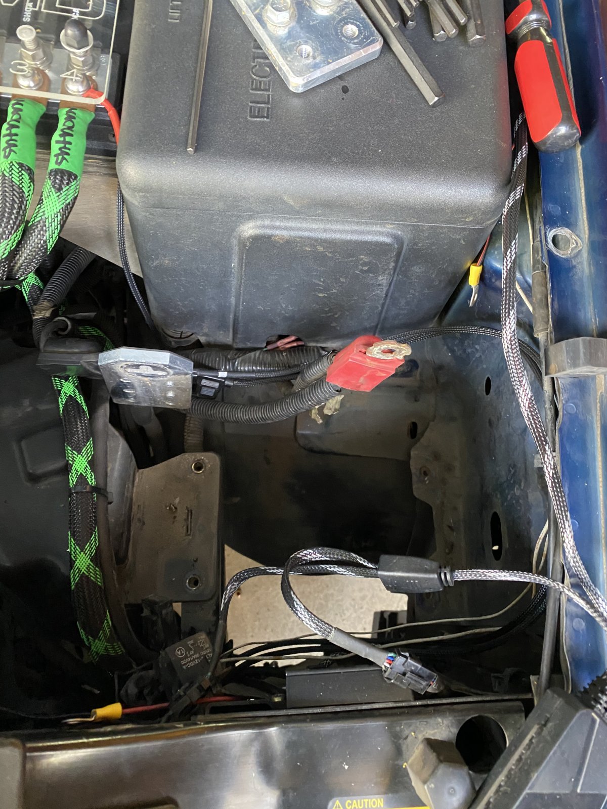

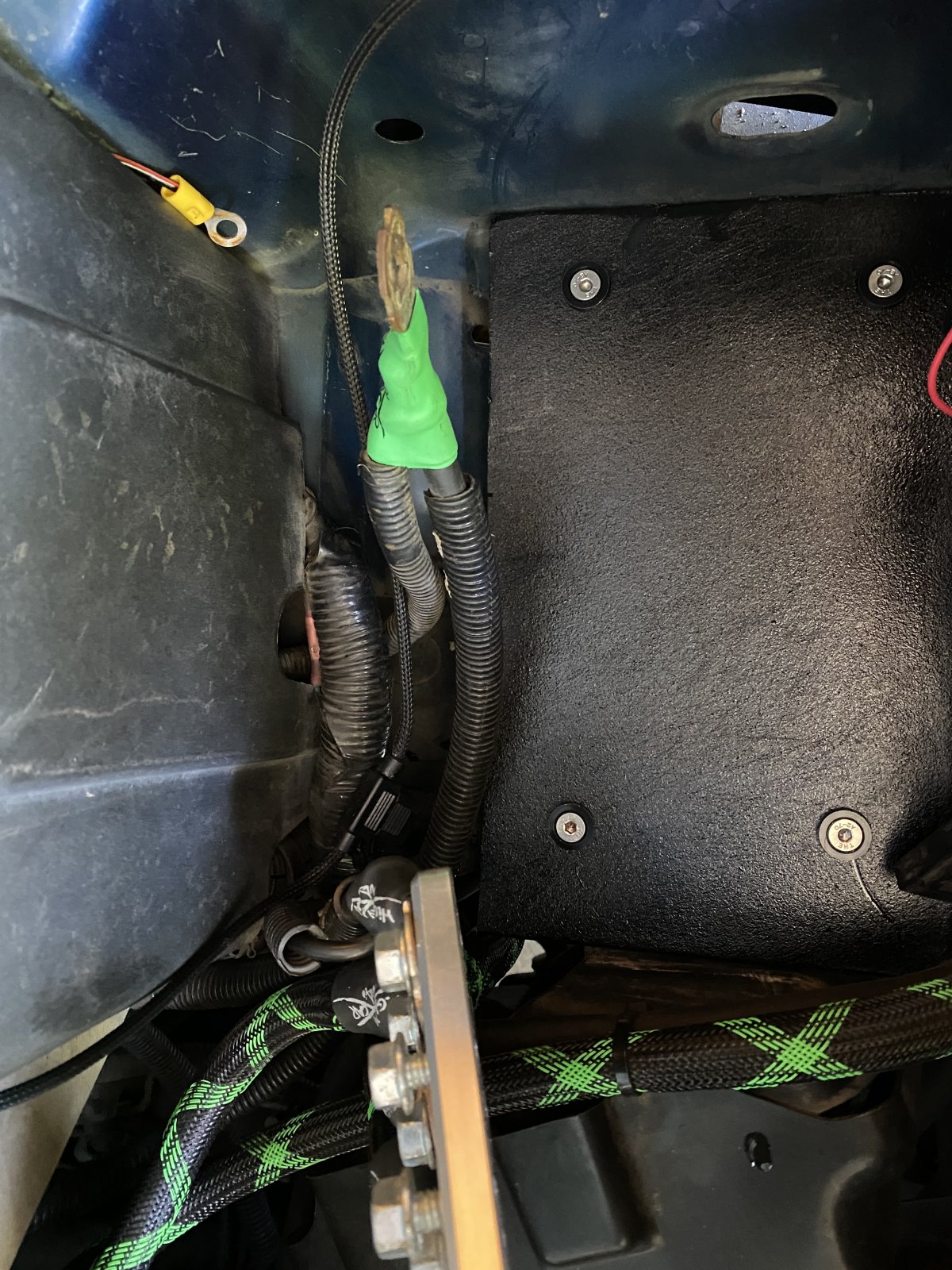

Battery delete under the hood is done. Used a 1/2” piece of plastic for it. Basically like cutting board material. Simple and easy plus made room for my hid ballasts and demon eye controller.
Finally got a new window wash reservoir but not the most excited on where it’s at. It works for now but I think I might try to hide it more.
Also Went down to the hardware store and picked up some stainless bolts and countersunk washers to replace the fender and hood bolts.

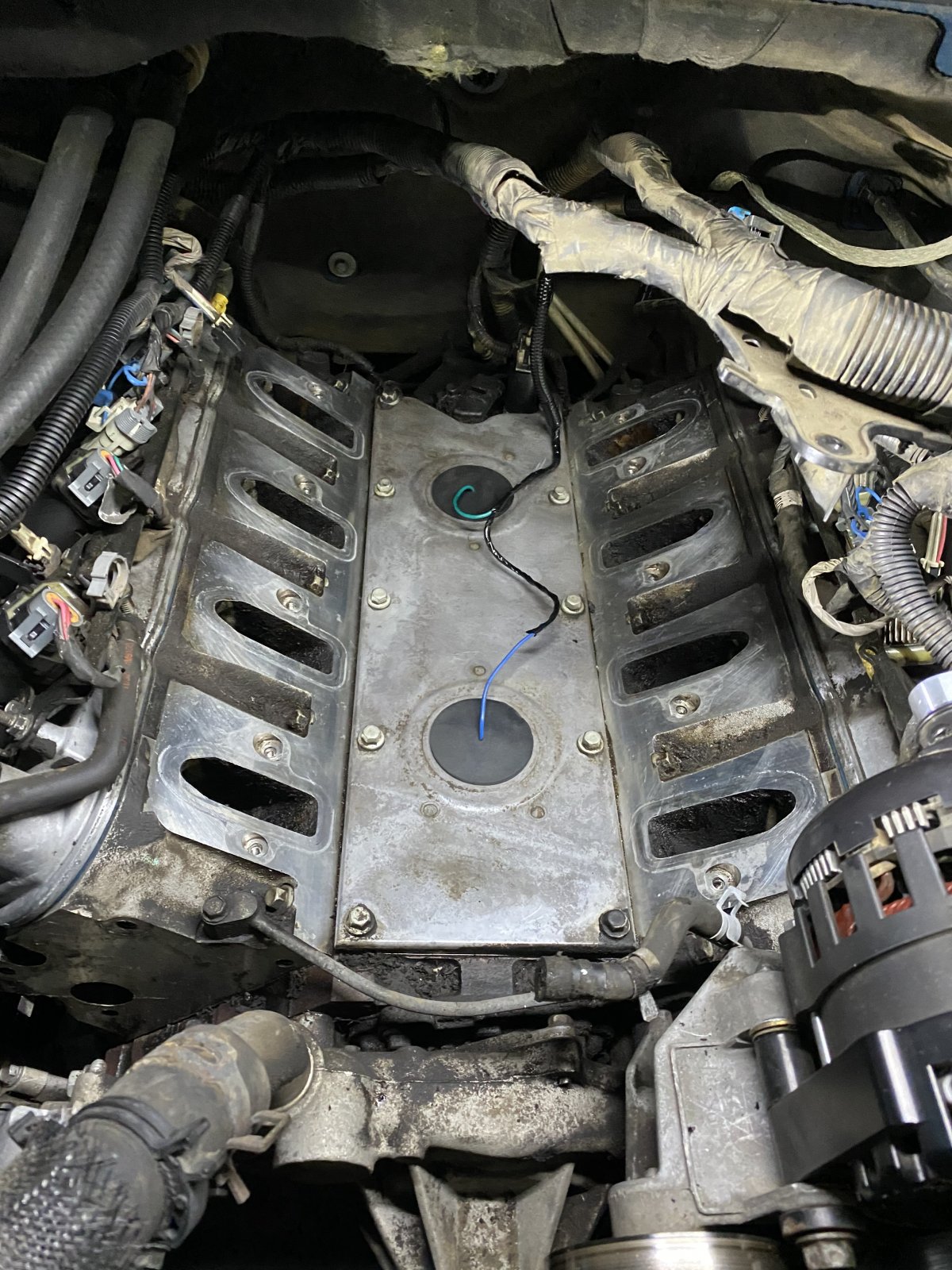

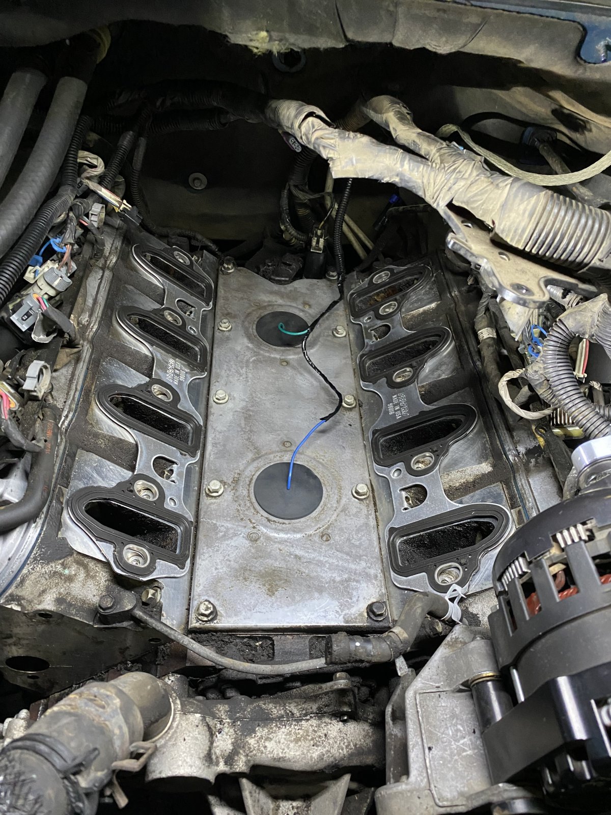

I really thought this was gonna go differently than it did. I mean knock sensors aren’t that much to deal with right?!
Apparently I was wrong hahah. now to explain.....

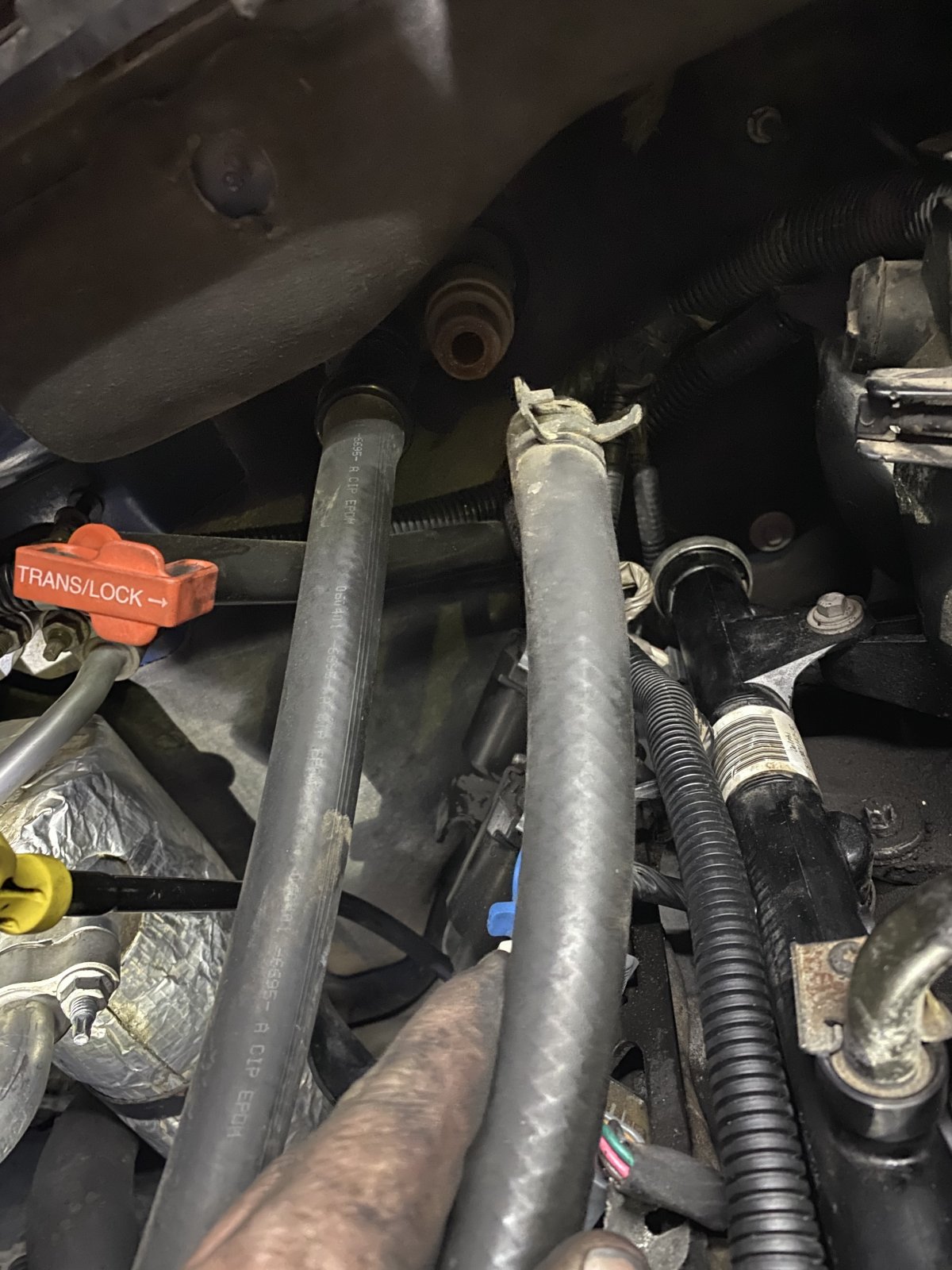

Everything started out okay at first. no problems disconnecting anything(besides the c clip on the stupid CC connector to the throttle body that disappeared), that is until I got to my fuel lines. the plastic quick release tools i had wouldn't release the lines. Drove to my buddies across town to get a metal set. got those off and boom manifold was off finally. 210k miles without ever being taken off looked like this.
YIKES:grumpycat:
After spending about a solid hour cleaning it i finally got it as good as it was going to get unless I busted out the pressure washer which was something i really didnt care to do lol. Figured while i was there i should replace the factory oil pressure sensor. Well i did not realize how long it was and i did not have a 1 1/16 socket deep enough for it... found out finally that i could loosen the cam position sensor next to it and twist it far enough to get some pliers on it and tighten it down.
(i forgot to take a pic before i swapped the knock sensors and oil pressure sensor in.)
So now the oil pressure sensor is in, knock sensors w/ new harness, and everything is cleaned on the motor ready for gaskets and intake manifold
I went with the FEL-PRO metal/rubber gasket kit instead of sticking with the flemsy plastic factory style crap.
finally can get the manifold back on!

Alrighty problems should be solved now, easy sailing.....HAHAHAHAHAHAH
intake went back on okay for the most part, got all the bolts started, then went to grab my in-lbs torque wrench. I completely forgot that the one I have only goes as low as 100 in-lbs. If you have done these proper procedure is 44 in sequence, then 89 in sequence. At this point its 1030 thursday night, I need this thing back together so I did a little research.
According to FEL-PRO that gasket is okay to be over torqued(it was made to not fail like the oem style gaskets). so i went in sequence with a 1/4 ratchet and just snugged them all up. came back with the torque wrench at 100 in-lbs and torqued everything with my fingers crossed.

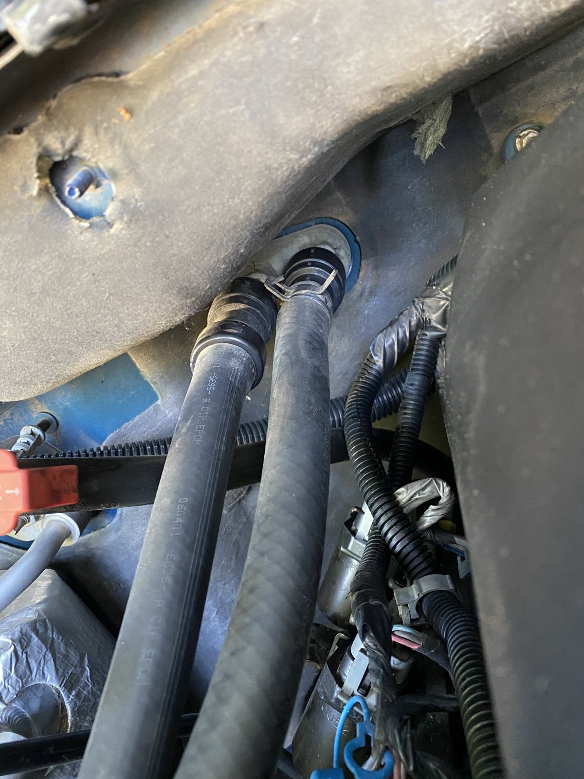

started hooking everything back up, started plugging in injectors and the first one i do i drop the retainer clip for the injector into a open valley on the manifold....Great. after pulling the coil packs off i was able to get needle nose pliers in there and retrieve it thankfully! in the process of doing that i bumped my heater core hose and guess what also was still factory. yeah that broke on me.
now its almost midnight so cant get a new connector. figured id get everything else connected then swap that after work today. last thing i went to do is twist the pcv hose to put it back in the valve cover, aaannnddddd that snapped in half. i was done for the night after that.
but it is all fixed now thankfully, definitely gonna do a oil catch can here soon after seeing the inside of my intake and head. everything went back together smoothly after this and she is running great now. idles smoother, seems to have better throttle response, and all around more smooth!
