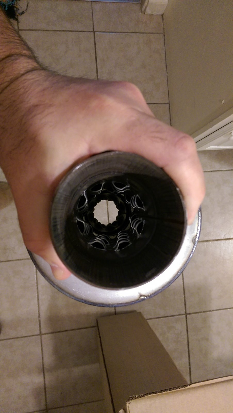

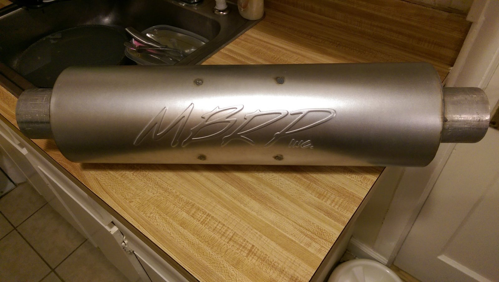

Thanks Tony. Did you know that MBRP makes aftermarket mufflers for snowmobiles. that's a single Muffler? Would be nice if the fuel tanks were located in the back of these trucks so a guy could run old school dual exhaust dumped right before the rear axle so you would have double the sound double the drone and double the gas fumes.

Thx. I do love how it sounds, but sometimes the drone just gets to me. If it's running outside you def feel the vibration in your house lol. If you can--I highly recommend doing a cam. More smiles to the miles :D:D:D. Def shocks the hell out of people. Who would hot rod a Tahoe;)?

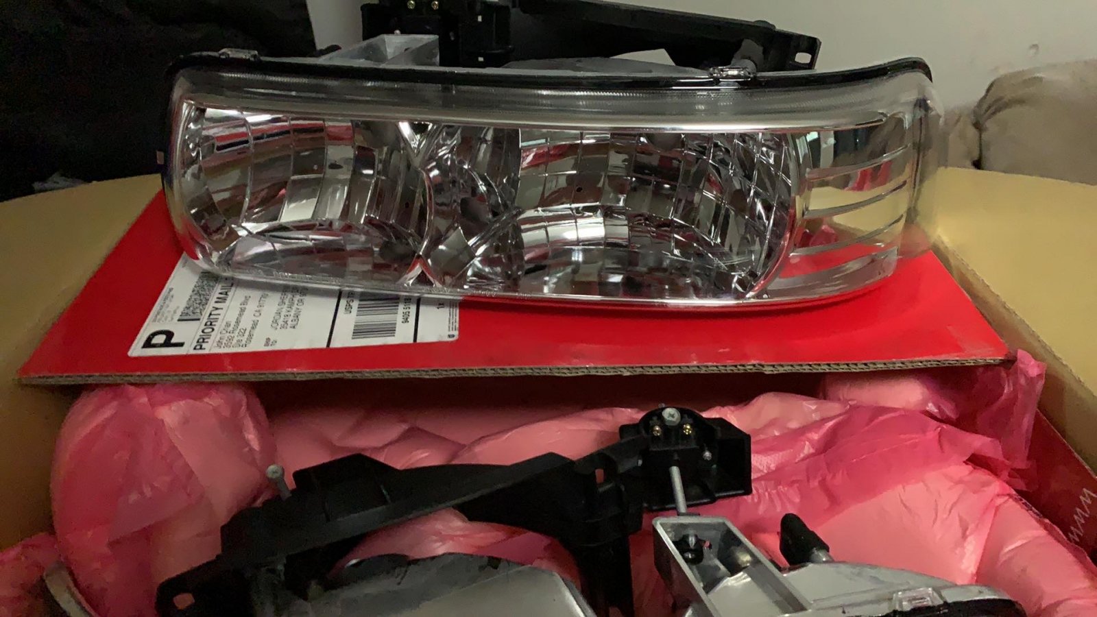

Alright. Maybe this weekend or sometime next week will be round 3 of headlight retrofit I will say I’m getting pretty quick at doing it now:emotions34::emotions34: I thought I could let the ****** fitment of these spec d lights go but I can’t so I ordered these spyder housings. Have to test fit them before I open them up but just looking them over last night they seem a lot better quality and more sturdy so let’s hope the fit is as good
if these don’t fit the way I want then I’m just gonna order some depo projectors and throw my projectors in them like @05Single did. Fingers crossed though

I gotta figure out how to make mine perfect first before I attempt anyone else’s stuff. They aren’t super hard to do it’s making sure the fit is good and they don’t fog up. My biggest problem has been the stupid housings not being able to find a quality set. Still haven’t test fitted these spyders yet been too busy unfortunately. But I’ll get there lol yukon should be a little easier seeing as the housing is bigger. Stupid trial and error I tell ya.

You have to open them up all the way to change the projector?

Yeah you have to bake them at 270 for 7 minutes then they will pull right apart. It’s really not that bad or that hard to get them apart to put the projector in. Just takes a little trimming to get the shroud to fit right.
