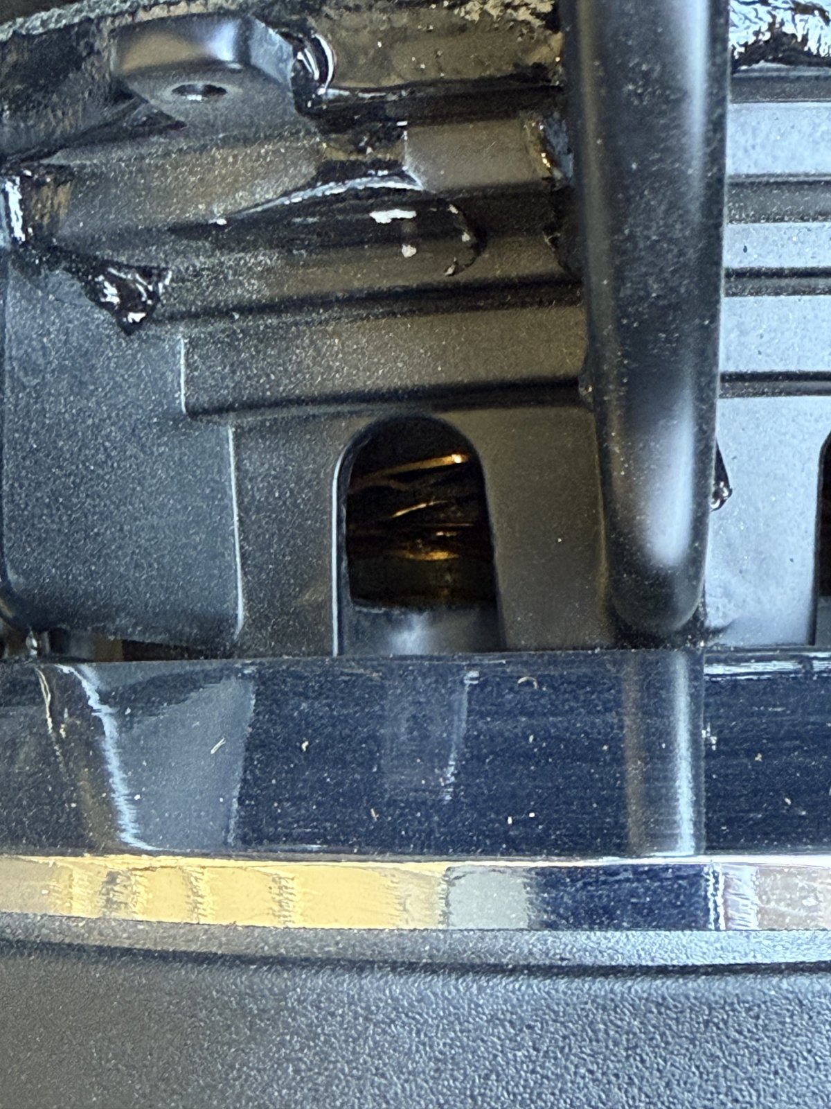

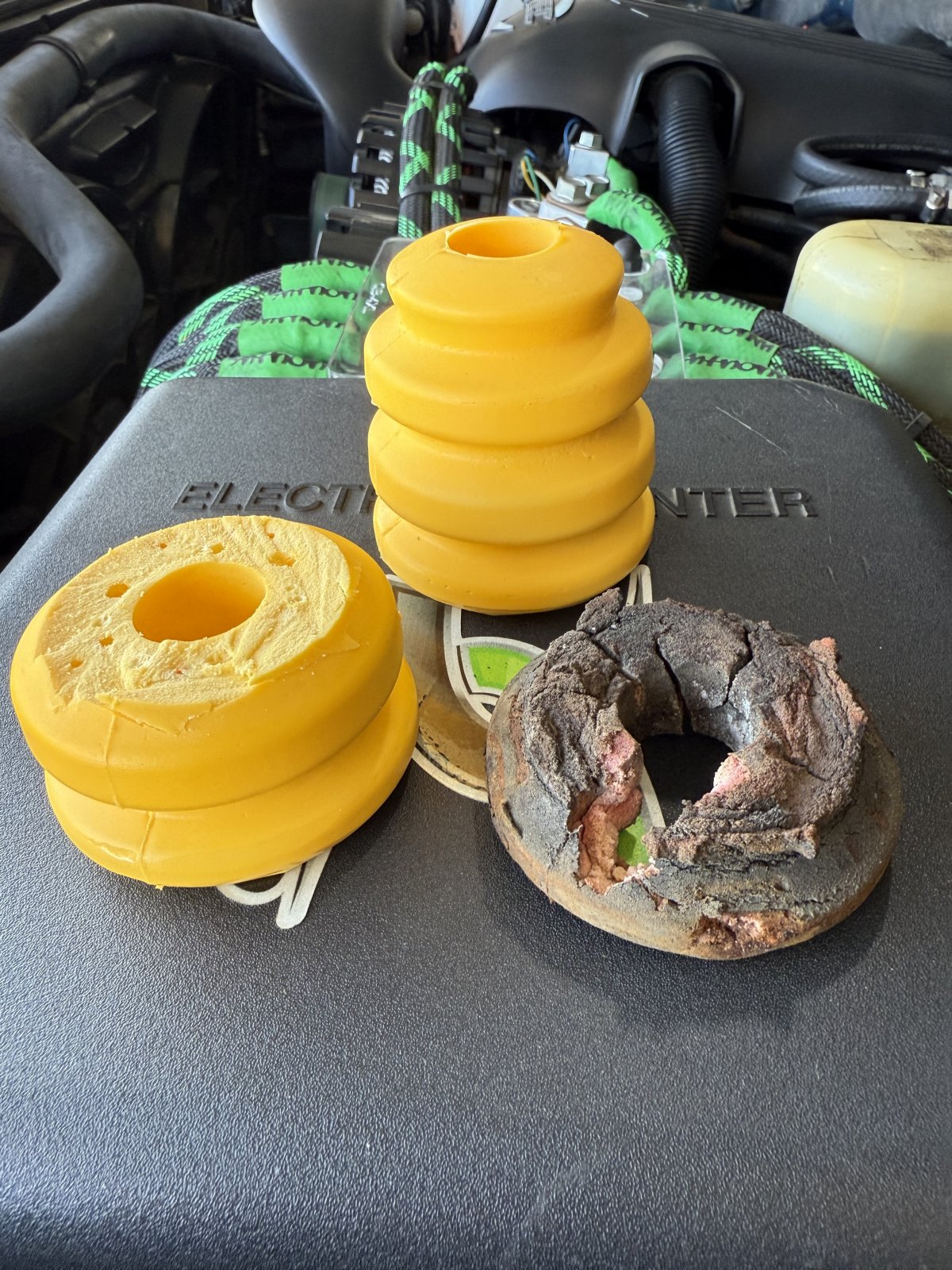

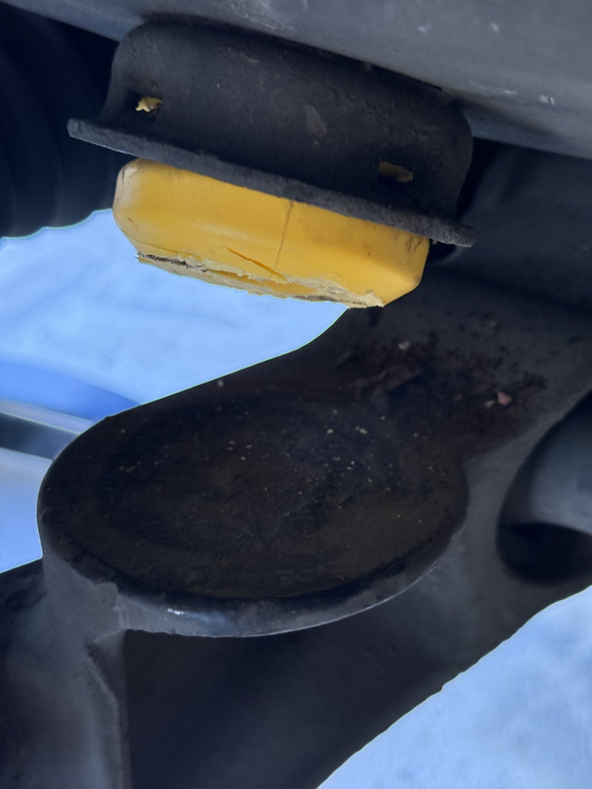

These jounce bumpers might as well have not been on lol. Cut down the new ones and swapped them out.
This was still jacked up after I put them in. I’ve never heard anything bottom out like metal to metal but they do sit awful close when it’s on the ground.
This was still jacked up after I put them in. I’ve never heard anything bottom out like metal to metal but they do sit awful close when it’s on the ground. View attachment 464559

I haven't been through this whole thread but can tell you that the front jounce stops should contact the lower control arms at ride height. Contact is intentional and stabilizes the suspension somewhat.
They do now with the new ones at ride height. I was saying with the old ones I’m surprised I never heard any metal to metal with them before from being so deteriorated.

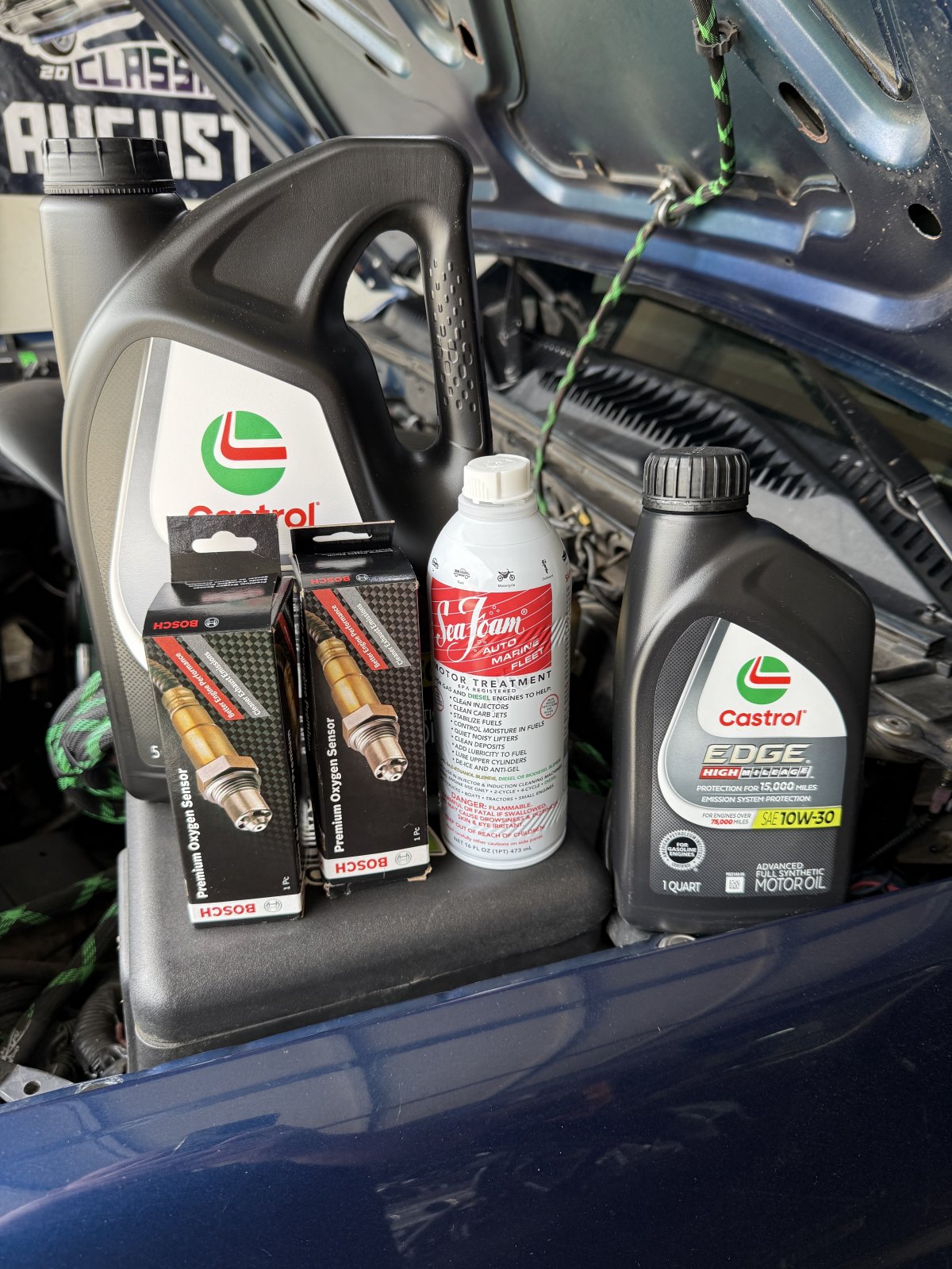

Been getting an occasional code for the o2 sensors this past week. Them being like 8 years old and driving around 1k miles untuned probably didn’t help.
Got those swapped out, oil change done, fueled up and tuned my amps. All that’s left to be ready for the show really is an inside-out clean this week.
