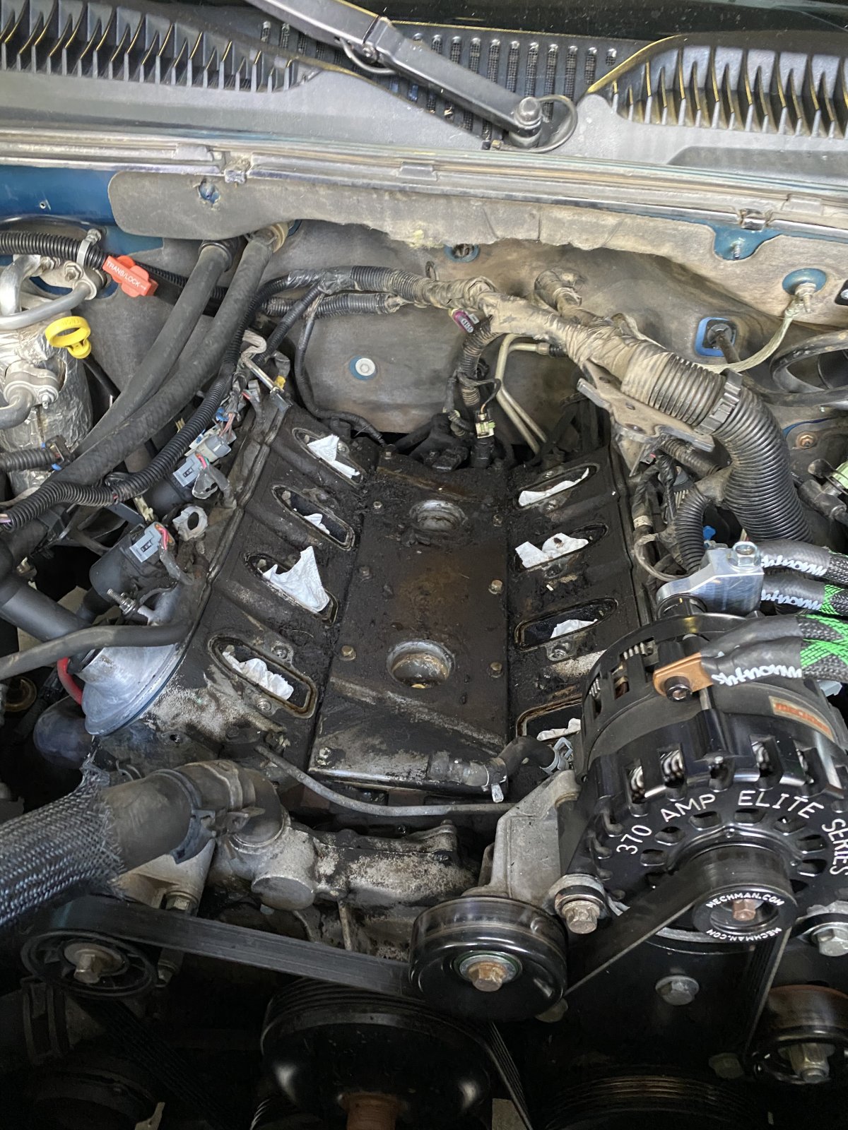

I really thought this was gonna go differently than it did. I mean knock sensors aren’t that much to deal with right?!
Apparently I was wrong hahah. now to explain.....

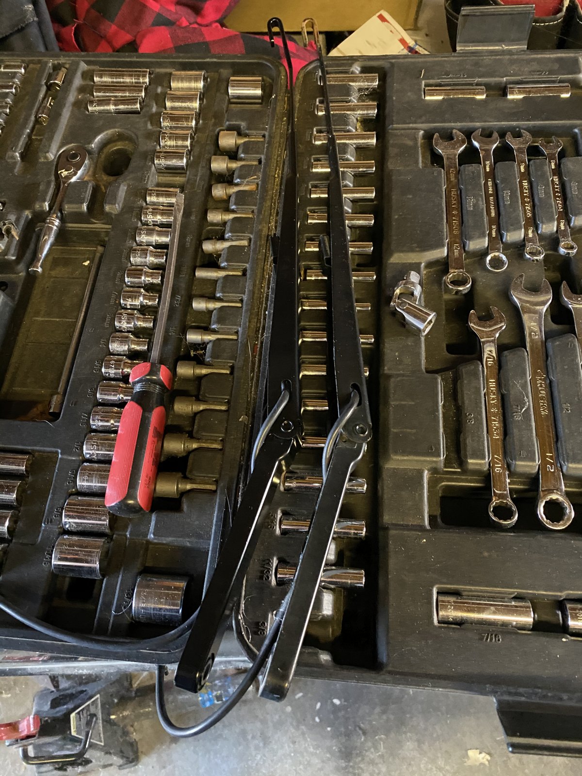

Everything started out okay at first. no problems disconnecting anything(besides the c clip on the stupid CC connector to the throttle body that disappeared), that is until I got to my fuel lines. the plastic quick release tools i had wouldn't release the lines. Drove to my buddies across town to get a metal set. got those off and boom manifold was off finally. 210k miles without ever being taken off looked like this.
YIKES:grumpycat:
After spending about a solid hour cleaning it i finally got it as good as it was going to get unless I busted out the pressure washer which was something i really didnt care to do lol. Figured while i was there i should replace the factory oil pressure sensor. Well i did not realize how long it was and i did not have a 1 1/16 socket deep enough for it... found out finally that i could loosen the cam position sensor next to it and twist it far enough to get some pliers on it and tighten it down.
(i forgot to take a pic before i swapped the knock sensors and oil pressure sensor in.)View attachment 252182
So now the oil pressure sensor is in, knock sensors w/ new harness, and everything is cleaned on the motor ready for gaskets and intake manifold
I went with the FEL-PRO metal/rubber gasket kit instead of sticking with the flemsy plastic factory style crap.View attachment 252183
finally can get the manifold back on!

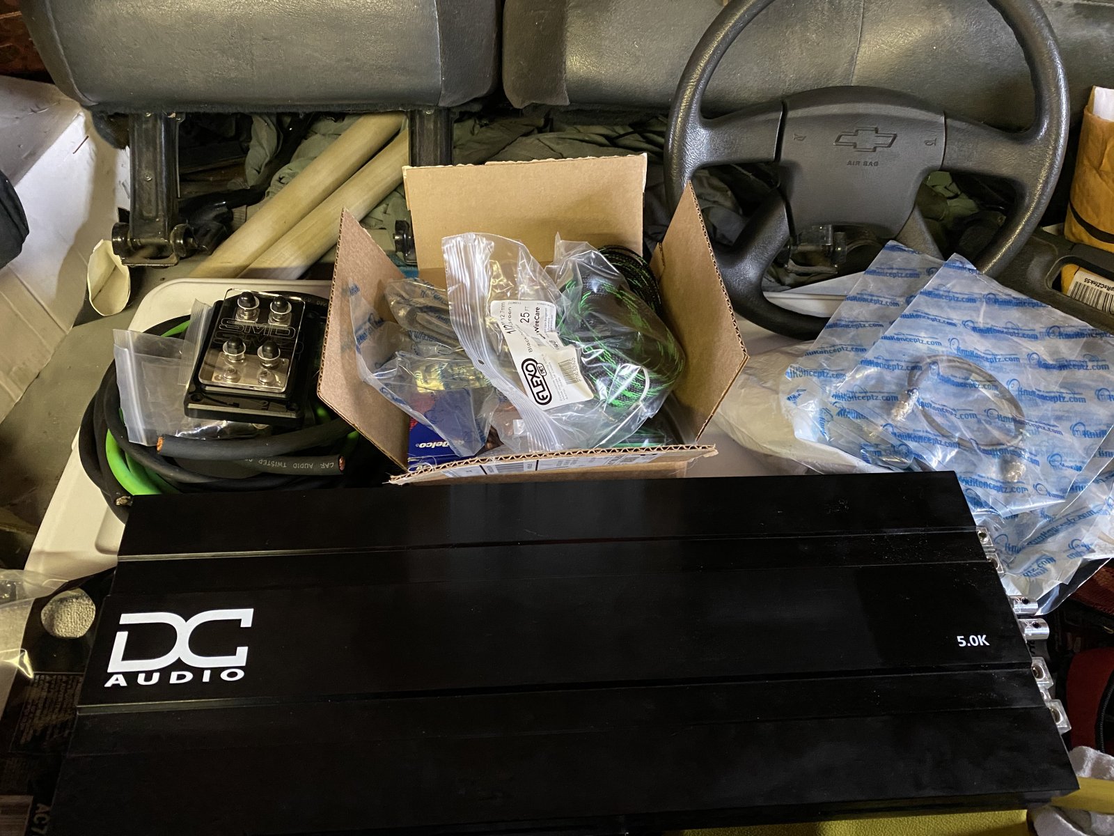

3rd 5k. 10,000 not enough !! New steering wheel nice. I just wish the 00-02 had the radio control on them.
haha yeah it’s always been the plan to run a 5k per pair of subs in this. Right now I have one 5k per 3 wired at .33ohm. So the amps currently will heat up a little quicker with how low of impedance they are set at. Once I get the third amp in I’ll be at .5ohm per pair of subs. Might not gain a lot on the meter but amps will be a lot happier and I’ll be able to play longer without stuff getting hot.

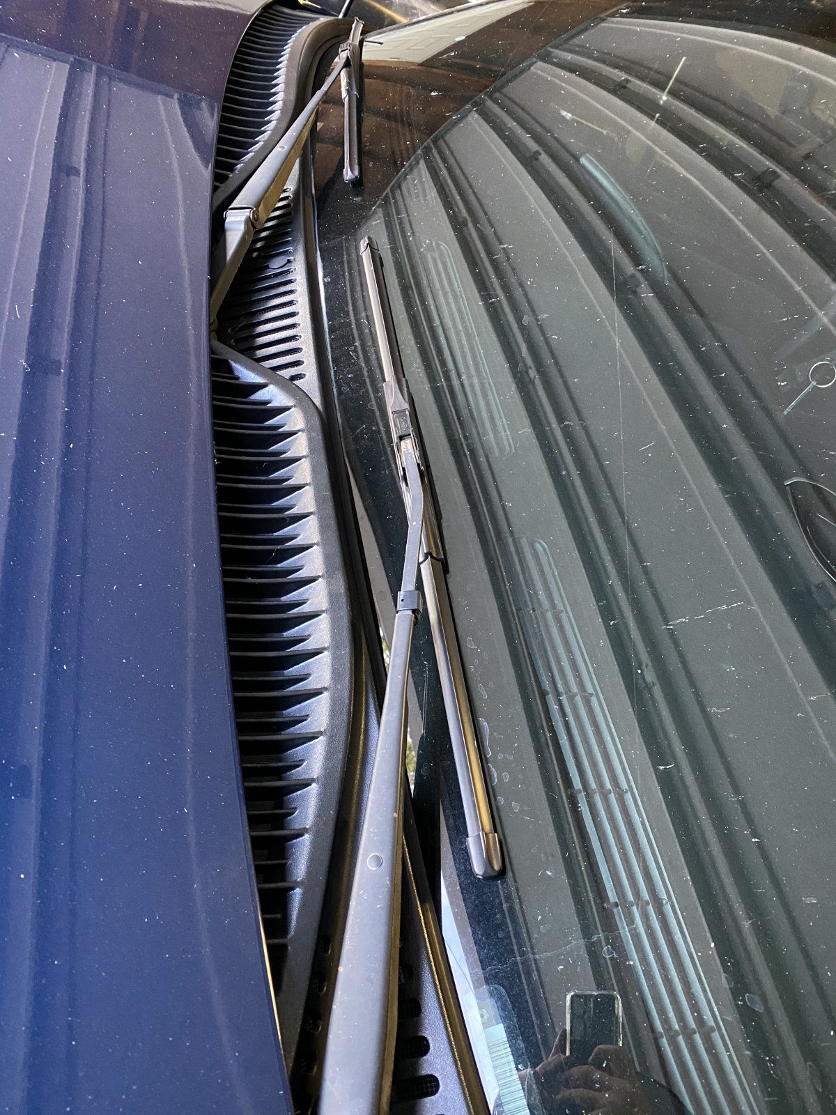

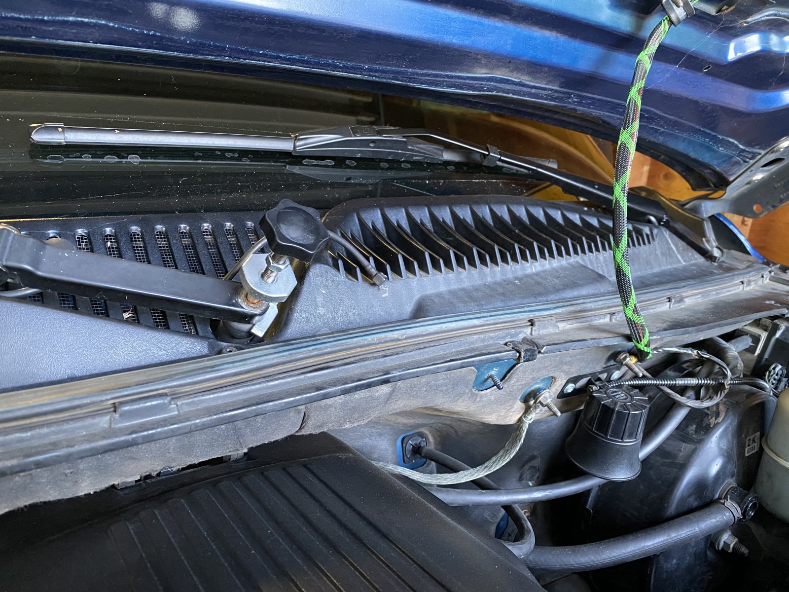

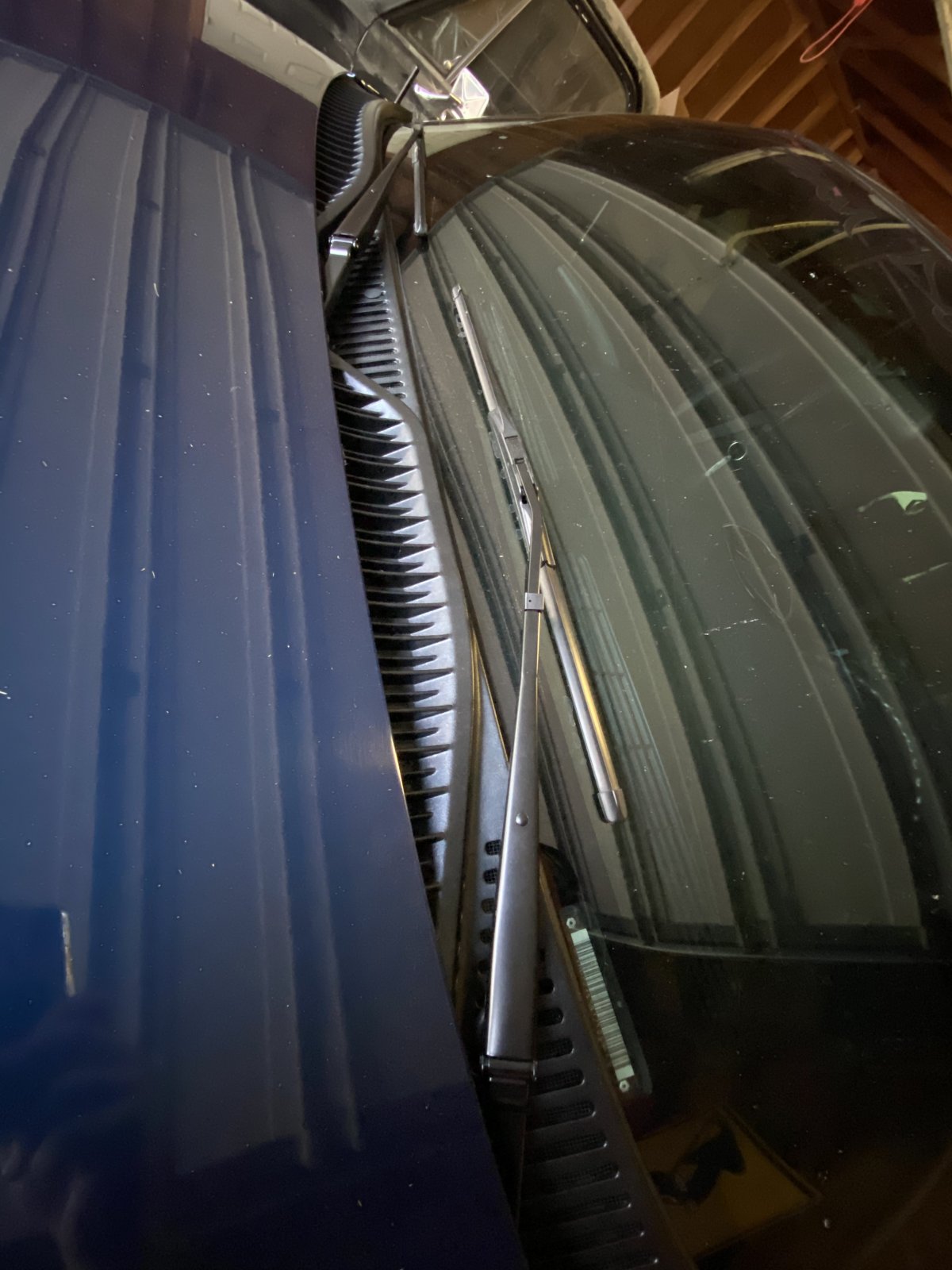

My lady got me some new oem wiper arms cause and I quote, “mine were chipping, rusty, and gross.” Love having a car enthusiast girl lol.

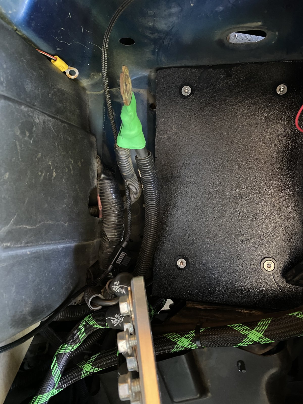

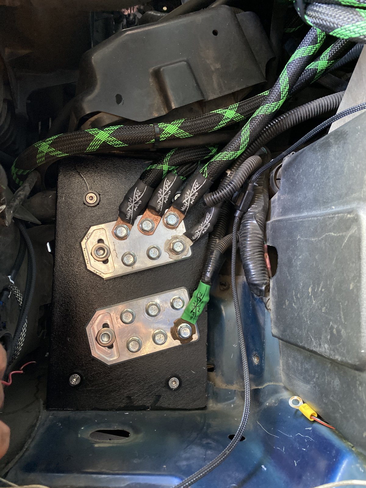

When I originally cleaned everything up audio wise I ran out of green heat shrink so my power runs on the alt always had black and it’s dumb but it always irritated me to look at and I got them switched out to green today. Also better view of the battery delete and washer bottle that my tires won’t desroy

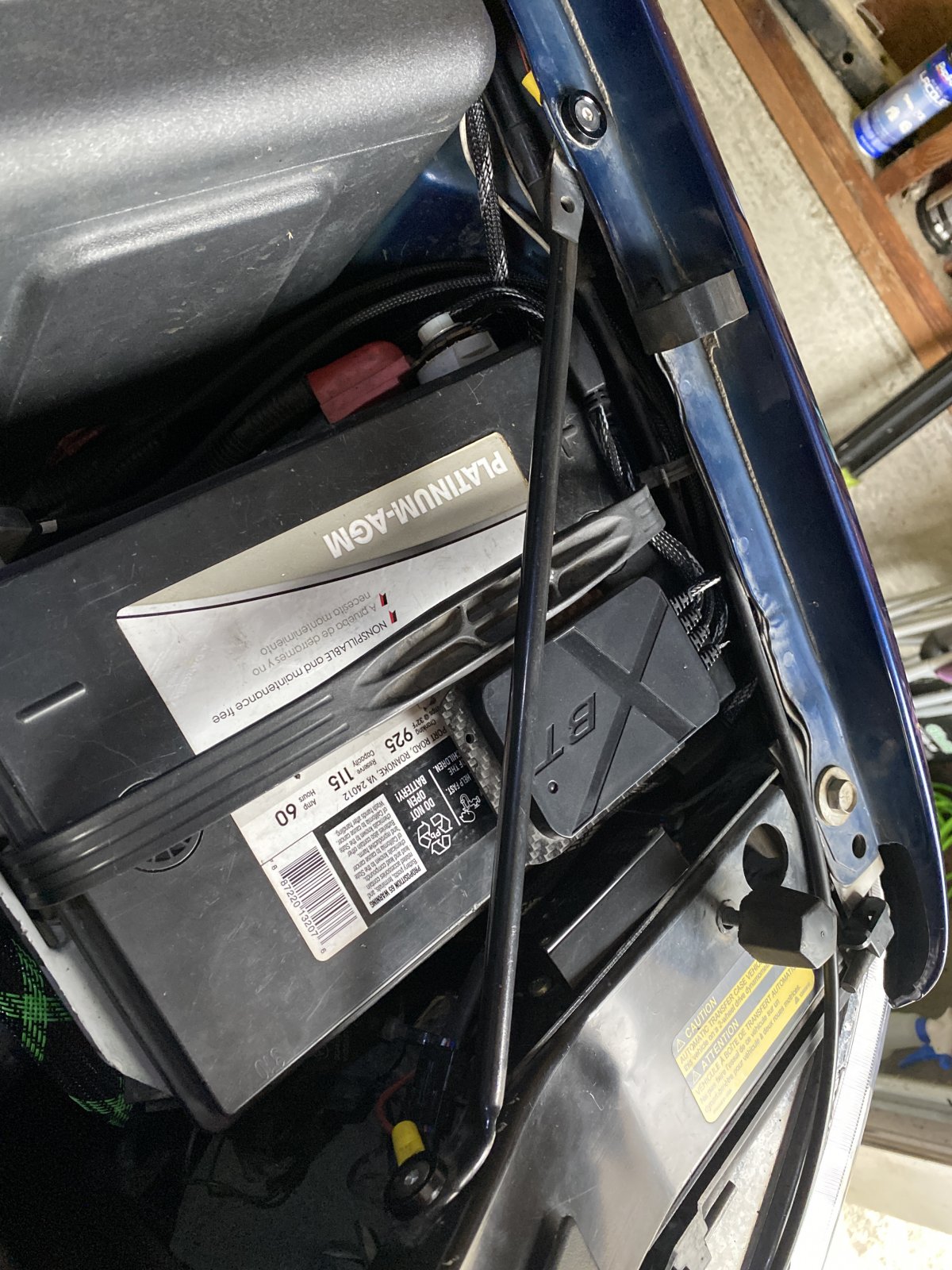

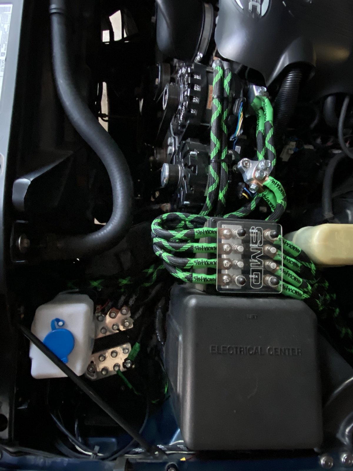

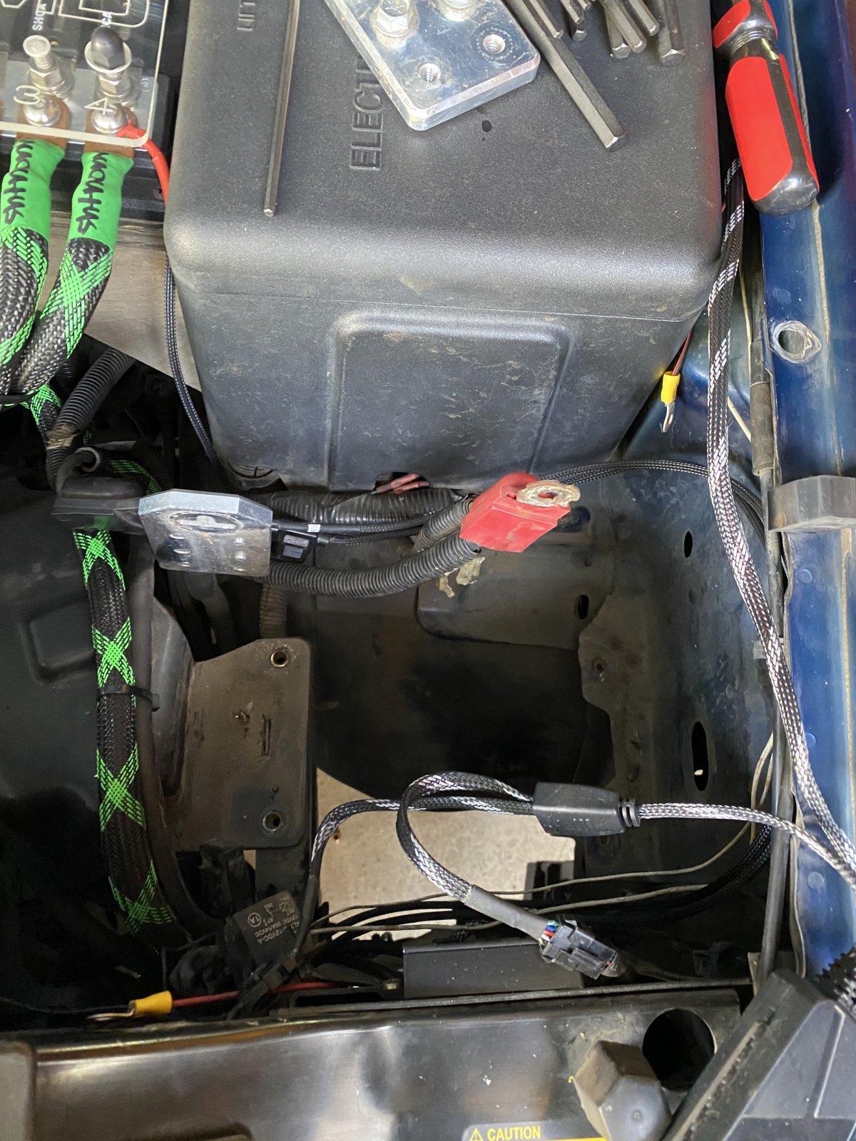

Battery delete under the hood is done. Used a 1/2” piece of plastic for it. Basically like cutting board material. Simple and easy plus made room for my hid ballasts and demon eye controller.
Finally got a new window wash reservoir but not the most excited on where it’s at. It works for now but I think I might try to hide it more.
Also Went down to the hardware store and picked up some stainless bolts and countersunk washers to replace the fender and hood bolts.
View attachment 251923 View attachment 251924 View attachment 251925 View attachment 251926
Where did you mount the battery?
