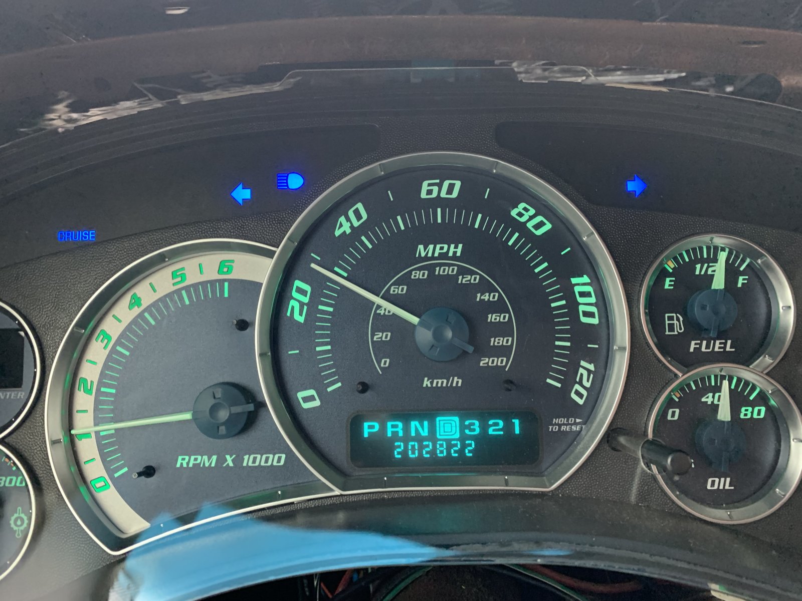

I don't feel bad about it at all. If it was stuff in my way and causing problems yet I still hung on to it, then there's something wrong with me. It's just extra stuff chillin in a corner and forgotten about that ended up being beneficial to some forum members. I'm at least disposing of the tint- one odometer screen at a time!
I recommend you do at least two layers of the tint and plug in the cluster to see how you like it before putting it all back together.
I only did 1 layer myself. Came out pretty good--but 2 would've been better.

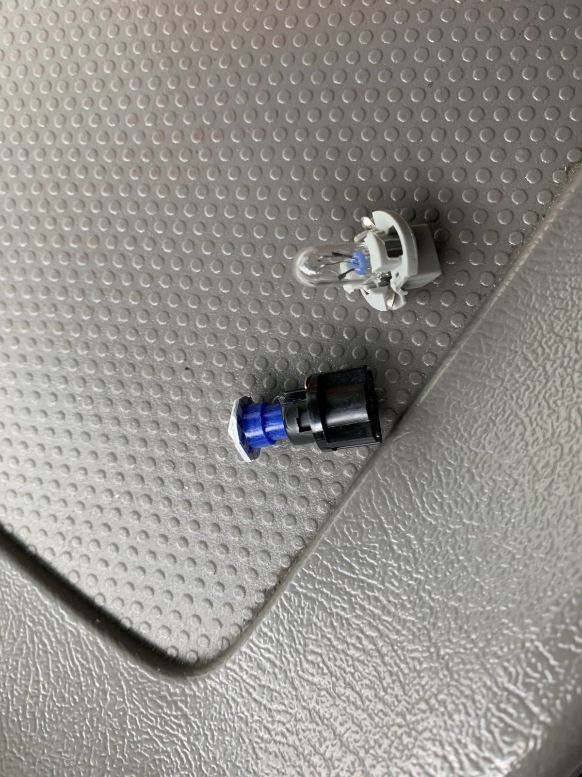

Tackled my indicator lights on the esky cluster last night. The turn signals, cruise, and high beam indicators are all twist lock with small bulbs though. Attempted to make my own with the 3mm leds but they weren’t wanting to connect correctly so first hit of bass and probably would quit working. That’s alright though I ordered new ones with blue led bulbs which might be here this week. For now got the rest swapped out and just left the factory in for those. For some reason my 4wd indicator won’t light up though. Have to look into that later not super worried since I rarely have it in 4wd anyways.

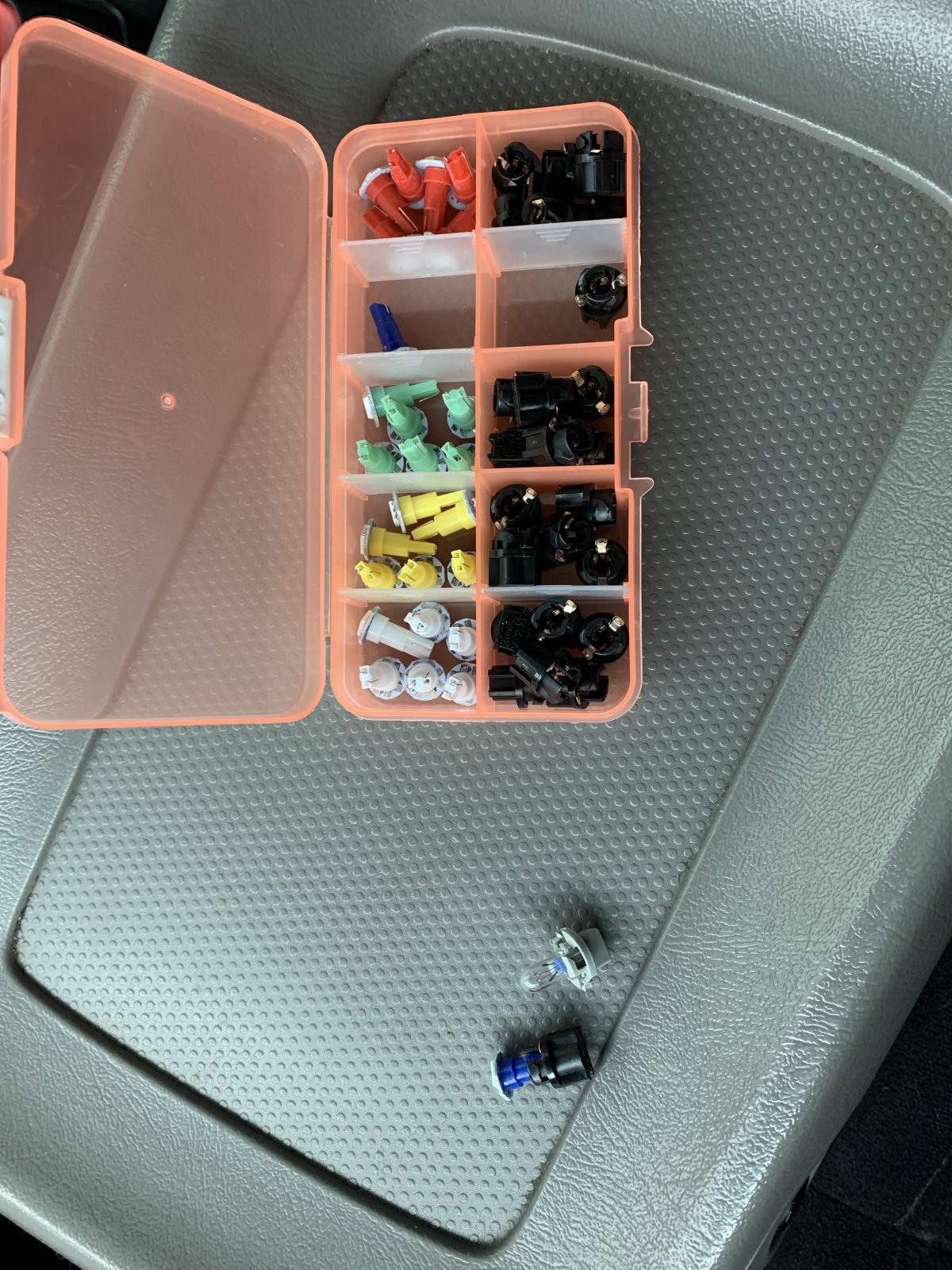

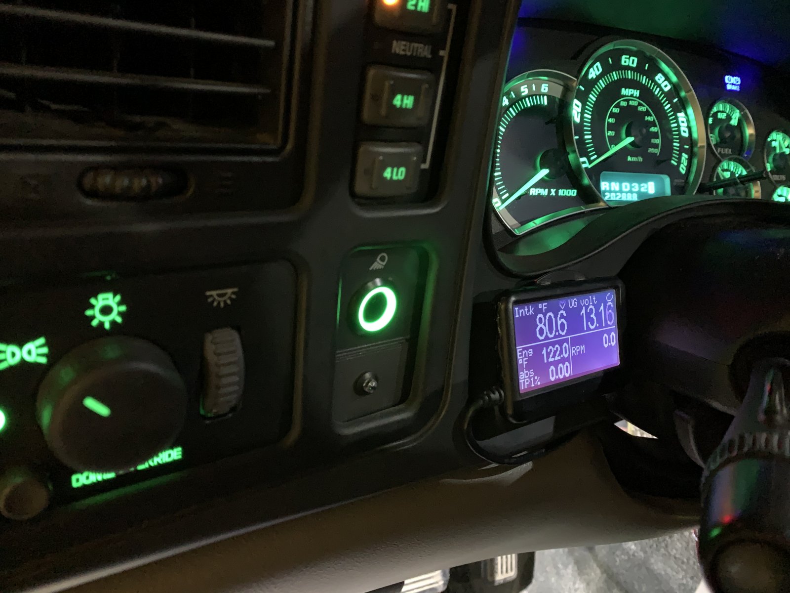

Bulbs and twist locks came in. Now it’s all blue besides the odometer. Just waiting for the film to get here. ordered a kit with white amber blue green and red it was only 10 bucks so we shall see how long it lasts.

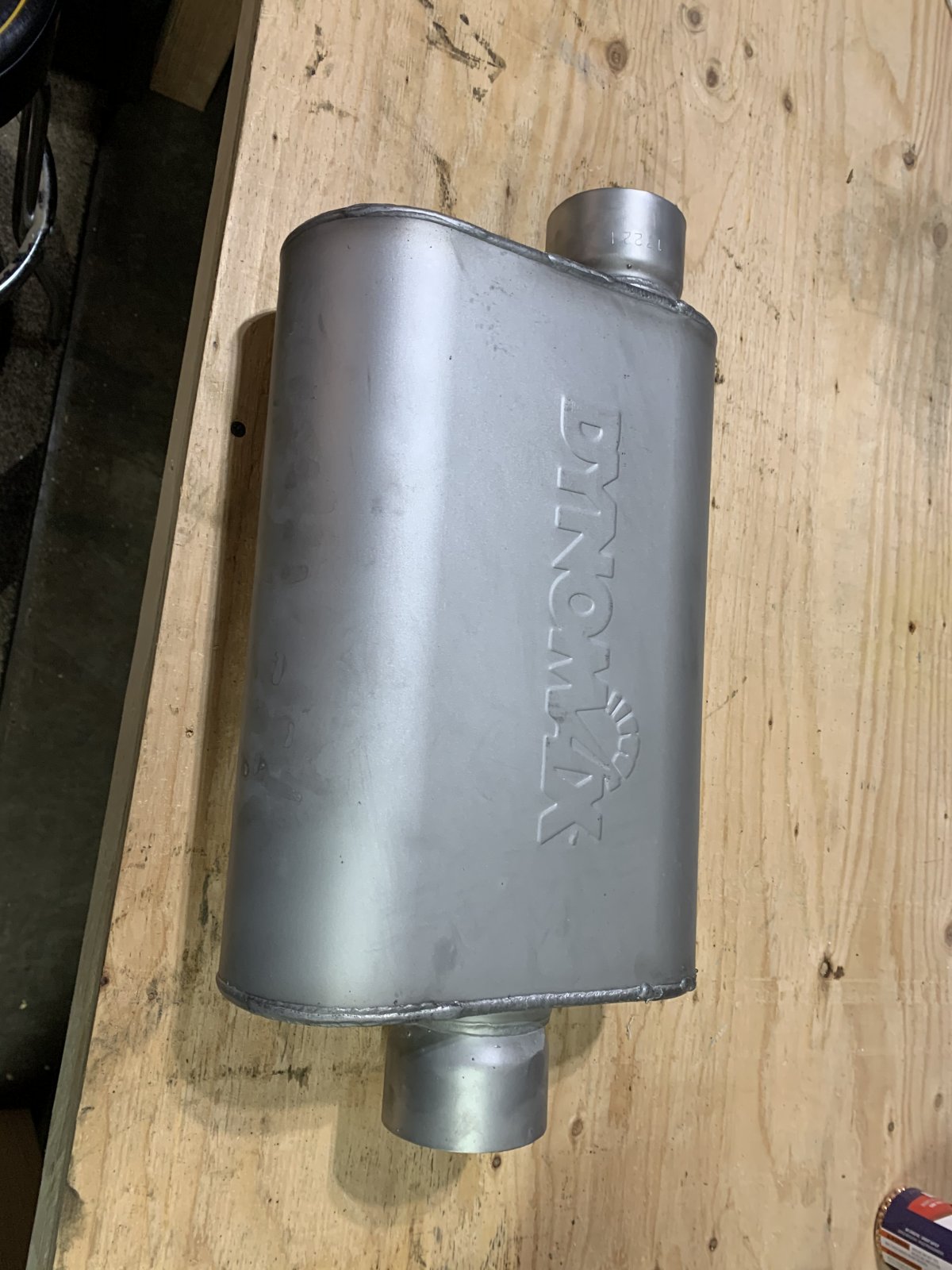

Ordered a dynomax ultra flo welded muffler. Supposed to be here Sunday or Monday. Have a flowmaster 40 on now but I didn’t put it in, it’s not the best weld job plus it’s old so I’m gonna see if I like the dynomax better. All the videos I watched on them I liked the way it sounded. No cackle or anything. Plan to order the 3” intermediate and tail pipe to replace my stock stuff anyways. So if I like it then I’ll order the rest of the exhaust. Exhaust stuff will be a month out possibly more anyways for the piping.

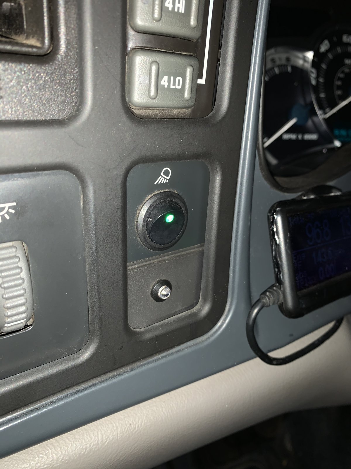

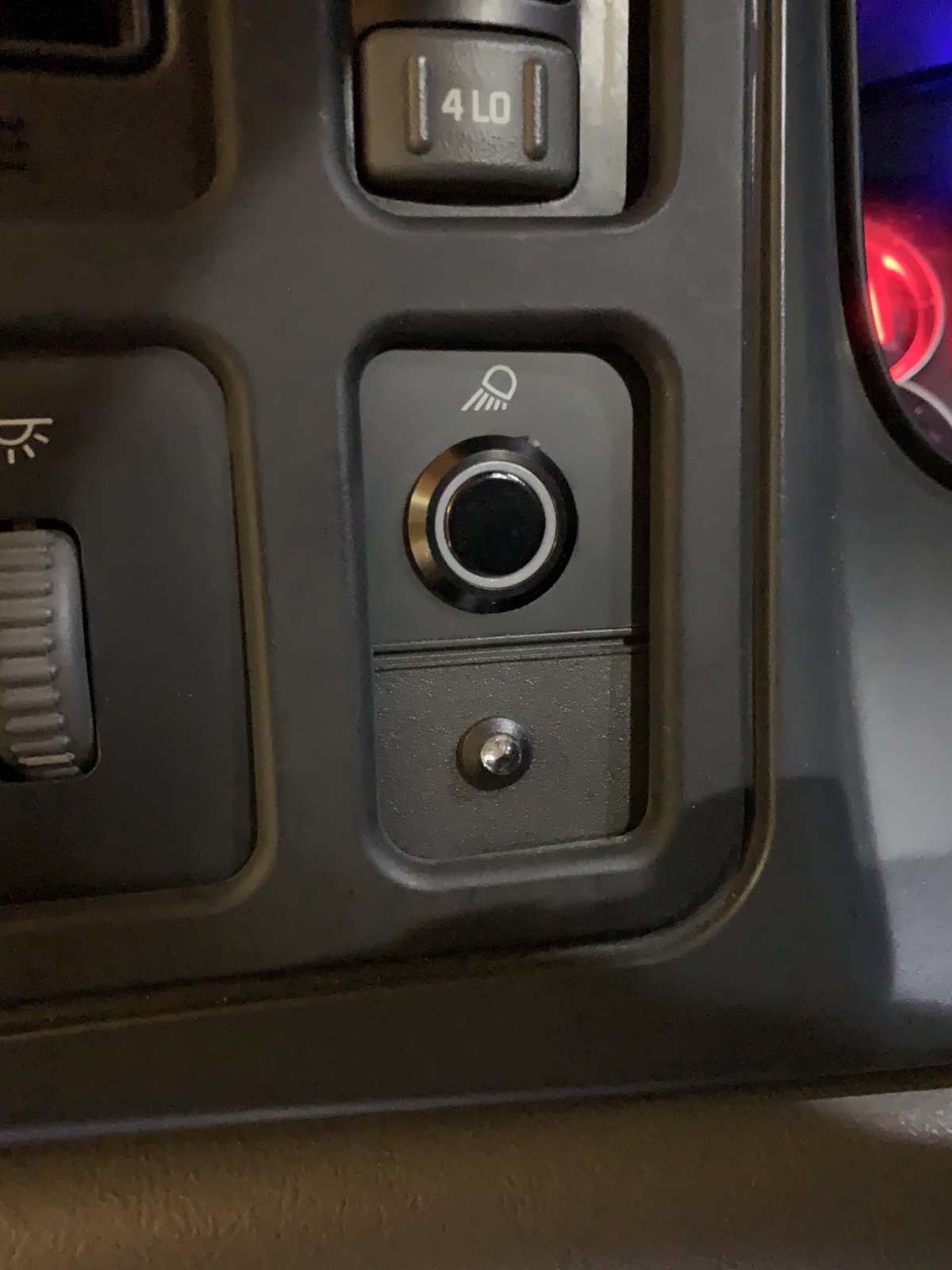

Dynomax came in today. Along with a new push button switch and the blue tint for my odometer. Haven’t had a chance to pull out the cluster to put the tint on yet.
cut out the flowmaster 40 and clamped in the dynomax. Wanted to make sure I liked it and want to be able to easily take it off when I order new piping. When p/o put on the flowmaster they welded on a like foot long section of 3” on the output and gap welded the 3” to the factory 2.75” tail pipe. So I’m definitely going to be replacing it here soon.
it’s more throaty than the flowmaster and less cackly in the high rpm range. I’d say it’s louder driving, less drone, but it’s quieter idling it seems. So far I’m enjoying it.
