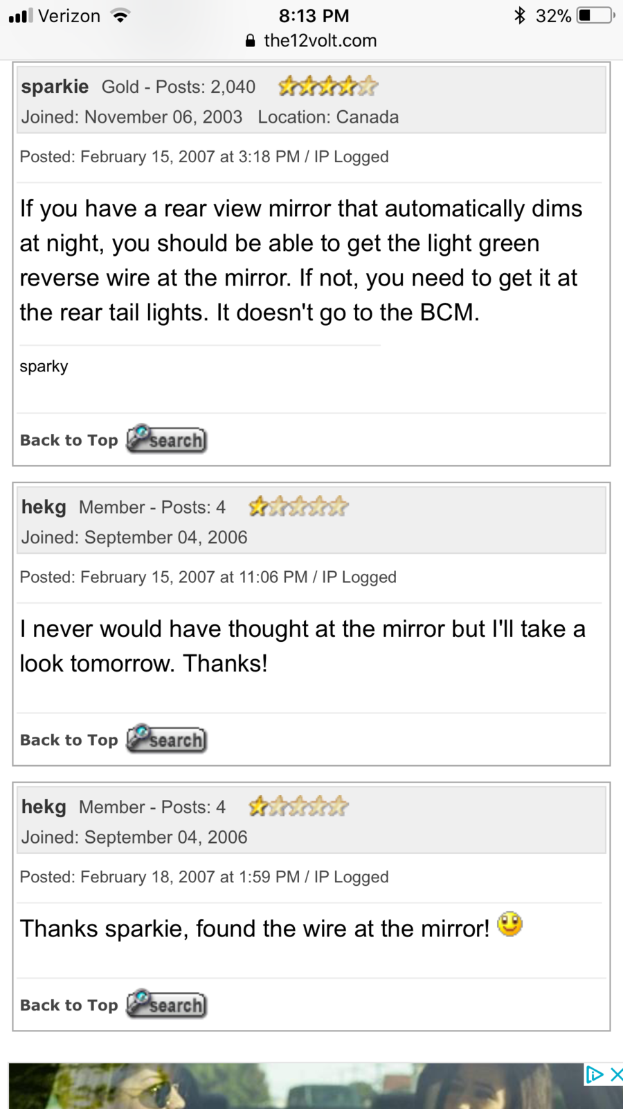

Okay, anybody at least know where the switch is located? Also what would reverse lights have anything to do with auto darken mirror?

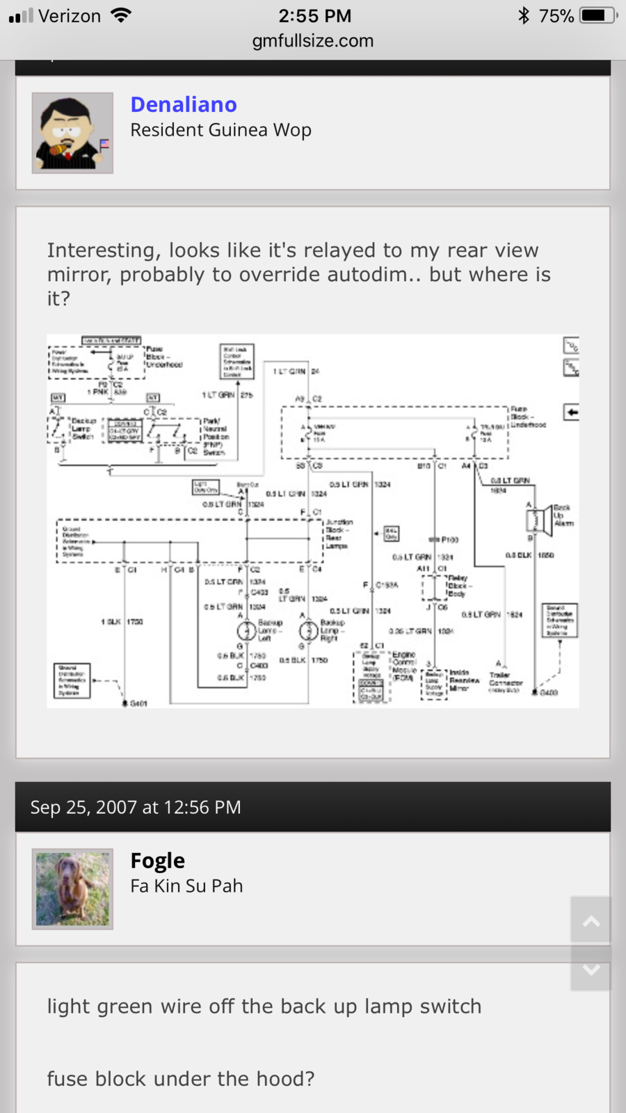

You asked, i googled and found that from some other forum... try it dude..it was for an obs truck....
PG01
Nov 6, 2016
15,676
21,079
Up here to the right
Here, schematic for an 02.... just sayin it does go thru mirror on later models....
