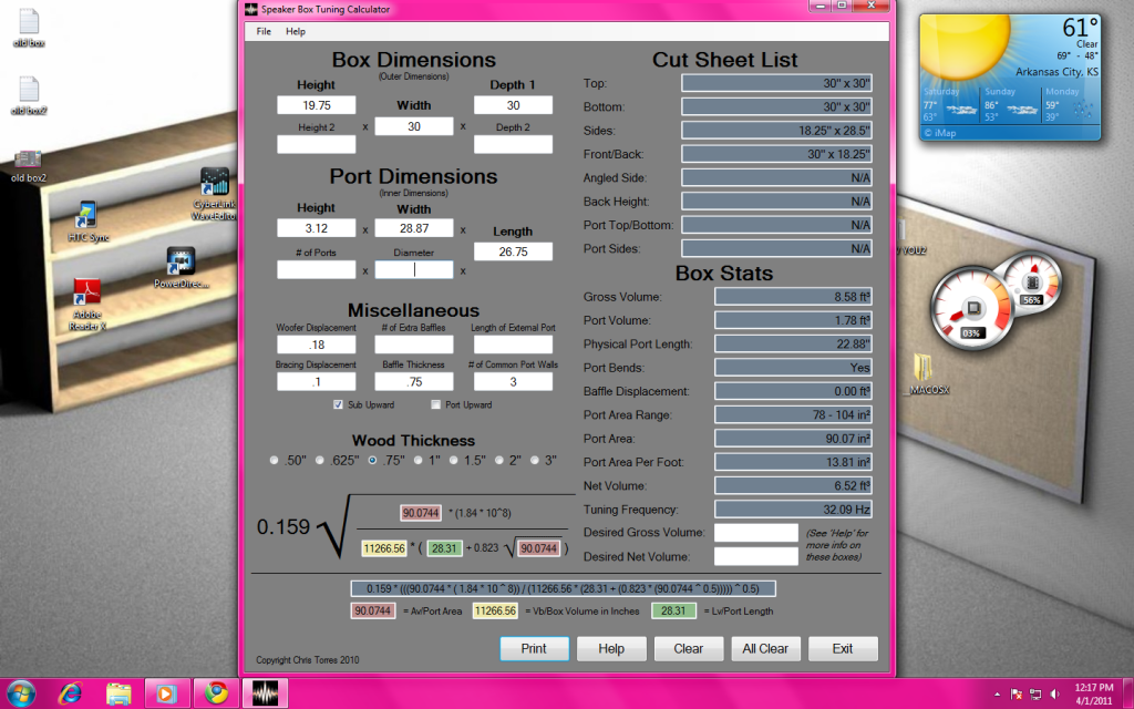

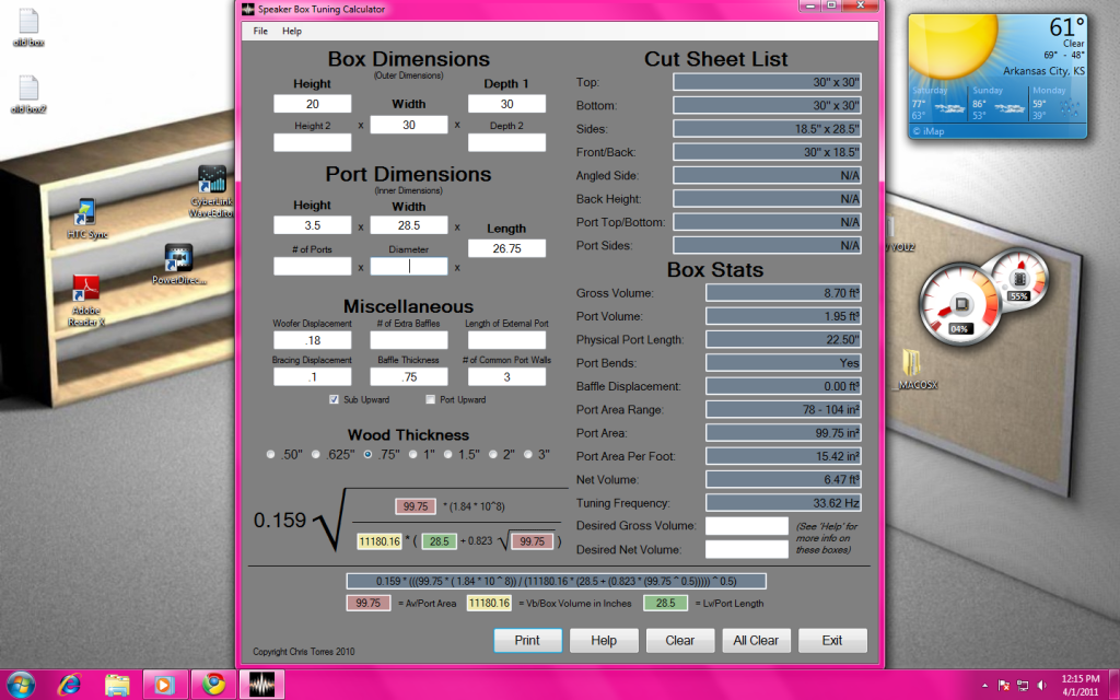

Here is the original measurements for what the box was supposed to be.
Here is how it came out.

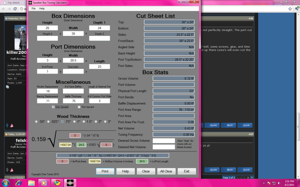

okay,now youve conviced me to just build my own. lol would it make too much diffrence if i made it 25h 30w and 24 d?

Here you go man. It doesnt say but that will put you right around 32.09hz.
---------- Post added at 02:56 PM ---------- Previous post was at 02:54 PM ----------
If you have any questions just ask ill help out. When building the box make sure the port is at least 3.5 inches away from the back wall of your box, so it will load and unload properly.
