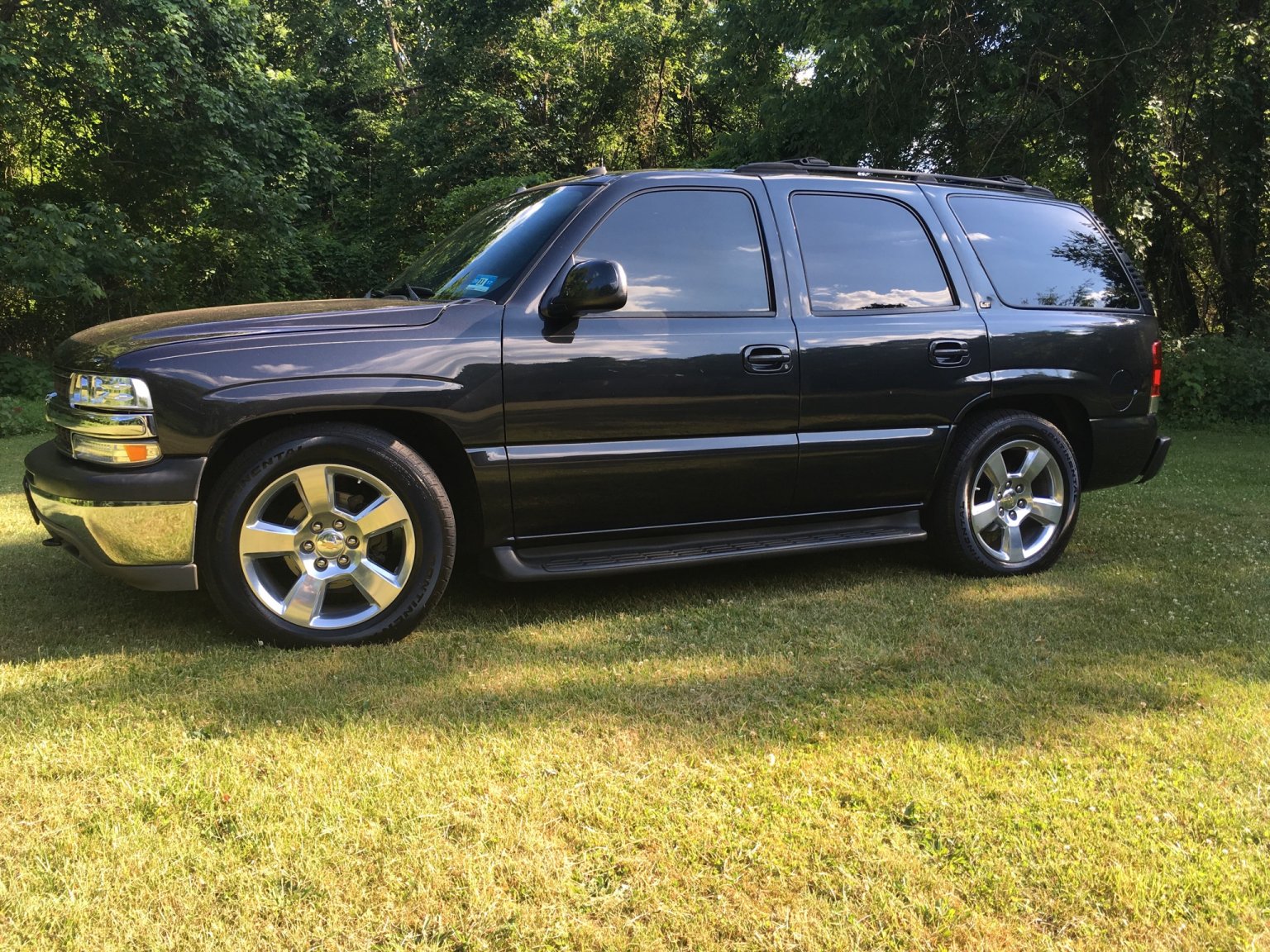

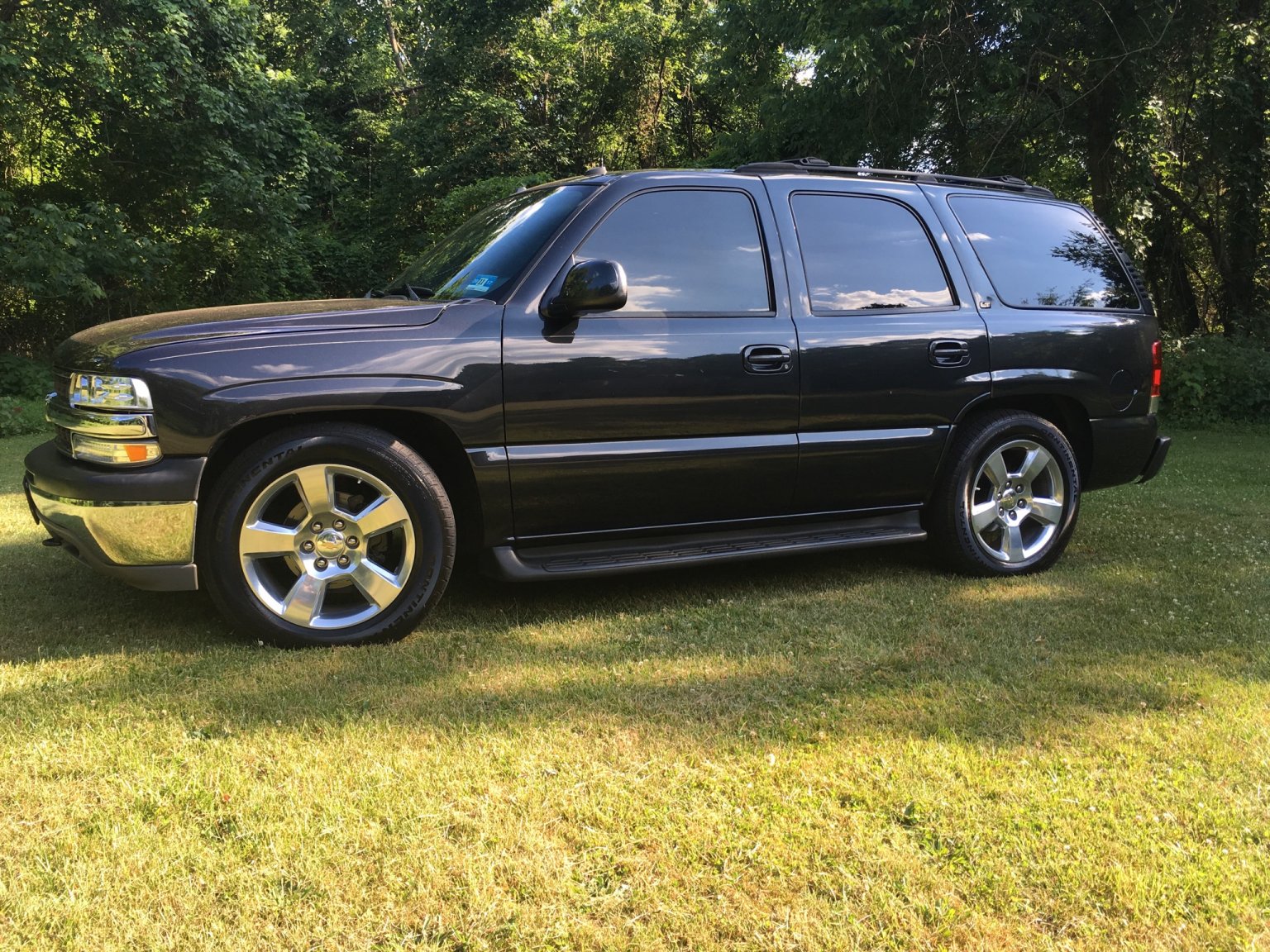

IMG_0104.JPG It's been awhile but I think it was Fosscore that made me get my 2/3 drop. Used the 2/3 spindle kit with shocks from Tony. Adjustable panbar, rear drop links, new to me 20" take offs. Did the upper and lower control arms. New swaybar bushings. Truck rode like crap over expansion joints, felt like it was going to shake apart.
Turns out the new suspension/wheels really hylighted how bad the idler and pitman arms were. Replaced those, good to go. If I were to do it again I'd get softer shocks.

View attachment 72375 It's been awhile but I think it was Fosscore that made me get my 2/3 drop. Used the 2/3 spindle kit with shocks from Tony. Adjustable panbar, rear drop links, new to me 20" take offs. Did the upper and lower control arms. New swaybar bushings. Truck rode like crap over expansion joints, felt like it was going to shake apart.
Did you get everything from Tony? In trying to go as cheap as possible. Just trying to get what I need, without touching the keys. BTW, love those wheels!
