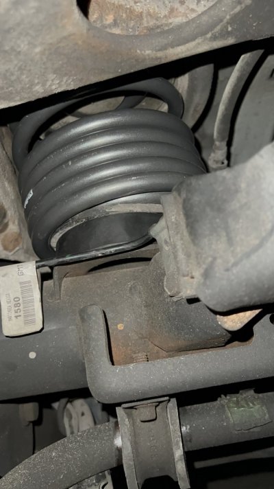

Ended up taking the lowering springs out. They rode like hot garbage. Spring rate is wayyyy too soft. Before someone mentions they’re upside down, I know they are but the bottom 5 coils shouldn’t be touching each other and flipping the spring wouldnt change anything
I think you’re finally the first person that agrees with me about those springs. Get the MaxTrac rear 4” springs if you’re using the spacer under the Belltech spring. The spring rate agrees with the auto ride much better. I went thorough a lot of springs before I found these. You also need to use either DJM or McGaughy’s rear shock extenders, they drop the shock down the most and with the 4” spring, the shock length is within 1” of factory so they will have factory travel and it won’t blow your airbags if the shocks have some age on them. The Belltech “extenders” do not actually drop the shock down at all, they just make it more vertical.

These springs are by far the worst lowering product I’ve ever installed. I could compress the spring with my fingers. I also didn’t notice the shock extenders being completely different until I looked at my suburban. And of course the DJM ones are sold out everywhere

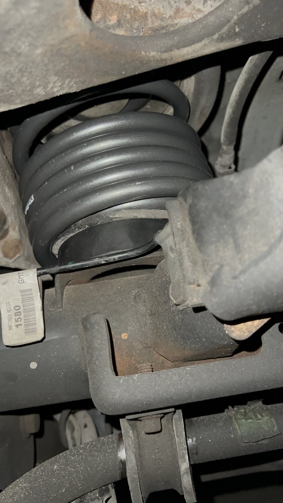

Yeah I saw them after I replied. I’m probably going to leave the suspension stock. I really don’t want to go down a rabbit hole of piecing together a lowering setup from all different places again. Pictures are with and without the rear springs

Keep the Belltech kit and just change out the rear springs and shock extenders. I like the Belltech knuckles, the shorter rear bump stops are included are much nicer than cutting the stock ones, and the shorter links for the rear suspension sensors are awesome. You can resell the Belltech rear springs and extenders to help offset some cost if you want, I had no problem selling mine.

I only bought the rear kit. I planned on doing the strut flip up front with the stock struts. Part of the reason I went with the Belltech kit was because of the shorter autoride links. I’ll probably just copy links and return the whole kit
