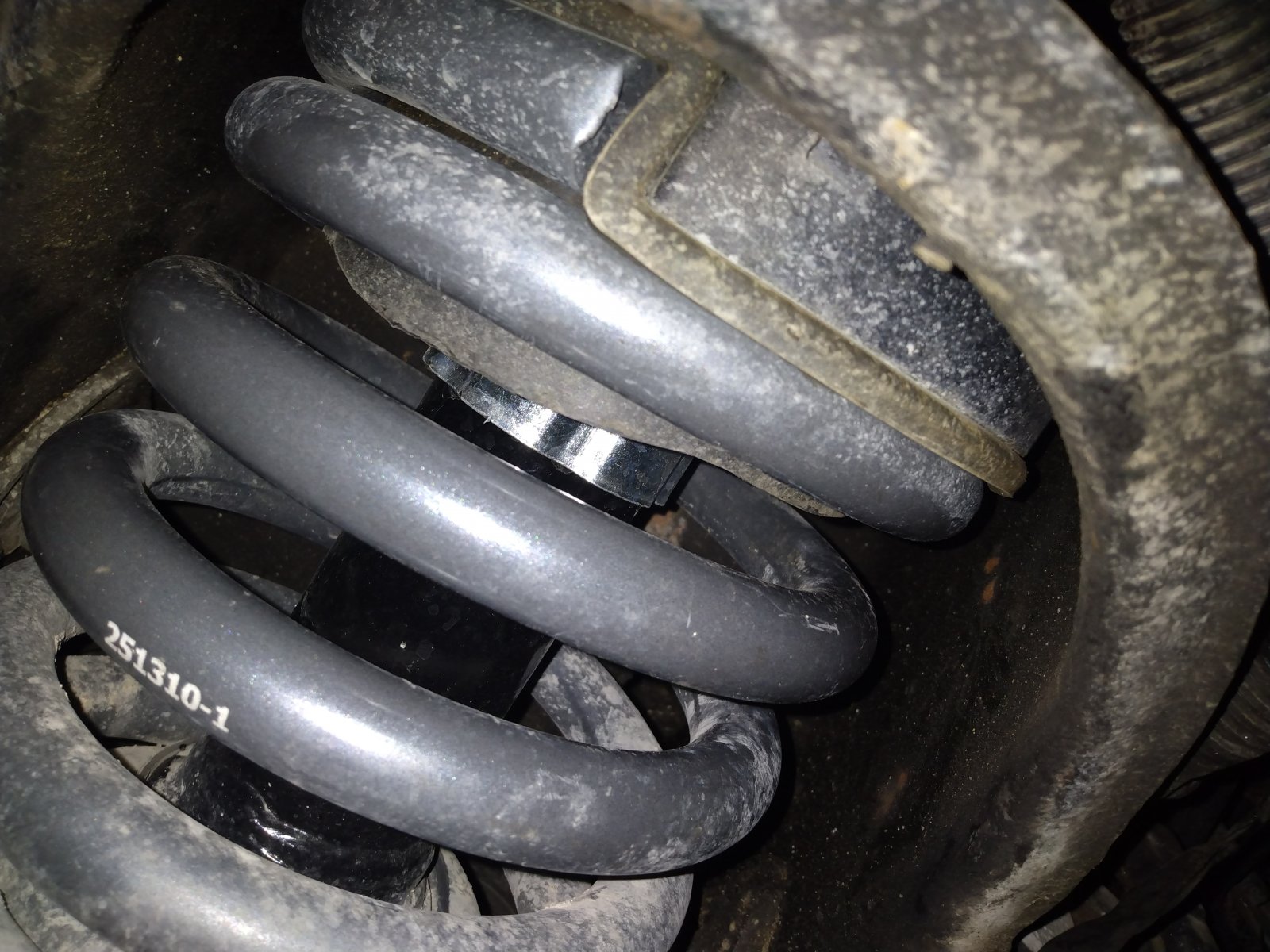

Hello everyone, posting a dilemma I am having in hopes someone could provide a bit of help. I recently installed the MaxTrac front and rear spring kit on my 2016 Yukon. The rear had the stock springs so it lowered it exactly 3 inches, just the front I am having issues figuring out. At first it seemed way to low in the front so I added a 1.5" spacer under the strut and it has it perfect for my taste. The issue is when I hit a hard bump, it seems to be bottoming out therefore I investigated and the strut is almost fully compressed to the metal body of the upper plate. I have AutoZone Duralast struts which seemed to be a bit taller than my stock struts (almost like they were designed to level the truck). Is there a certain strut I should use that would make this perfect and not have the front strut with such little up travel remaining? When I jack the Yukon in the air, it has a tremendous amount of down travel. Also, Firestone said the camber is max out which should not happen for only a 2 inch drop IMHO.
Hoping that the factory strut would be the right size but don't want to just throw parts at it until I know for certain. Perhaps I could install the AutoZone springs on them again and go with a spindle drop but still, not sure the total outcome. Thanks in advance!
Attaching a pic of the truck as it sits along with a pic of the strut to show how far the body is up in the spring.

I contacted MaxTrac and they recommended their lowering struts which have a 1" lower strut body which will work with their lowering spring. Going to install and update in the event anyone else runs into this issue as well.
Note to anyone reading, do not put lowering springs on auto zone replacement struts, they will be to long and you will bottom out as I am doing.
