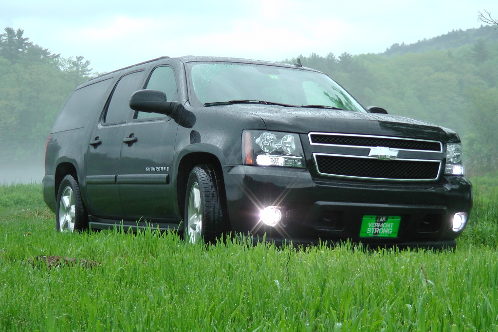

I FINALLY installed my 2/3-4 drop kit from Tony today. 2008 Suburban, 4wd, non-autoride, 1" spacer. Aside from some concerns about the ride height (already talked with Tony), the ABS and Stabilitrak lights are on and asking for service. We checked the wiring and it all seemed to be connected right, so is it time to hit the dealer to pull and clear the codes? Or is there another solution? I'll post pics tomorrow if this friggin rain ever stops.

Ok so current measurements are:
LR: 33 7/8
LF: 33 7/8
RR: 34
RF: 34 3/8
I think I'm going to order 2" spacers for the rear, but we'll see how it looks after things settle down a bit.
