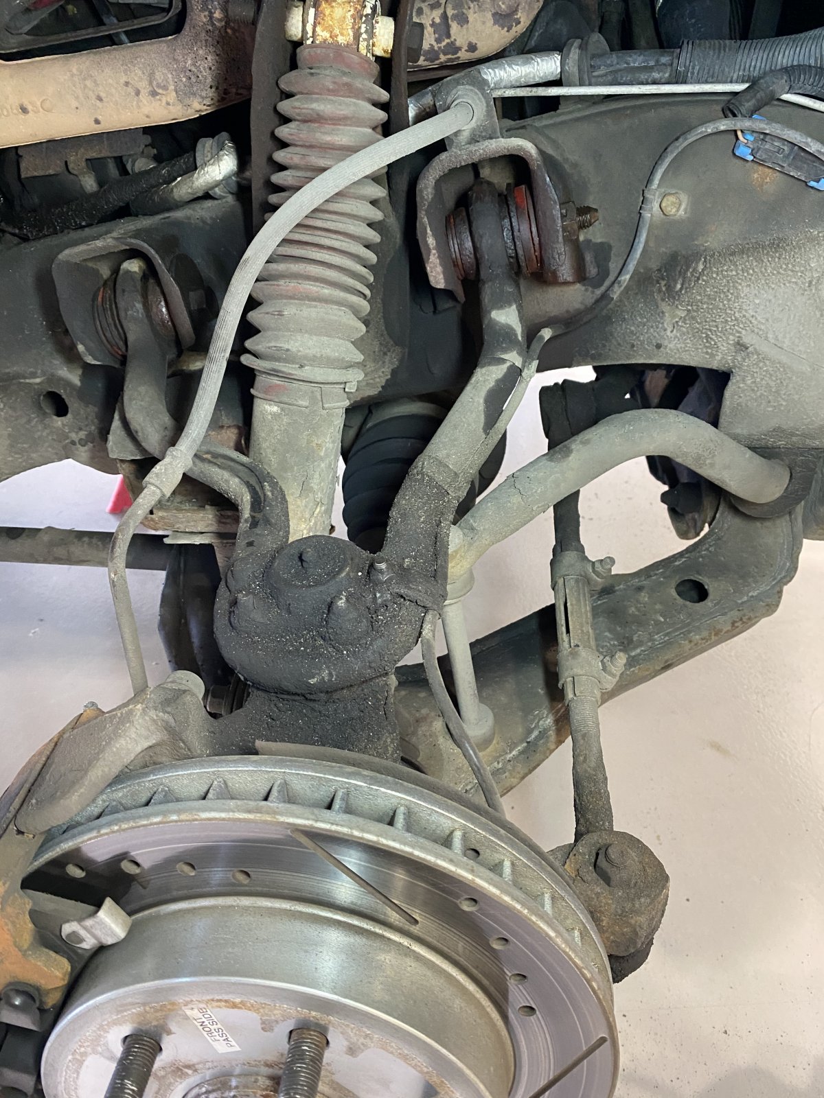

Thank you guys. Here is what I have done about 3500 miles ago. The entire front end linkage with the exception of the lower control arms. The noise wasnt there prior to new items . I can't get it to repeat the sound when on jacks. It isn't quite a clunk. Sometimes it sounds like torque cracking sound on something and a plastic clunk if that makes sense. It is a sharp clunkity clunk with a vibrative sound. But I can't feel it in the cab. No indication at all, just the sound.
I heard it could be calipers if they have become gummy. I replaced the front brakes as well and they may been a little gummy and slow to react. Maybe I will spray some liquid wrench in the upper control arm bushing first and see if there is a difference as well. They are relatively new.

Make sure your shocks attachments are tight. I have had fasteners at the front top shock attachment back off, causing a clunk before. Also check to see if your sway bar bushings are greaseable. I have also seen where the sway bar end link bolts are put in upside down and can contact the upper control arm. Basically check and double check everything you had replaced 3500 miles ago.

Common things are upper control arm bushings or the upper control arm bolts loose. Also common to break front stabilizer links or the bushings on them fall apart. Check lower ball joints with a jack under the lower control arm outboard and use a block of wood and prybar to pry wheel upwards and look for play.
