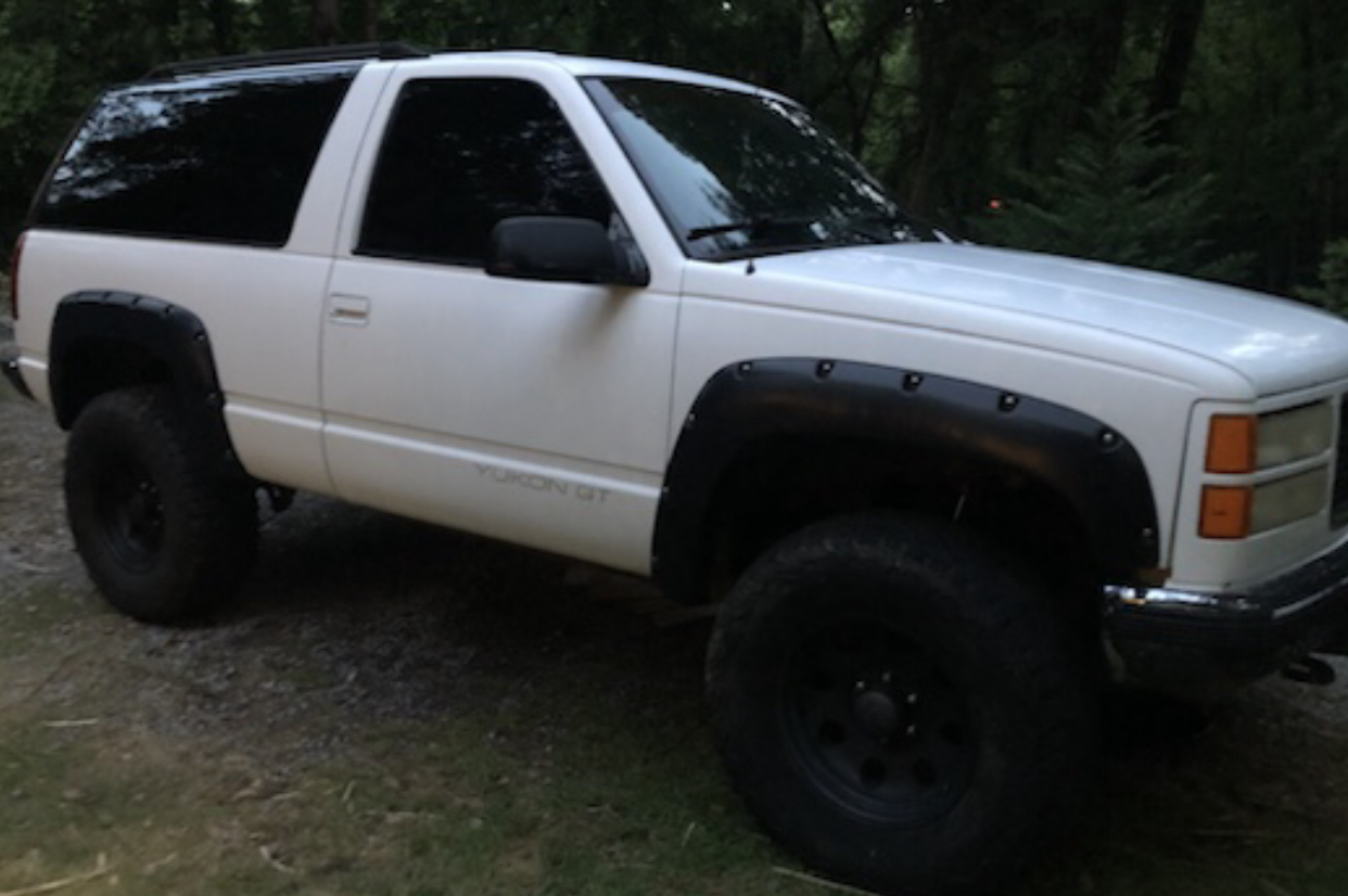

Welcome to the Forum from NH.
Pics of the truck, please.

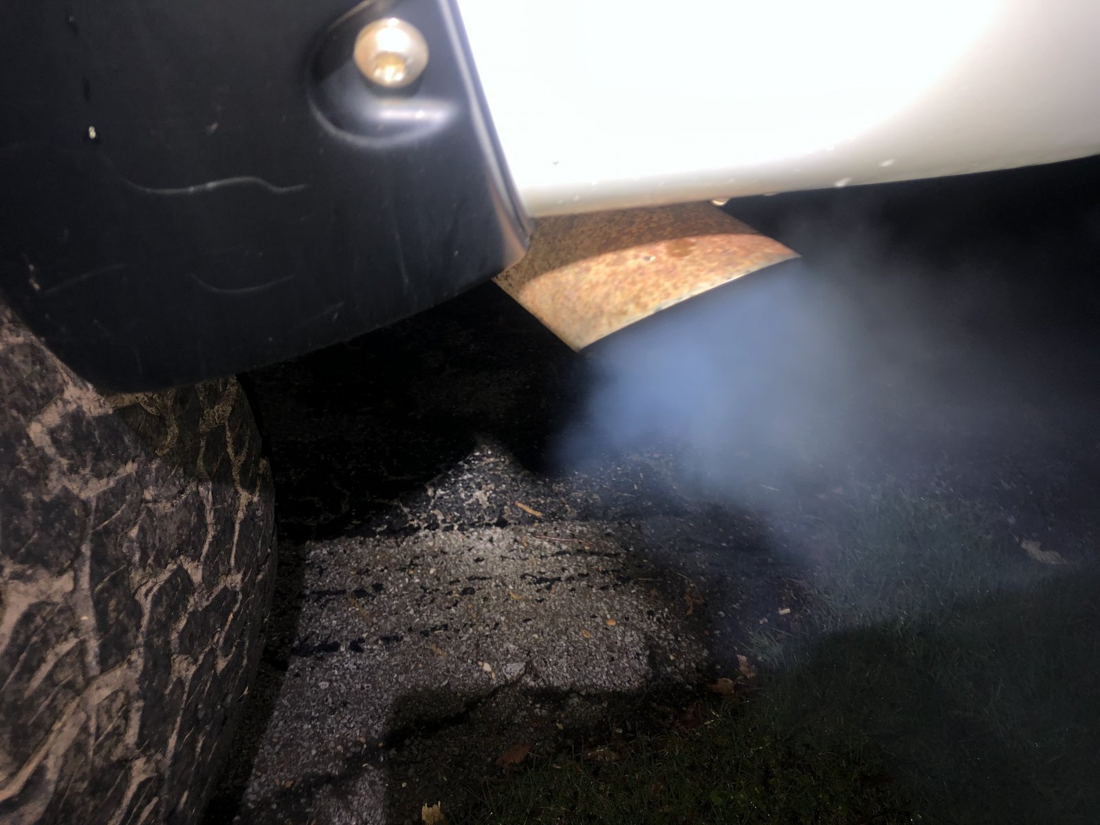

Sorry. It’s out of the tailpipe. And it doesn’t stop. It doesn’t run hot and it sounds good idling. Cranks right up without any hesitation. Thank you for responding

OK, we have the where. Now we need the what. Coolant makes steam and if it has antifreeze it has a very distinctive smell. Oil makes blueish smoke and smells different. Obviously if it is burning a fluid that fluid level will drop. A vehicle that has been sitting might have accumulated moisture in the exhaust and that will show steam out of the tailpipe.

I would double check that the new pcv valve is installed correctly and that it is not stuck, then just drive it a little bit, what may have happened is some oil seeped thru the valve guides and piston rings from sitting, so either it will smoke a bit at first and then burn off and then it may stop or it may only do it at startup, or it will just continue to smoke in which case may it may need seals and rings. but that's just a guess without seeing what's been done. double check your work if everything looks right drive it a bit and see if it clears up
