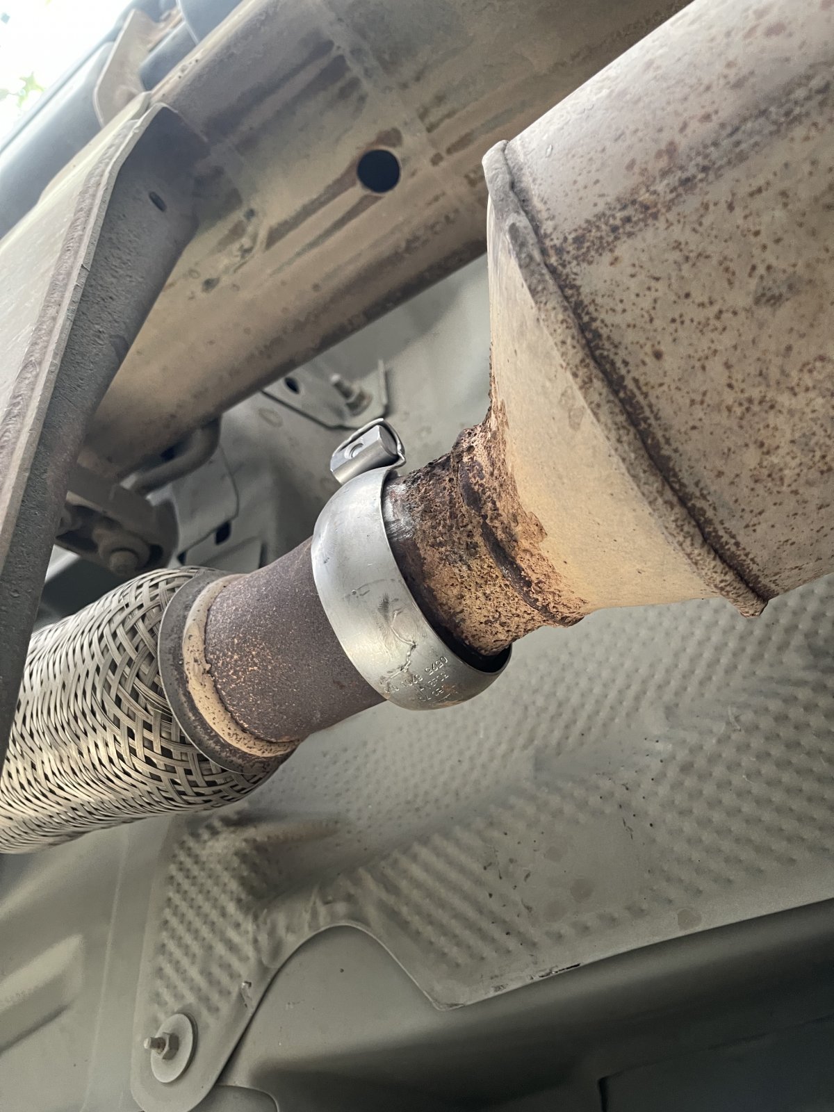

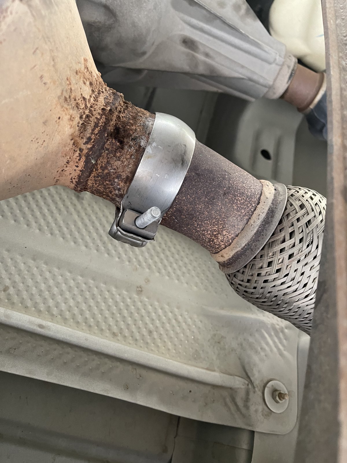

I got under it and was touching anything they would have taken off and the rear clamp on the exhaust was put on but was not tightened down.. first picture is before I tightened it 2nd is after lol simple clamp, feel like they would have doubled checked before they put it back down on the ground. I drove it and no noise

If the GM dealer did the work, take it back and explain the issues to them. A slight metal rattle could be something as minor as a loose heat shield that they bumped or did not reconnect after the TC repair. Vibration, could that be your AFM kicking in and off and its more pronounced now with the new TC? Random shake on the highway at 70-75 could just be tire balancing. A weight or two could have come off while they were doing some work, etc. as well.
I watched the dash from where it goes from V4 to V8, most definitely feel the vibration in V4 with holding light throttle it’ll stay in V4, anything more than that it’ll obviously go to V8 but the vibration stays can definitely feel it “kick” back into V8. What a goose chase

Glad the metal noise is sorted out. But check that exhaust, is that a pin hole I see?
I started to look up just a simple plug in one, found the range one as well, luckily I don’t have inspections here in Kansas so don’t have that problem, I’d really would like to have it deleted all together but the shop that I see that does it and looks like they do great work is pricey at about 5k for a complete rebuild, tune, ect. On the exhaust I think that is just dirt built up, taking about that dark spot just after the cat?
