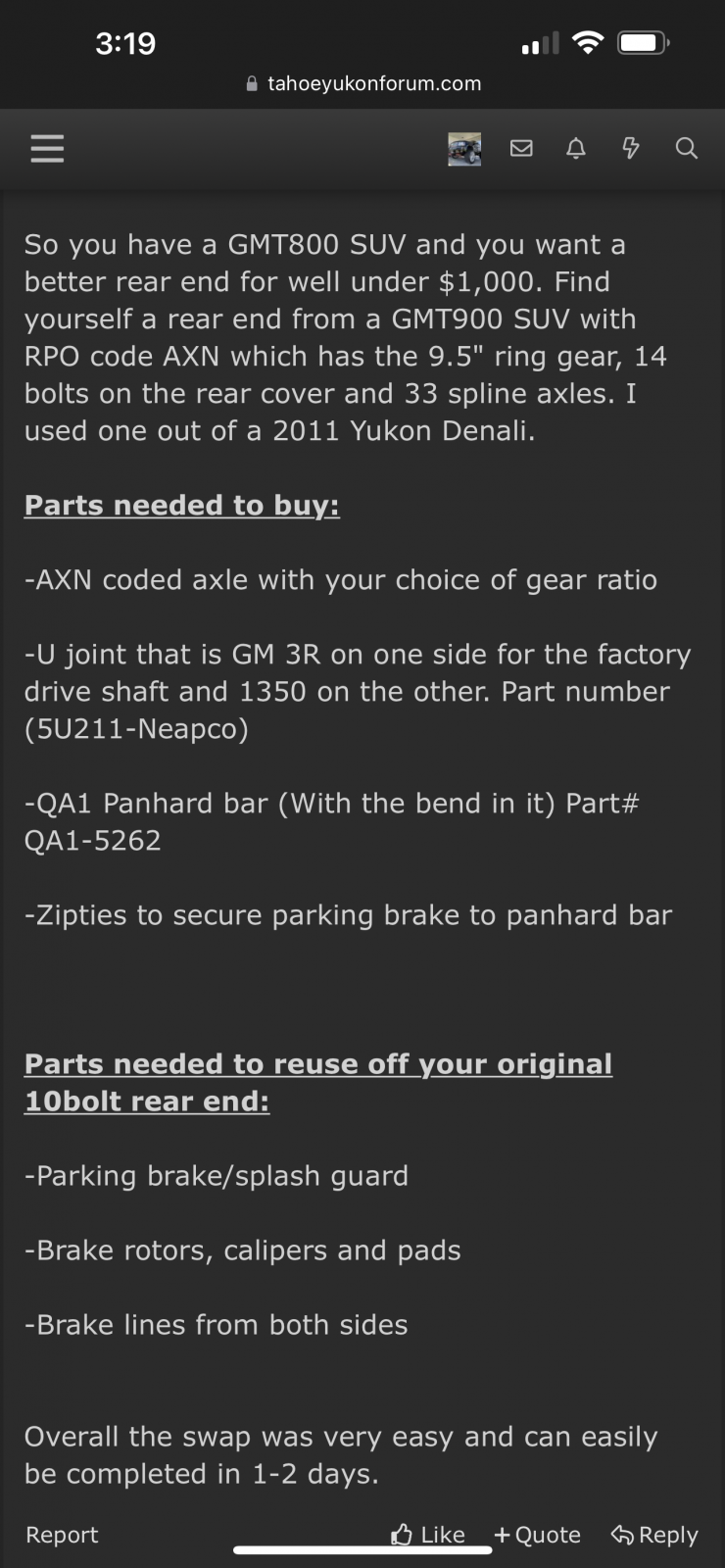

Pretty much bolt it, possible U joint issue at-least when bolting to a GMT800. Any of the 99-14 rear brake setups with bolt right on, however you may have to change splash shields which required removing the axle shafts. Removing the shafts is cake with the axle on a table or stands.
4.10-4.56s and a trutrac would be my vote for a lifted truck.
Dantheman1540
Feb 13, 2020
4,975
10,828
Sugar Loaf Mountain
Here’s a link to my write up.
