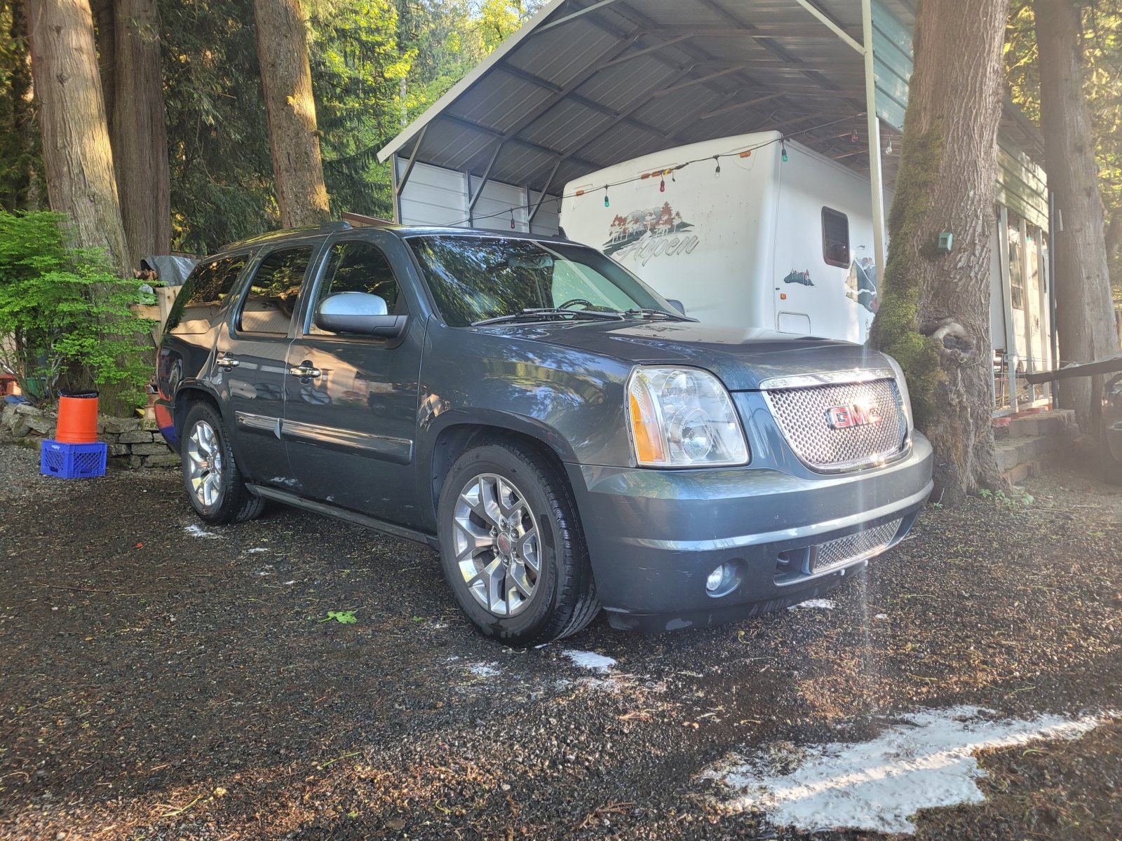

Well ⅜" in spacers on top of the strut mount and its real close to being level. The rear is less than ¼" and the front is right at ¼" if I go up another ⅛" spacer on the drivers side it's starting to lift the passenger side. So it's as close as I'm going to get it. I will take a picture or two when I get a chance. I'm very happy with how it looks.

Well I finally got around to washing my Denali, so here is a picture of the new stance.
