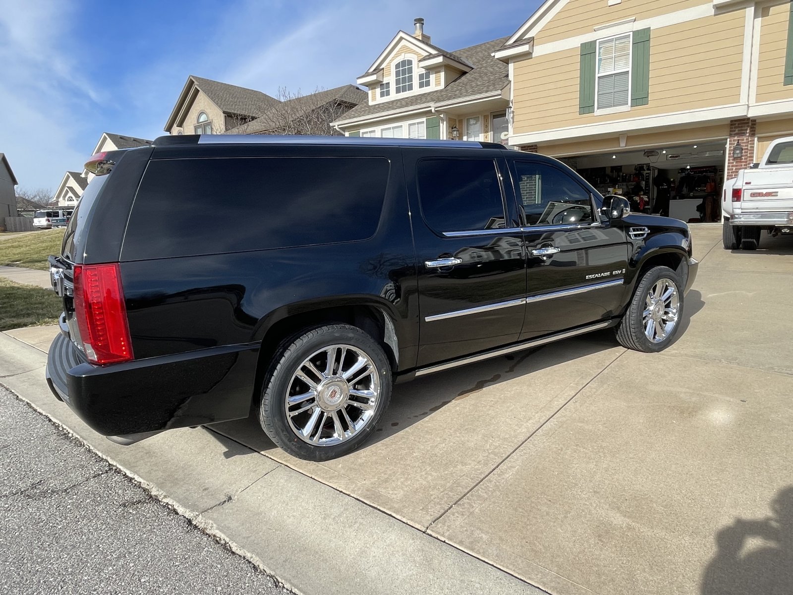

New rims/tires and leds in the fogs. Really liking this upgrade. Upgraded style but still generation correct :)
