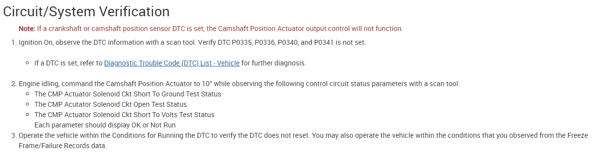

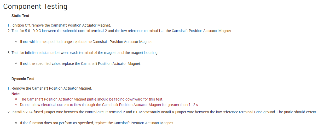

Here's how to solve the problem from the shop manual:

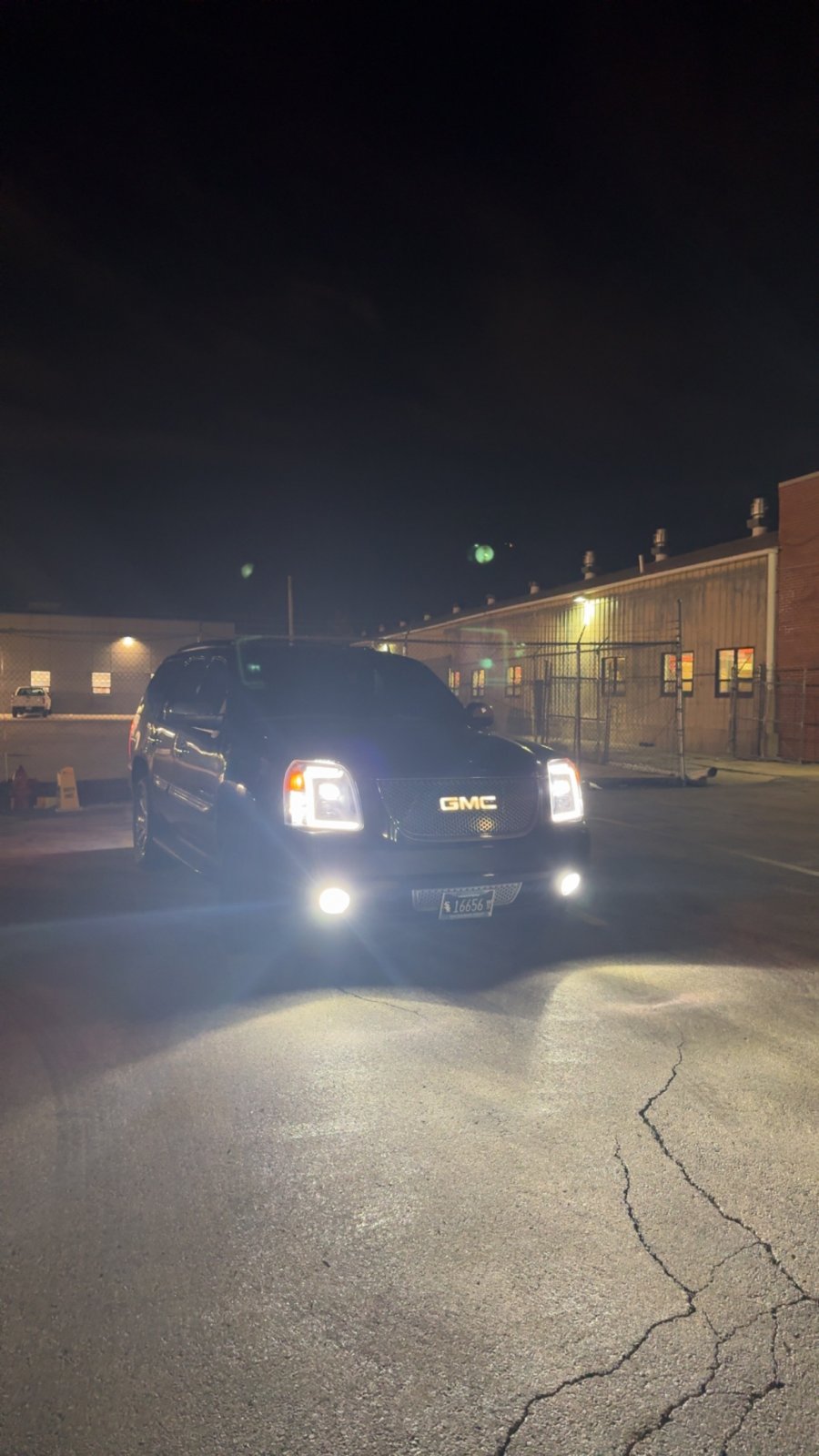

Pics of truck below View attachment 422794
