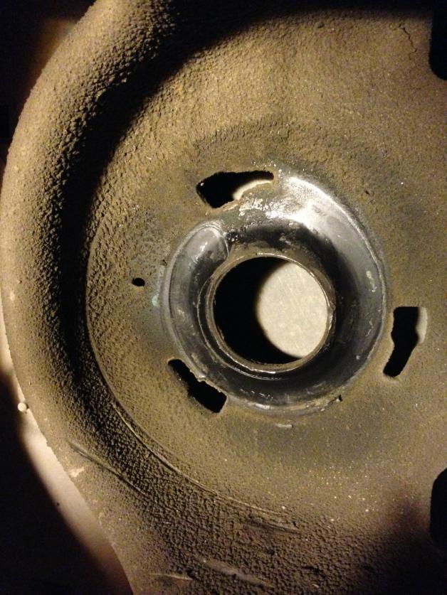

just did my buddys truck 3-4 rear drop last night. Pulled his springs on his 07 cadillac ext and sure enough same mounts as the trailblazers

Do you have any pics of them installed?
Also at ride height and layed out?
Thanks

No sorry had it on my old phone but lost pics. There are a few guys i set up on here also but nobody put up pics.
they lay the axle on the frame
