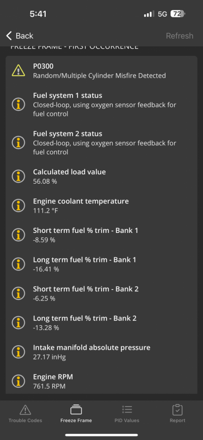

What do the short-term fuel trims look like?

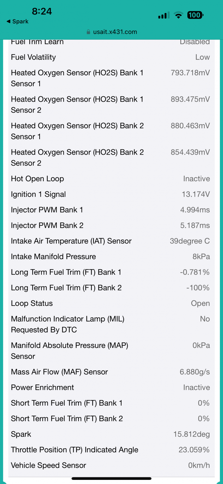

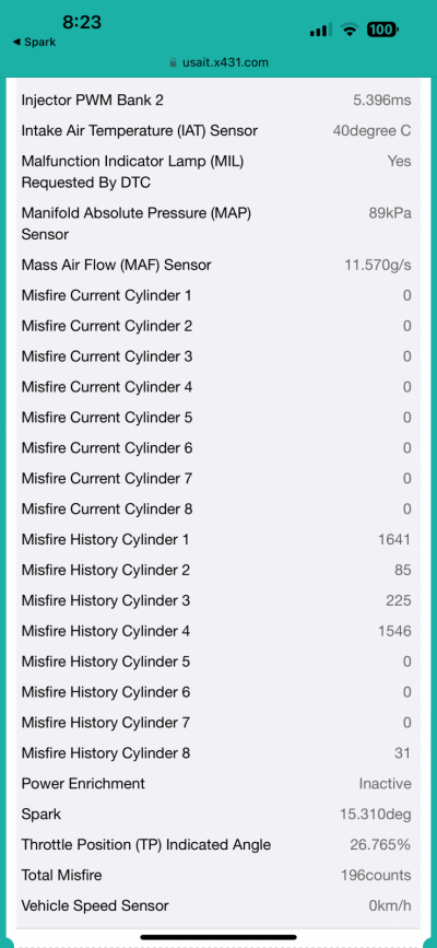

nvious62
Aug 15, 2024

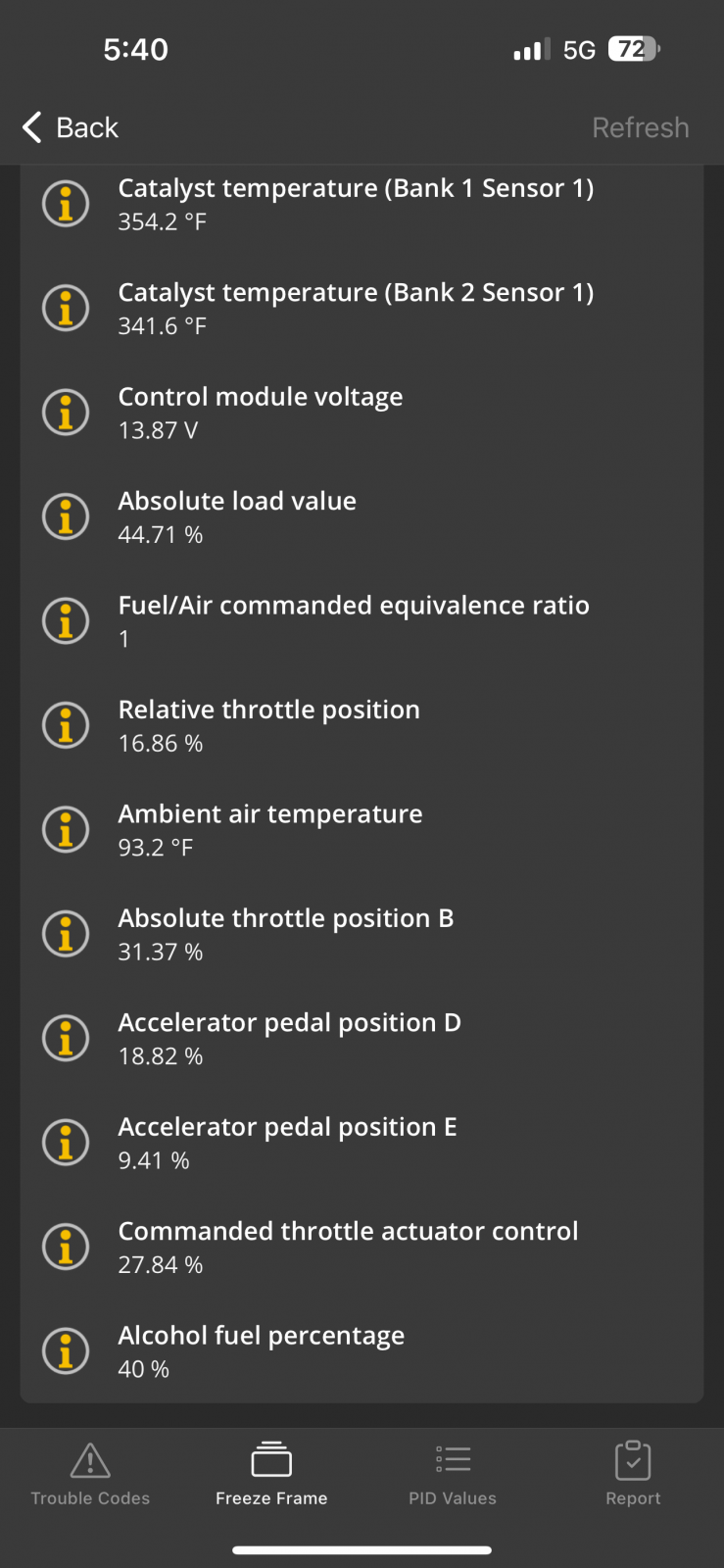

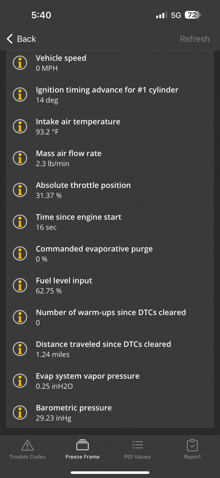

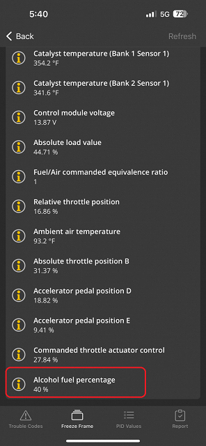

Here is what I was able to pull with the cheap scanner I have I got better one but haven’t had time to hook it up. I’m running 87 with 10% ethanol.

If you've not run any E85 lately, then the computer is mis-calculating the alcohol content; it should be 10% or less based on using E10. Need to get a scanner on it that can reset the alcohol percentage. That'll be a start to see if it helps the misfires.

nvious62
Aug 15, 2024

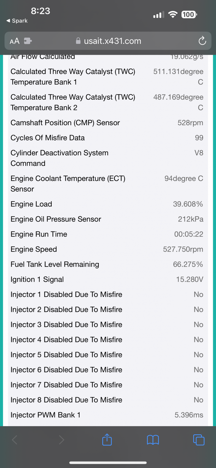

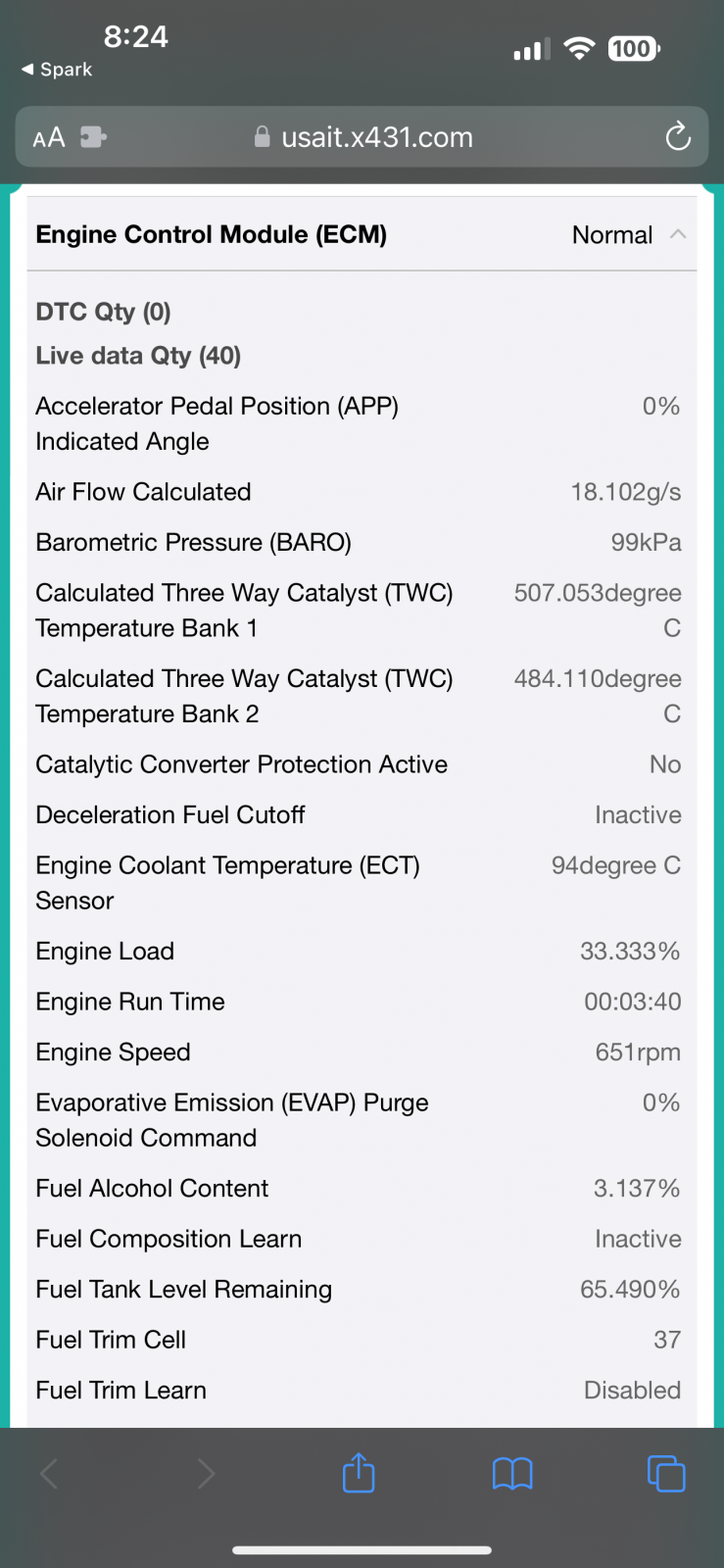

Was able to reset fuel composition and read again and down to 3 percent. But still running rough and knocking. Here are some screenshots of what I have now.
