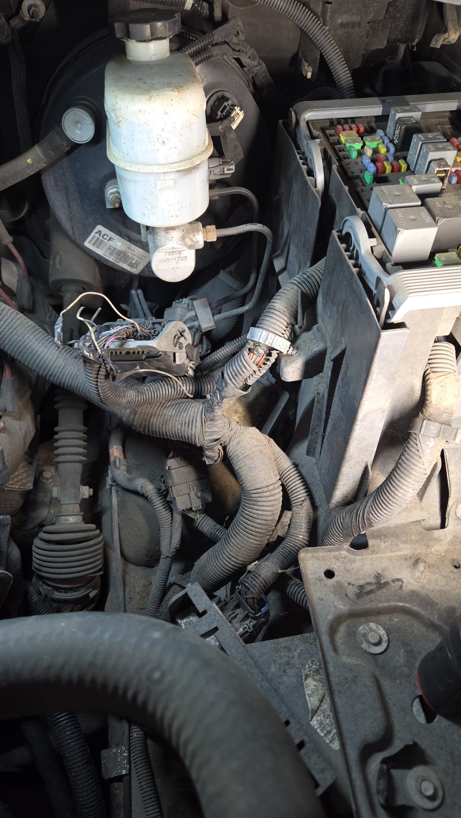

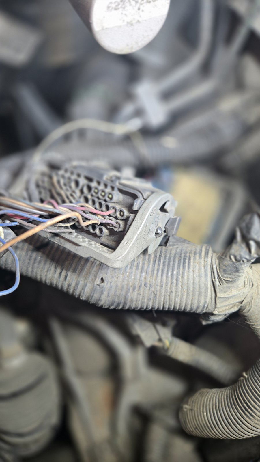

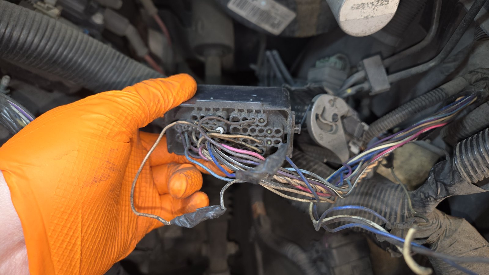

While trying to diag the lift gate i noticed that the connector the goes from the fuse panel in the engine compartment to parts unknown has some random wires are cut or broke free from the fuse block side of the connector.
I have been searching for a pinout with no luck, so I thought I would ask here. I am sure populated pins vary with options...but I am hoping there is a standard setup....anyway it definitely looks like someone was in the plug. The plastic dividers are missing.

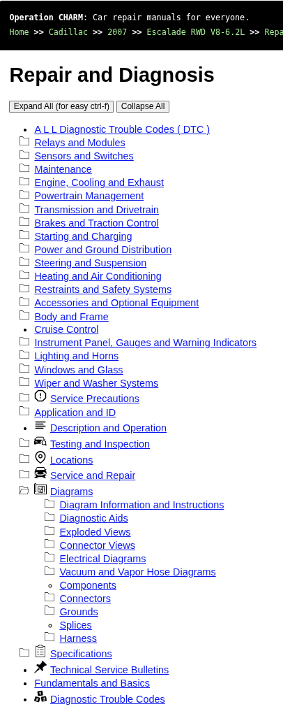

You can find electrical wiring diagrams at www.charm.li .

That is where it has been sitting for ~3 years, and I need to get a better picture but you can see some of the what I think are broken wires. There are floating wires I will get a better picture of when I get home. I **** that last night while trying to juggle a flashlight my phone and the wire loom... :)

View attachment 479685View attachment 479686
You've got a decent scanner, so that is good for deep troubleshooting when needed.
When you do take the additional photos, please show that connector at a more distant view, as well, so that we can orient ourselves on just where that connector is located.

Thanks for the feedback. I am starting to look through that site and it looks like there is info, just need to find all the c115 references spread across the different pages :)
Update, it is the body side of the connector that I was looking at, it routes under the fuse box which is where I got turned around....
Thoughts?

Possibly connects to ebcm. Gray/black wires could be rear wheel speed sensors.
Perhaps they wired in a traction/abs defeat?
