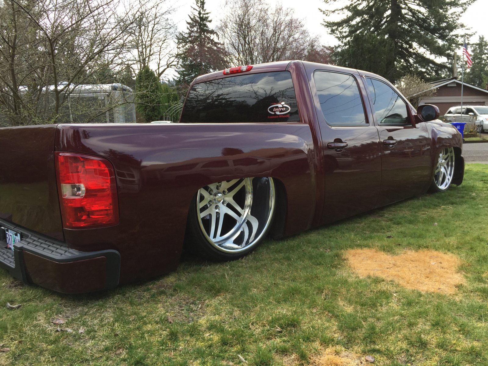

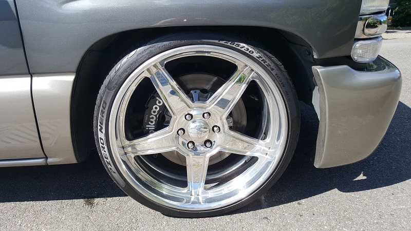

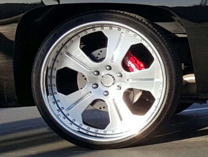

It’s nice to know the rears work on the 2011 pickups since I converted my bagged and bodied 08 to disc. When I decide to do Wilwoods on it they will look nice behind my new billets.
Staggered 02
Jul 5, 2019
672
1,556
It’s nice to know the rears work on the 2011 pickups since I converted my bagged and bodied 08 to disc. When I decide to do Wilwoods on it they will look nice behind my new billets.View attachment 236151
Yes sir. I switched out the drum brakes in order to get the Wilwoods all of the way around. I thought you had already done that. They will look great on that very nice truck of yours.
Just need some time so that I can switch out the Calipers and hats one last time like I did on the 02.
52,954

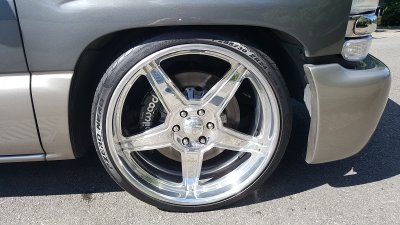

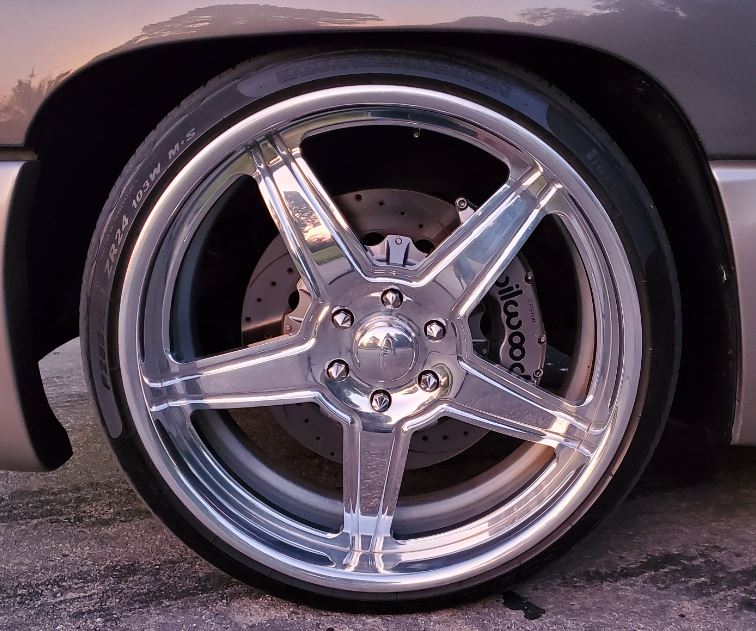

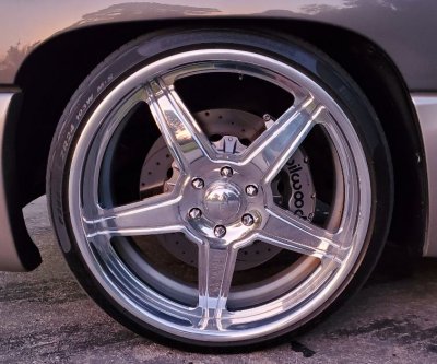

Oh, sorry. I misunderstood. Installing the Wilwoods on your Crew Cab will be a very nice upgrade and look.

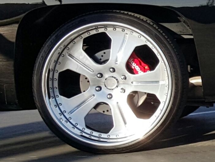

I put Wilwoods on my 02. Then the Crew Cab, the 2005 Escalade, and knew I had to put them on the Escalade when I ordered the intros for it. Below are pictures of the brakes on the 02 Silverado.
Look forward to see them on your truck one of these days.
