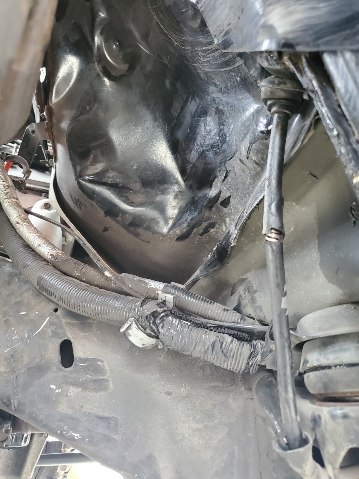

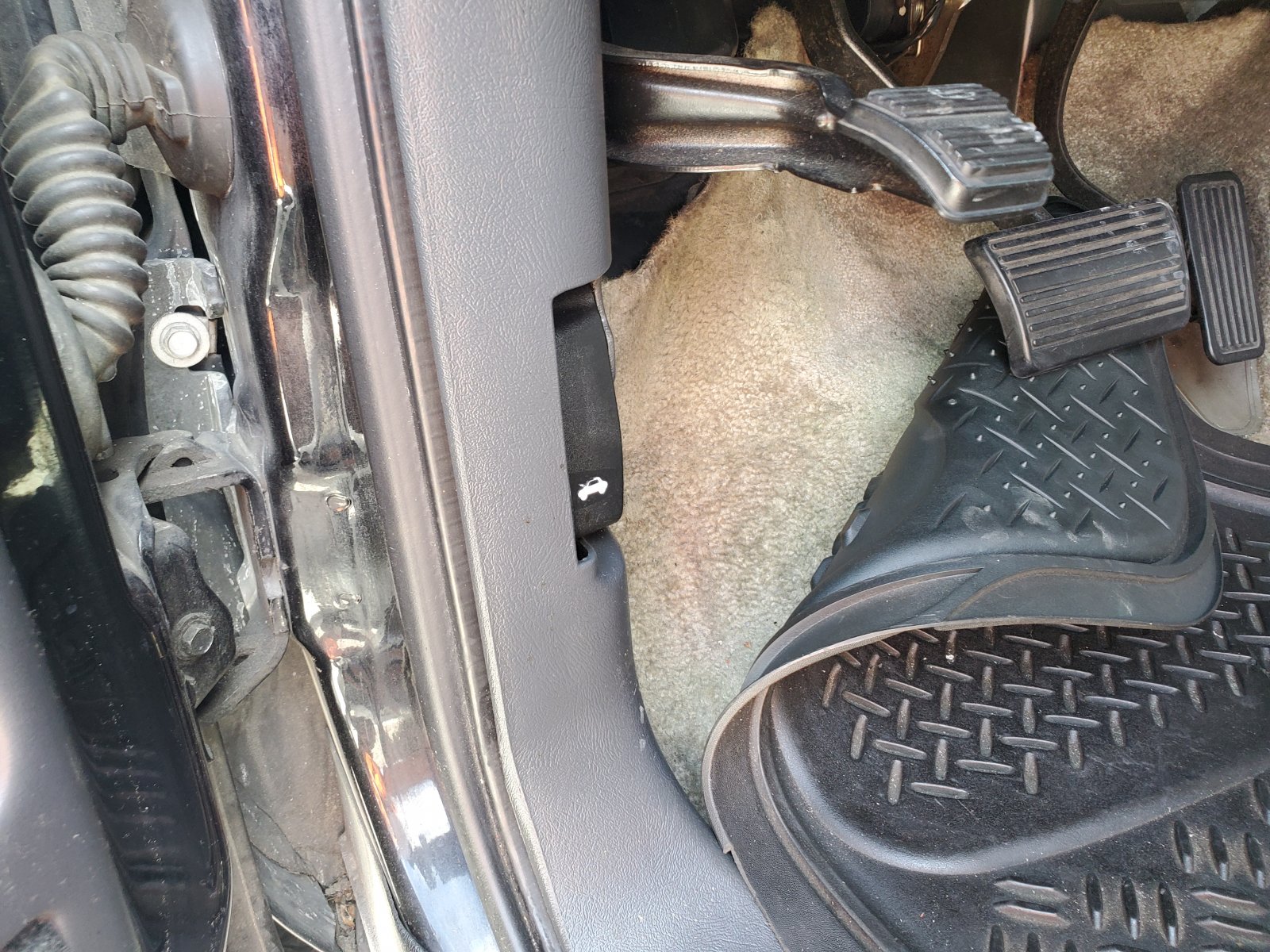

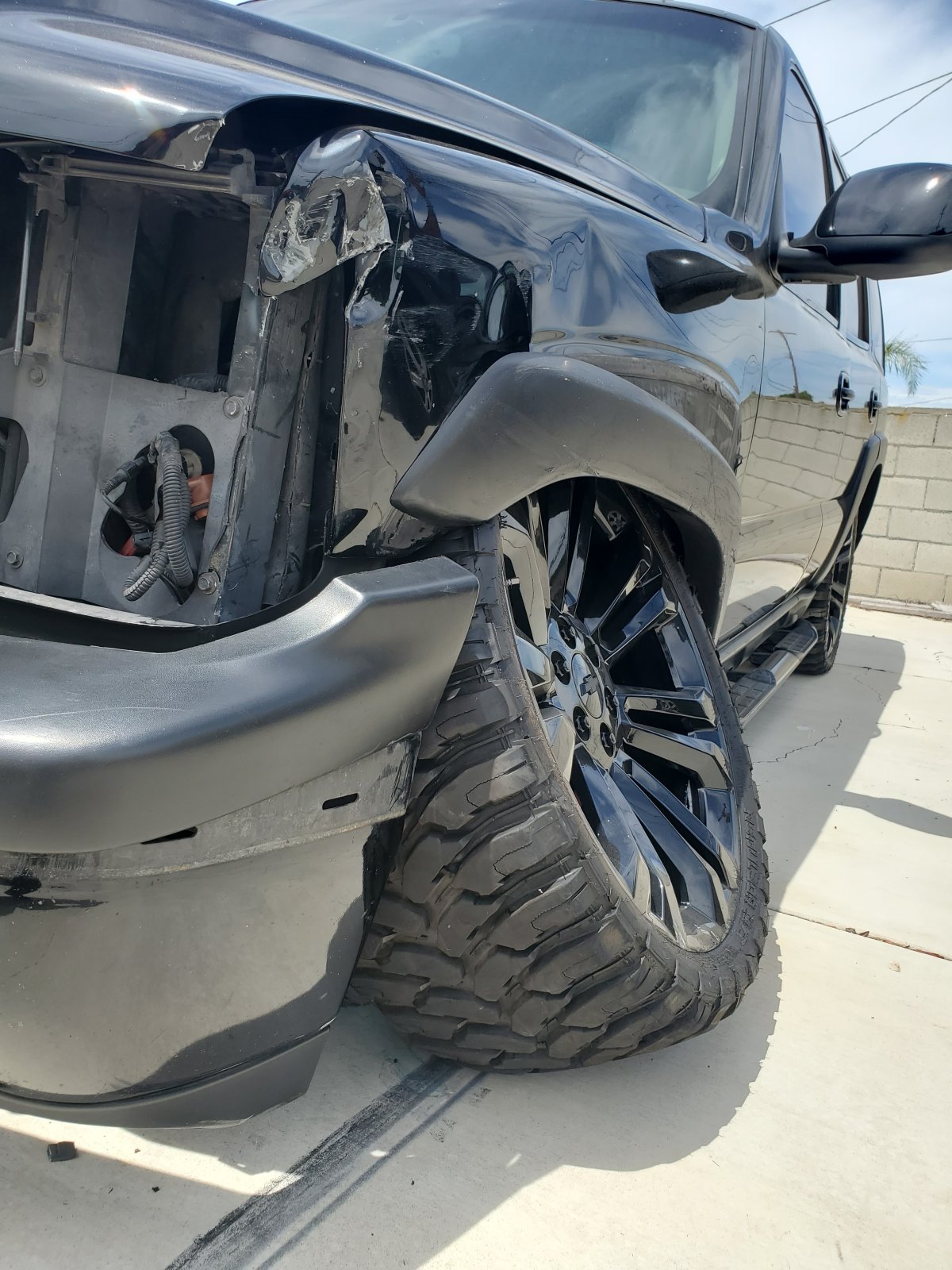

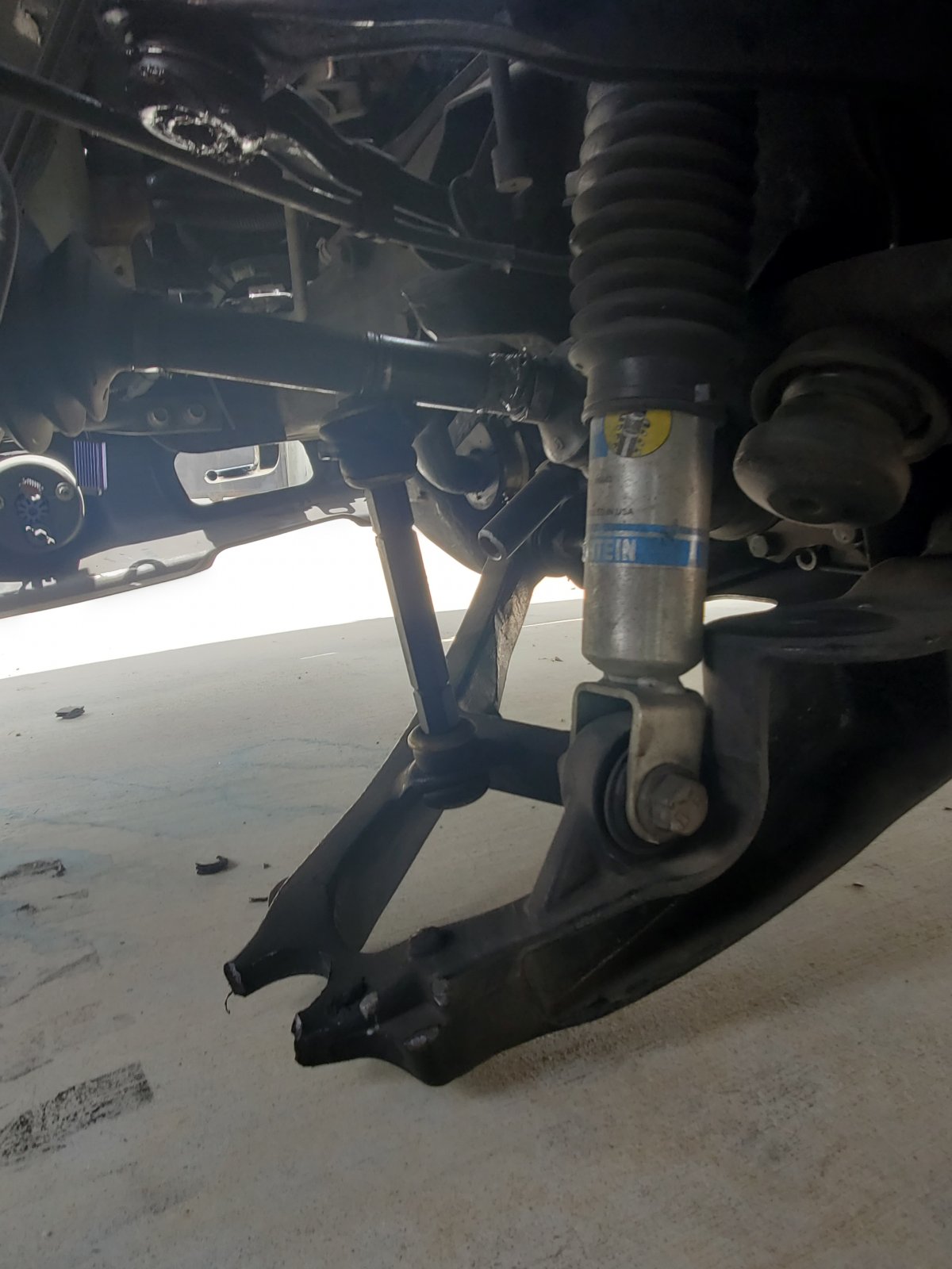

My upper and lower control arms broke completely off and wheel hit the fire wall. Totally dented the drivers side floor in. Any advice on getting the dent out without going to a body shop and completly draining my bank account?

Is it just that dent? Did it cause any other damage? Other then the floor? How's it inside the cabin with the rug still in place? Is it noticeable? If it was mine, and the dent wasn't noticeable with the rug in place I'd just leave it alone. If not, take the seat out, move the rug over and try hitting the dent with a small sledge, working it a little at a time. Just be aware of anything around where you're hitting it--wiring, fuel lines underneath etc. Don't go too crazy, you don't want to put a hole in the firewall/floorboard. How'd that happen btw?

It very noticeable on the inside. The tie rod broke and pulled it to the left and hit a car which boke the control arms. Tonyrodz I've been thinking about just that. Grabbing a 30 pack a beer calling a buddy of mine and going hammer time sledgehammer crazy.

I hate to say it, but that is serious structural damage. You can probably bend it back, but if that area takes a hit again it will not "fight" the crumple like its supposed to. Like if someone was to T bone you, you've already lost quite a bit of the integrity of that metal and the cab could fold way easier than it should.
If it was just a trail rig I'd say hammer away, but this may need a professional opinion.

I've asked a few places there saying they would remove the motor and complete front end. Find a donor cut weld and so on. Thinking about striping it. Don't think its worth California body shop prices

That's a shame. Hoe looks in good shape.
