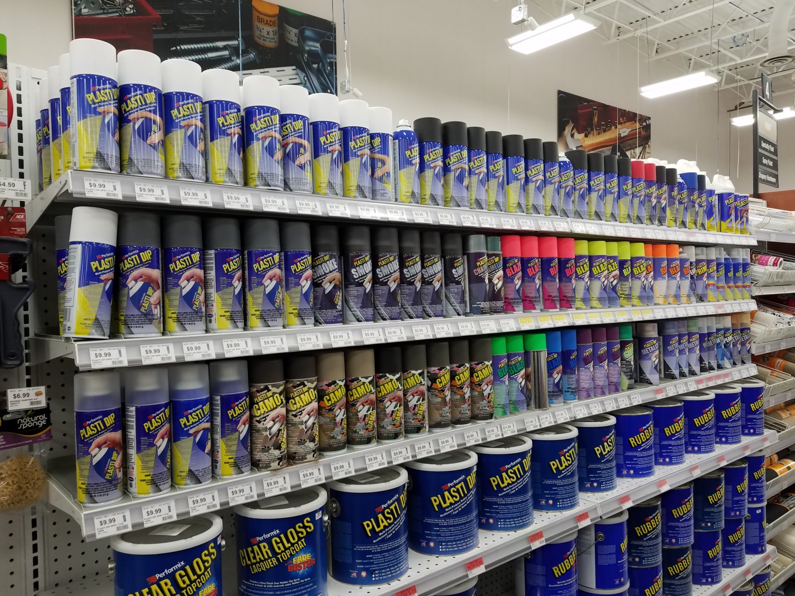

9.99?! Wow. Don't they have it at your home depot, or better yet Menards if you have one there?
Yep, alaska prices. No mernards. Home depot only has black and white colors at $7 a can. Same with Lowe's. Auto zone and napa only have black and white, maybe bright blue and bright red.
Ace has tons of colors plus glossifier and metalizer.

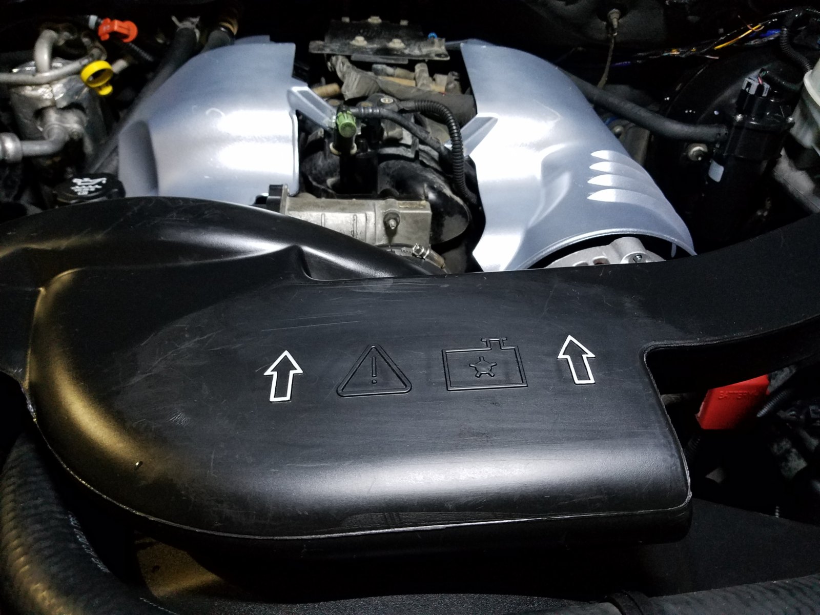

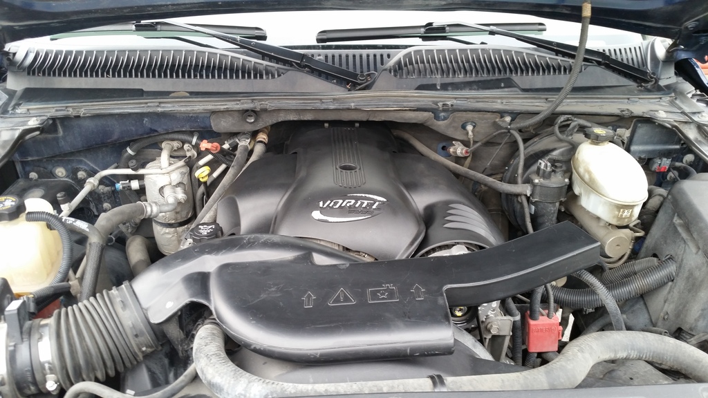

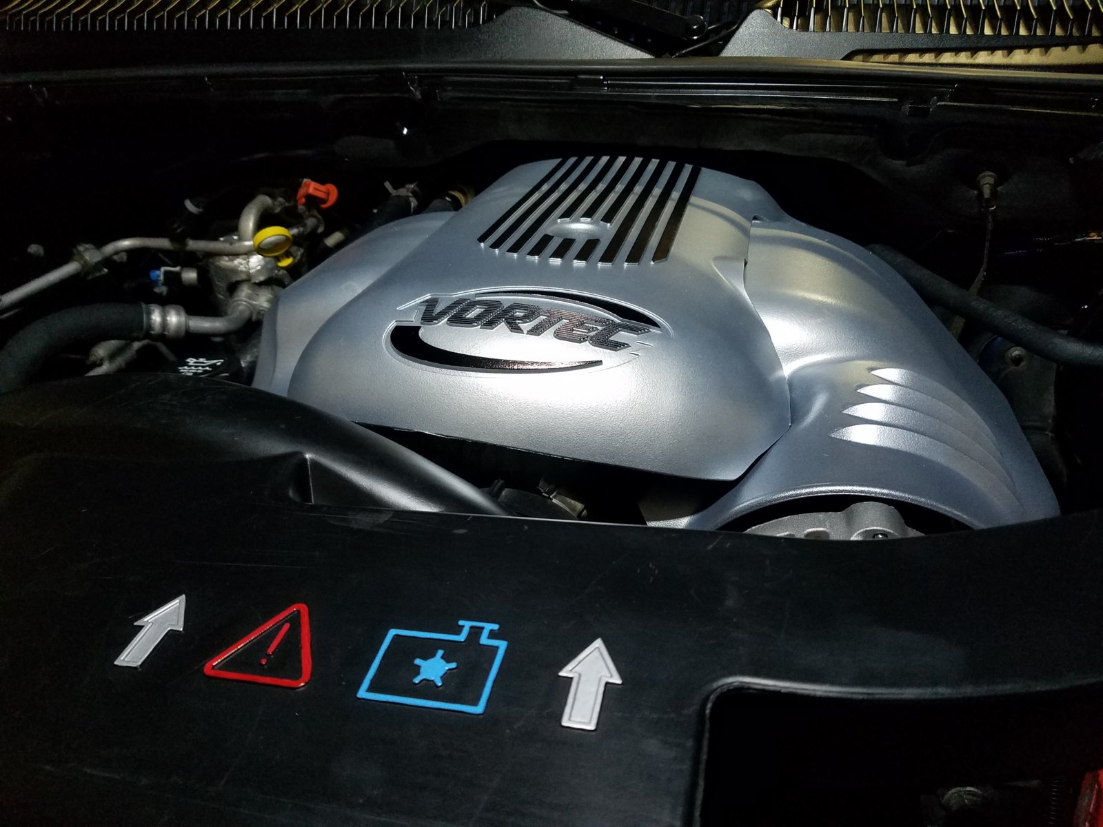

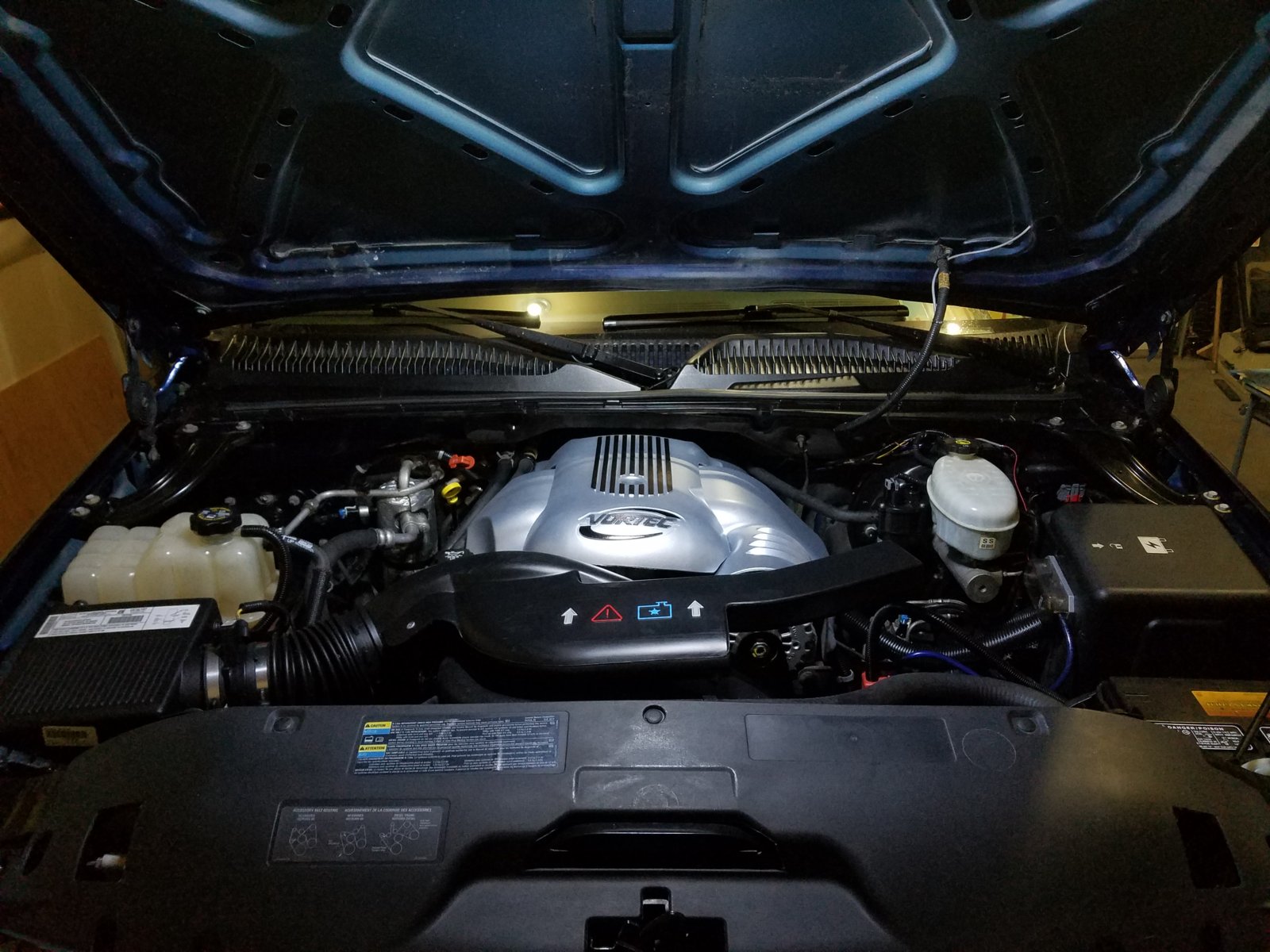

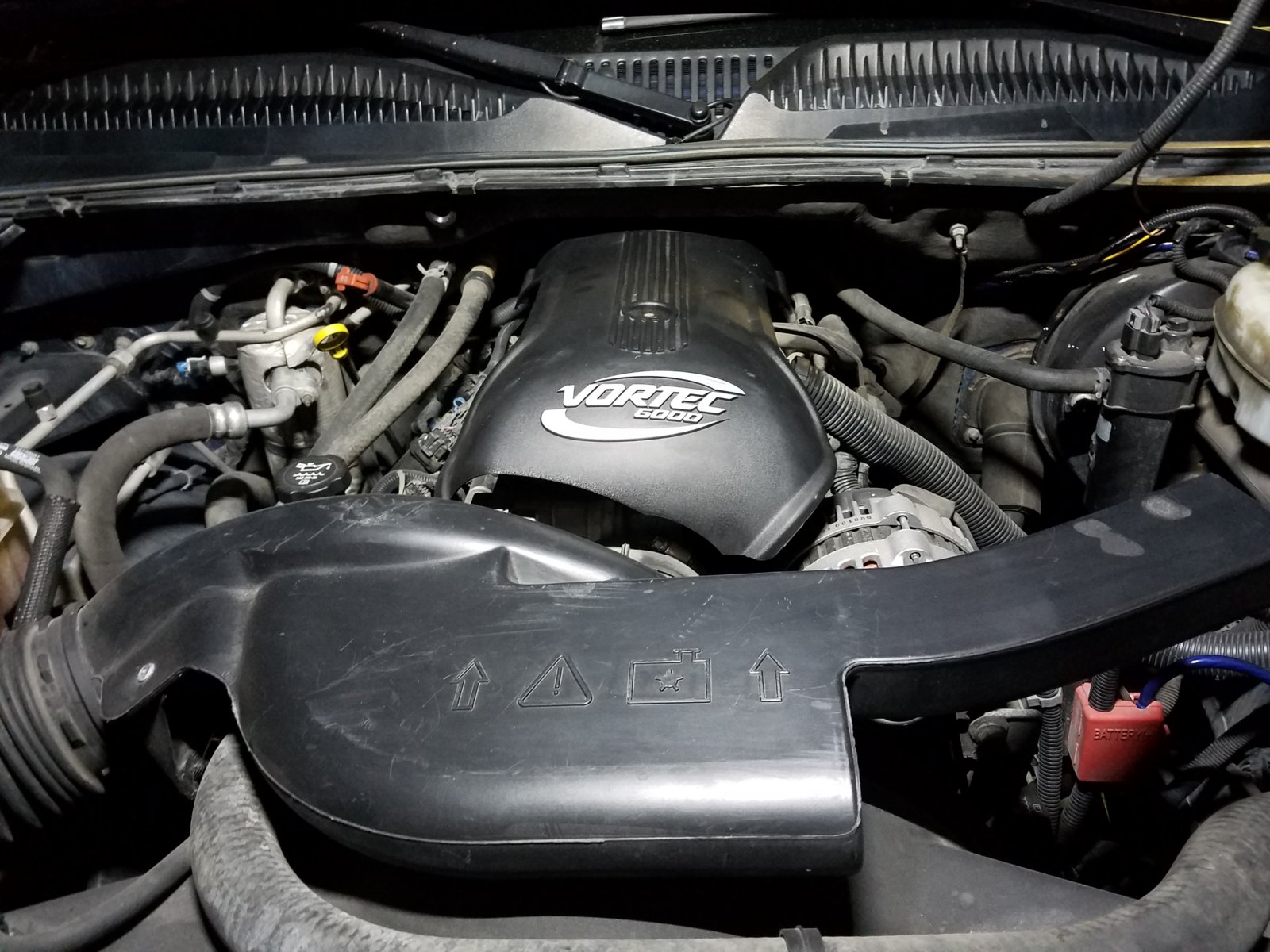

Got bored. Dressed up the engine bay. Actually detailed it, I realized I haven't cleaned the engine bay since I got the truck 2 and a half years ago.

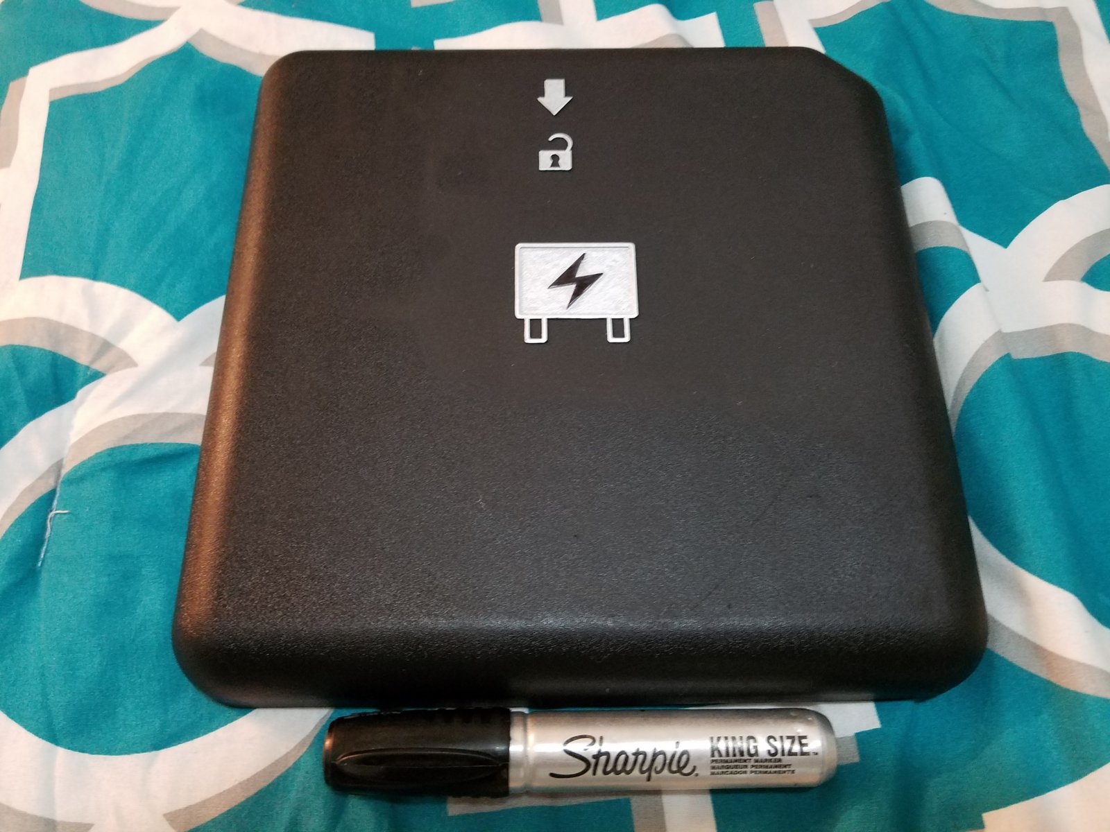

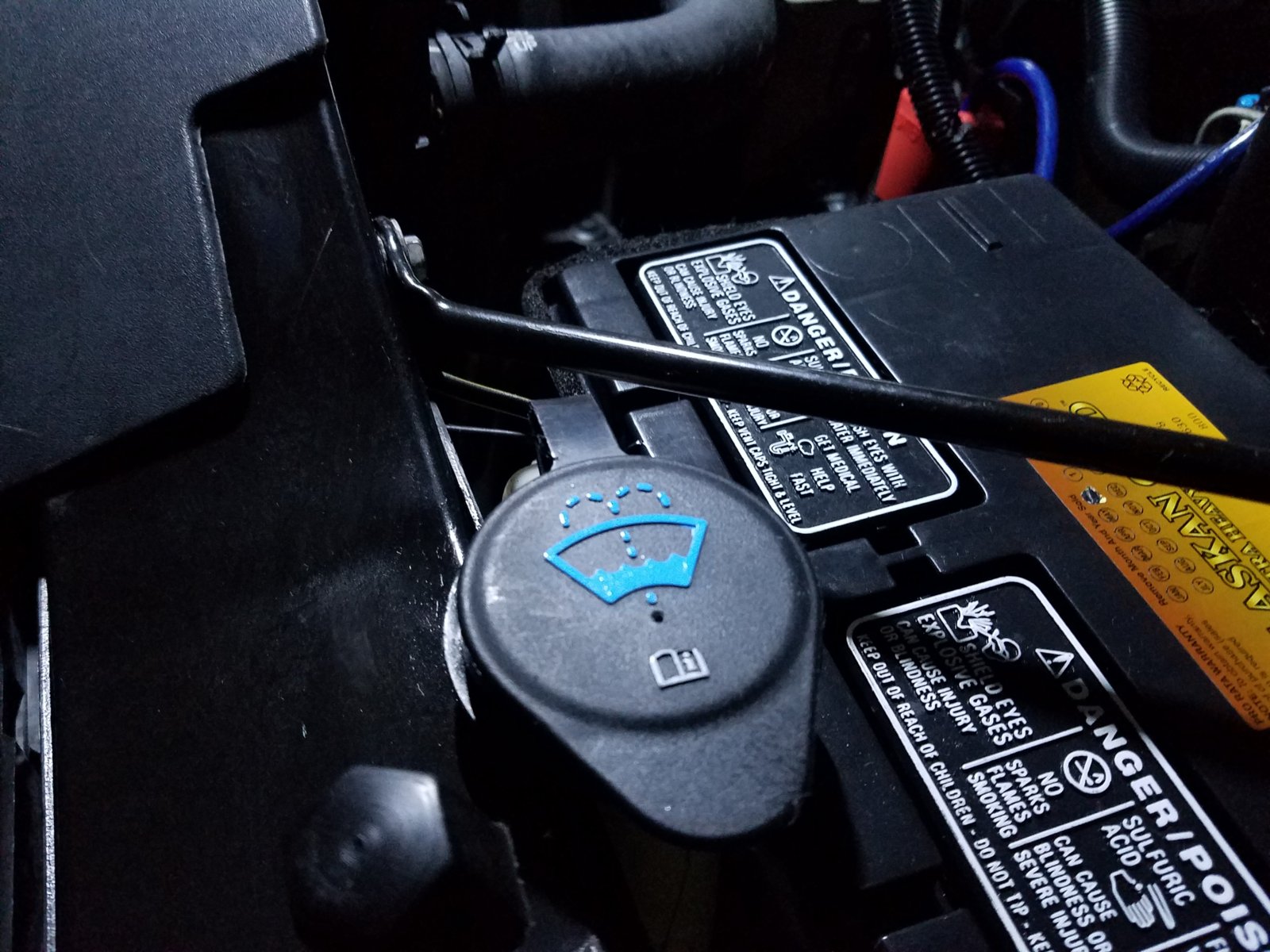

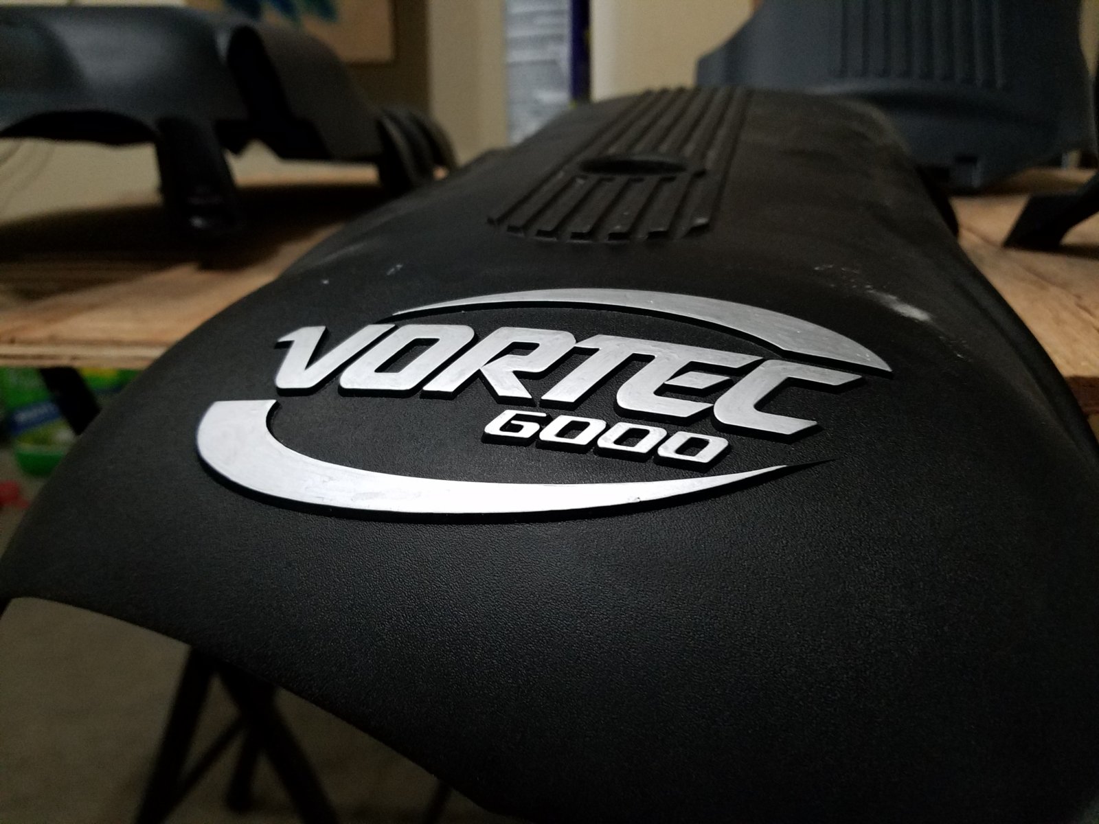

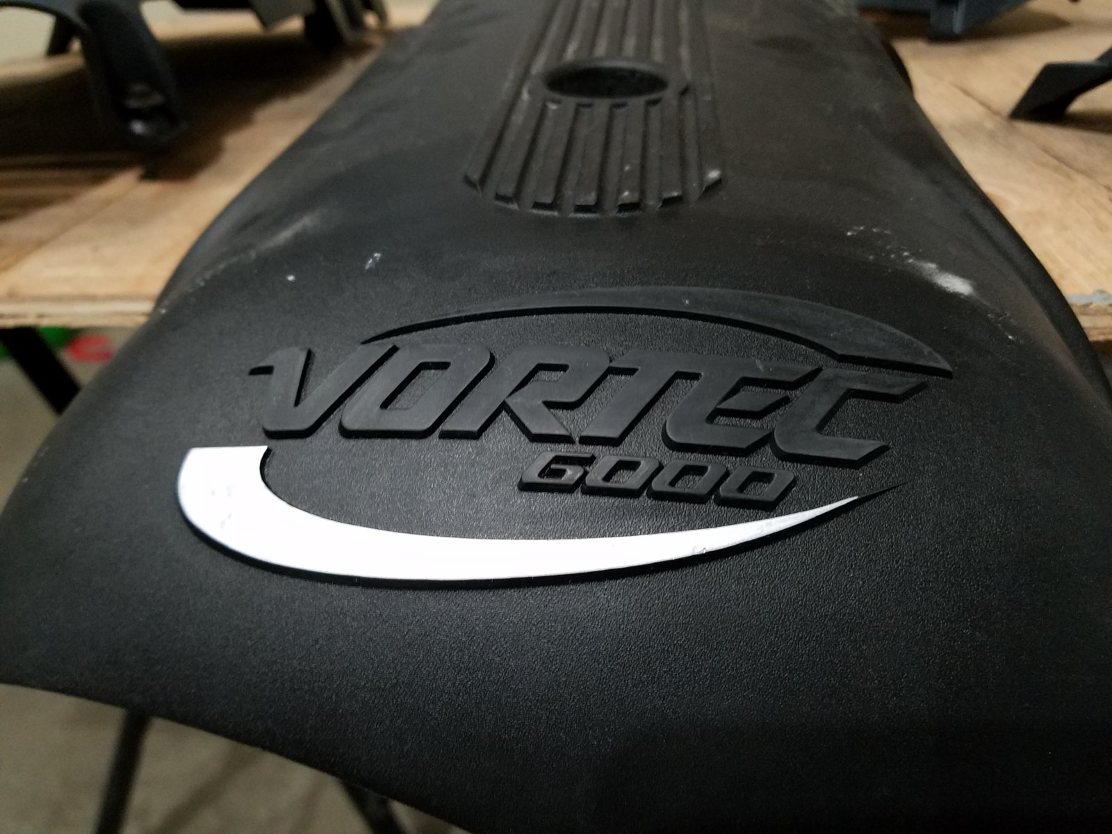

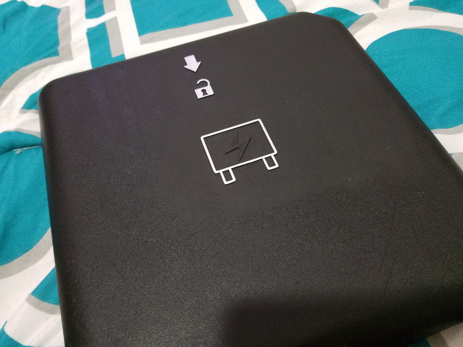

Used sharpie paint markers from home depot. Lightly wet sandy the letters and symbols that you 2ant to paint, that will create a surface for the paint to grip and a ledge so it doesnt drip over onto the surfaces you don't want to paint. I practiced on the 6.0 cover I had.
Before
After
But wait, there's more!!! (Billy Mays voice)

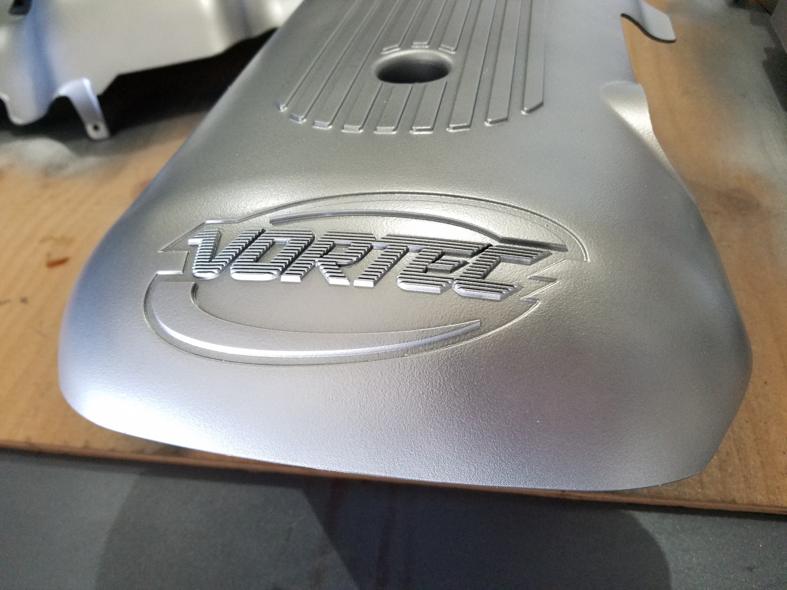

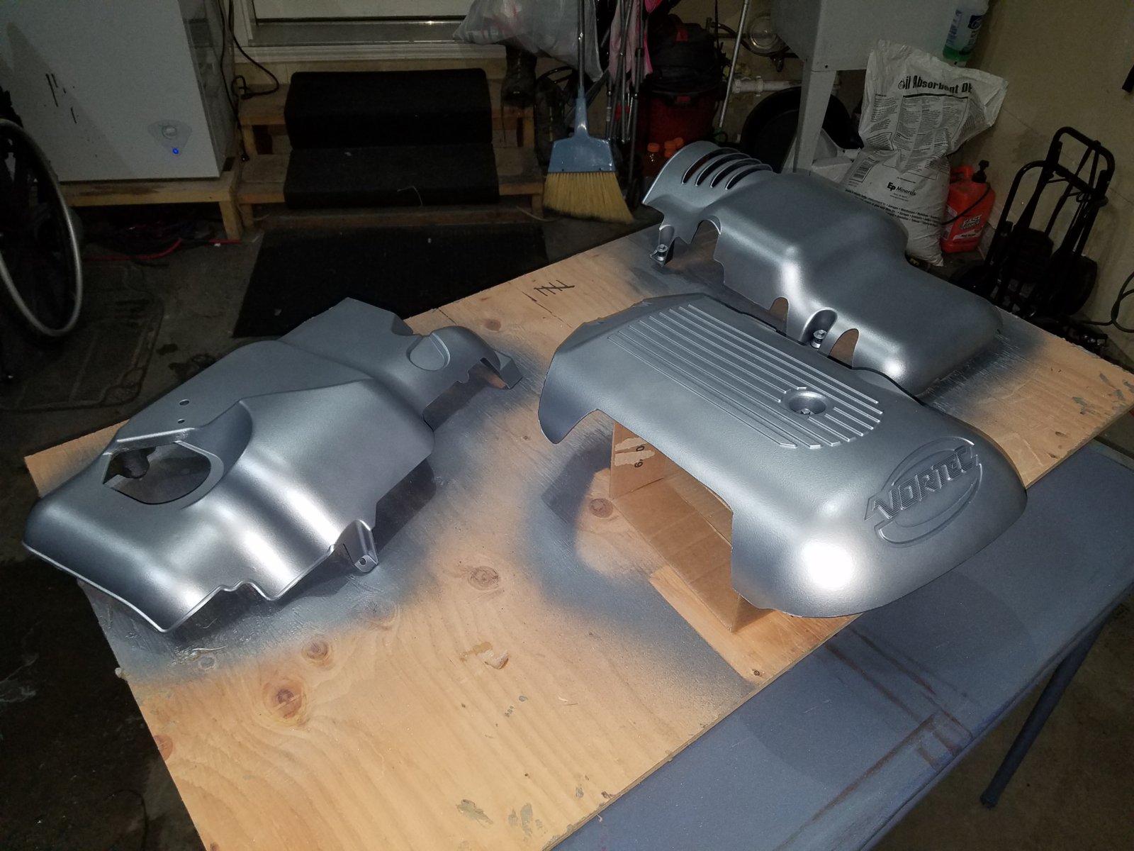

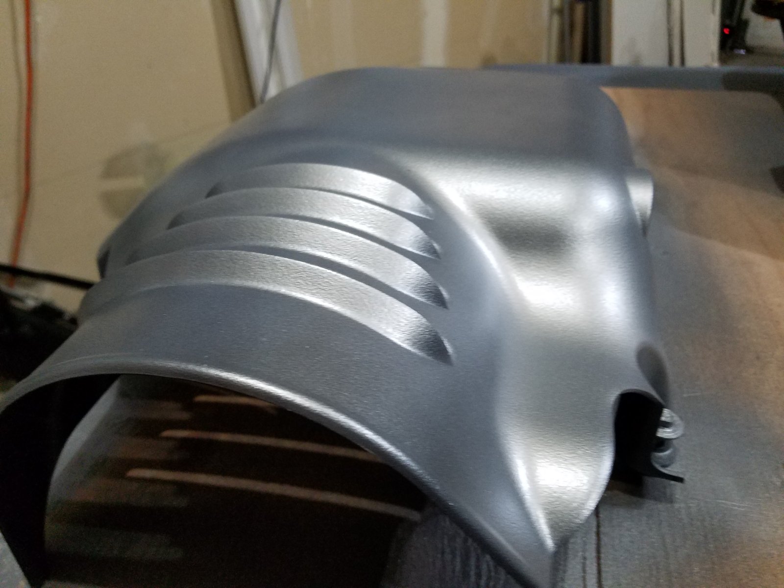

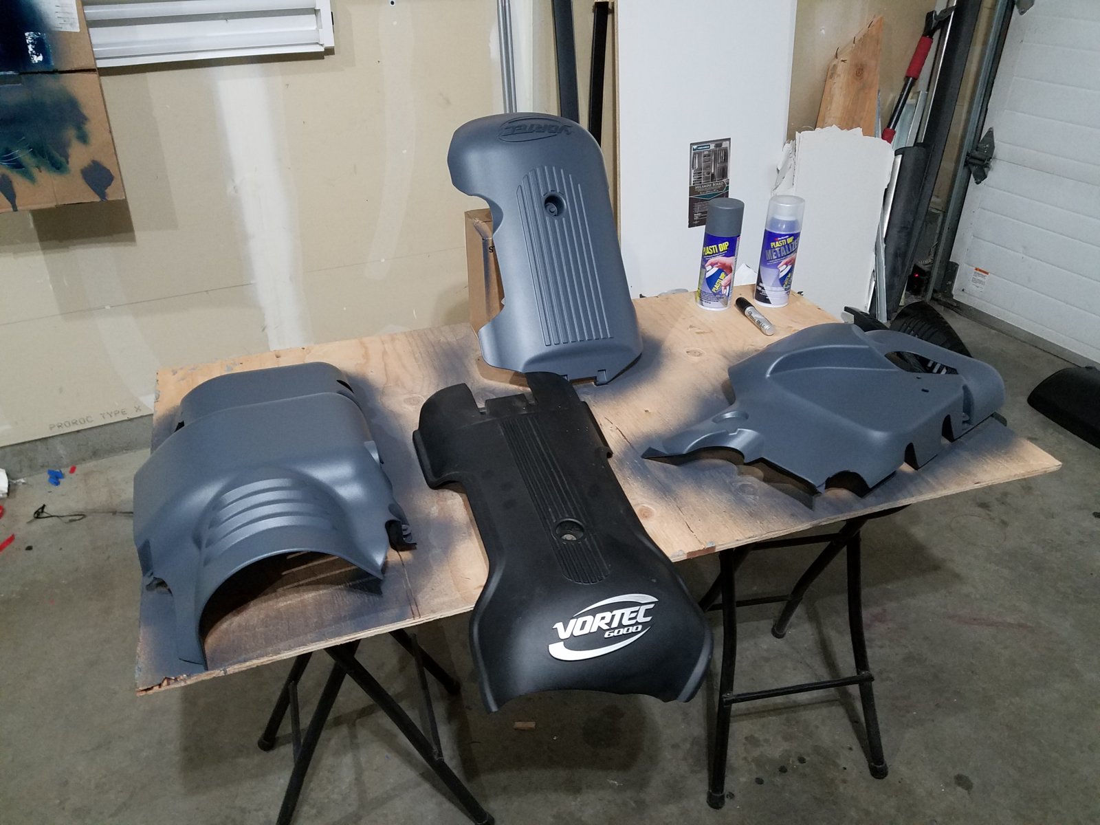

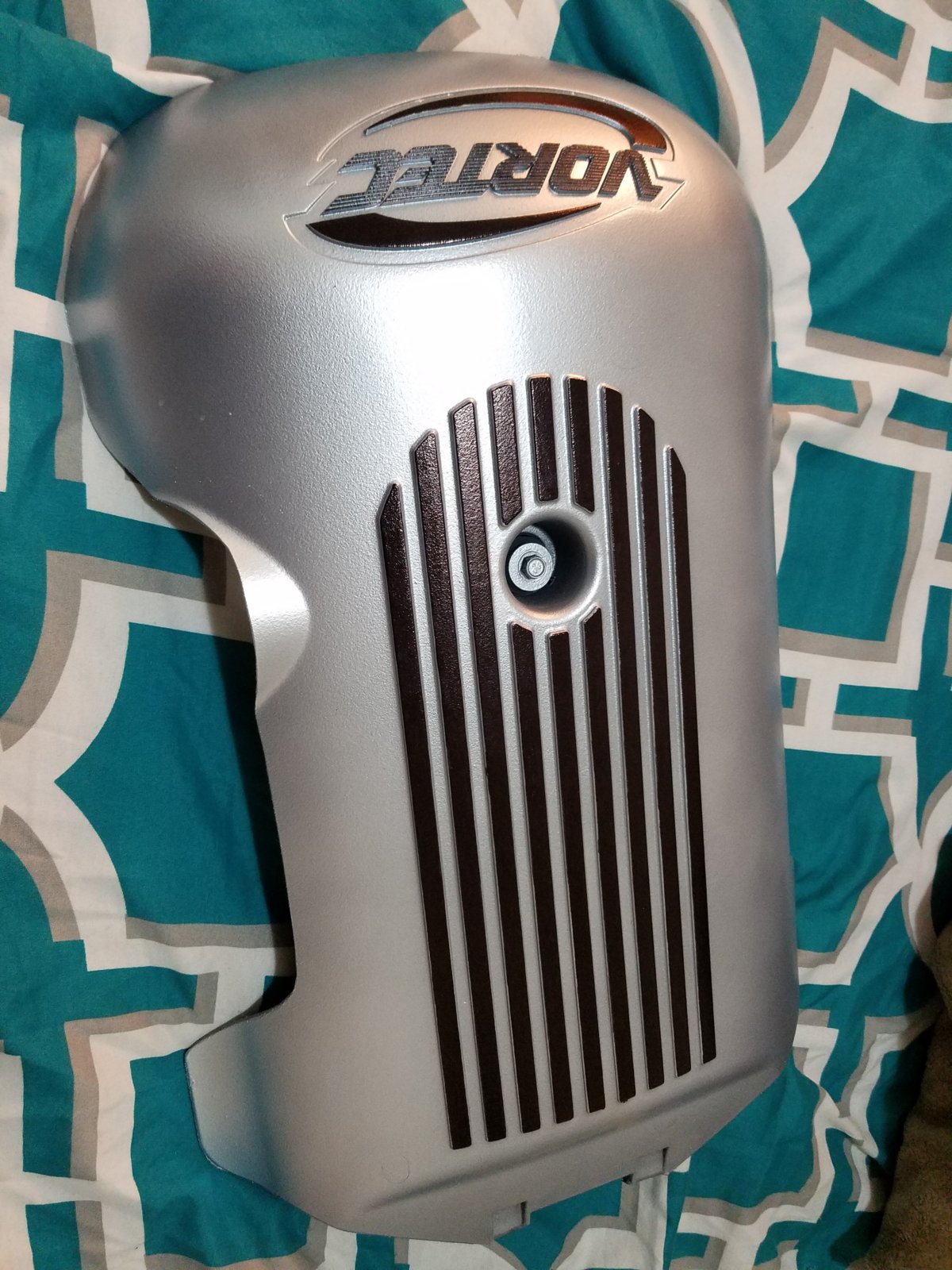

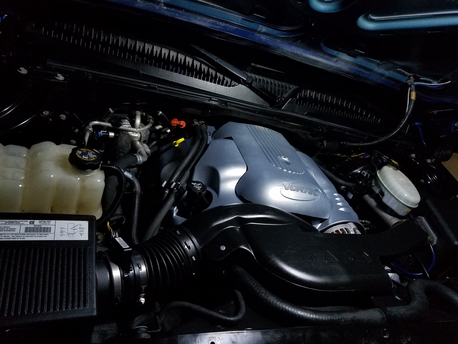

Then plastidipped the 3 piece cover with my custom cut 5.3 cover.
6 base coats of gunmetal gray.
3 coats of pearlizer and it creates a raw aluminium look. *Same effect if you used black as a base coat. The coverage is crazy quick, this is only after 1 coat.
Final coat
