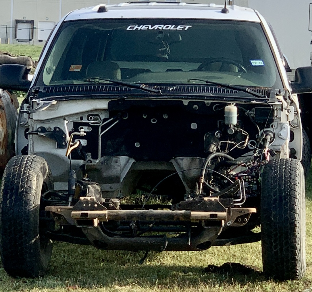

This is it btw. My brother also noticed it has the hydroboost brake system. I don't know if that's Z71 standard or not. Anyone?
