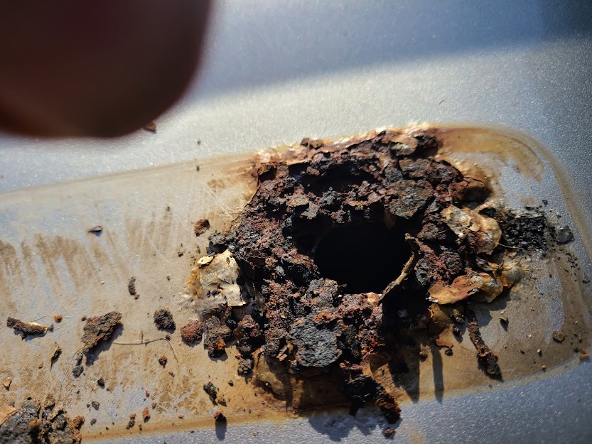

Capt Don
Mar 20, 2014
On my '02 Tahoe, I developed very wet driver side floor carpet after heavy rains. Went through all the investigating. Found the cause to be a rust hole under the front roof rack mount.
