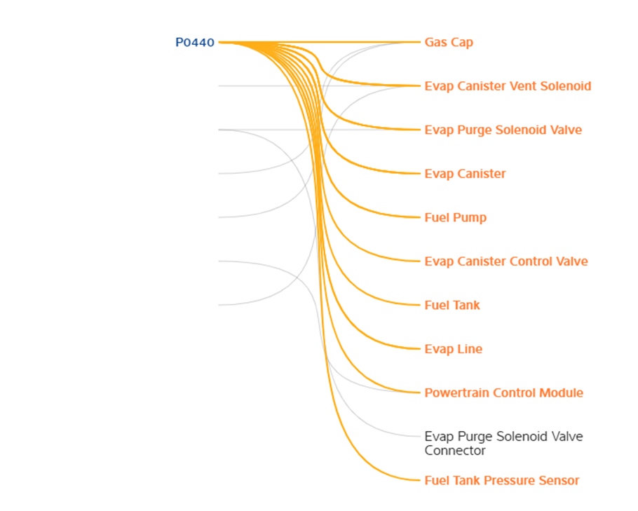

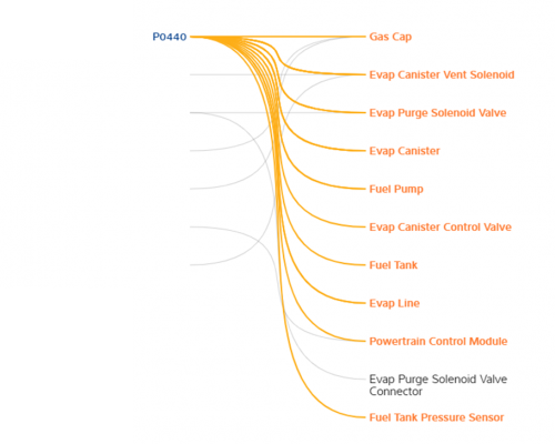

On another note, P0440 is not uncommon. Attached is a screenshot from ProDemand with the top causes of your specific dtc.
Project Denali
Nov 30, 2016
148
150
I have personally had issues with the purge solenoid located on the front of the intake manifold, and the seal on the gas caps before. Remove your gas cap and check the sealing edge for cracking.
