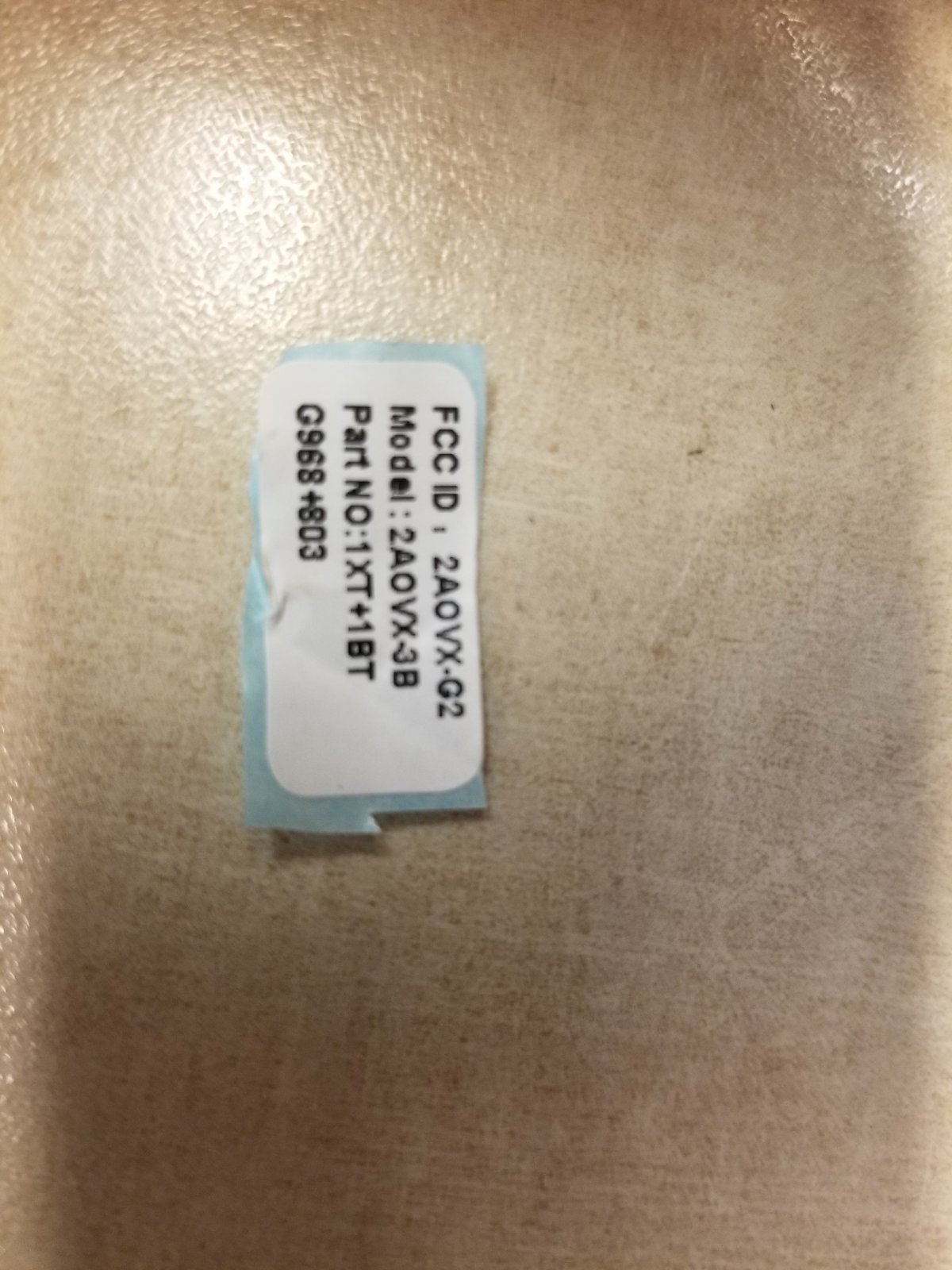

I had a 2002 Tahoe and went to Amazon to order 2 extra fobs. I did use the original fob and one of the new fobs and followed the steps in the pic I am posting and both fobs worked fine. I still have the new extra fob and plan to program them all to work. I know that when you do the new fob you have to do all steps for the new and existing fobs at the same time. Hopefully the pics help and I ordered the new fobs off of the numbers on the back of the original fob.

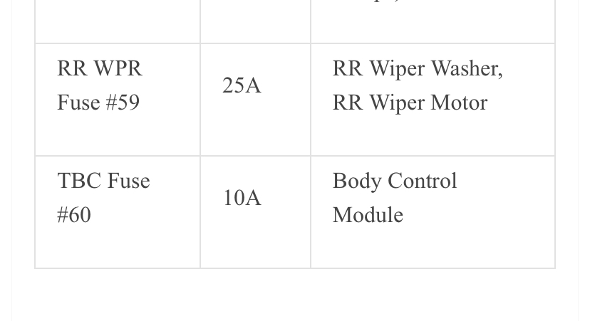

Check these links out: https://fusesdiagram.com/chevrolet/fuses-and-relay-chevrolet-suburban-2000-2006.html
https://chevroletforum.com/forum/tahoe-suburban-25/just-started-blowing-interior-bcm-fuse-19423/
On this link, look at the very bottom of the diagram for fuse #59 on the dash side panel location for that fuse box.
https://fusesdiagram.com/chevrolet/fuses-and-relay-chevrolet-silverado-1999-2007.html

Again, thank you very much. I will check fuse 60 but I have to assume it’s fine being as literally everything else in the truck works fine. Hopefully someone has the answer!
That 3rd link shows the fuse as number 59.

You are correct. I did not click off of the default fuse list for 1999. The fuse list for 2000 to 2002 shows fuse 60. Good catch.
you had me second guessing myself! I’m like what am I missing here!? Nevertheless, I’ll check it but I would assume other things would be rendered inoperable if the fuse was bad. I wonder if it’s possible that the bcm could only be bad but the only thing affected is the fob programming? Would it then make more sense to have someone with a scan tool that can access bcm features manually add the fobs? I’ve added fobs to numerous vehicles and never had an issue. I really wish I knew why it won’t work!
