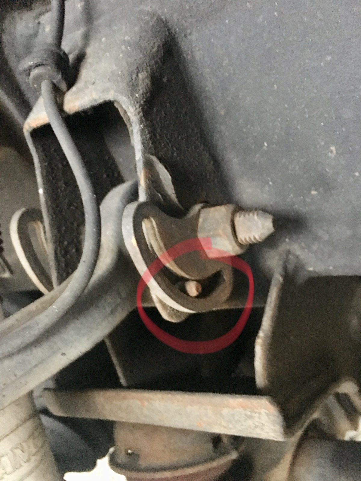

Hello so my left lower control arm is missing a pin has this happened to someone? And how do I go about fixing this or where can I order the part?

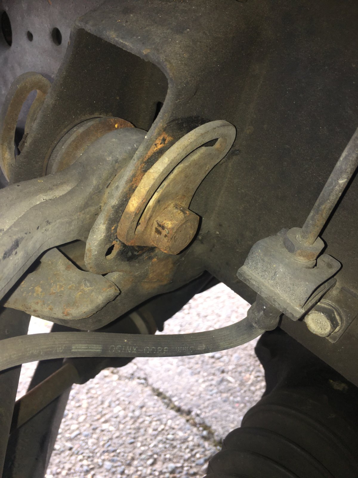

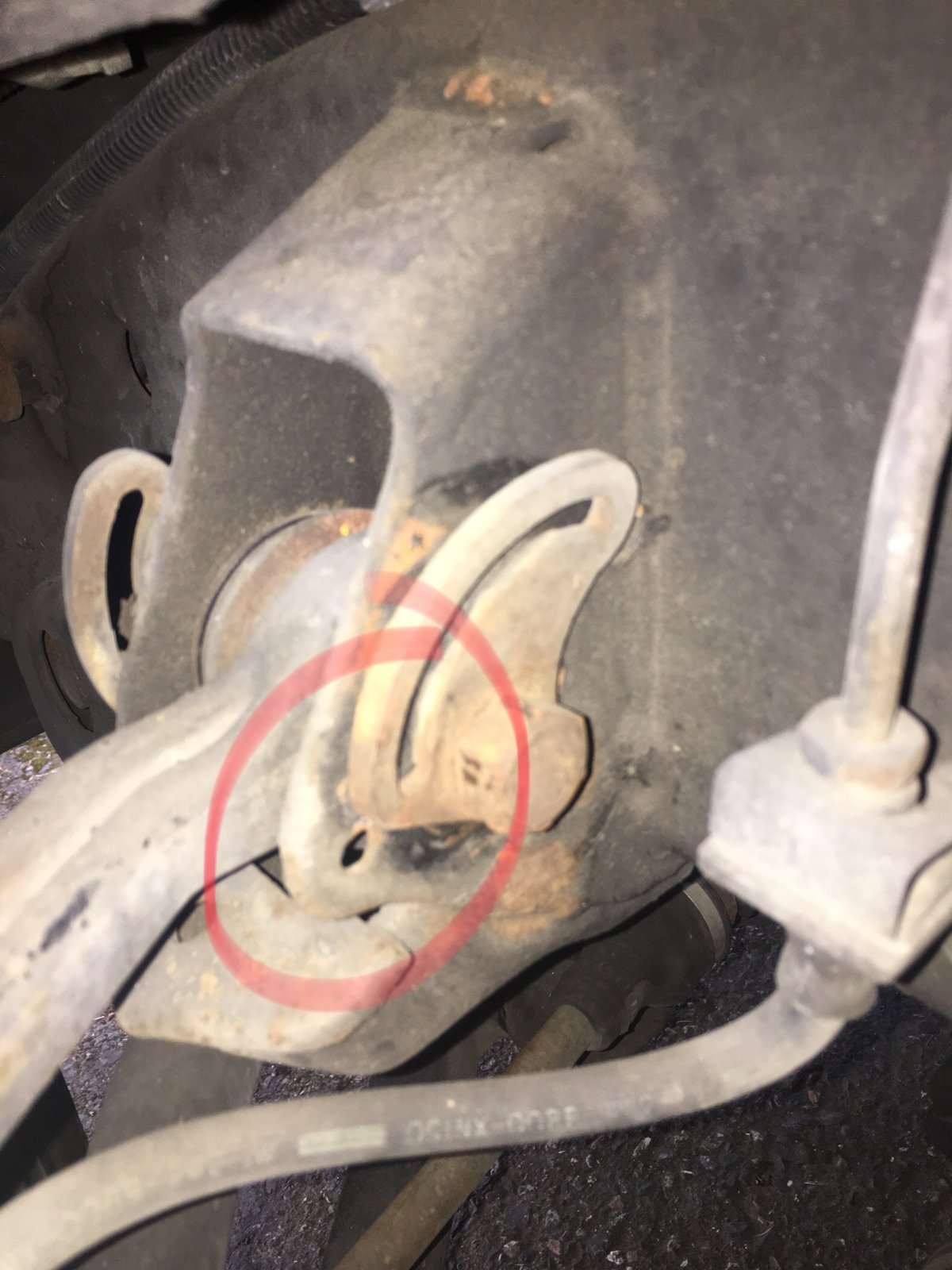

Thanks for the feedback. However, it’s more of this rod thing that’s missing (circled).
Here’s the rod intact on my right side lower control arm.776D02F5-D4B3-4A68-880A-06515DB9422C.jpeg
Here’s my left side where it’s missing the rod

Yeah those little guide pins that both these guys listed are what you're missing. They're just pressed in, I've got 2 that are loose and trying to come out. It happens when someone tries to crank the cam/control past the point where it's stopped up against those pins. I bought some Belltech alignment cams for my truck when I dropped it and found out the hard way that the sweep is completely different and won't work with stock arms. I pulled one of my alignment cams straight out of its mount lol
